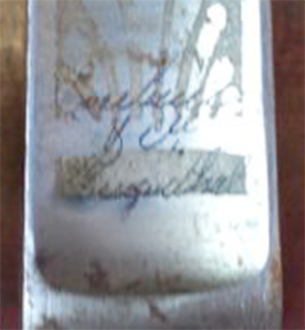

Secondly: as I stated earlier, I have just acquired a Second Empire Court Sword from Klingenthal and spending time playing with it has led me to what must surely be a universally asked question; why did they not put an edge on the blade? It is of the 'one wide', and 'two narrow' hollows cross-section and I cannot see why they didn't sharpen the edges to produce a cutting sword as well as a thrusting sword. It would be very easy to do, and entirely unique style of fighting could have been developed to take advantage of the facility. I'm tempted to have someone put edges on this sword just to experience the capability of it. Even a 'uniform hollows' blade could have been sharpened quite easily.
ps
Does anyone recognise the maker's name on my blade?
[IMG]

The picture is very blurred but looks like a Klingenthal... Can you reshoot the blade please... Regards, Ibrahiim al Balooshi.

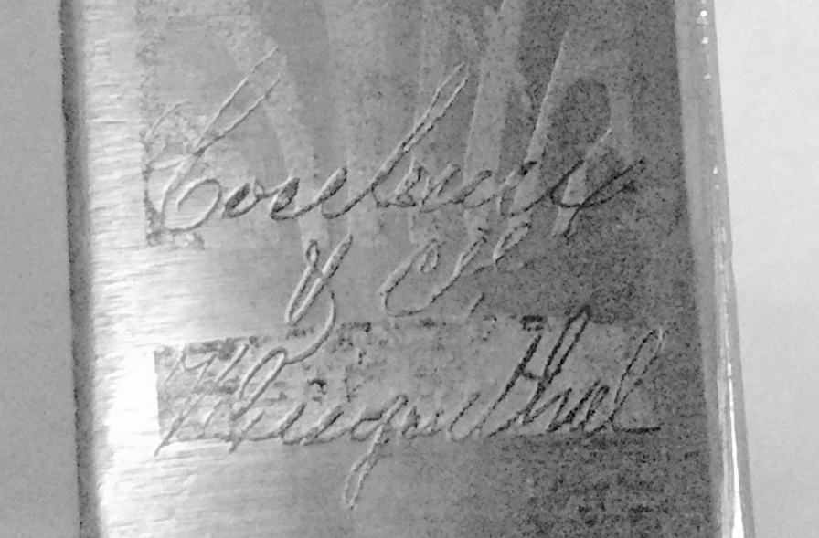

Yes, very messy, and me an ex pro photographer; sorry about that.[IMG]

It's Coulaux and Bros, isn't it?

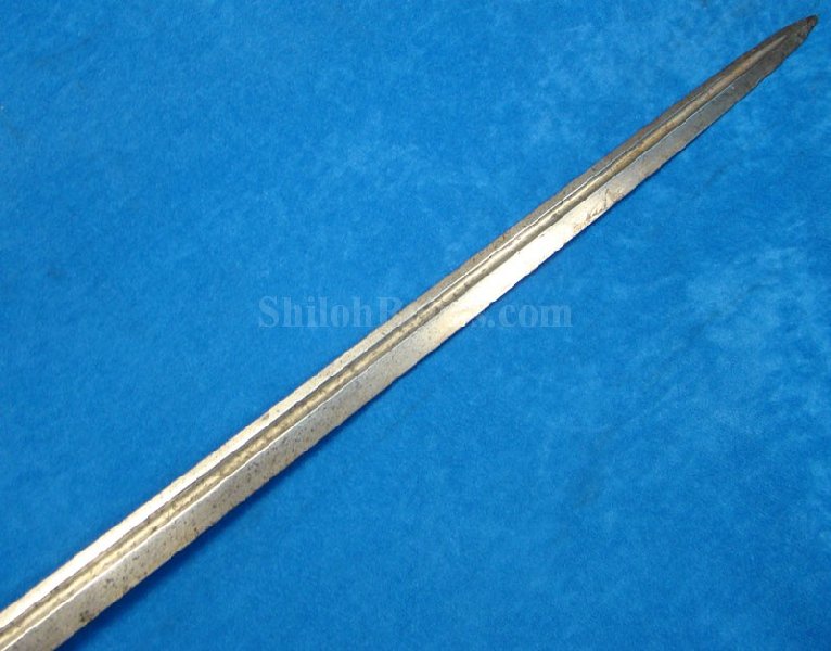

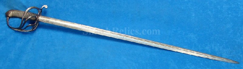

They are all tri-form hollow blades they are holding.
I don't think they are. Rather they are blades for the standard 1882 infantry swords with the offset fullers (cannelure) which became apparent mid 19th century. Note the fuller terminating before the foible. The blades are lenticular rather than concave. The appearance in the photo deceived by lighting and luster.
My colonial fantastique circa 1870 with a Coulaux/Klingenthal blade.

Hello Mr Hotspur, or shall I call you Harry. Yes, once I viewed the photo on my PC rather than my tablet I realised they were not small-swords. The reason I commented was it seemed wrong given the date.
How come Klingenthal survived and Shotley Bridge didn't? They were both Solingen workers abroad. Could it simply be the addition of quality blades from Birmingham that made the difference?
I'm very impressed with my 'hollow-blade' court sword from the Coulaux Brothers: it's a superb blade.
