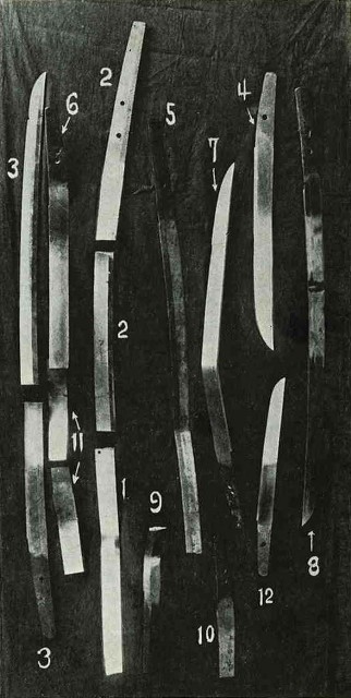

Japaneses had made their own cutting experiments even destroying very
valuable weapons (see picture/captions below, a hundred thousand dollars today...) to test reliability of swords under every aspect (the picture refers to -60° C tests for brittleness in the '30, good for another topic elsewhere here, I believe).
Want to say if a great wootz blade cuts better then a great euro one ?
This forum has plentiful supply of antique dealers. Buy a bunch of swords
of both type, learn how to correctly use them and try on a historically correct target (the target topic only would request a lot of study). There is no other way to have definitive evidences. Everthing other are armchair speculations.
Test by Omura Kunitaro
Reference:
Nagoya Shinbun, Nagoya Shinbunsha, February, Showa 12
Shumi no Token Kenmasube, Omura Kunitaro, May, Showa 8
Nihonto no Kantei to Kenma, Omura Kunitaro and Fukunaga Suiken, June 1st, Showa 50.
1) Norimitsu katana, ni-ji mei, Sue Bizen kazu uchi mono, bent upon a single cut. (This blade was the first tested and it was at normal room temperature )
2) Norimitsu katana, (Blade from test 1) After it was conditioned to -60 ° C, it was broken when struck.
3) Tadamitsu katana, Bishu Osafune Tadamitsu, Meiou 3rd year 2 month day, a well made sword with horimono, conditioned under -60 ° C, broken when struck.
4) Masaiye tanto signed Mihara ju Masaiye, era Choroku , conditioned under -60 ° C, bent and large ha-gire when struck.
5) Yamato-mono katana, mumei, Oei period, conditioned under -60 ° C, bent and large ha-gire when struck.
6) Muramasa tanto, mumei, 2nd generation, conditioned under -60 ° C, bent when struck.
7) Mino-mono wakizashi, mumei, Oei period, conditioned under -60 ° C, bent when struck.
8) Morimasa wakizashi, Bishu Osafune Morimasa, Oei 21 year 2 month day, conditioned under -60 ° C, big and deep shinae occurred on the ji when struck.
9) Mihara-mono katana, mumei, Tenbun period, conditioned under -10 ° C bent with three large ha-gire when struck. One of these ha-gire caused the blade to break.
10) Sue Shimada-mono tanto, mumei, conditioned under -60 ° C broken when struck.
11) Shinto Seki mono, mumei, heavy and thick tanto, conditioned under -15 ° C broken, one big mune gire and three ha-gire when struck.
12) Signed and dated gendai tanto, by Toukoto in mid autumn of Showa 11, modern steel alloy of Tungsten and Molybdenum, conditioned under -60 ° C bent when struck.

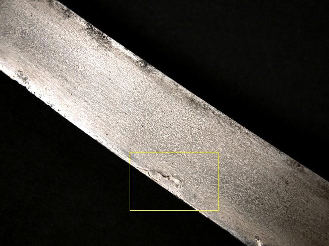

BTW, here is an example of what can happen to wootz.
http://cgi.ebay.com/ws/eBayISAPI.dll...0731&rd=1&rd=1
Look at the very first picture: very big area of delamination.
Old 29th October 2006, 06:44 PM   #138
katana
katana's Avatar
Location: Kent
Posts: 2,658
Hi Ariel, is this the area you are referring to....?
Old 29th October 2006, 06:46 PM   #139
S.Al-Anizi
S.Al-Anizi's Avatar
Join Date: Jun 2006
Location: Arabia
Posts: 278
That seems like a fatigued edge.
S.Al-Anizi is offline   Reply With Quote
Old 29th October 2006, 07:08 PM   #140
That's the one.
BTW, whose signature is in the cartouche?
Another Assadollah?
Carlo,
All of us are armchair specialists, yourself included (no offence).
Yes, the problem is that I wantn't to seem anything more than this.
EDIT : I've realized that we're not talking about NihonTo. Ariel are you sure Wootz delaminate ? It's contrary about what I know about it.
That's the one.
Another Assadollah?
Looks like an old weld repair to a chip, probably from cutting cannon barrels .
Provided we can be certain that the contemporary wootz is identical to the original one, and, as far as I know, this is a very uncertain area. The best reviews of modern wootz sound like "... looks very similar in structure and appearance..."
BTW, in one of your earlier posts there was a picture of a helmet cutting test. Was the helmet real? Having seen that pic as well as the horror of "Sword testing", I seem to begin changing my opinion about Japanese reverence for their cultural objects
As for yor drinking taste, I am disappointed... I am giving you a way out: try Peruvian Pisco: it's their version of Grappa, but the grapes are different.
One glass and you look like that...
mmm.. Are the dimensions of that c*ck related to the reason you know Pisco ?
if it makes such a magic i've to try it.
Still waiting your explanation about how the heck wootz steel can delaminate...
tsubame1 is offline   Reply With Quote
