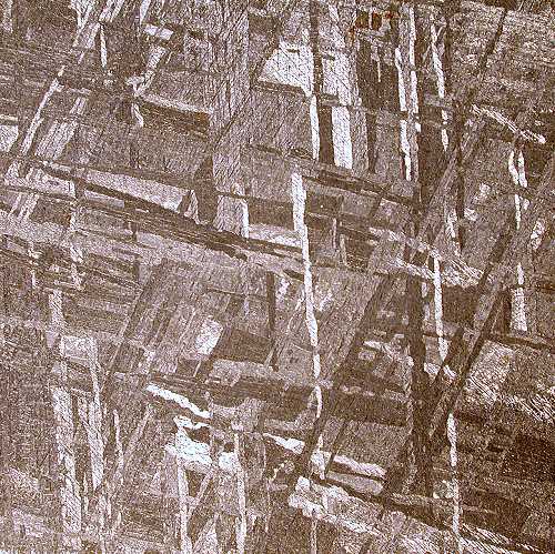

Tom,
I do not think anyone would confuse pamor with Widmanstatten structure. Widmanstatten structure will only be visible through rusting (oxidation) or through acid etching. Pamor is basically binding the iron on the blade with sulfur to blacken it. Attached are two pictures to show the visual differences, the Widmanstatten structure if of a fine octahedrite.
Here is some more interesting stuff:

Actually though we may have forgotten, I think it is very easy for anyone not familiar with either to confuse or conflate the two; the primary visual difference is contiunual curved layers vs. patchy small layers; not a very big difference to the many people who are not much used to thinking about material structures....
As long as we keep in mind, there isn't any black color in the Widmanstatten pattern. The affect is cause by the different speeds the acid "eats" it's way through the nickel-iron structure... where in pamor, it is a blackening affect by depositing sulfur on the iron, changing the color of the iron surface.

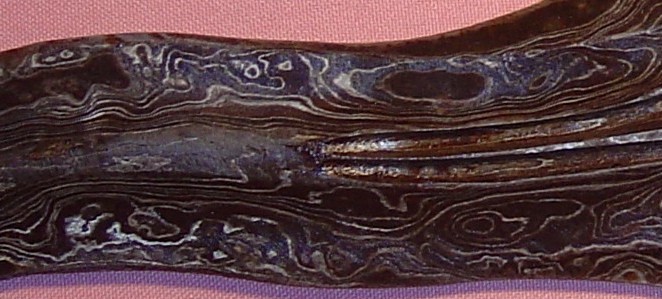

tom hyle
Location: Houston, TX, USA
Posts: 1,254
Actually pamor is etched by acid in exactly the same manner, and (commonly) also stained. The staining is a subtlety understood only by natives and afficionadi; ordinary "westerners" do not understand there to be a difference between pamor and any other folded steel, if they know anything about it at all.....listen, I encounter sellers on ebay who cannot give me measurements in coherent units, or who don't know the difference between width and thickness; believe me; it's easy for the ignorant to conflate things.
Hi Tom,
I just want to be sure I am not misunderstood... unlike pamor, the Widmanstatten pattern has no staining to the surface as does pamor. That is the difference I am referring to.
BSMStar
