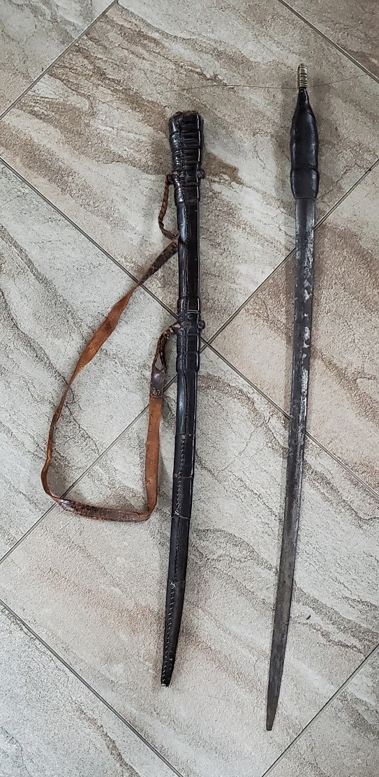

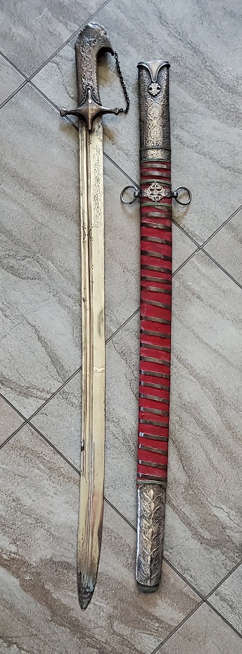

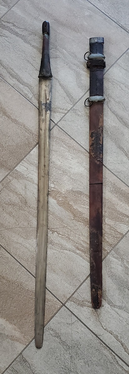

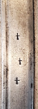

Wanted to add these three with notes:
1. This is what may best be called 'Maghrebi' as these are found from Algeria to Morocco, but typically they are known to collectors as Moroccan sa'if.
The mark at the forte is located in the same place as typically these are found on Algerian examples (Briggs, 1965). There are varied marks but significance unclear.
2. This is the so called 'Zanzibar' form, which term seems to have developed in the 80s and possibly from numbers of these which were apparently sent into Yemen from there. This was one of about 40 discovered in a Yemeni arsenal (?).
The markings of three crosses on the blade may be interpretations of German blade markings.As previously noted, Buttin (1933) makes no notice of these being peculiar to Zanzibar and terms them Arab sa'if only.
3. A sa'if of 19th c.(possibly earlier) Hadhramaut, according to Elgood and Lebedynsky, which may have silverwork from Hyderabad. There appear to be two hilt forms, the one with canted pommel and hand nock, and this more karabela form. Hadhramaut is of course a Yemeni region.
The pages are from Elgood ("Arms and Armor of Arabia" 1994) and Buttin, collection catalog 1933.

Wonderful grouping!! These are excellent examples of these sa'if of the Arab sphere. It is important to note that this does not mean 'Arabian' as in Arabia proper, but in the places where Arabs populate the regions, not meaning to get into ethnic discussion.
By the same token, the Moroccan example has long been known colloquially as a 'nimcha', by collectors, but overall, these are all simply termed sa'if.
These are likely 19th century but could be earlier, especially the one you note as Yemeni, which is actually more to the Hadhramaut regions (as described in Elgood, "Arms & Armour of Arabia".
Thanks! As it happens a copy of that book is on its way to me now from the US. Took me longer to find a copy of the book that I could afford than the actual sword! Look forward to reading it.
The example with extended crossguard ring has also been somehow classified in collectors circles as 'zanzibari', however in Buttin (1933) these are noted as Arab sa'if, with no mention of Zanzibar. Naturally these were present there, but by no means were they exclusively from there. It seems this classification appeared in a number of references in 1980s.
The blades on these are invariably trade blades, German of course, and the blades are typically early 19th c. These were most typically acquired from Bedouin traders by armorers mounting blades into hilts in locations often in Yemen. With the Moroccan examples (which were often Algerian as well) these were mounted with trade blades, and armorers often added the 'sickle marks' approximating the so called 'Genoan' marks.
The straight blade on the 'Zanzibar' example is of a type of trade blade usually into Ethiopia late 19th c. which usually ended up traded into Yemeni markets. These were often mounted in Yemen on silver hilts of a different form. Ethiopian swords often went into Arabia as the Arabs were after the rhino horn typically on the Ethiopian shotels for their kahdjhar daggers.
Ah, very interesting. I thought there might be a connection to the Omani kattara (although the tip on the Zanzibar is not as rounded), and I knew a lot of the Moroccan blades are European, but I hadn't made the link between the straight bladed Zanzibar saif to the Ethiopian market. The straight bladed gurade swords I've seen usually have different styles of fullering.
EDIT: And to add, I really like how that red contrasts with the silver on that karabela's scabbard! You see that on Dha scabbards sometimes as well.

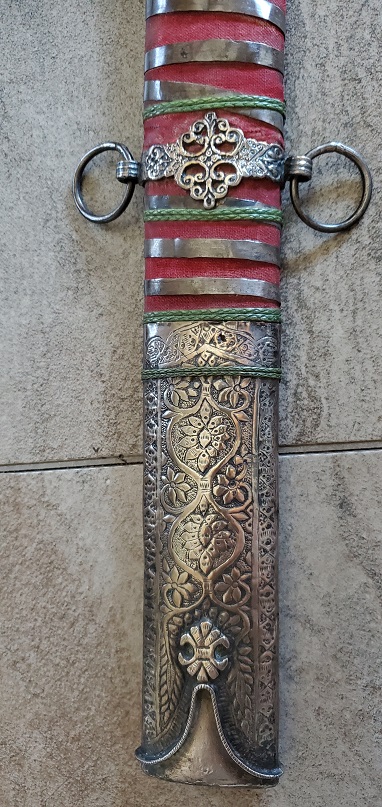

Thank you for the note on the red over silver banding. Elgood notes this as a Hadhramati characteristic coming from swords mounted in Hyderabad India in accord with their mercenary forces active there. These kinds of styles found as far as SE Asia, and even Central Asia (Uzbekistan) are often found in the Indian subcontinent conduit. A distinctly Arab feature however in the silver work is the element known as the aghrab (=scorpion), which aligns with the evil eye superstitions.

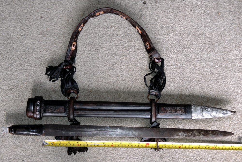

In pics:
An Omani 'dance' sa'if as used in Zanzibar Funoon ceremony. These have commonly become known as 'kattara'.

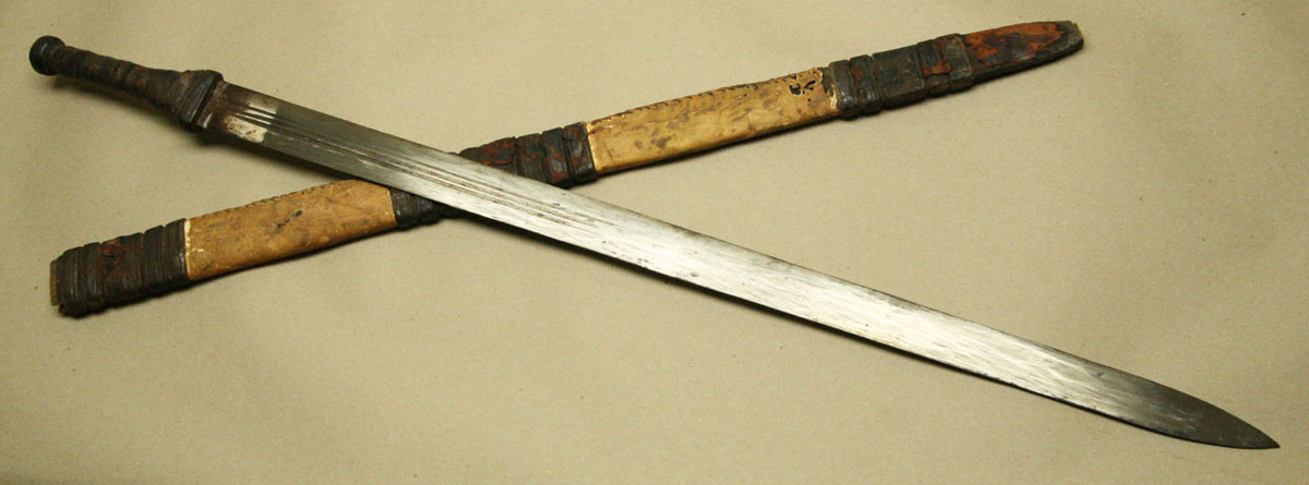

Next is likely a Manding saber from Mali, but this is remarkably similar to the curved sabers also from Zanzibar which are actually deemed 'kattara' by the Omanis. These are noted to often have German 'cavalry' blades.
It is interesting to see the similarity of the cylindrical hilt of Manding sabers with this type of pommel........trade caravans westward which often had Zanzibar origins traveled through the interior carrying Omani influences into the Sahara, especially Timbuktu (Mali). Here eastward influences from as far as Morocco interacted traveling eastward back to Zanzibar.
Moroccan s'boula are known in Zanzibar (Burton calls them Zanzibar swords), so the cross diffusion of these weapons is certainly viable.

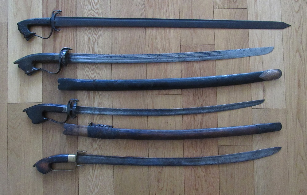

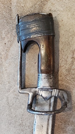

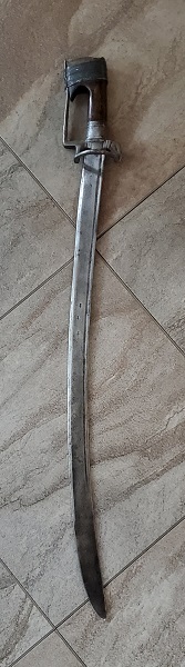

Werecow, this is a really nice Zanzibari, or probably more appropriately, East African saif. Great to see it complete with its wooden scabbard. It is interesting that these swords almost never have any blade marks.
I know nimcha refers to the overall sword size, but since I do not have a better word to describe this hilt type, I will keep using the term "nimcha" here. When it comes to the difference between Maghrebi, Arab and East African nimcha hilts, the shape of the grip and especially the angle at which the pommel is tilted is in my experience more important in determining the area of origin than the presence or lack of a guard ring. Some Maghrebi examples, especially earlier ones have a guard ring. Then there are some examples from Oman/Zanzibar and the Comoros without a guard ring at all.
Here are my few examples, of which the one with the straight, single edged blade has no guard ring and a sort of a "crab claw" like guard instead.

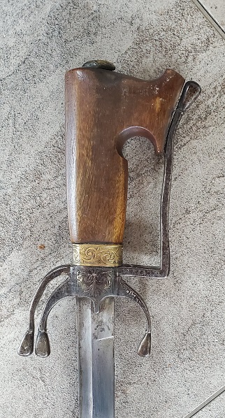

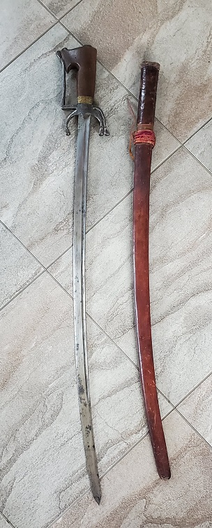

I think that's actually the first nimcha/saif I've seen with a backsword blade! Very interesting. EDIT: Actually, there are a couple on the first pages of this very thread! My memory is not great. }|:oP
I've seen a few of the Manding swords with straight blades as well. Sometimes it's easy to get them confused, especially when they are not the kind with the bulbous scabbards. Case in point:
Contrast with:

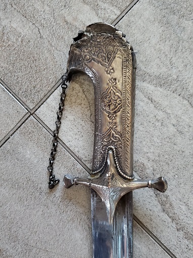

Thus I will open with the Scabbard... which is identified as Omani Style with distinctive leather sworls in a circular design seen on Omani Sayf and Kittara scabbards... identical and not seen on other nations scabbards.
Post 16 above and other pictures dotted around on this thread show many similarities in Nimcha design both types given a sort of grouping by Butin into African and Arabian types with charts again shown at thread and interestingly showing the broader Yelaman on Chart xxx11.Top right and Left. It is suggested and in support of Jims research that this is Moplah influence from across the Indian Ocean on the Malibar Coast..
Who gave the name Nimcha to this weapon? Butin seems to have taken the view that these were all Nimcha types but we know that none of the local peoples called them Nimcha...a term perhaps coined after the short coat ...or waist coat of the Baluchi mercenaries working for Saaiid The Great in the Indian Ocean. Omanis call the type Habashi. Nimcha seems to be a collectors name.
The main hilt shape appears to be very similar to the Turkish Palash style including the general format of the grip pommel and cross guard knuckle guard and turned down quillons but with a much less broad blade which in the Turkish type is a massive cleaver like blade. See thread for examples.
Hilt design also includes a more lavish expertise known to have been iused by artesans in Zanzibar in the art of Ivory adornment usually seen on hand held mirrors and illustrated on the hilt seen here at post. The style is also shown on thread of a mirror from Zanzibar in that style. I wouild expect this to adorn a VIP or rulers sword or an important trader or sea captain. See also how this hilt has spread to places in the Indian Ocean by viewing a similar hilt from the New Caledonia Islands...

Atop the Zanzibar pommel is a turtle which is the same type as lives around the tropical Island of Zanzibar...thus is a signature design feature of the location...and suggests something related to Oceans and or Sailing?and related to Zanzibar.
A Royal Insignia...!!!! Next is a quite remarkable signature feature representing the signature of HM Saaiid The Great himself ...See picture below for exact example and details of the entire hilt... On thread is the signature of the ruler and further there is an Omani sword hilt with this kriss cross format which is what I suggest also a basic signature
using silver stiching ofdten seen on Omani Sayf and Kittara swords hilts...and repeated on Khanjar belts....... and view the sword makers effort in reproducing a follow the dots style of design. This is accurate insofar as down to the minute blemishes seemingly tiny floral decoration possibly inspired by the herbs growing on Zanzibar...between the letters which are of course in Arabic... read from right to left and done geometrically on each quillon ...The quillon of the edged cutting blade under the knuckle guard is the correct one to read and at thread is an almost exact perfect example of the Rulers signature at least in part..

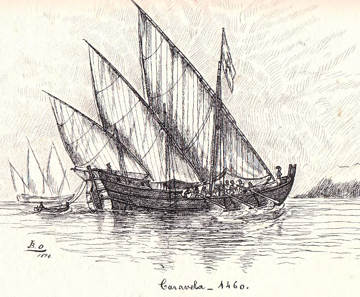

The Arabs used the lateen sail thru the Copts, mostly the crewmen for Muslim-led fleets for centuries. It was the Arabs who developed the lateen sail. Later on, sailors used it in the Mediterranean. Only after the 14th century did the Atlantic and Baltic vessels switch to using the lateen sail. Northern Europe adapted to using the lateen sail in the Late Middle Ages.

Old 22nd February 2024, 04:39 PM   #104
Originally Posted by Peter Hudson View Post
It was the Arabs who developed the lateen sail. Later on, sailors used it in the Mediterranean...
Regarding the lateen sail, several authors have suggested in the past that it was introduced to the Mediterranean by the Arabs, possibly having originally appeared in India. However, the discovery of new representations and literary references in recent decades has led scholars to push back the appearance of the lateen sail in the Levant to the late Hellenistic or early Roman periods.
The Portuguese around the 15th century adapted this sail to the famous Portuguese caravel, becoming one of the main characteristics of these vessels. It helped the great navigators in their great expeditions, and Vasco da Gama was one of the first to use it for this purpose.
(Casson 1995, p. 243–245, fig. 180–182. Basch 2001, p. 57–64.Campbell 1995, p. 8–11. Pomey 2006, p. 326–329).
