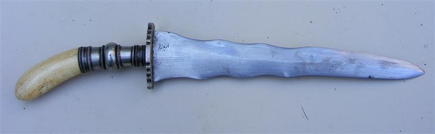

Thank you Jose for your educated opinion. This would explain the sharp luks and the good condition. But the workmanship look quite good. Do you think that to this time they were worked for locals or for tourists?

I would not worry too much about this being a small piece made for tourist as most of the ones of this style I've seen are from 10/12 inches in length. As Jose has pointed out the hilt having the sudden bend and not a slow or flowing curve points to its being of later construction and I would agree with his estimate of age placing this most likely in the 1940's. I'm not sure the pointed luks being present on a gunong is an accurate way of dating them any longer as there is now some evidence that pointed luks on kris have been in use long before previously thought. That being said I would not think it would be too much of a stretch of the imagination to think that pointed luks might not also have been used on gunong blades from the same time period. Any way it goes I like this piece and am looking forward to its arrival.

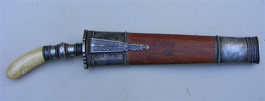

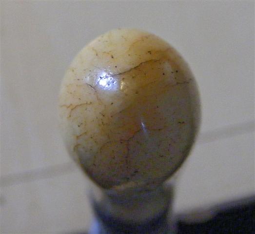

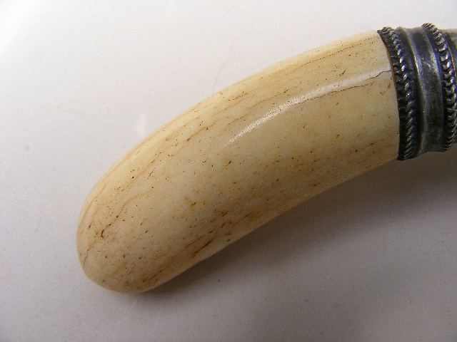

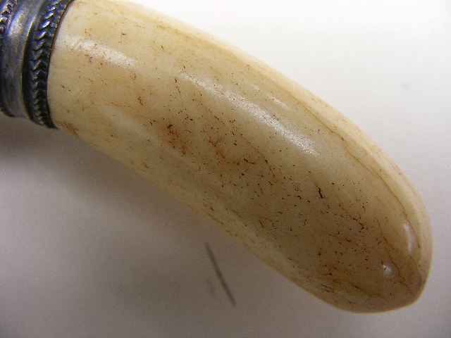

First, thank you Robert for you thoughts about the gunong, second for the good pictures I've received from you.
Here a few of this pictures. Robert and I am very unsure about the handle material, it's almost looks to my eyes like walrus ivory but I am very, very unsure. Any thoughts?
Old 12th June 2015, 10:43 PM   #96
Iain
Iain's Avatar
Join Date: Mar 2010
Location: Olomouc
Posts: 1,720
My entirely uneducated opinion also says walrus, or at least marine ivory.
Old 12th June 2015, 10:56 PM   #97
Posts: 4,736
Sajen:
In the close up of the handle the little black dots visible, especially towards the end of the hilt, look like Haversian canals in cross section. This suggests that the handle is made from bone rather than a form of ivory.
Walrus ivory is extremely rare in the Philippines and would, I think, be restricted to high end, expensive weapons. I have not seen a convincing example of walrus ivory on a moro weapon. However, I have seen what was said to be dugong ivory on the pommel of a datu quality kris.
Ian.

Posts: 7,297
I'm with Ian. This looks like bone to me.
Old 13th June 2015, 10:58 AM   #100
Thank you all for comment!
You could be correct that it is bone. It was just a thought since the ones I have seen with bone pommels has had a top cap to cover the inner porosity.
Old 13th June 2015, 04:39 PM   #101
Posts: 7,297
That's a good point Detlef. I hadn't considered that. Still, it does not look like any ivory i have ever seen and the porousness and black dots on the material does look a lot like bone.
Old 13th June 2015, 06:00 PM   #102
Posts: 7,405
Take it from a bone head, this is bone.
Old 13th June 2015, 09:53 PM   #103
Hi Jose,
think that you are correct.

Robert just send me this both pictures from the pommel head, seems indeed to be bone.

Old 30th September 2015, 03:38 PM   #113
This early gunong will enter my collection soon.
Old 30th September 2015, 06:25 PM   #114
Robert
Robert's Avatar
Location: Centerville, Kansas
Posts: 2,196
Wonderful early gunong Detlef and with silver fittings to boot. My congratulations to you for such a great score and new addition to your collection. Can't wait to see it all cleaned up and the silver polished again.
Robert
Old 30th September 2015, 07:41 PM   #115
Robert
Thank you very much Robert. Would you agree that it is from around 1900 until 1920?
Old 30th September 2015, 08:18 PM   #116

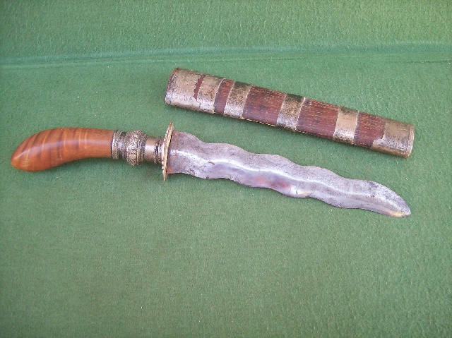

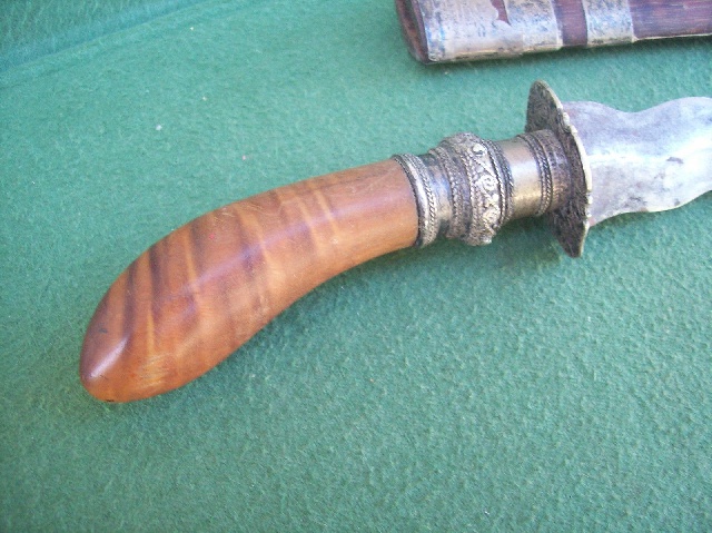

Robert
Robert's Avatar
Posts: 2,196
Hello Detlef,
I would date this from late 1800's to early 1900's. I could be wrong of course but with its size and style that would be my personal opinion on this piece.
Robert
Old 30th September 2015, 09:04 PM   #117
russel
Join Date: Jul 2012
Location: Tasmania, Australia
Posts: 238
Congratulations Detlef. I made an offer on this one, but with the terrible state of the Australian dollar my offer had to be modest (too modest for the seller). I'm glad this good early example has entered your collection.
Russel
Old 30th September 2015, 09:43 PM   #118
Posts: 4,736
I think that would be about right Detlef.
Ian.
Old 1st October 2015, 05:28 PM   #119
Robert and Ian, thank you both for confirming my age guess.
Russel, the Euro don't have a good state in the moment as well but the price was very good for a gunong like this.
Old 10th January 2016, 12:25 PM   #120
Have just get another interesting example from ebay. The seller provided only two pictures and not much information. I am very unsure about the age of this example, handle (pommel) and ferrule is an early style but the blade shows sharp luks which is a sign of much later examples. I doubt that the fittings are from silver. Pommel seems to be from bone. All comments are welcome, special age guesses.
Here pictures of the gunong after it has received some maintenance. The fittings seems to be from (coin?) silver and are very well worked. I haven't etched the blade until now.
I think that this piece is post WWII. I am unsure if this is a very well worked early tourist example or worked for real use, what you think?
