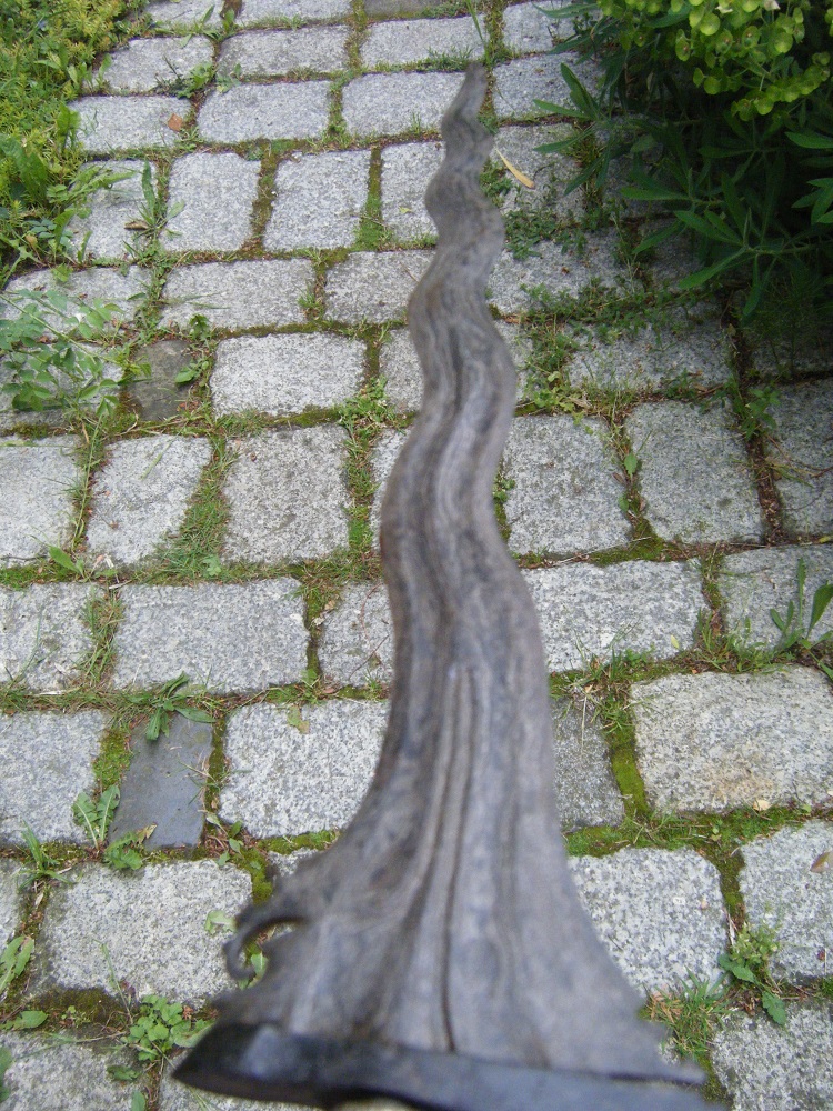

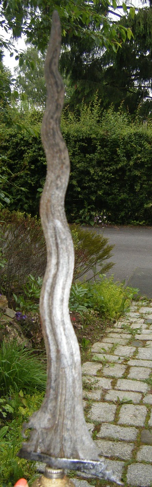

I have no problem with a Bugis influence for this keris.
The sorsoran, especially the indented gandhik and boto adeg blumbangan can be related to South Sulawesi, these features are also attributed to the Eastern Islands of the Archipelago, and the Bugis people occupied Eastern Lombok.
However, I personally do not know of Bugis keris with this very dramatic topographic treatment from South Sulawesi, or from anywhere other than Lombok.
I'd very much like to see examples of Bugis influenced keris that had this style of wilahan and that also had inarguable provenance for somewhere other than Lombok.
I know almost nothing about Bugis keris, I have never carried out research in South Sulawesi, so perhaps this style of keris can be found in South Sulawesi, or even in the Peninsula. But I do not know of examples that can illustrate this.
For me this is most likely a keris from Lombok, but most certainly we can accept Bugis influence.

Actually David, I believe I'm saying pretty much the same as you.
The Bugis originate in South Sulawesi.
They went all over the place.
One of the places they went to was Eastern Lombok, they settled there.
After a time Bugis keris made in Lombok sometimes acquired a style that was not seen in keris from other places.
In the case of this particular keris, I am of the opinion that it comes from Lombok, but has Bugis features, as well as other features that are the result of influences other than Bugis.
So it is a Lombok keris with Bugis influence.
There are probably a number of ways in which this idea could be expressed.
To move sideways a little bit. Wherever the Bugis people went, they made keris, but those keris are not identical with the Bugis keris that were made in South Sulawesi. In the book "Senjata Pusaka Bugis" we can find Bugis keris with stylistic variation that points to varying geographic locations of origin for those keris.
I had a quick flick through this book before I wrote post #60, I could not find any keris with similar deep kruwingan such as this keris has, but there are numerous examples of the indented gandhik, the style that in Solo in the 1980's was regarded by the keris elites as evidence of a keris from the Eastern Islands. At that time in Solo most people seemed to think that the world beyond Bali was remote and savage, so Lombok was lumped in with all the other Eastern Islands.
In "Senjata Pusaka Bugis" this gandhik style that was thought of as "Eastern Islands" by the Solo people, is identified as South Sulawesi.
Then I went to "Keris Lombok", and in this book we can see many examples of extreme topographic sculpting.
There are any number of combinations of words that can be used to classify this keris, but I have chosen "Lombok with Bugis influence". Anybody who does not like this combination of words is perfectly at liberty to choose their own.

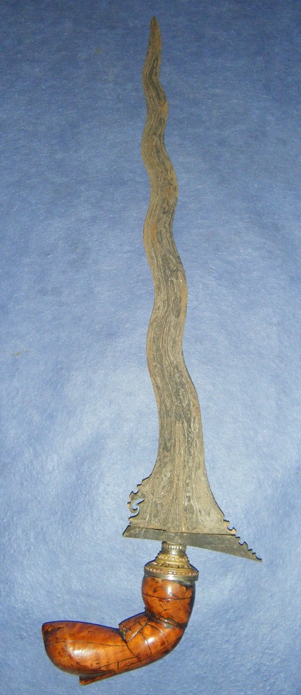

I will post in the next days pictures from a keris I've bought many years ago from a Lombok dealer who stated that he get it from Sumbawa. This blade show some resemblance to the blade in question. But I have only the statement from the seller.

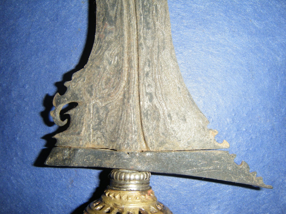

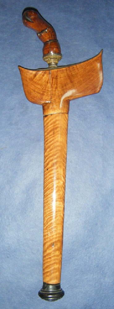

Here the promised pictures. The blade has as well similar long ada ada, not good to seen on the picture. I've received the keris in bad state, the blade and sarung was restored, the buntut was missing.

We have bad lighting conditions today, maybe this two pictures are helpful.

Yes Detlef, some similarities, as is to be expected.
However, although we can see that South Sulawesi gandhik, and other characteristics that mark this blade as Bugis, the kruwingan looks to me to extend only as far as the 3/4 luk, it is not deep kruwingan as in Tim's keris, and overall the blade does not have anything like the same deep topographic relief of Tim's blade.
I would say it is related to Tim's blade, but not, let us say, a brother, perhaps a cousin or other slightly removed relative.
