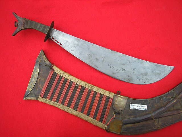

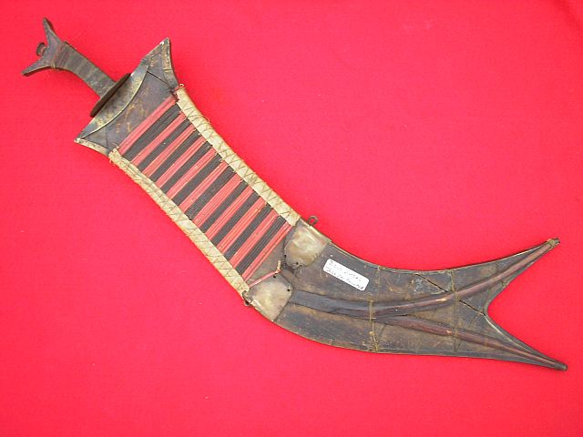

Thanks for bringing these pics back up. That is probably the best example of this rare knife that I have seen. Remarkably complete and looks as though it comes from the same time period as shown in the picture I just posted above. The sticker on the scabbard says: BOLO SWORDObviously not a Tagalog knife. Like Indianajones, I have been looking for one of these for a long time. Ian Last edited by Ian; 21st January 2017 at 06:25 PM. |

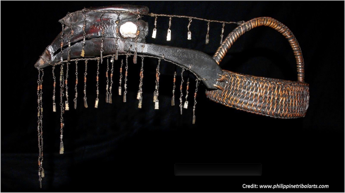

Here is a nice picture of the Ilongot headdress made from a hornbill and other materials.
Height: 6.5" Diameter: 6.5" Approx. size: Length 19" Size of Hornbill: Length 7" Ian |
