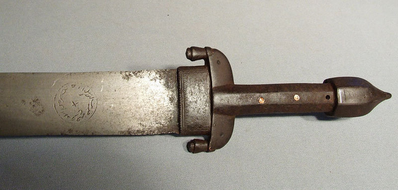

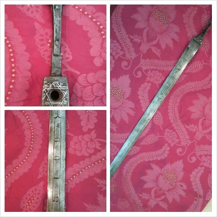

Salaams ariel, Are you referring to the sword at $1? since the SOARES inscription is not the project I am trying to translate?? Observe the Norwegian for the word Svare...which means answer respond or reply... seems like a reasonable solution except its got an S on the end but these inscriptions are rarely accurate... However, please do look at the letters on #1 and tell me what language in western Europe uses the form that is similar to A 51UU A Where the two A looking characters are quite different to European A style having a vee or tee shaped crossbar and which is almost identical to OCS. Where the letter Zayin (similar to a 5 with no top) is a Hebrew Cursive letter... Where the two letter U forms are also Hebrew. They appear as almost IJ close together... Finally if you have a better idea or your associate can help by all means lets hear it from that quarter ... Which European language/western language might this be from? I would be delighted to hear it. Regards, Ibrahiim al Balooshi.
#62 | |
Join Date: Jul 2006
Posts: 4,408
Salaams Ian, For sure the blade is European ...I would say Portuguese, Italian or German style like Papenheimer or something similar... but the script...whilst it may mean nothing is taunting since it is so close to some of the varieties like OCS and Hebrew... I just cant match a European alphabet to it... I still think Hebrew may be the answer however I am sure it will turn up some day... Actually, though it would be nice to crack the code it doesn't really matter since the essence of the idea and the peculiar circumstances of this blade and others like it into and out of the Red Sea Arena are more clearly understood with such examples albeit with much skulduggery attached. Fortunately we have uncovered this practice of hilt switching having shone the bright light (of field research) into that dark corner.. It's no great surprise since even great museums around the world are infiltrated with very clever stuff...As they say... "If only they could talk" ? Regards, Ibrahiim al Balooshi. |
#63 |
Think of the X's not as letters but as 'separators', as often happens.
Then you a continued sequence of the terms related, mispell allowed, with the latin verb ORARE (orar em portuguese, meaning to pray). |

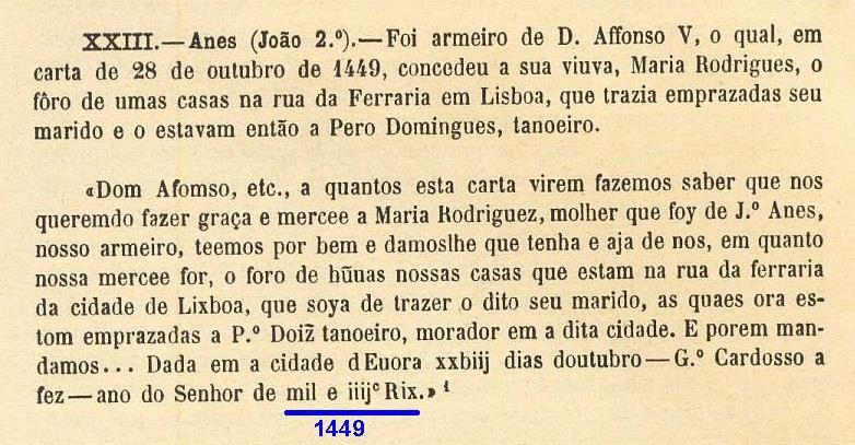

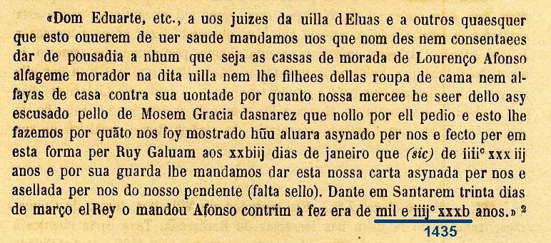

I think i should come back to lettering issue, even if i am in part correcting my previous consideration.
My idea is that, the contents of what i have learnt may be useful for collectors general knowledge. Having consulted some of my old books in Portuguese armoury (Viterbo 1907-1908), i foccused on the the way the name of Jesus Christ and document dating were practised in the XVI century, when Kings issued letters of previlege to armoury smiths. I can not type the way these were done, as current keyboards do not have such characters, as also the fonts used by Viterbo printers in 1907 may also be a bit distorced. This way i show parts in the book where Jesus Christ "initials" are mentioned, as well as a genuine print that comes in a "reformulation of the Rules of the Order of Christ" (ex-Templars), published in 1503. In both cases the letter H has a place but, above all, it is interesting to know how these symbols may appear in weapons ... and not only. Also the type of dating is most interesting as, being Roman numeration, is rather different than that used nowadays. I phoned the experts in Torre do Tombo (National Archives) and they told me that, in that early period, Roman numeration had a difftent 'convention' ... which i, for one, was not aware of. I also upload here a couple examples contained in such letters of previlege so that, if these figures show up in old (Portuguese) swords, won't be a complete surprise. . |

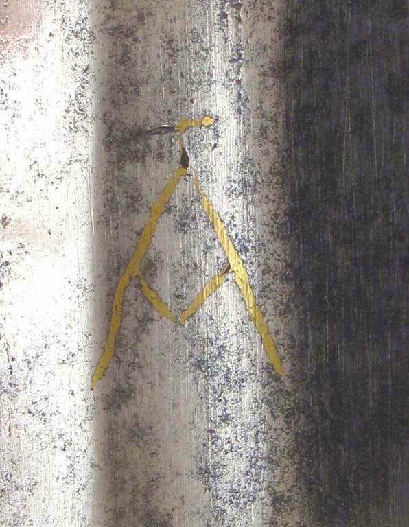

In looking at my reference thus staying on Benidictus style script I see the letters again could be interesting ..
M 51 DD M The Book of Revelation is often referred to as 51... So are we off to a reasonable set of meaningful code? In suggesting Portuguese origin of blade form at http://www.vikingsword.com/vb/showt...rtuguese+swords it could of course point to another source as actual blade manufacture; Solingen. This would suggest the religious nature of the blade marks as being in line with the reference above at http://www.academia.edu/13386318/TH...ol._10_pp._9-20 Could the DD indicate In Nomini Domini or perhaps Dominus Deus? http://www.academia.edu/13386318/TH....10_pp._9-20and the two outer M shapes be some sort of decorative introduction or brackets? This weapon is indeed interesting as an Ethnographic example whereby an old blade has been given a mixed cloak namely the Solomon star decoration and the added extension of extra tang and Pommel of an Omani Dancing Sword. The blade appears much older than the Pommel which is from a distinctive 19thC Dancing Sword style. I have shown in a previous post how this is achieved and particularly in the souk workshops of Muttrah where it is common practice. It should be noted that in the case of Omani Dancing Swords a weak point caused by vibration is about half way up the tang...Omani Dancers are made with tang and pommel and blade in one piece and it may be observed that the curved Omani Kattara is not so it has to have a tang extension and pommel added to every weapon... I digress... however, it is the tang and Pommel which brings the entire weapon to the table from the Ethnographic viewpoint. Decoration to the Pommel is superb following the Solomon style star but I have never seen it before on a Pommel. By way of a correction it may be seen that the initial and final letters are not the M letter but the old fashioned way of presenting the letter A Last edited by Ibrahiim al Balooshi; 10th November 2018 at 03:45 PM. |
#88 |
Join Date: Jul 2006
Posts: 4,408
The objective is to crack this code A 5 1 D D A Where the A is in Majescule form at both ends of the code.
There may well be a variation in how the reference is applied since 51 could refer to the book of revelations or Psalm 51 . I am looking at the A called The Majescule A which looks to belong to several alphabets and has a peculiar tail at the top left of the letter and a central support leg to the cross piece … Could this indicate a place... Augsberg possibly. I recall Michael(RIP) in one of his amazing epic threads discussing the Augsberg Halbard pole arms with the Augsberg letter in Latten style on the blade in the form term being expressed here...of a Majescule A. Could this be indicating that since A is at both ends of the script that it forms a sort of bracket around the biblical term being expressed. Thus underwriting the blessing as having been carried out at Augsberg? Thus so far I have a hypothesis as follows...Benedictus style blessings often focussed on a psalm thus I lean toward that possibility~ At Augsberg Psalm 51(or the book of Revelations) Dominus Deus At Augsberg. Last edited by Ibrahiim al Balooshi; 11th November 2018 at 09:38 AM. |

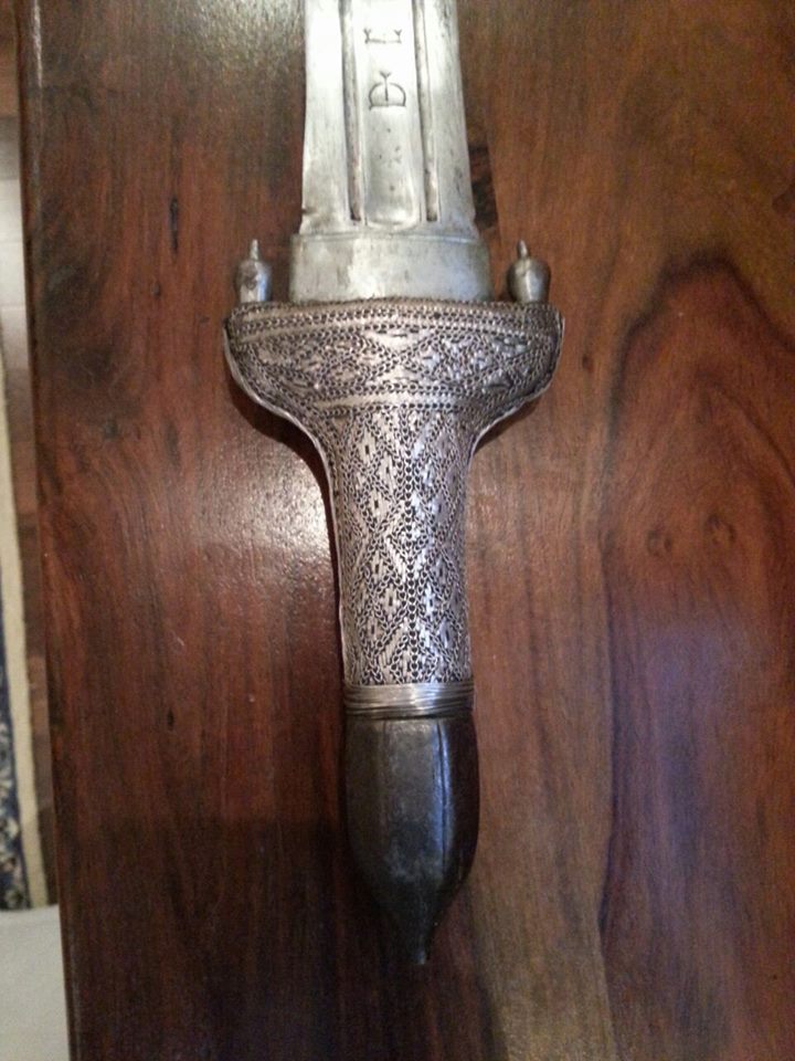

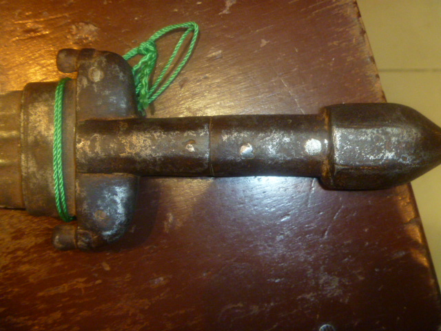

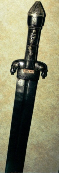

The Ethnographics of this case are huge! Not only is the hilt rare in the case of the other sword See Post 44.....but on The Odd Sword the incredible decorative form on the added pommel illustrating the Solomon style star geometry and Talismanic gridded majic square with Arabic numerals seemingly all 5s …
I have previously described figure 5 geometry as representing Hand of Fatima daughter of The Prophet (pboh) . In addition there is a tang extension although it looks like this part snapped off another sword type...The only weapon it could have come off is The Omani Dancer. The decorative devices are so rare that no one has seen such a decoration before. I also show how the fixing is made in a previous post to thread See post 23. Please note that blade and hilt and pommel are made as one with the blade on dancing swords so that in the case of a hilt and or hilt extension there would be no rivets or brazing together of hilt parts unless the hilt was a replacement of some sort... In this case two parts ...Half a hilt with two rivets shown and a complete Pommel with Tang extension in this case riveted . See pictures below. Last edited by Ibrahiim al Balooshi; 11th November 2018 at 10:21 AM. |
