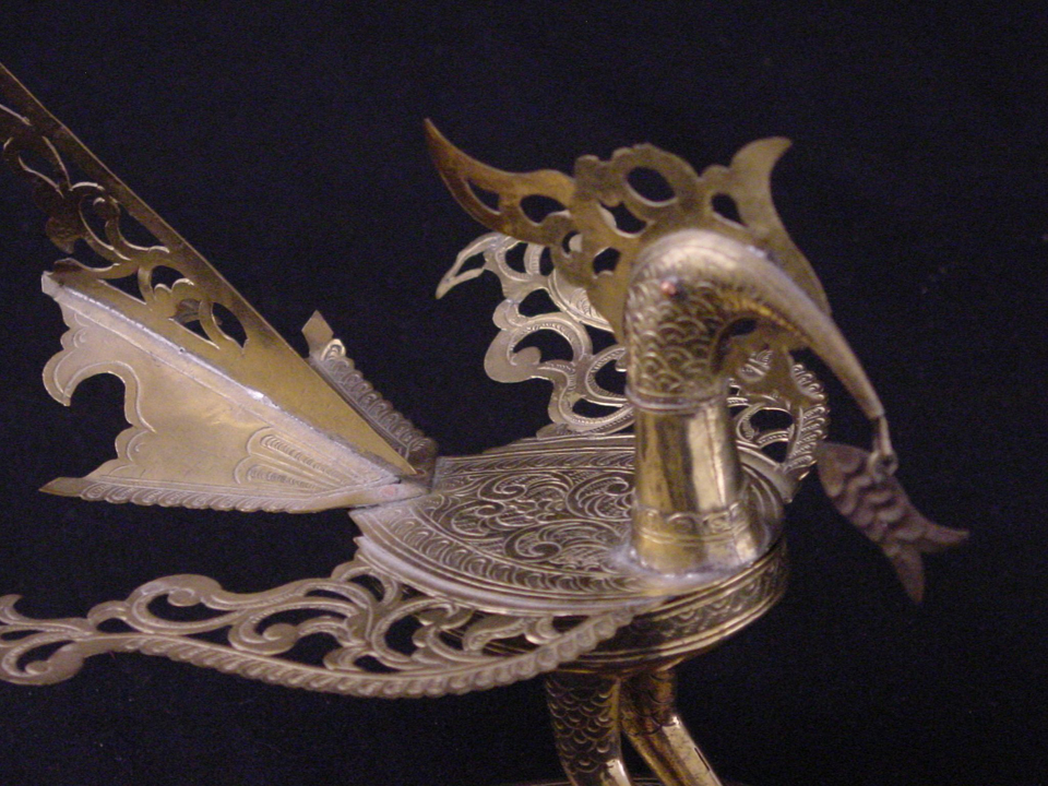

When i search for "Sarimanok hilt" i find a good number of hits lead me to these very old (10-13 century) gold hilts. I do not believe these swords were kris per se, but this does seem to help establish the symbolic use of the Sarimanok within the culture as hilts and pommels for swords going back centuries ago.

Hello David,
There seems to be no extant sources corroborating that these hilts really were attributed to the same "mythological beast" originally nor has it been established that there is any continuous line of cultural descent. Arguing that the Maranao figurines are similar enough to the gold hilts to prove any connection seems overly enthusiastic to me to say the least.
Thus, I'm far from convinced that this attribution holds any water! I'll ask Lorenz - maybe he can point us to the origin of this attribution/story...

Here is some further information about the Sarimanok gathered from the internet. There are numerous origin stories so it is difficult sorting out what the actual development of this mythological beast actually is, but it is clearly an old and important symbolic creature to the region while one can find little to nothing showing the importance of kakatau (cockatoo) to the Moro.
BTW, it does seem that most sources of information that i encounter seem to define the word "Sarimanok" as Sari-article of clothing, usually colorful and Manok-chicken or bird. So the Sairmanok is seen as a colorfully dressed bird. In some stories it seems to have its roots with the Maranao totem bird called Itotoro who has an invisible spirit twin called Inikadowa and together they act as a medium to the spirit world.
Another theory is the the Sarimanok came from the Garuda and then developed into its own creature. It does appear, however, that it did exist in Maranao lore before the arrival of the Spanish.
The FMA blog linked here cites its use as a symbol of resistance against the Spanish. Perhaps another reason why such a symbolic presence might end up being represented on a kris used to fight in such resistance.
And yes, none of this is particularly back up by any strong extant sources that Kai (and i believe all of us) would like to see. But i must remind you Cato's hypothesis that the pommel of the kris that we speak about here might represent a kakatau does not really have any more evidence behind it either.

Necro'ing this thread because I fancied putting a Maranao kris (with a vintage hilt) beside my vintage sarimanok.
It's pretty close- but in the correct-side-up orientation, not in the upside-down pommel orientation. The upside-down is incompatible because a sarimanok's tail is always upward-oriented
Well, as with most things that we encounter in SEA, there are multiple ways of interpreting just about everything. So while we can imagine just the head depicted here with the the kris in one orientation i don't think we need to dismiss the possibility of the entire body being depicted in the reverse position. And while i agree that in most old sculptural depictions of sarimanok the tail section is oriented upward i have also seen many images of sarimanok (albeit, more recent ones) where it goes downward.
Regardless of how we interpret it though, i still favour sarimanok as the bird in question. I cannot find anything in Moro or Filipino lore that makes any strong spiritual connect to the kakatua, while sarimanok has strong mythological connections in this area.
Good point- although it's very much possible to isolate the imagery based on the traditions inherent in each Moro tribe within a specific era- in my example, since it's vintage Maranao sarimanok and vintage Maranao hilt, the upturned version is the strong basis, and not the upside-down (since the down-tail emerged in modern time already). The Maranao elders and researchers that I've consulted with also never discussed the pommel in an upside-down fashion, so that says a lot.
But that doesn't mean the upside-down version ceases to be a possible symbolism- at least from other POVs. Symbolism may differ depending on the Moro tribe in question- what may be a "kakatua as sarimanok" from the Maranao POV, for example, may be a different interpretation from the Yakan POV; at the same time the Tausug have their own symbolism, etc. Additionally- Mindanao-made kakatua differs from Sulu-made kakatua in terms of design aesthetic. And it's not only the pommel- oral traditions regarding the origin of shared blades such as the kris/kalis, for example, may vary not only per tribe, but per family lineage as well.
In a nutshell, interpretation of Moro imagery is based (and modified) by the following:
1. Era (and sometimes area too)
2. Tribe
3. Family lineage
These should all be taken into context to arrive at a strong interpretation regarding symbolism/imagery.
