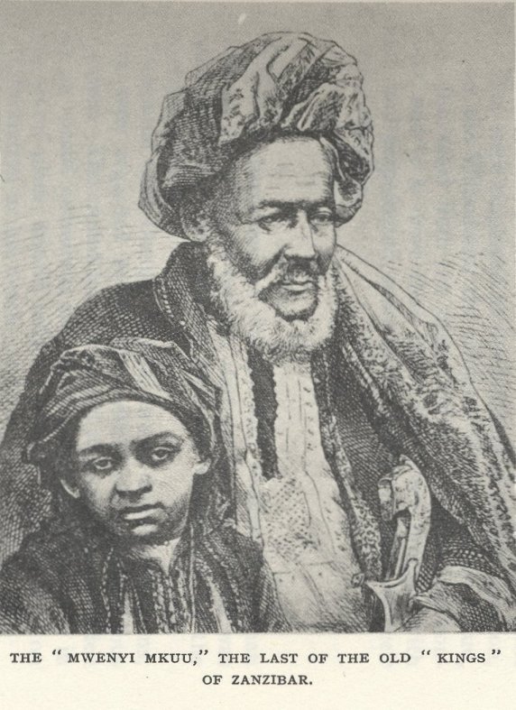

Default Mwinyi Mkuu
I found a bit more information about the Mwinyi Mkuu. It turns out that the caption of the picture was wrong - the people depicted were not from the 15th century:
"Mwinyi Mkuu, the 'Great Owner', last descendant of the Shirazi sultans who preceded the Omani Sultanate, together with his son. He died in 1865 and his son soon thereafter."
https://zanzibarhistory.org/Palatial_Zanzibar.htm
I'd be interested to know if there are any photographs of the type of nimcha he is seen with.
Excalibur2025 is offline   Reply With Quote
Old 1st June 2025, 09:10 PM   #63
Posts: 10,872
Mwinyi Mkuu (Muhammed bin Ahmed al Alawi, 1785-1865) was the last of the line of Shaziri rulers in Zanzibar.
Mkuu was a Tanzanian term for hereditary ruler.
The Shazadas were dynastic rulers of Persian origin so this dynasty appears to be from Persian settlers there c. 10th c. +
From the illustration the sword referred to has the familiar peak at the pommel seen on 'Zanzibar' versions of 'nimcha'......however the crossguard is notably that of a Persian shamshir. The shamshir was a prevalent sword form highly favored as a sword of status here much as many other places in the Dar al Islam, so not surprising.
This illustrated example however Im not sure represents a form of nimcha as much as perhaps IMO a notable combination of both Zanzibar nimcha and Persian guard.

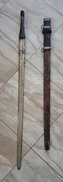

These straight blade sa'if with cylindrical open hilt seem to have evolved around 1800 from earlier swords of Omans interior (Nizwa) with quillons and other similar features. While these open hilt swords often with European broadsword blades and often embellished hilts and scabbards were again, worn as status symbols by Omani merchants into Zanzibar and the interior on trade expeditions, they were not used for fighting (Burton, 1884).
In the Busaidi dynasty in Zanzibar post 1820s, these open hilt broadswords with cylindrical hilts, were produced and used in ceremonial functions, including remarkably impressive demonstrations of swordsmanship. They were basic swords, but not used in combat. This was noted by Burton, a well known swordsman, that he could not imagine this type of sword used in combat.
Just my views of what often become highly contentious topics. Like Teodor, Ive spent 'a few years' studying these.
First example, munitions grade ceremonial sa'if

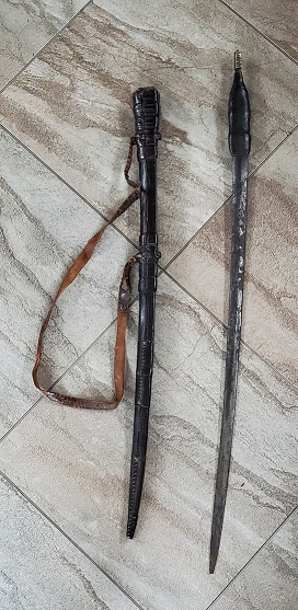

next, the 'kitara' with somewhat curved shorter blade

In post 66, on the right, this is not actually a kitara, which was an Omani hilt of cylindrical form, but with curved cavalry blade, usually German.
This example is of course Manding, this one if I recall was from Ouangdougou, Burkina Faso. In many cases curved cavalry blades in the Sahara ended up with takouba hilts, then regarded as 'alguinar'.
