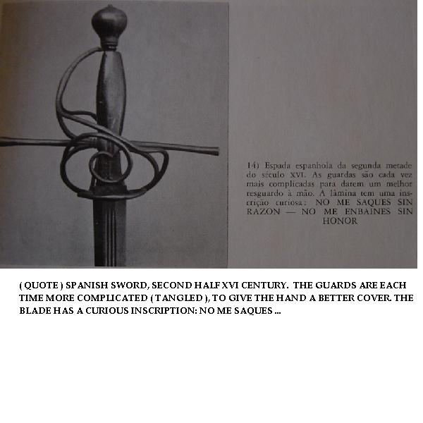

Old 9th June 2005, 07:58 PM   #31
sorry, forgot to upload.
NO, IT WAS THE SIZE.

I was just passing by and saw the current discussion...
Very interesting the arscives 1991 site. Lots of interesting swords there, although some miscatalogation too. For example number 5 is not African but a very specific portuguese form from late XVth early XVIth. Some "Portuguese made" I find discutible on the other hand.
But what brought me here. I am also intrigued by the motto "no me embaines..." and would be very interesting to find a XVI century sword with it. However I consider the example provided to be a remounting with a newer (Late XVII to early XVIIIth , possibly genoese) blade.
About Portuguese patriotic mottoes, they appear for example even in official Spanish military models (like what later would be the called 1728 model, an example at Poldi-Pezzoli, Milan), and cannot give clues about nationalities.

when the spanish conquistadores founded bogota in 1538, their leader gonzalo jimenez de quesada was using a toledo sword with the motto no me saques sin razon ... a code of the followers of el cid ( quoting jose maria vergara y vergara in fundacion de bogota ).
el cid lived on 1043-1099. if this were a true story, contradicts the prior assumption that the motto was originated on the templars oath, as this order was founded later.
the missing link prevails

I'm not a specialist on templars, but I would doubt any connection with the motto. Very similar motto in different languages exist in every caucasian nation - circassians, chechens etc. , only instead of "honor" they have "blood".
On the other hand, I seriously doubt that real templars (I don't mean Christian clubs, that put "templars" in their names) would use such an oath. Obedience, humility (they had to give up their pocessions, did not they ?) and faith would be far more appropriate virtues for a templar, rather than honor.
Honor was always associated with a relatively secular world - you can't imagine the Pope "defending his honor" by slashing someone in half ?

I think the reason of not finding the "no me envaines" motto earlier than late XVII is both technical and cultural. Technical because the use of cheap acid etching did not become spread before that (OK we find it in Royal swords in XIII century but that is not common). It was usual than the letters were carved or punched one by one, and texts are shorter, rarely more than 10 characters, quite often ininteligible acrostics, and here comes the cultural point, taking the effort to do them, they prefer religious to boastful phrases, at less while swords are more a killing tool than a fashion toy.
Still it is perfectly possible that an example from XVIth or earlier exists, but it will be far from common. When did that Vargas wrote? I would trust him if contemporary to the facts, but not later (the least if he is from XIXth. c). For example Colombians keep as a sacred relic the so called "Sword of Bolivar", suposed to be used in their independance from Spain, 1815-1821, what it is actually a Toledo model from about 1835.
Now I think of it I have a boast rapier blade from around 1610, it has written by punching inside the fuller: "NOMENE TENGO", what possibly means "no me ne attretengo". In English from an Italian dialect "I do not care", and it was adopted as business mark from a Bergamo swordsmith. I will not be surprised if the "no me envaine motto" appeared first in a mutilated way or as initials:
N.M.S.S.R-N.M.E.S.H
