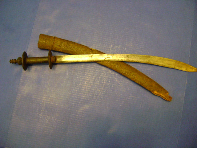

I guess this begs the question: does the hilt style and lack of cho make this piece in question other than a kukri?

The handle construction seems to be of Bukharan style no? (http://www.vikingsword.com/vb/showthread.php?t=14093)

I don't know......it could be a little lower south, like say north India? The blade style I have seen from there. The handle - reminds me somewhat like a khanjarli from the side view (as I now think of it).......

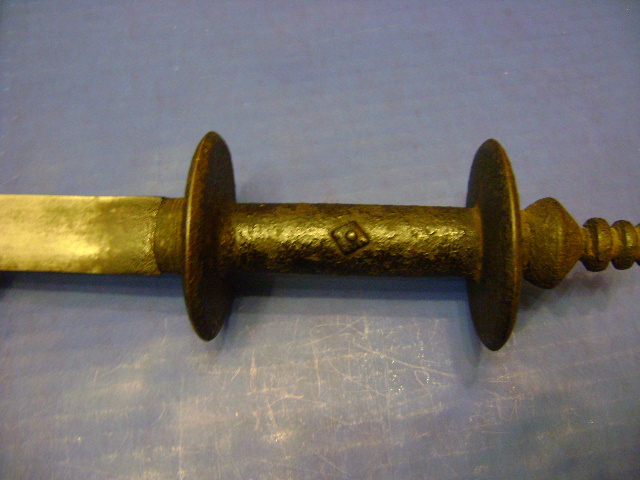

Personally I see the handle as the hybrid aspect. The grip ring is that of one present on a Kukri and in about the same place and the protruding ears is more like the longer Afghan/Sindh swords but the presence of the grip strap is in line with North west India, Bukhara and other regions further removed.

I was intrigued by the argument about definitions: kukri or sosun pata. AFAIK, kukri ( or proto-kukri) was brought to Nepal by the Rajputs who had sosun patas galore.
Both are just Kopis-type blades. Perhaps, kukri in its classical form was just adapted to the landscape and the size of the inhabitants?
Here is something I wanted to ask your question about: would you define it as a kukri or as sosun pata? It ain't no Afghanistan or India, for sure:-)
Old 7th December 2013, 04:51 PM   #36
spiral
Posts: 1,712
Good one Ariel!
Id guess Its a worn out kora, given a second life.
To me the splayed hilt kukri grip ring looks more Chillanum style than kukri style.
But whats in a definition, some kukris don't have a grip ring, some don't kaudi. Generaly I think a full length T spine means its not a kukri, but that's just my opinion. I think a Hindu could want a kaudi on any weapon its both practical & symbolic.
Some kukri have kora or khanda style grips.
These hybridised mix & match designs are great but truly defining them will probably come down to personal opinion, when they have mixed features.
Spiral
Old 7th December 2013, 07:34 PM   #37
Please pay attention: it has a VERY old scabbard that fits the current blade like a glove. How would Kora fit there?
What prompted you to see re-worked Kora? Specifics, please. We see tons of Kukris with " Kora" handles; are they all, in your opinion, reworked Koras?
Where did you see Chillanum features?
It does NOT have a T-spine.
