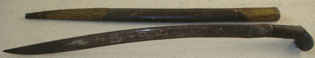

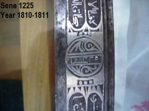

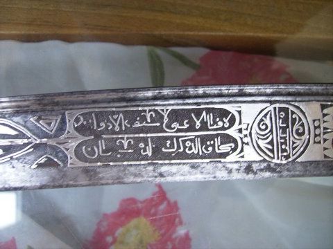

Zifir, Dom and others who can read Arabic, can you please help with the inscriptions on this yataghan?
Thank you very much in advance,
Teodor

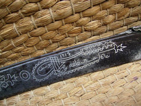

Old 18th January 2009, 08:58 PM   #33
TVV
TVV's Avatar
Location: Bay Area

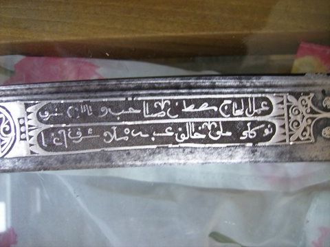

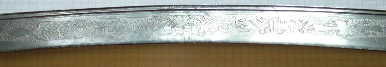

Posts: 1,770

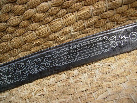

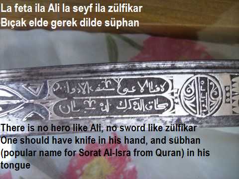

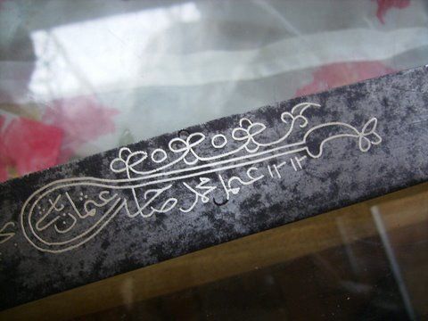

Here is another yataghan with nice inscitpions from Bulgaria - can anyone help translate them?
Many thanks in advance,
Teodor

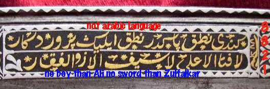

Old 21st January 2009, 01:52 PM   #34
Dom
Dom's Avatar
Join Date: Oct 2005
Posts: 1,142
Hi Teo
except a date, 1288 (1871 gregorian calendar)
and a sentence; la fatha ela Ali, la Saïf ela Zulfakar
no boy than Ali, no sword than Zulfakar
not possibilty to translate the others inscriptions, from Arab to an another language,
because, it's what ever you want excepted arabic language
à +
Dom

Old 21st January 2009, 06:16 PM   #35
TVV
TVV's Avatar
Location: Bay Area
Posts: 1,770
Thank you very much Dom,
I guess the top row is most likely in Turkish.
Teodor

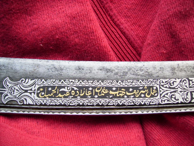

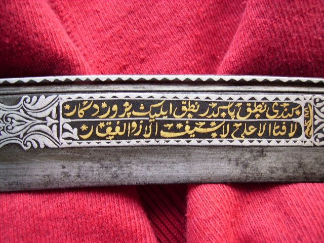

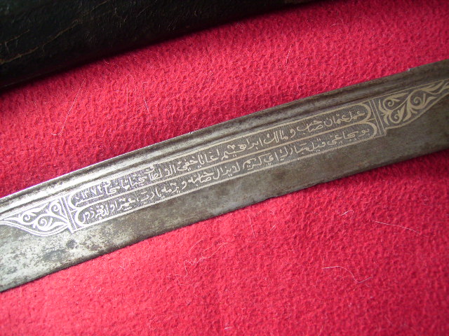

Old 22nd January 2009, 06:41 PM   #36
Zifir
Zifir's Avatar
Location: Istanbul

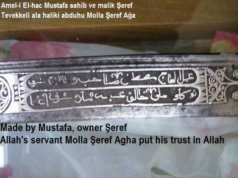

Posts: 228

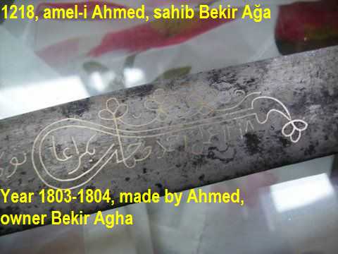

Hi,
The first one is:
Amel-i Şerif Sahib Osman Ağazade Abdülcemil
Work of Şerif, Owner Abdülcemil, son of Osman Agha
The first line of the second script was difficult to give meaning for me although there is no difficulty in reading it.
Kendi nutk-ı pakdır nutk eyleyen Perverdegar
(My somehow nonsensical translation is: He himself is a well spoken word since it is Allah who make him speak. Some Sufi references here that I am not familiar)
that's best I can
Zifir is offline   Reply With Quote
Old 22nd January 2009, 07:19 PM   #37
TVV
TVV's Avatar
Location: Bay Area
Posts: 1,770
Zifir,
Thank you very much, I really appreciate your translation.
The line with the Sufi reference is especially intriguing, and since almost all inscriptions had an important, almost talismanic meaning to the original owners of these blades, I wonder how it should be interpreted.
Teodor

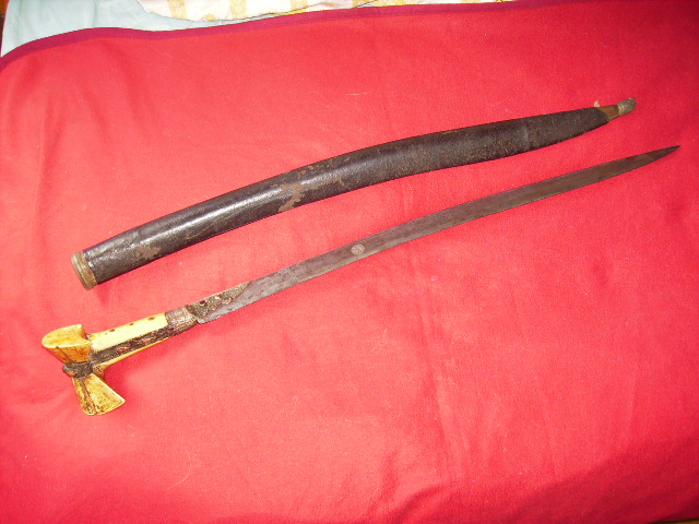

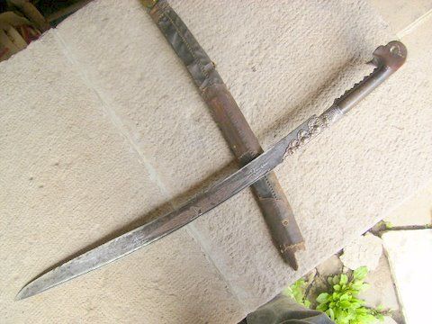

Old 23rd April 2011, 06:56 PM   #38
TVV
TVV's Avatar
Location: Bay Area

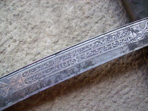

Posts: 1,770

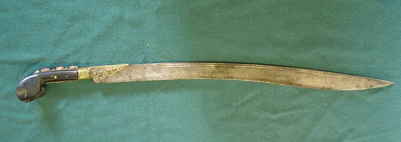

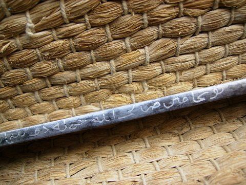

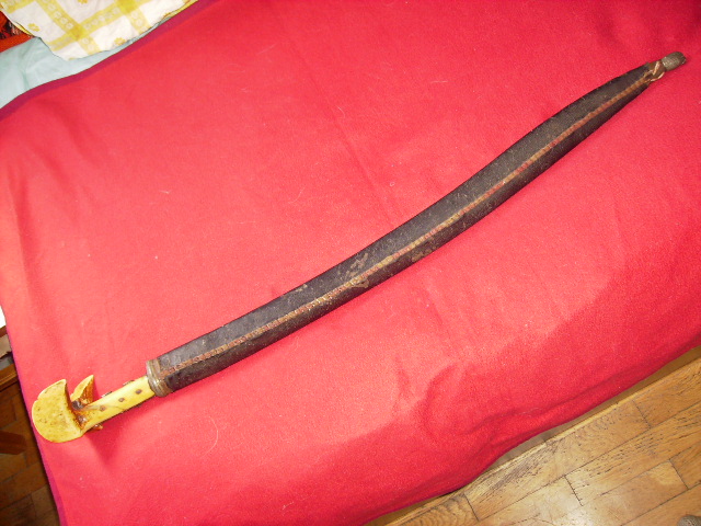

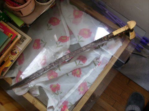

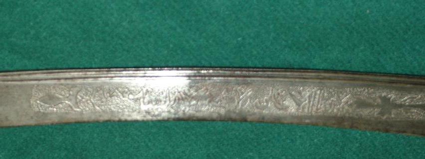

Here is a yataghan recently found in Bulgaria - 96 cm long, which is not common, with a Balkan hilt and likely an Anatolian blade, with interesting inscriptions in 3 circles on one side. Can someone translate the inscriptions? I think I see a date 1260, or 1844 in Gregorian.
Thank you very much!
Teodor
Old 24th April 2011, 12:47 AM   #39
Dom
Dom's Avatar
Join Date: Oct 2005
Posts: 1,142
Hi Teodor
quality of pic ..
- too far, please use "focus" fonction
- about the date, I agree with you 1260 H. (Persian writting)
à +
Dom
Old 25th April 2011, 04:51 PM   #40
TVV
TVV's Avatar
Location: Bay Area
Posts: 1,770
Originally Posted by Dom
Hi Teodor
quality of pic ..
à +
Dom
Dom,
Thank you for the quick response. The yataghan is located half the world away from me and neither it, nor the pictures are mine - I posted it here at the request of its owner. I will see what I can do.
Teodor
Old 27th April 2011, 06:33 AM   #41
TVV
TVV's Avatar
Location: Bay Area
Posts: 1,770

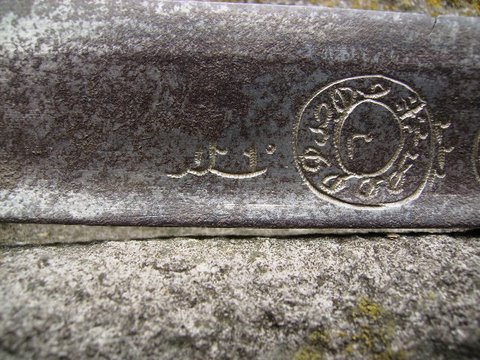

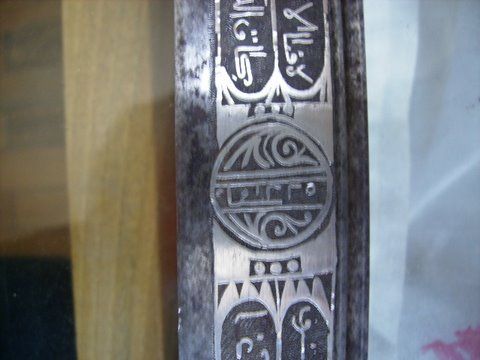

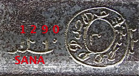

Ok, some more pictures of the inscriptions on this yataghan. The more I look into these, the less sure I am they are legible, but I would appreciate if anyone gives it a try.
Again, thank you in advance.
Teodor

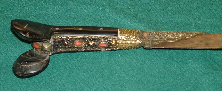

Old 28th April 2011, 02:14 AM   #42

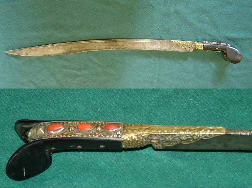

Teodor,
I really enjoyed this thread . Thank you and the rest of the gang for posting them.
Regarding yours with the rhino handle.
There is a cavity between the cheeks. I do not think I have seen such a completely "disassembled" handle before. Anybody knows whether this space in yataghans in general was filled with some kind of putty or was the handle hollow inside and kept by rivets only? Of course, they all had some kind of metal ribbon around the entire handle.
Old 28th April 2011, 02:31 AM   #43
Gavin Nugent
Gavin Nugent's Avatar
Posts: 2,818
Originally Posted by ariel
Teodor,
I have had two Yats with portions of the grip strap missing and neither of them were filled, just the rivets holding the slabs against the strapping....the kilij seen here;
http://www.vikingsword.com/vb/showthread.php?t=13639
Also has a grip strap that requires attaching to the top and bottom near the guard and it too is not filled in completely, just appears that what has oozed past the tang during original application has fallen in the gap....perhaps a standard Turkish method of manufacture.
Old 28th April 2011, 05:55 AM   #44
TVV
TVV's Avatar
Location: Bay Area
Posts: 1,770
Thank you Ariel. I believe Gav is correct - usual hilt construction on yataghans, including those with metal hilts is that the scales are not glued to the tang, but are held by rivets only, and this hollow space is covered by the metal band in the middle of the hilt. There are probably exceptions, but the majority of the damaged hilts I have seen follow this method of attachment.
My guess is that this was done to preserve scarce hilt material, such as walrus ivory, and to create an illusion that the scales were carved out of a giant piece of ivory or horn.
Teodor

Hi Teodor
Tks for pic's, they are exploitables, and at first view, could be possible to get something, at least ... some
just need few time, we'll be absent until May 2nd, be patient and optimistic
à +
Dom
just a taste ....
SANA 1290 either YEAR 1873
Cheers

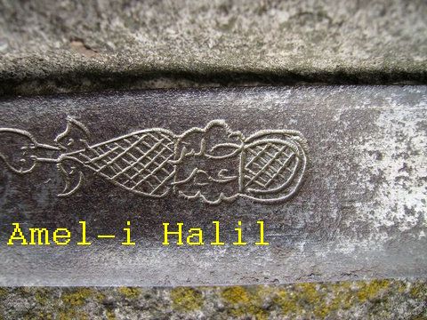

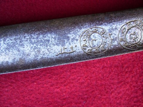

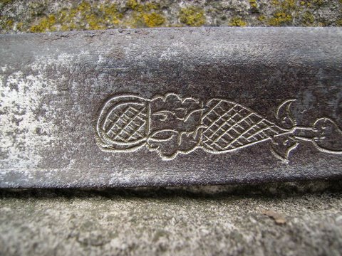

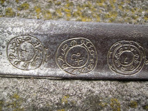

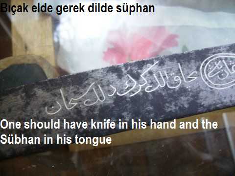

Old 4th May 2011, 05:30 PM   #47
Zifir
Zifir's Avatar
Location: Istanbul
Posts: 228

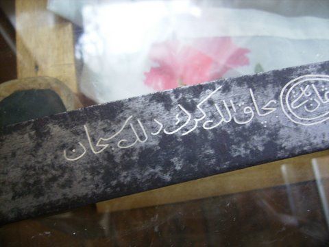

Hi,
I could only read this part, but I am very curious about the circles. This is the first time I see such circles on a yatağan. Although I cannot read it, there are arabic letters and symbols inside the circles which I am not very familiar. Also if I remember correctly, I have seen the symbol, in which amel-i Halil is written, in elsewhere and somebody claimed it to be a Bektashi symbol.
Old 4th May 2011, 07:31 PM   #48
TVV
TVV's Avatar
Location: Bay Area
Posts: 1,770
Thank you very much Zifir,
This is very helpful. I have also seen the symbol one other yataghan blades, even though it is not a very common one. I did not know of its significance by now though. I gues if it is indeed a Bektashi symbol, this would simply mean that the owner or the maker (Halil) has some sort of a Janissary connection.
Hopefully, we will be able to learn more about the circles at some point.
Teodor

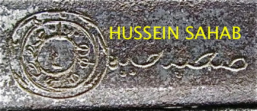

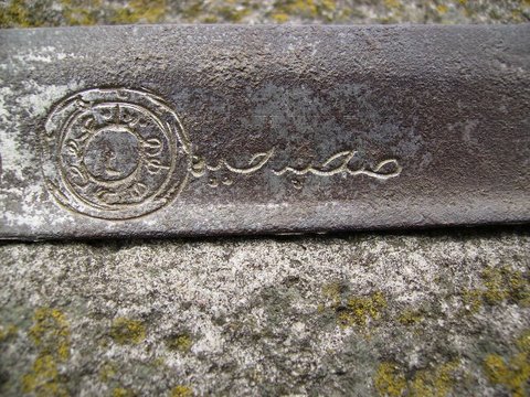

Old 4th May 2011, 10:51 PM   #49
Dom
Dom's Avatar
Join Date: Oct 2005
Posts: 1,142
hi
as well as Zifir, we cannot read it, the arabic letters and symbols inside the circles.
precision might be bring:
- AMEL means => the blacksmith
- SAHAB (SAHEB) means => the owner
on the pic jointed, has been translated
HUSSAIN SAHAB either OWNER HUSSAIN
very sorry to don't be more efficient
à +
Dom
Old 5th May 2011, 01:27 AM   #50
TVV
TVV's Avatar
Location: Bay Area
Posts: 1,770
Thank you Dom, I appreciate it.
The circles are quite unique, but maybe they exist on another blade, in a more legible form. If such a blade surfaces at some point in the future, it may help with the translation of this one. Or at least this is all we can hope for.
Thanks again Dom and Zifir for your help.
Teodor

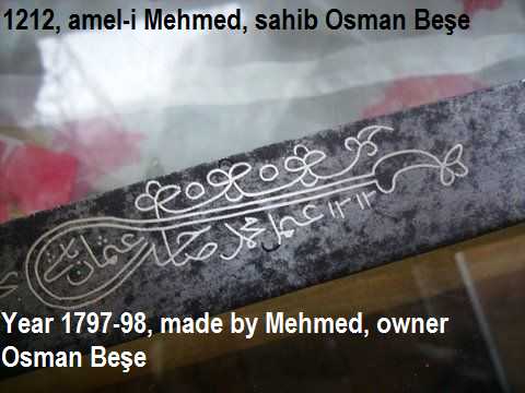

Old 26th January 2012, 06:06 PM   #51
TVV
TVV's Avatar
Location: Bay Area
Posts: 1,770

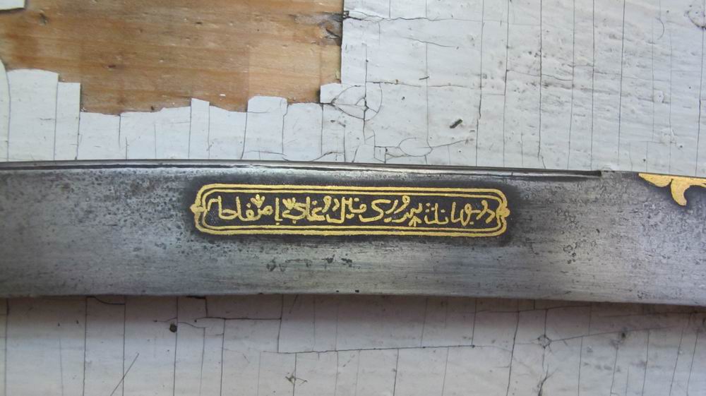

My Bulgarian friend, who collects yataghans, has asked me to post three of his latest acquisitions here with the hope of getting the blade inscriptions translated.
Teodor

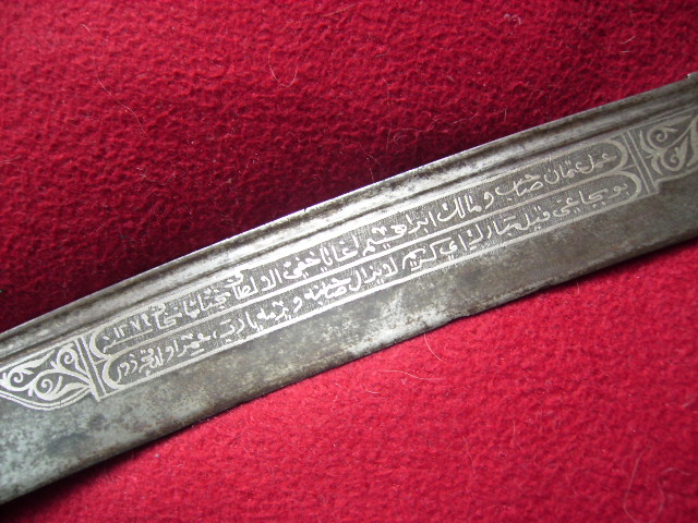

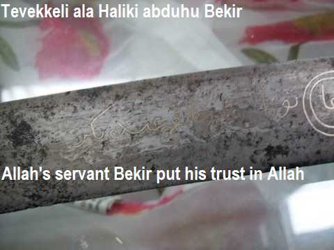

Old 28th January 2012, 04:08 PM   #52
Zifir
Zifir's Avatar
Location: Istanbul
Posts: 228
Hi Teodor,
Pretty standard inscriptions, accompanied by my haphazard translations

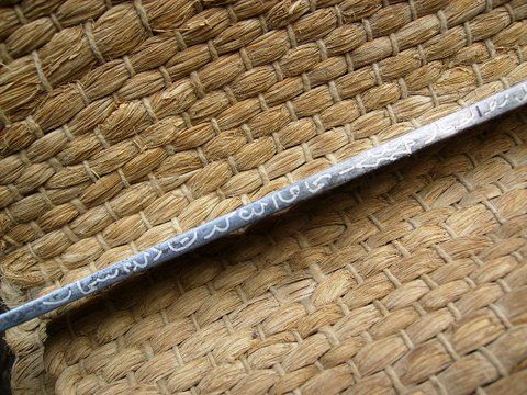

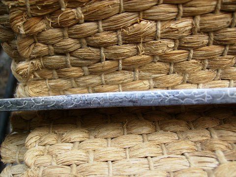

Old 11th October 2012, 06:20 AM   #60
TVV
TVV's Avatar
Location: Bay Area
Posts: 1,770

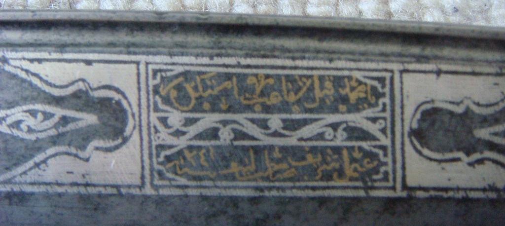

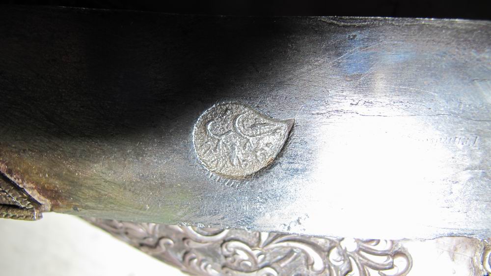

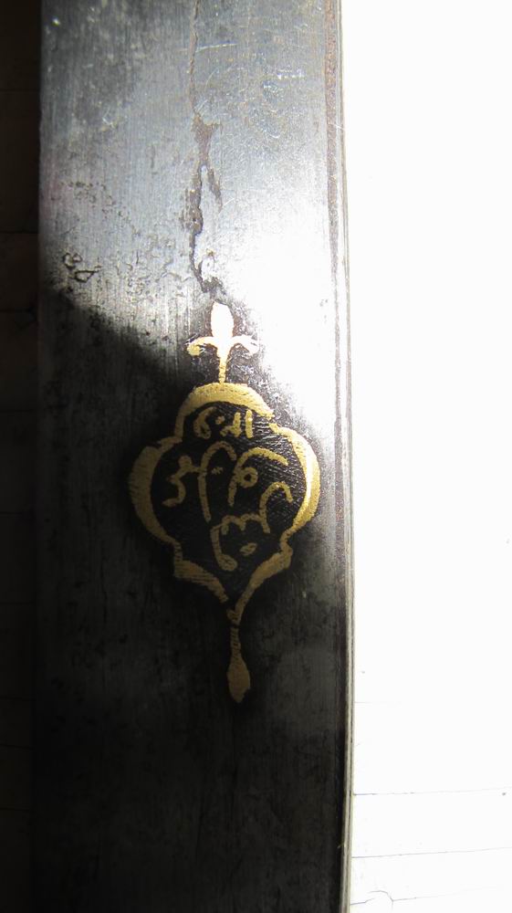

Here are three photos of inscriptions and a maker's mark on yataghan blades. I received them from a friend in Bulgaria with a plea for translation. I apologize for not having photos of the entire yataghans: I am trying to obtain those shots. However, in light of contributing so many yataghans to this forum, I hope that I may be granted an exception in this case from our gracious translators.
As always, all help in translating these inscriptions and marks is greatly appreciated.
Thank you,
Teodor
