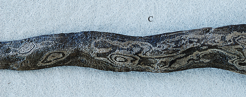

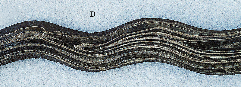

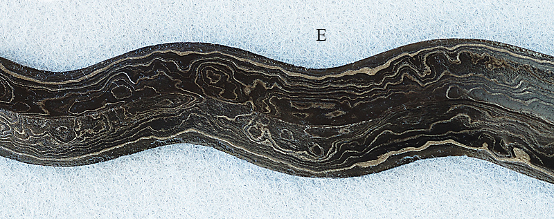

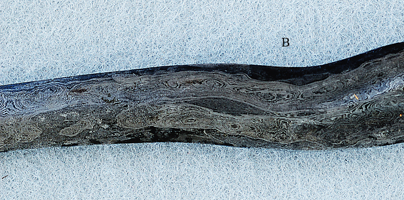

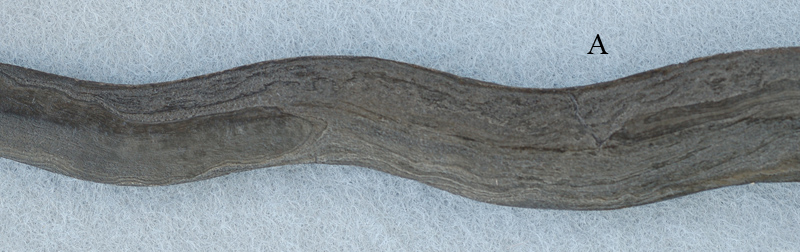

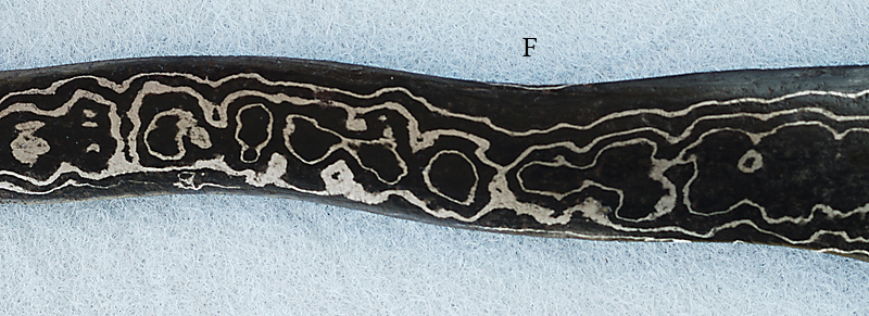

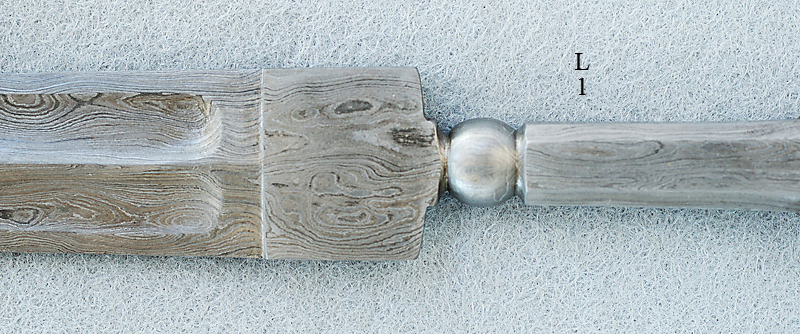

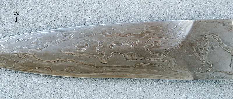

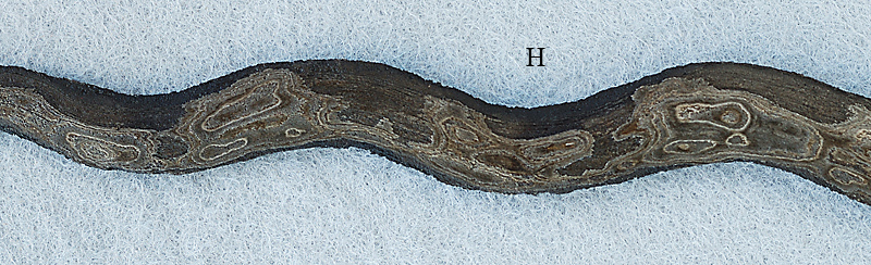

A.--- An old Madura blade, arsenic trioxide, stained about 1965.
B.--- An old Sumatra blade, stained in about 1960 with sulphur, salt, rice water.
C.--- An old Bali blade, arsenic trioxide, stained about 1962; this blade was extremely corroded and had deteriorated badly prior to the clean and stain.
D.--- An old South Sumatra blade, arsenic trioxide, stained about 1974.
E.--- An old Surakarta blade, arsenic trioxide, stained about 1978; this blade was purchased from an English dealer and is attributed to Wirasukadgo.
F.--- An old Bali/Lombok blade, arsenic trioxide, stained about 1970.

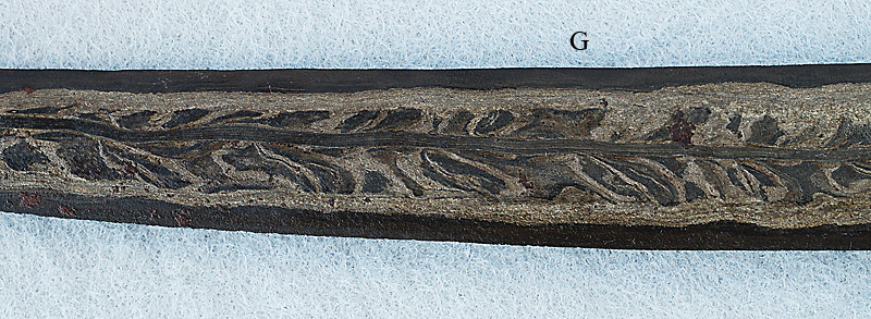

G.--- An old Peninsular Bugis blade, stained with warangan in Jogjakarta in 1972 by Romo Murdo; this was a "quick fix" stain, not a proper clean and stain.

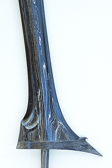

H.--- An old Jawa blade (Senopaten), stained with warangan in Jogjakarta in 1978; this is a standard commercial stain.

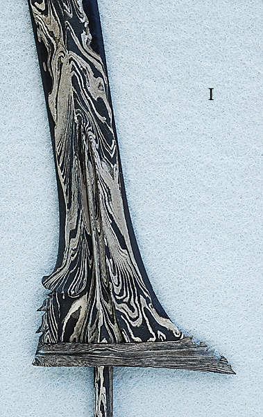

I.--- A keris made by Empu Suparman in 1982 and stained by him using warangan.

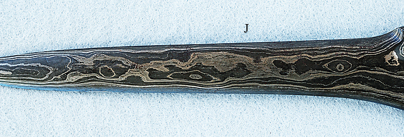

J.--- My first attempt at pamor in a keris blade, made in 1980 before I was taught by Pak Parman, this stain was done with arsenic trioxide.
K.--- My first attempt at pamor in a dagger blade, made in 1980, this blade is the same construction as a keris, with a steel core and pamor of nickel and iron on its faces, the blade has not been stained but only etched with dilute hydrochloric acid.
K1.--- Close up of K.

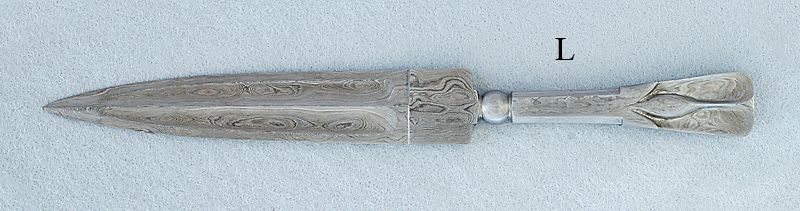

L.--- A dagger of damascus which I made in about 1985, this is made of wrought iron and 01 steel, it was etched with hydrochloric acid, stained with ferric chloride, then washed with white wine vinegar.
L1.--- Close up of L1.

I had 14 pics but could only upload 12 at a time, so here are the las two:-

Thank you so much for this presentation Alan.
Just a bit off topic because it is not a keris, but i really like the design of this last blade you posted. Very eloquent.
Old 16th August 2009, 05:59 AM   #51
Posts: 7,230
Thanks David. It is one of the better things I've done.
I'm not so sure that this is off-topic, because what we're talking about is blade staining, and I believe that this encompasses more than just keris and arsenic. I've stained many different types of materials, and I've used many different substances to achieve the stains. The wider one's experience the more that experience can contribute towards the achievement of excellence in just one medium.
What I've tried to do with these pics is to show some of the variations that can occur.

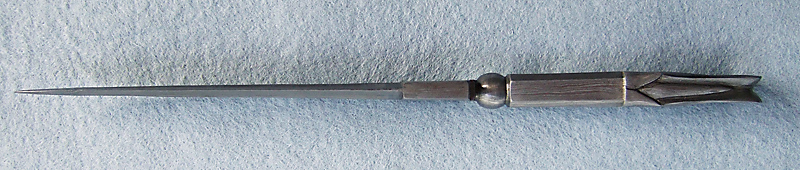

Here is a side view of that damascus dagger.
