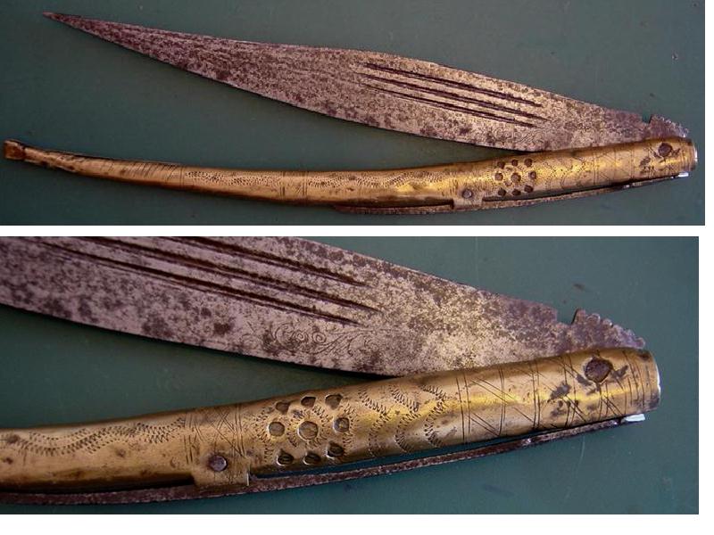

Hi everyone, I am very new to this website and the use of forums, but am not a new comer with collecting edged weapons.
I am hoping someone out there can help me put together some very hard to read script that is found on my pride and joy, being Australian, Spanish in not a language I grew up with.
With the use of internet tranlators I have worked out the first of the three lines found on the blade and only partially deciphered the other two lines.
The first line reads "Si esta vibora te pica no hay remedio en la botica", "If this viper itches to you there is no remedy in the pharmacy".....too right I say, wouldn't want this fella drawn in anger against me.
The second line reads "___ defensora de mi dueno bas ta el _____ ______", " ___ defender of my owner you go to ______ ______".
The third line is " O le ____ __ Grava __ Labra" ....something like "it burdens working to him" with a few words missing.
Those of you in the know, may know of this inscription or be able to fill in the blanks if fluent in Spanish.

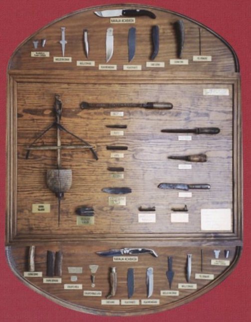

With regards to the framed collection and Chris's reply,

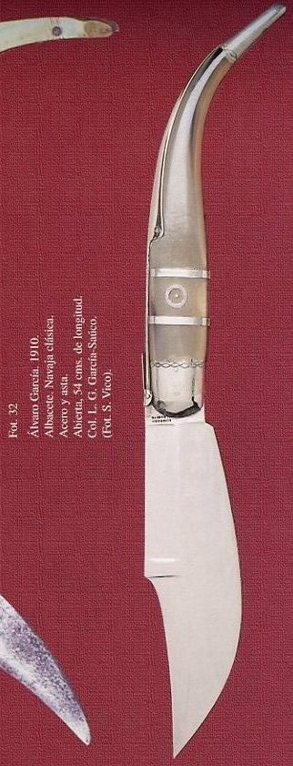

The top one is definitely Spanish from what Chris has pointed out, it has a square locking hole with a single notch, amazing craftsmanship when examined closely. The piecing together of this piece is absolutely precision engineering.
The Alvero Garcia blade appears to be 20th century with the further input from Chris as the blade is super smooth, but it is heavily etched and I can see light file marks on the non etched edges??????
The Navaja without a locking mechanism is identical in everyway to this ebay link below. This may help further identify it. The little cresent for the thumb nail is present as is the symbol shown above the initials, though it lacks a couple of those strokes either side and the circle in the middle is clearer on mine. I have heard of this referred to as a "sun burst crown". Every engraving on the end caps are identical too.

I am still not 100% convinced about the Toledo blade being very modern, there is nothing stamped about this navaja(to my eyes), it is all, what I believe, engraved, etched or chiselled, the lines are so crisp and delicate in many places. I do remember Laura from knifecollection some years ago put this around circa 1900-1910 as she too was watching the auction at the time and wanted to add it to her stock.
OK. we here a obviously Spanish style non functional souvenir grade navaja manufactured some time ago, but we don't know when. Apart from the ubiquitous "TOLEDO" there is nothing else to identify it.
In such cases we can only do the following:
a) Carefully examine the piece and try and detect the technology used in its manufacture, such as blanking of the blade, the mode of construction as for example cast or the earlier riveted sheet handle frame, indications of machining and die forgings, mechanical polishing, electroplating, type of engraving used, materials employed and any other evidence of advanced manufacturing. All this is then to be compared with periods of known cutlery output from Spain.
b) Try to estimate the probable age of the piece from condition and type of paint used to fill up the engraving. A powerful clue is whether the gold effect was obtained with powdered pigment paint or a thin coat of translucent "gold" laquer applied over a silvery electro plated surface. The way to detect this is to examine the area in question under a low power microscope (20x-50x) and with a scalpel gently scratch away at the surface. If this technology was used, then after removal of the coat of lacquer a shiny silver surface will be revealed
Now, we do know that
a) Up to around 60s, cutlery in Spain was a cottage industry, using only the most rudimentary tools and basic materials. After that, it modernized;
b) There was flood of cheap souvenir daggers, and swords in the 60s and 70s with cast metal handles and plated blades using the above "faux" gold plating, all etch engraved and painted with enamels. As far as I can ascertain, the sequence of paint deposition was as follows:
1st coat: Silvery electro plating
2nd coat: Translucent "gold"lacquer
3d coat : Colored enamel, the "gold" lacquer serving as an undercoat/primer.
I have not seen any earlier Spanish decorative cutlery that utilized this "faux" gold finish.
c) We also do know that cast metal navaja handles became widespread sometime after around 1960. This how most of the modern imitation junk navajas are made. The only way to get a "real" navaja, built by traditional means (Spanish "artesanal") these days is to have one custom made. If still producing, then the navajas of Exposito are exempted from these remarks.
Hope this helps
Cheers
Chris

Hi, I am very new to this website and the use of forums, but am not new to collecting edged weapons.
I am hoping someone out there can help me put together some very hard to read script that is found on my pride and joy, being Australian, Spanish in not a language I grew up with and things get lost in the translation.
I also remember reading in other forum discussions about the Navaja and someone stating how hard some were to open. I must say this one being my fav in my collection is extremely easy to open, just a firm grip in the middle, useing my finger tips to just push the blade free of the horn handle and a flick of the wrist and hey fresto, a 16inch blade ratchets forth. I know why many call these the predesessor to the automatic flick knives we know of today.
Many thanks

Why don't you give us a photo of the inscription and the navaja?

Thanks Chris, and sorry to everyone for a repedative blog, seems I added it three times....newbie to this.
I have uploaded a few photos of the large navaja and will add more of my navajas when time permits. I have also added an image of a framed collection I put together and various images I have on file of my Toledo navaja in the frame.
In the framed collection, all navaja are approx 16 inches long.

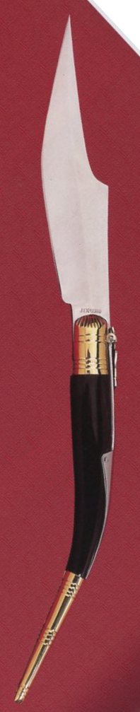

The fifth is a mid-late 20th century navaja with imitation mother of pearl grips.
With regards to the 6th one, a Toledo navaja, I beleive it to be late 1800s very early 1900s, though I one chap here in Australia said it to be a very modern tourist item...anyone have any take on these opinions. It has outstanding deep etched or chisled releif all over the blade and handle, it of an all metal construction and has Spanish inscriptions on both sides "Do not draw me without reason or store me without honour" and on the reverse side it says "Never a dent shall I suffer as Toledo was my Cradle" It has been gilded, blued and highly polished all over as seen in the images.

I hope you don't mind me adding this, but this recently finished on eBay. I did bid ....but was not confident enough to bid too much....and (possibly) missed out on a bargain ?
I am not certain that this would be regarded as a Navaja as it is similar to knives described as 'Roman folders'. Whichever it is ...it is large. Blade approx. 25cms Opened approx. 53 cms
Any ideas
http://cgi.ebay.co.uk/antique-foldin...QQcmdZViewItem

Old 2nd November 2007, 06:55 PM   #18
Hi David
I am not so good ( or don't know enough ) at evaluating things at distance.
Chris could tell you a lot more about this piece.
But i don't think you missed something valuable. You might have missed the bargain, money wise, but i don't think you missed a good collectible item.
To my ignorant eyes, the blade looks funny. The lock, besides not being working, looks itself locked . It looks as some extra device was added to it. But this must be because i never saw such pattern.
Again, Chris could help much further.
All the best
Fernando
