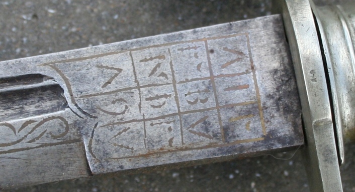

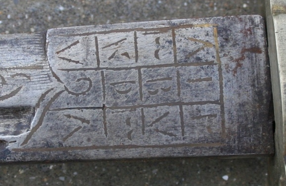

Question SYMBOLS ON A PARANG NABUR
This thread got me thinking about a Parang Nabur which has been hiding in a chest of drawers for the last 20 years ( Who has a house large enough to display everything ? ). I have just dug it out and photographed the symbols. Anyone seen these before ?

These are quite common on Malay weapons from south Borneo.
Yours is related to the Islamic magic square, wafq, where the numeric value of the arabic letters in all directions are the same.
This value represents a "hidden" name. Like the most common one is the Buduh (3 x 3) also known as Adam's seal.
The 4 x 4 is Plato's seal etc...
There is a lot of symbolism within the squares and by itself it also has baraka, "the Force".
Old 17th April 2008, 08:39 PM   #42
Posts: 10,851
Nicely worded and concise comments on this Teodor. While I had known of the buduh, its concept was a bit unclear. Thank you for the info.

Royston
Join Date: Mar 2008
Location: Poole England
Posts: 445
Default Symbols
Thanks for the information VVV. I now have some more reaserch to do.
Royston
