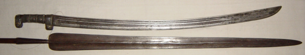

Ariel, have you practised any armed martial "arts" ? how many spears have you handled? The spear is the primary weapon. It can be used in a circular motion. I would agree that in a melee of a broken line the sword would have some advantages but you are still in danger of getting stuck by a spear. I think it is the combination of weapons that works best. Rather you than me, I would prefer to be one of the rabble rousers

If this spear was not African I am sure it would be considered a noble weapon equal even superior to many swords and worth a lot more as a collectors thing .
Old 19th October 2006, 08:28 PM   #35
I see your point: even as recently as 18-19th century, the Brits maintained the superiority of bayoneted rifle over a sword. They had ample empiric evidence from their many Indian wars.
As part of my (long, long ago.....) fencing training, we had rather extensive bayonet practice; that is the extent of my knowledge. Since there were no official bayo competitions, we did not like it very much and preferred real fencing. Spear and bayo have a lot of advantages over a sword: distance, force, stocks with solid buttplates are handy etc... On the other hand, what is gained in distance, is lost in speed. But, Tim, to each his own and, since neither spear nor sword is a practical weapon these days, we can have this argument to our heart's delight over a beer or two, rather than on the battlefield.
And, buddy, if you want to be a real rabble rouser, get yourself a pitchfork!
