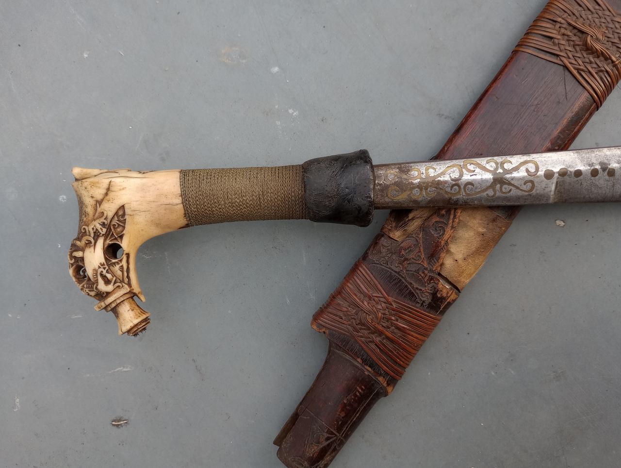

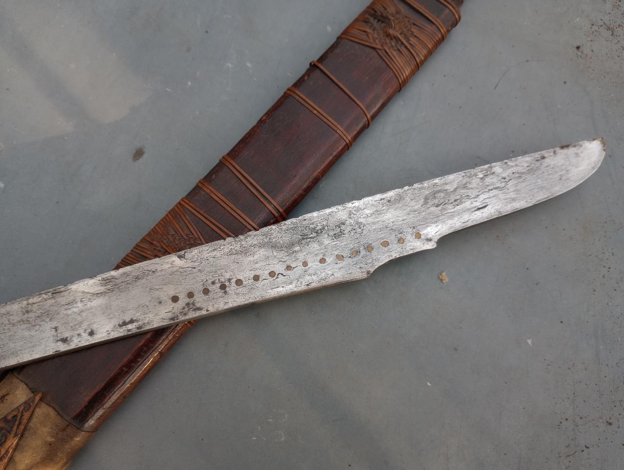

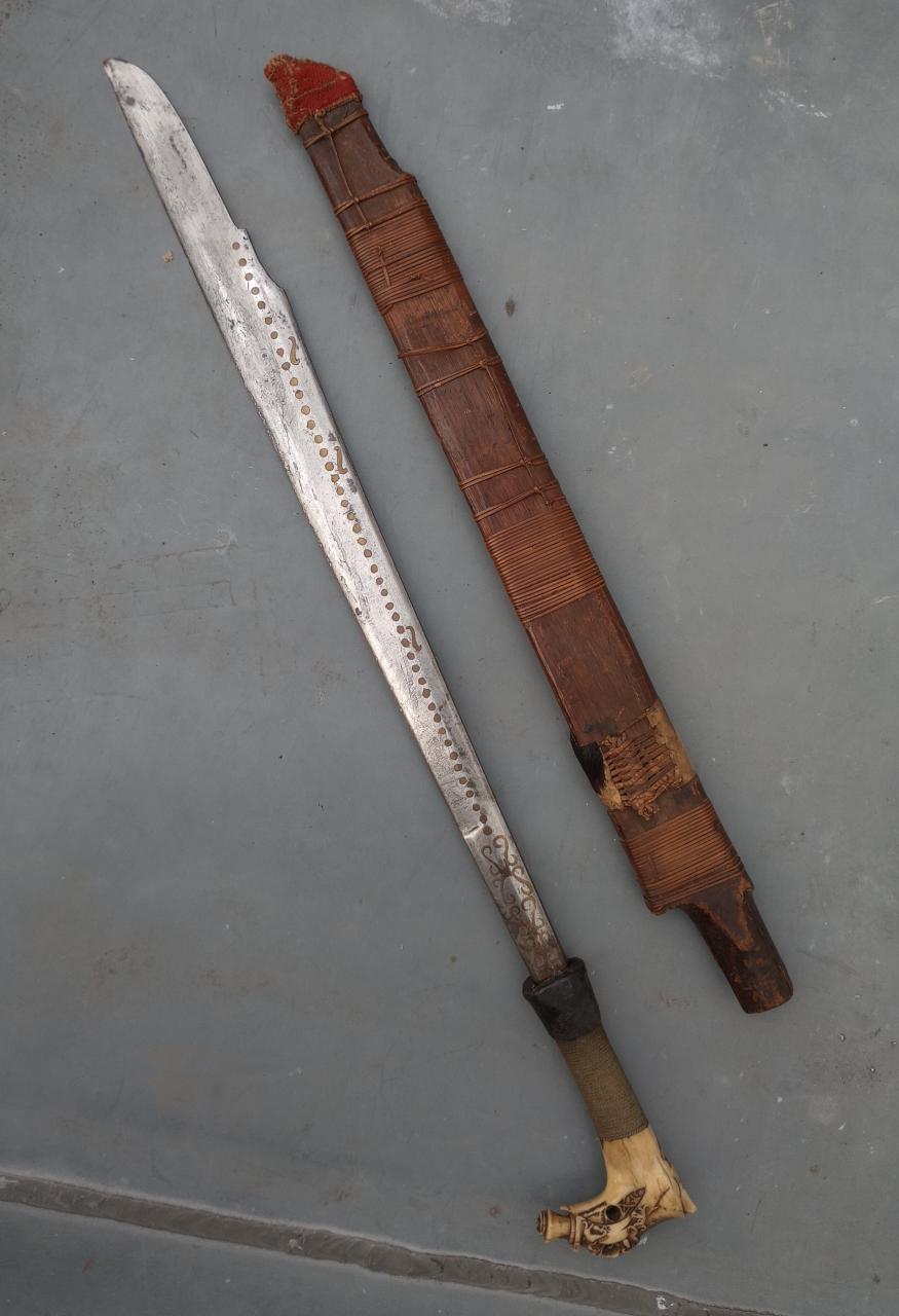

Here some pictures of my mandau which I think qualifies as mantikei.
Hi Willem,
Sorry, forget you as a person who knows also well about mandaus!
And thank you for providing the word "mantikei" for laminated mandaus, I searched for nothing in my memories for this word!
PS: I see a little bit of rust at the tip of the blade from your nice mantikei mandau you should care about!
Roughly / locally forged blades are sometimes referred to as "mantikei".
I have 1 blade in my collection with a similar surface as this one.
They are rare, but I am not sure if they have a special status.
