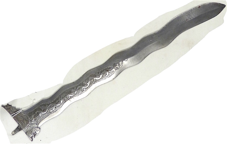

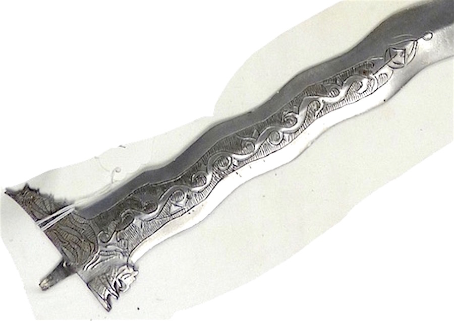

Just one last thought on the similarity between gunong and kris blade styles. Here is a relatively modern kris blade that shows the square shoulder preceding the first luk on the "back edge" of the blade, and the ">"-shaped point with its acutely angled tip. The blade does not have a separate gangya, and the tang is very short (although Moro kris can have surprisingly short tangs, this one is shorter than most). The elephant trunk area suggests a Maguindanao origin for this blade.
The okir style engraved on the blade, with cross-hatching, is found on early 20th C pieces (say, 1900–1920/1930), and this is consistent with the blade features noted above. Similar blades were made later without the engraved okir.
I think this may help date some of the gunong shown here. However, the production of these small knives has extended for more than a century, and continue today. Those seen for sale now are nearly all 20th C in origin, sometimes reflecting earlier styles. I don't think one can say that because the blade on a gunong resembles a kris style of the late 19th C or early 20th C it is therefore from that same period. I think one can say it is of a style that does not predate the corresponding kris style, however it could have been produced decades later. Only a small fraction of Moro gunong/punal coming on to the market these days are 19th C in origin and it is good to see pictures of knives in an early style posted in this thread. The popularity of the gunong as a souvenir item will see its continued production in the Philippines, although current quality may not be what it once was.

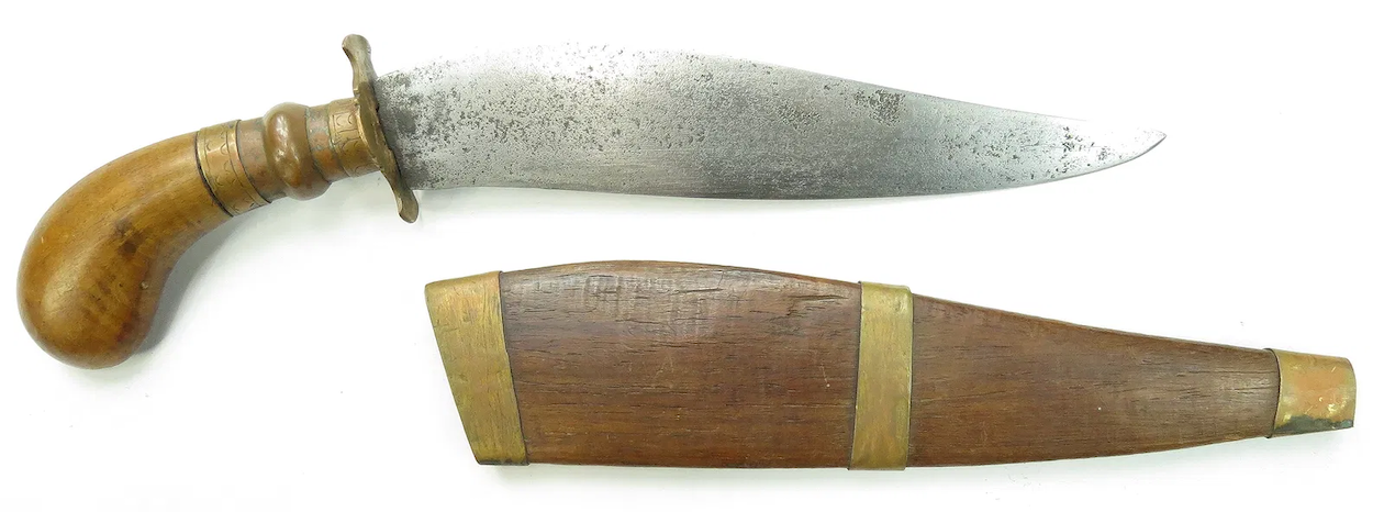

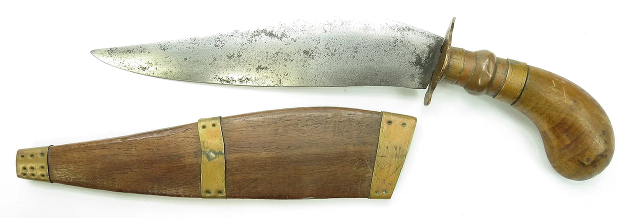

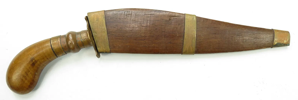

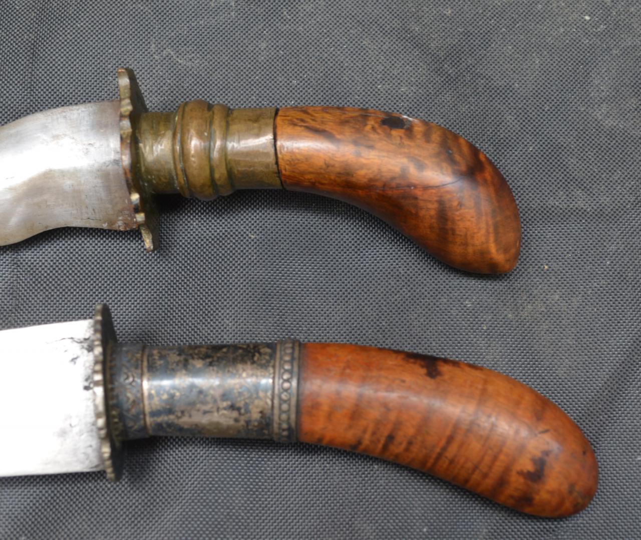

Here's another one with the older style of brass ferrule and guard, similar to others shown in this thread. The blade may be a recycled end portion of a Moro kris. The scabbard appears to be newer than the knife.
Overall length 30 cm (~11.5 in.)

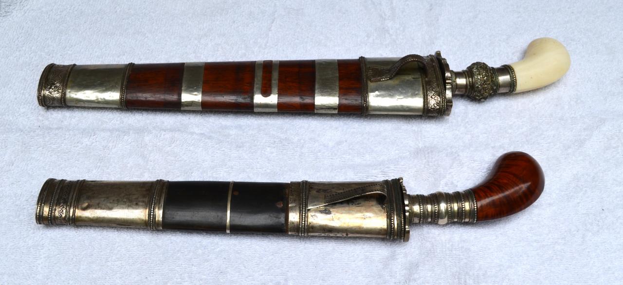

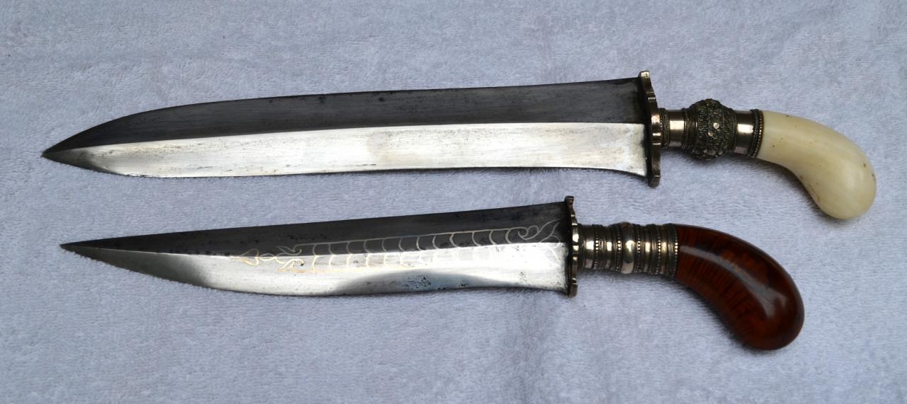

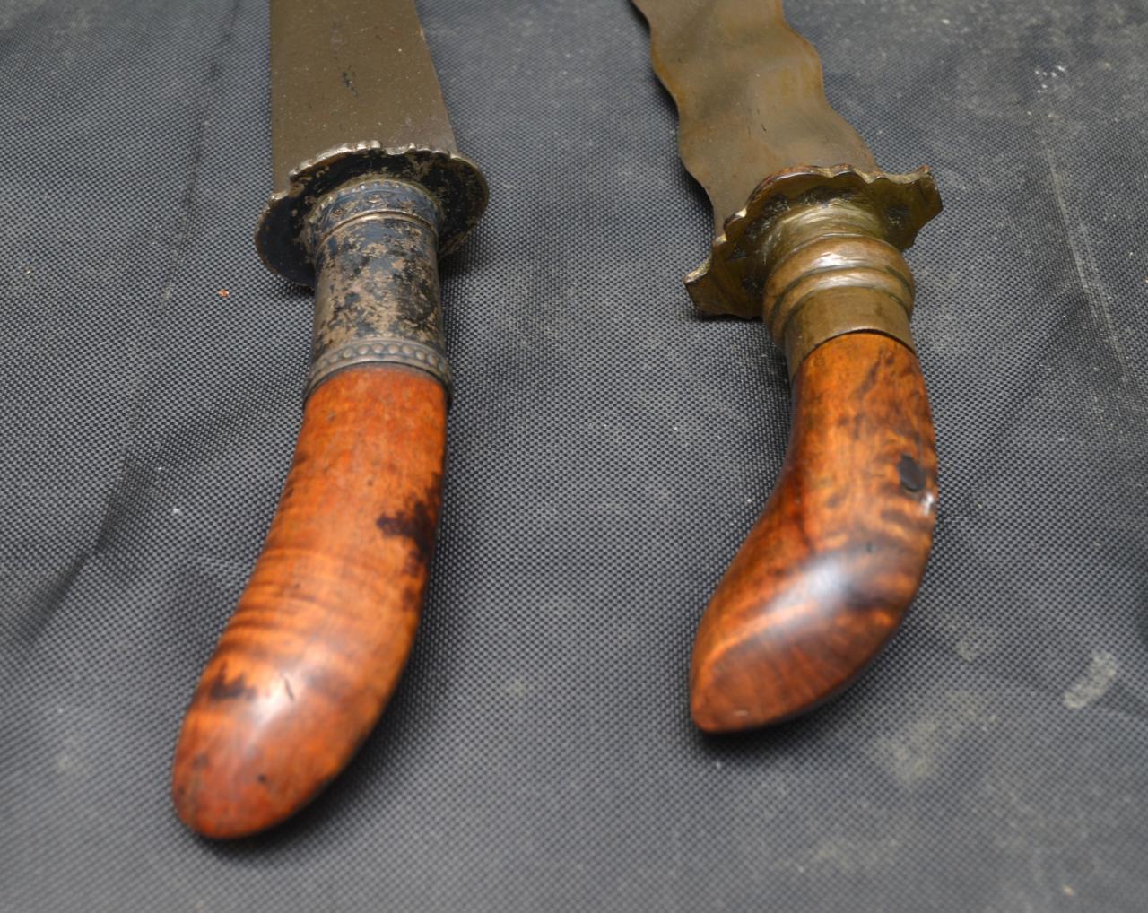

Since everyone was posting punals,I thought I might post a couple of mine.
Old 27th May 2025, 02:15 AM   #34
Posts: 4,738
Hi drac, Very nice gunong in heavy silver mounts. I think these are all 20th C examples, whereas this thread has been focussing on earlier pieces with brass/bronze ferrules and guards.

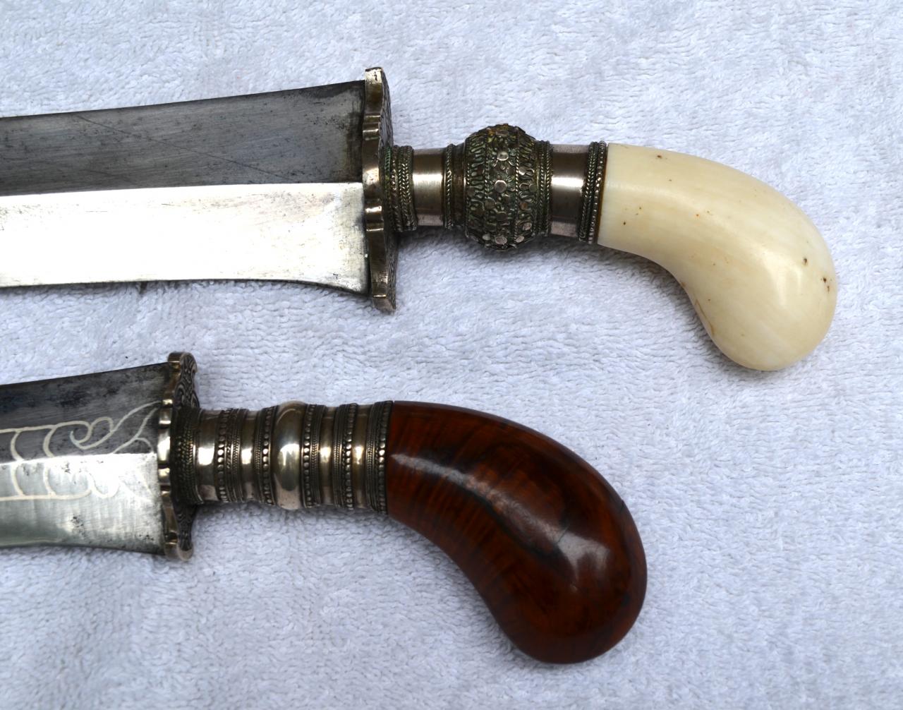

Ooops;who knew that a thread that was titled "Bronze and Brass Punals," meant punals with bronze & brass fittings,lol.I guess my powers of observation haven't diminished(just not improved).

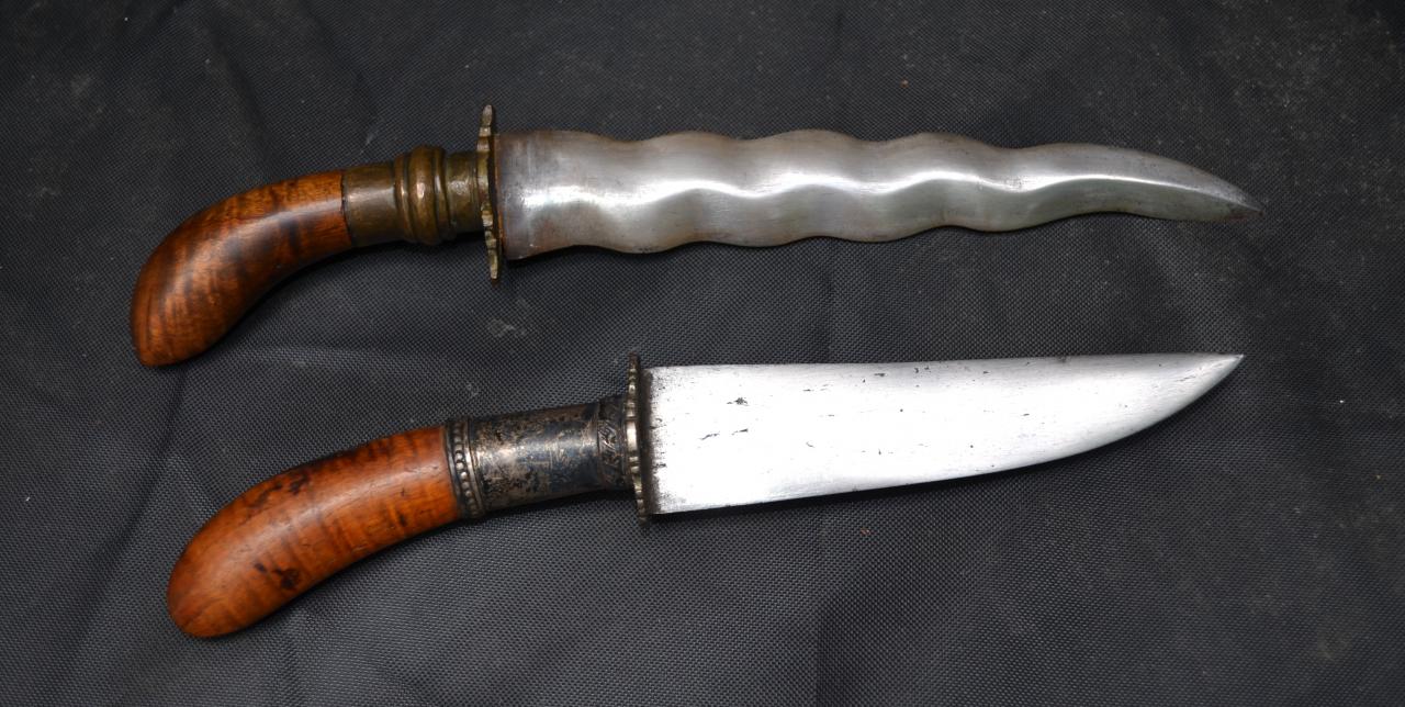

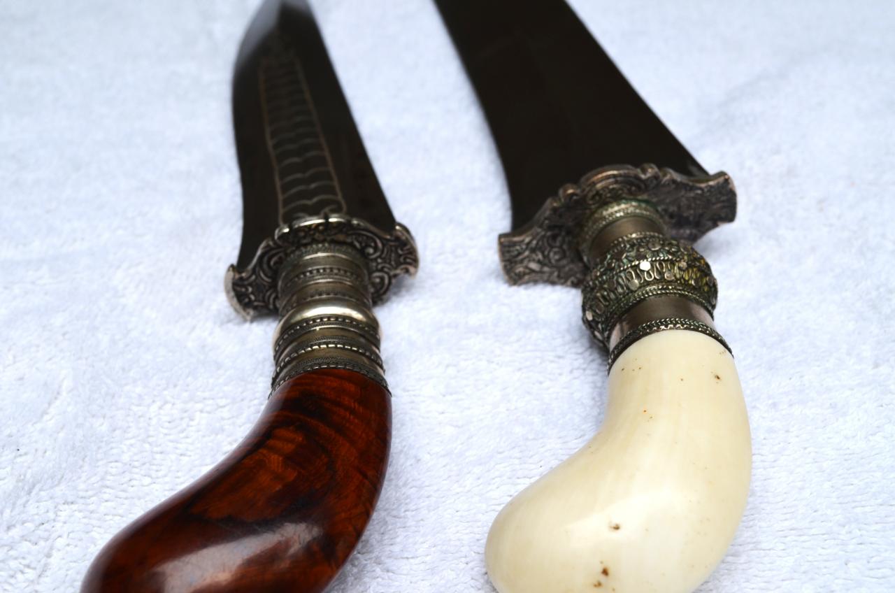

Let me try again
Old 2nd June 2025, 11:53 PM   #36
Posts: 4,738
That's much better.
Those both look older examples. The more elongated, less "globular," pommel on the bottom one looks like an older style, and the top one has a brass/bronze ferrule that fits right in with the styles shown in the earlier part of this thread.
Nice examples. Thanks for sharing them.
