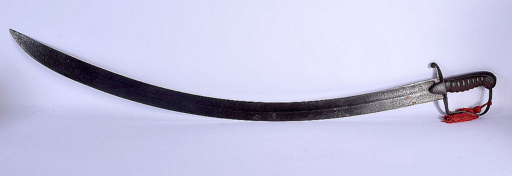

This saber is what I believe is British, and possibly one of the many variations of the M1796 stirrup hilt sabers for light cavalry of this period, and most likely for an officer.
It was featured in an article on M1796 sabers in Denmark around 20 years ago which concerned the numbers of variations in these swords.
In the 1790s, Henry Osborn of Birmingham teamed with a British cavalry officer named LeMarchant to develop the first regulation patterns for the British cavalry known as M1796.
While the blades seem to have had a number of variations, some with 'pipe back' (many of these had the stepped back yelman point), and even cases of 'yataghan' type blades, this is the only version I personally have ever seen of a 'shamshir' type blade with this pipe back . Typically the M1796 had what s known as a 'hatchet point' which was a radiused point rather than sharp tip .
Also unusual is the deeply canted hilt which is a characteristic I have only seen on certain type of shashka from the Caucusus regarded as 'Mingrelian' if memory serves.
What is known of this period of sword development in England is that numerous variations observing other sword forms from various nations were considered. Possibly the Caucasian types might have been noted?
I would be curious to know if others here have seen similar examples and thoughts on this anomaly.
