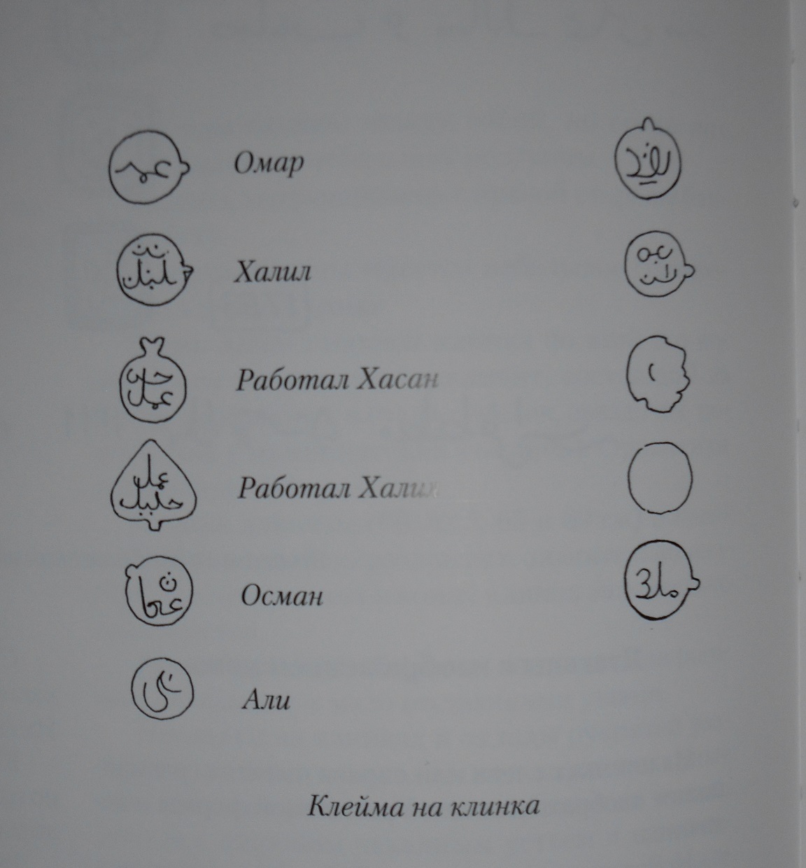

This probably comes too late, but all the marks posted here say “Mustafa”

The maker's name in the mark is 'Mustafa'

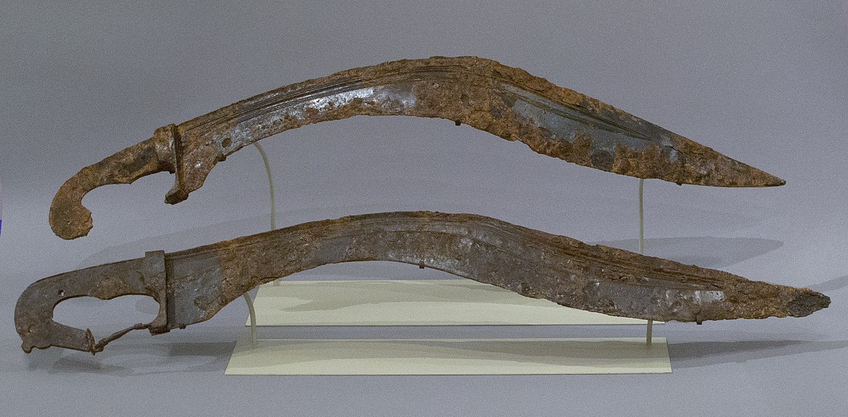

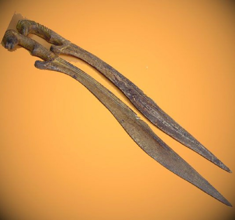

I will stay with the Greek kopis, same kind of weapon, same period 5 -4 BC, same area... |
