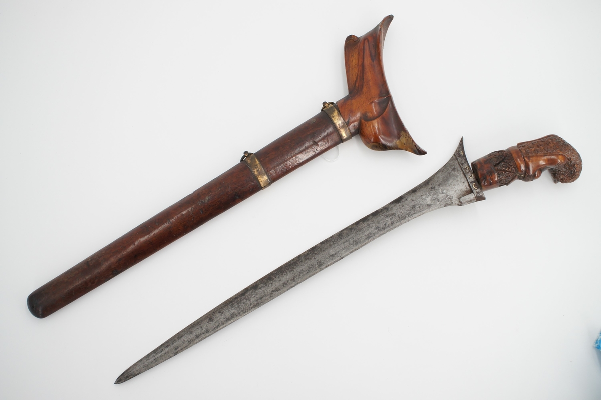

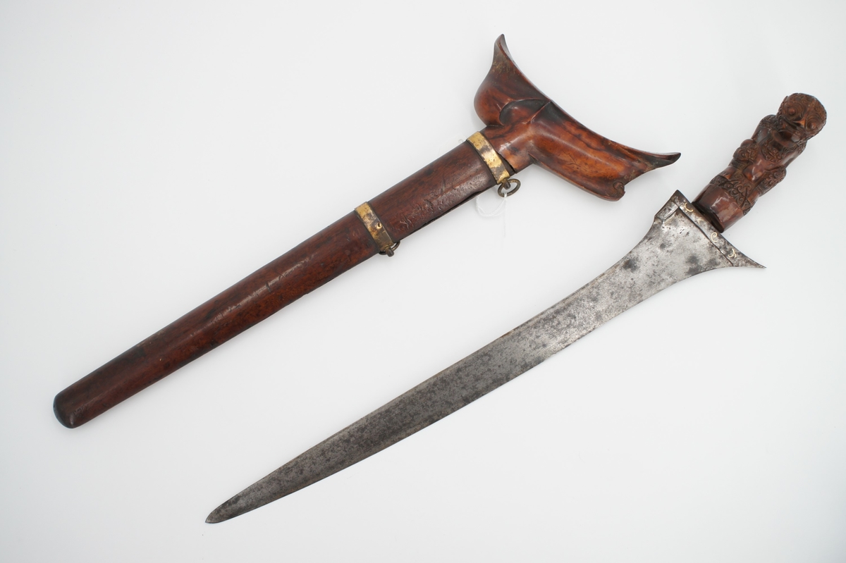

The dress of your Keris certainly is Palembang/Lampung. However, the dress seems fairly recent to me, probably quite a bit younger than the blade. Thus, we probably have to focus on the blade only; considering the differences with Gustav's blade though, I kinda doubt that it will bear much on placing the latter.
Yes Kai, the dress is obviously later than the blade, which is probably the case with most keris that come up for discussion.
To be clear, the reason that i posted my own keris for comparison was to draw Jean's two assertions into question.
1. that sumatran keris are generally not larger than 37cm.
2. that the tikel alis passing into the gandik is more a North Coast trait.
These are traits that both my keris and Gustav's share as well as a very similar arrangement in the greneng and a flat, squared off buntut urang. Certainly there are many differences between my keris and Gustav's and given that Sumatran keris were greatly influenced by keris from Jawa i was not necessarily trying to develop a thesis to prove the origins of both. What i did what to know was if Jean's assertion held to greater scrutiny and if what he was saying discounted Sumatra as the origin of my own keris. Given what has been presented i feel quite comfortable continuing to identify my keris was Sumatran. Gustav's keris presents some other more difficult traits which perhaps makes it harder to be so definitive.

Originally Posted by kai
IMVHO, the scabbard seems to be the best bet in placing the ensemble.
Perhaps the best bet for placing the ensemble, but does it place the origin of the blade itself. Just like with mine or most other keris we discuss this ensemble is probably not as old as the blade itself. So identifying the origin of the sheath as, say, Sumatran , does not necessarily mean that Gustav's blade did not originate in North Coast Jawa.

Originally Posted by David
1. that sumatran keris are generally not larger than 37mm.
Gosh, I did not say that
And after seeing the pic of the whole blade, I agree that it is probably from South Sumatra.

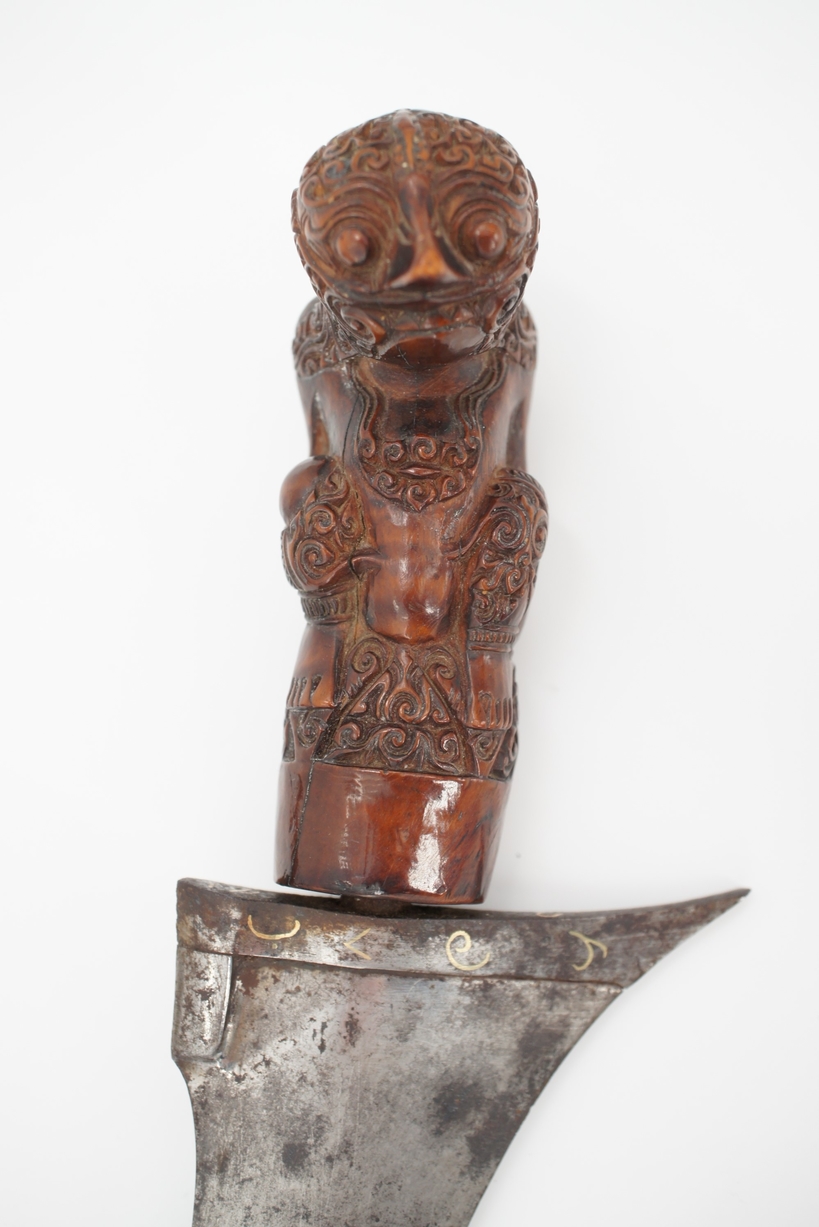

Join Date: Jun 2009
Posts: 1,346
There was another Keris auctioned last week, with some corresponding features - generally the same style sheath, talismanic inlays on Gonjo of similar kind.
A Yaksha/Rakshasa hilt with some unusual/individual features.
The interesting thing about it - it was brought to England by James Alms (1728 - 1791), officer of the Royal Navy, possibly at latest 1784.

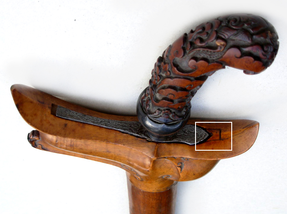

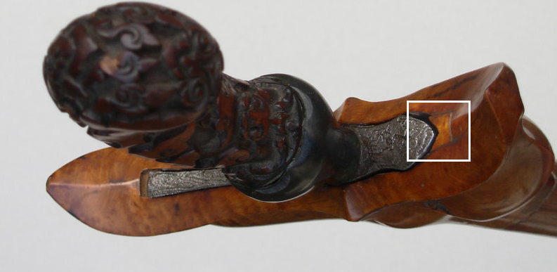

Referring to the initial post of that nice Palembang kris I noticed the adapted slot opening. Seems to have contained quite a square model.
Paul B. is offline   Reply With Quote
Old 31st July 2019, 09:36 PM   #40
Gustav
Join Date: Jun 2009
Posts: 1,346
That is just an inlay, about 4 mm thick. Under it the wrongko exactly fits Gandhik.
Similar inlay, of the same thickness, missing on Kepet side.
Just a cosmetic repair, done long time ago.
