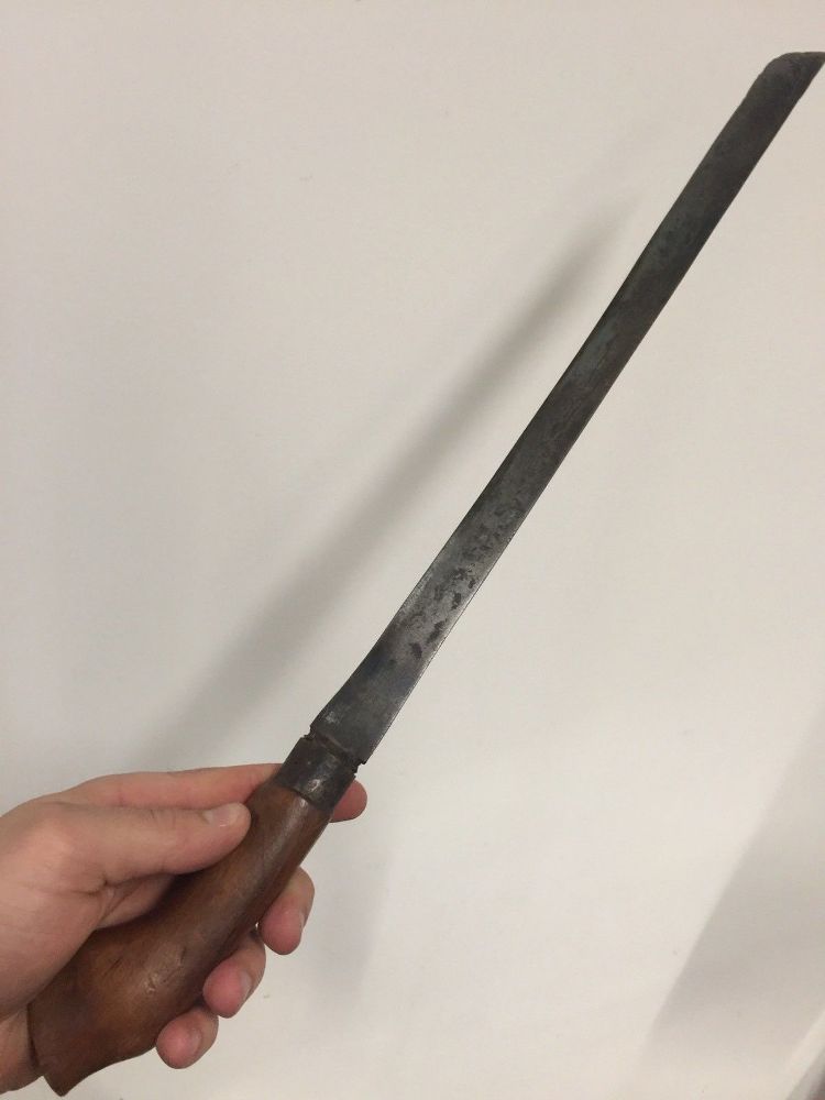

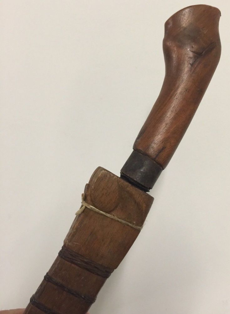

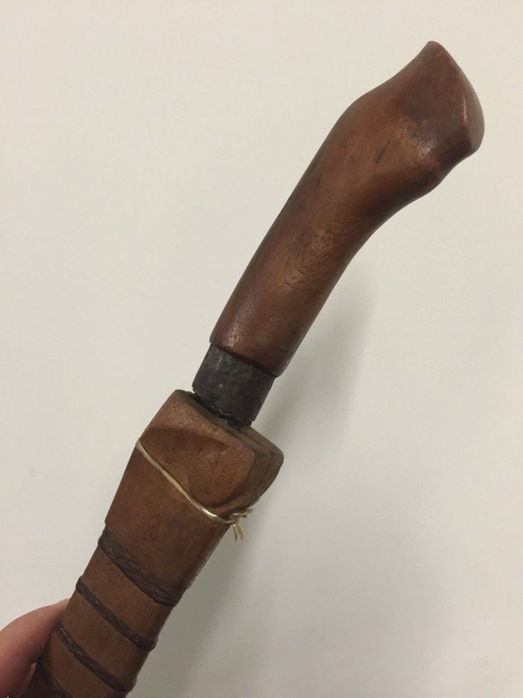

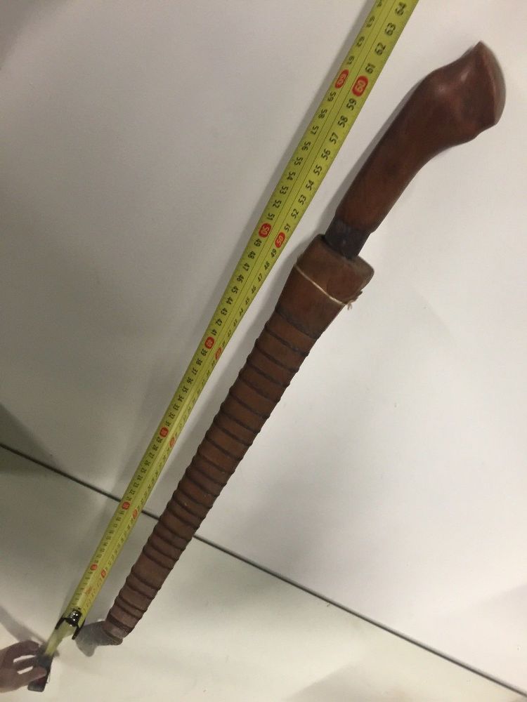

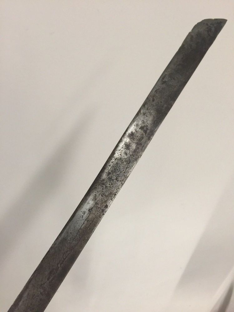

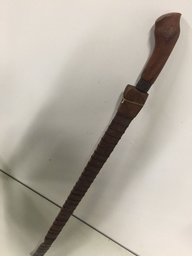

Here another Nias knife I've bought recently. Pictures from the seller. Maybe not extremely old but with laminated blade.

Hello Detlef,
This is a kind of secondary sword (usually worn behind the balato). The blade looks promising - please let us know the blade thickness once it arrives. As you already suggested, the fittings seem younger (mid-20th c.?) to me, too.
It's a known pattern with pretty much identical style compared to the small EDC knives; there even may be a (possibly more recent?) continuum of sizes: Ian's from post #24 seems to be intermediate with traditional tip and apparently rather strong blade?
However, most of the knives are really small and the swords more in the balato size range (give or take a few inches) while the intermediate size-range usually gets covered by regular si euli (a damaged si euli scabbard is easy to recycle into a knife scabbard though).
