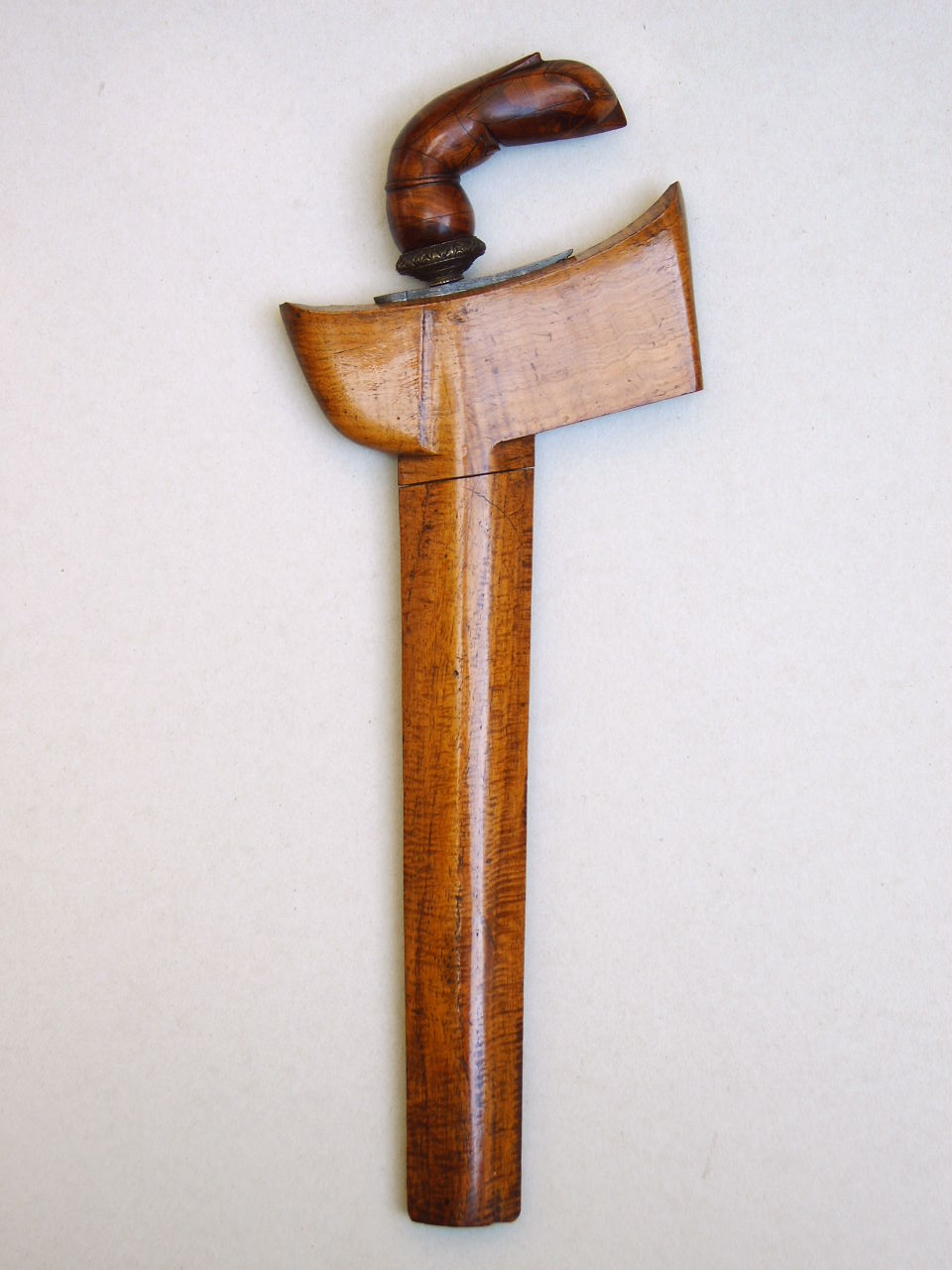

Guys, it's of course nothing of great importance, yet Johan's Keris quite clearly is a Riau or Straits piece (its Gandar/Batang included) and has nothing to with Sulawesi. The sheaths shown in this thread are Sulawesi Bugis.
The Straits Sampir are boxier (wider) and could actually be easier to carve - they don't have the bulge.
Gustav, if you (or anyone) have some example to show please post them. I'm sure an illustration would be helpful to Johan. I have no such keris in my own collection at this point.

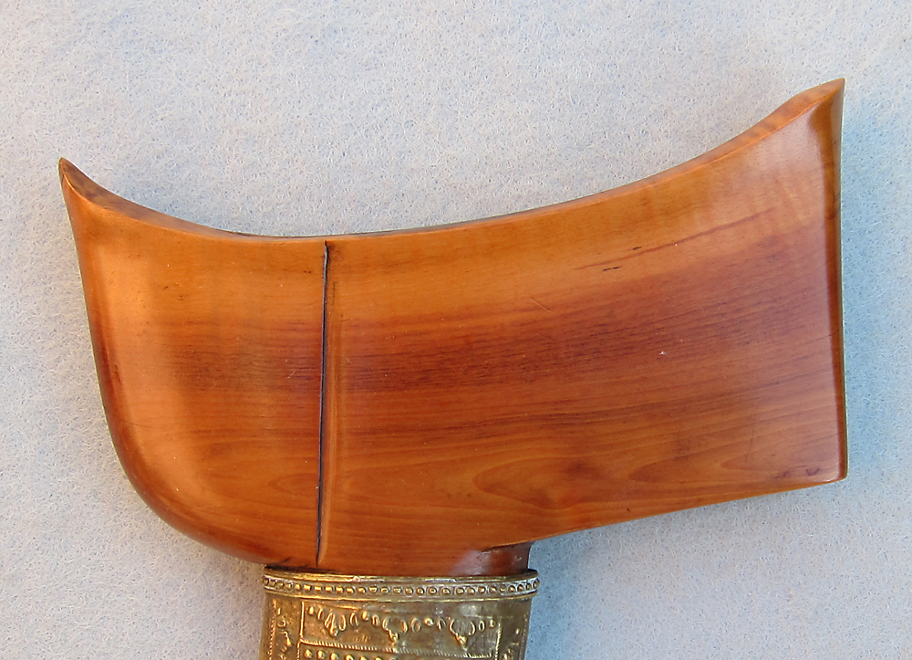

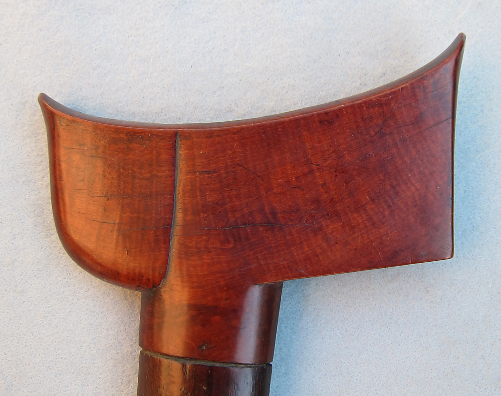

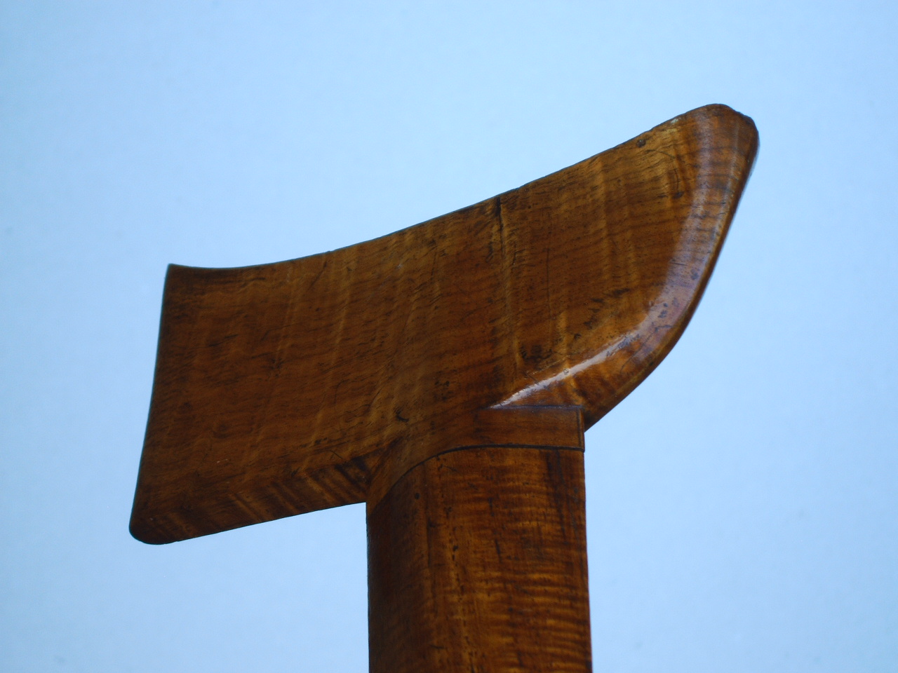

This one comes near to Johan's Gandar/Batang in shape and also wood characteristics are similar. Unfortunately one tip of Sampir has a damage. Will try to make more pictures of it tomorrow.
But I think, all that is not so important, as it in any case will be a "cross cultural" Keris. The Wrongko just should be a good fit for the blade. The only point for the Riau style Wrongko in this case (besides the style of the blade and the survived fittings) is perhaps the minimally easier understanding of its shape and carving work.

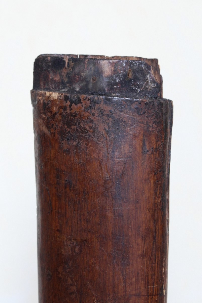

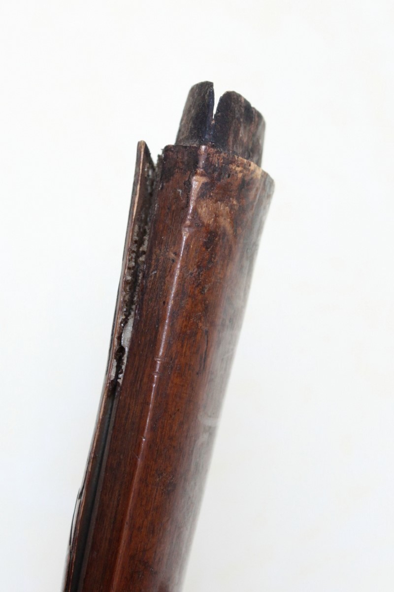

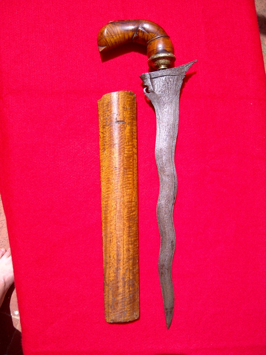

Johan actually is wright. For a Gambar/Sampir on Sumatran or Peninsular Kerisses the piece of wood is mostly taken from roots, can be brittle and has a lot of inner tension. The walls at the joint with Gandar/Batang often are only a couple of millimeters thick, exactly at the weakest place. I have seen many and own some sheaths, where Sampir at this place is broken. If you try to adjust the loose pieces, you mostly find them slightly deformed, because of the inner tension of material.
Sorry, the weather wasn't good today to shoot the pictures. Will try tomorrow.

Posts: 7,229

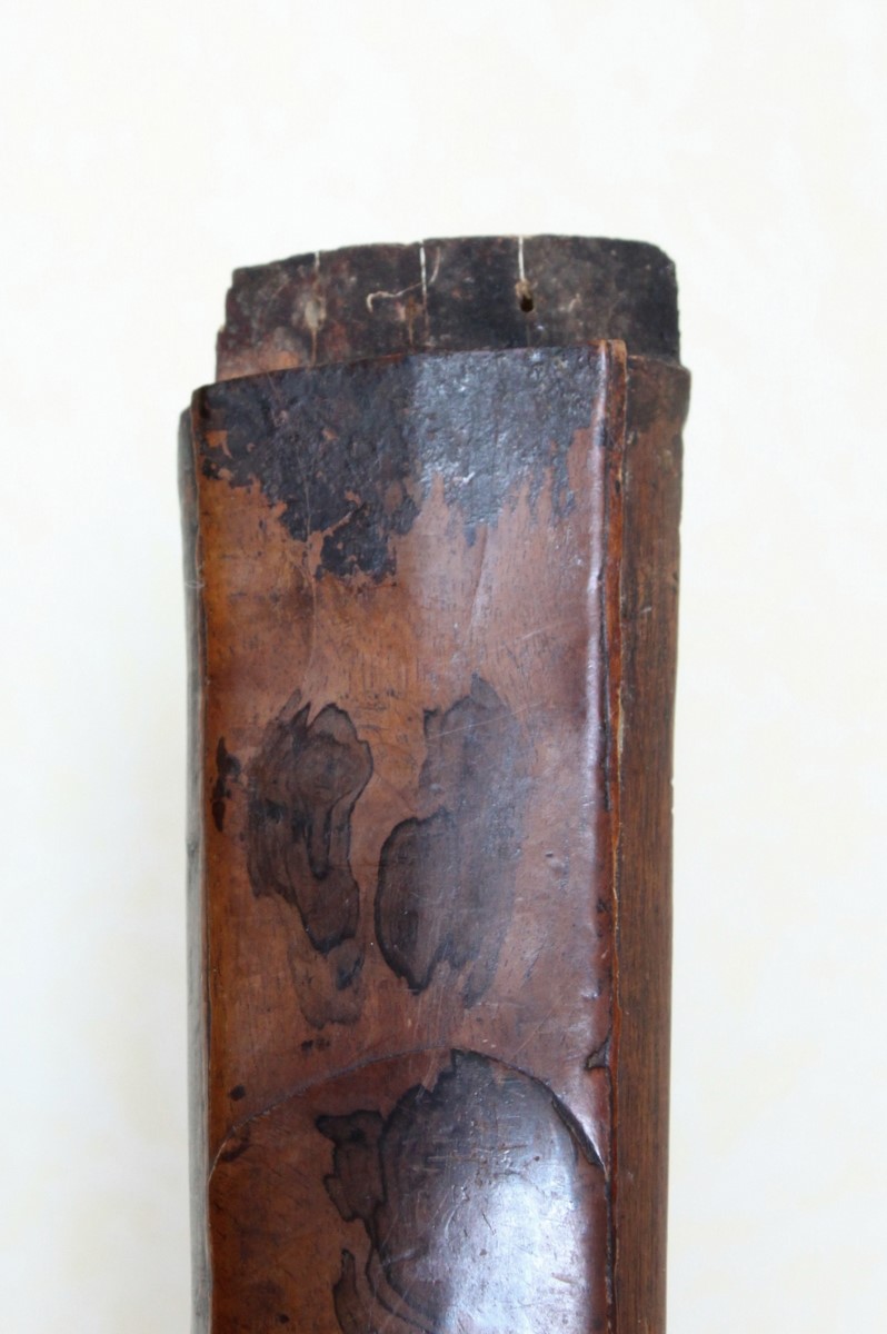

What you say is correct Gustav. I've seen many wrongkos where a split has developed in the neck of the gambar, I've also seen many where the tongues of a gandar have broken off. The weakness here is not confined to Bugis/Peninsula wrongkos, nor is it confined to root wood or burl wood, but it occurs in all wrongkos.
In old-time Javanese wrongko joints, the adhesive used was very often button shellac, which is a very weak adhesive. This allowed the adhesive to break before the wood broke, and it is a very simple thing just to heat the button shellac over a candle and refit the gandar, rather than return the whole keris to a m'ranggi to get it repaired.
Basically, it is a weak joint, and if there was enough timber to do so, small dowels would improve the joint.
But there is almost never enough thickness in either the wrongko neck, or the gandar, to use dowels.
So what is done is to overcome this joint weakness in another way. The joint gets covered by a metal collar, or it gets bound with twine, or a pendok is fitted.

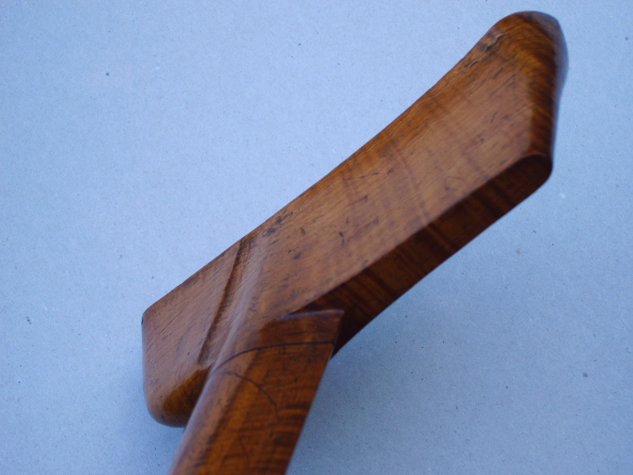

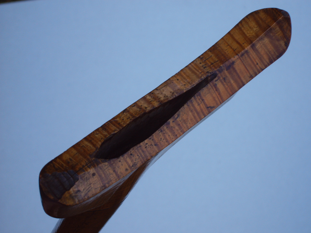

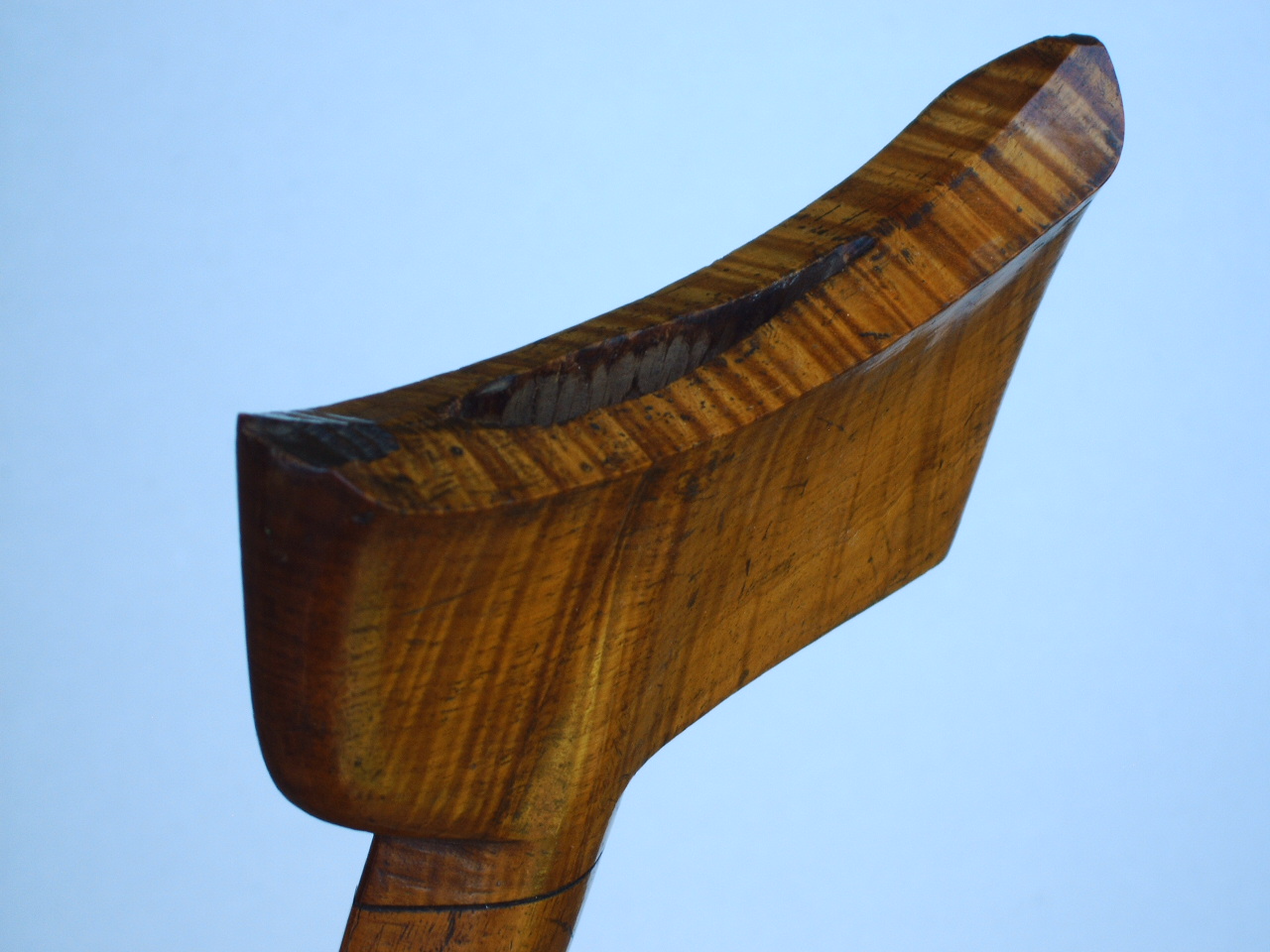

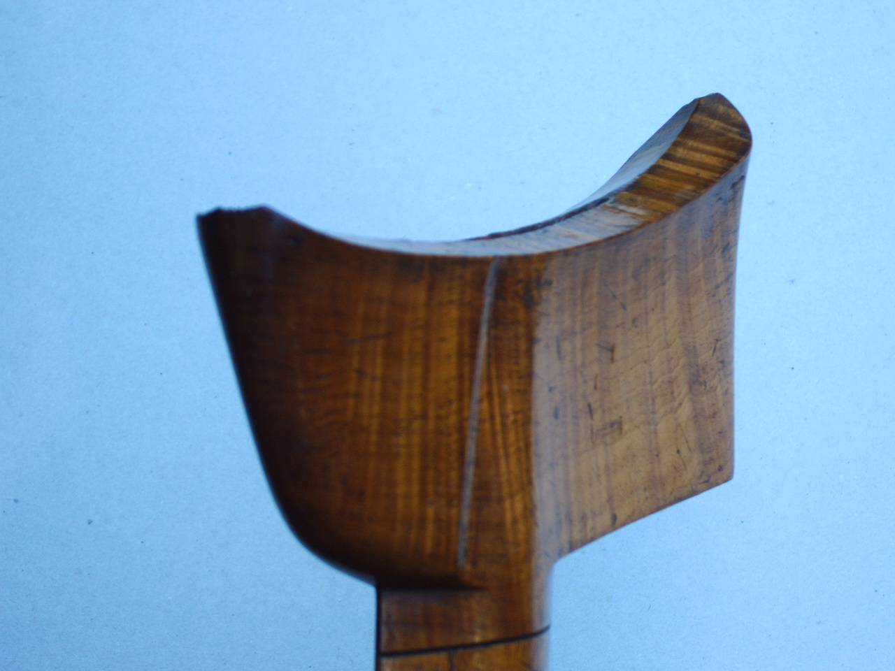

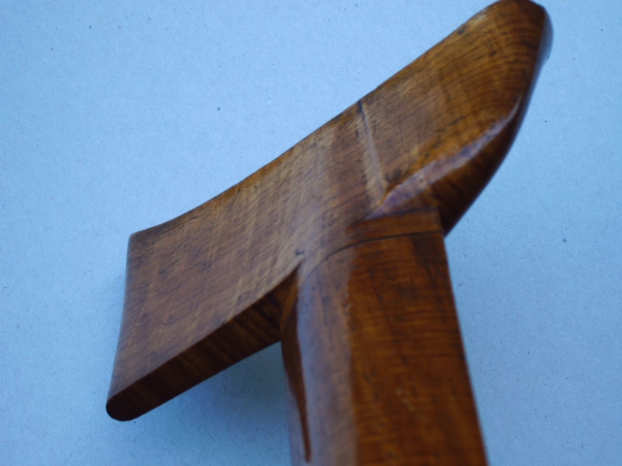

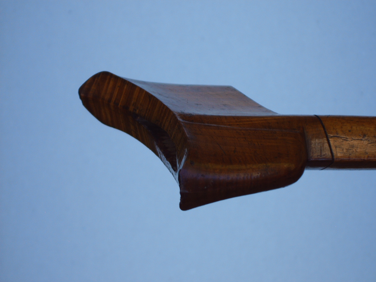

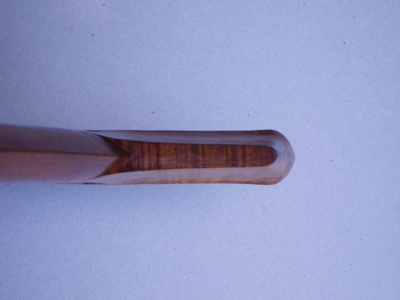

A couple of pictures.
It's exactly 3 cm wide there, where the tang of blade would be, and becomes a little bit wider at the back (Greneng side of blade), with the length of 16,5 cm - all parameters when looked from above.

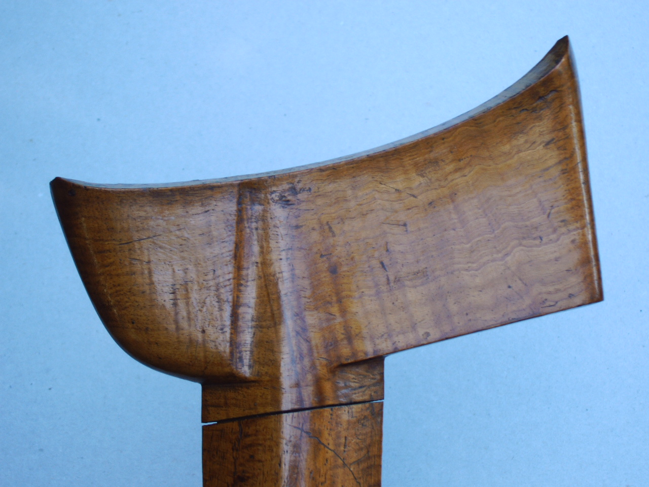

Old 2nd May 2017, 11:33 AM   #41
Gustav
Join Date: Jun 2009
Posts: 1,346

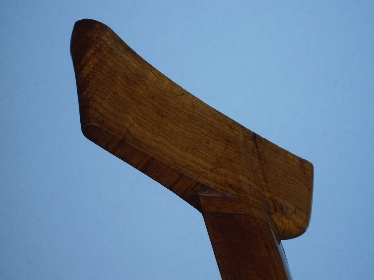

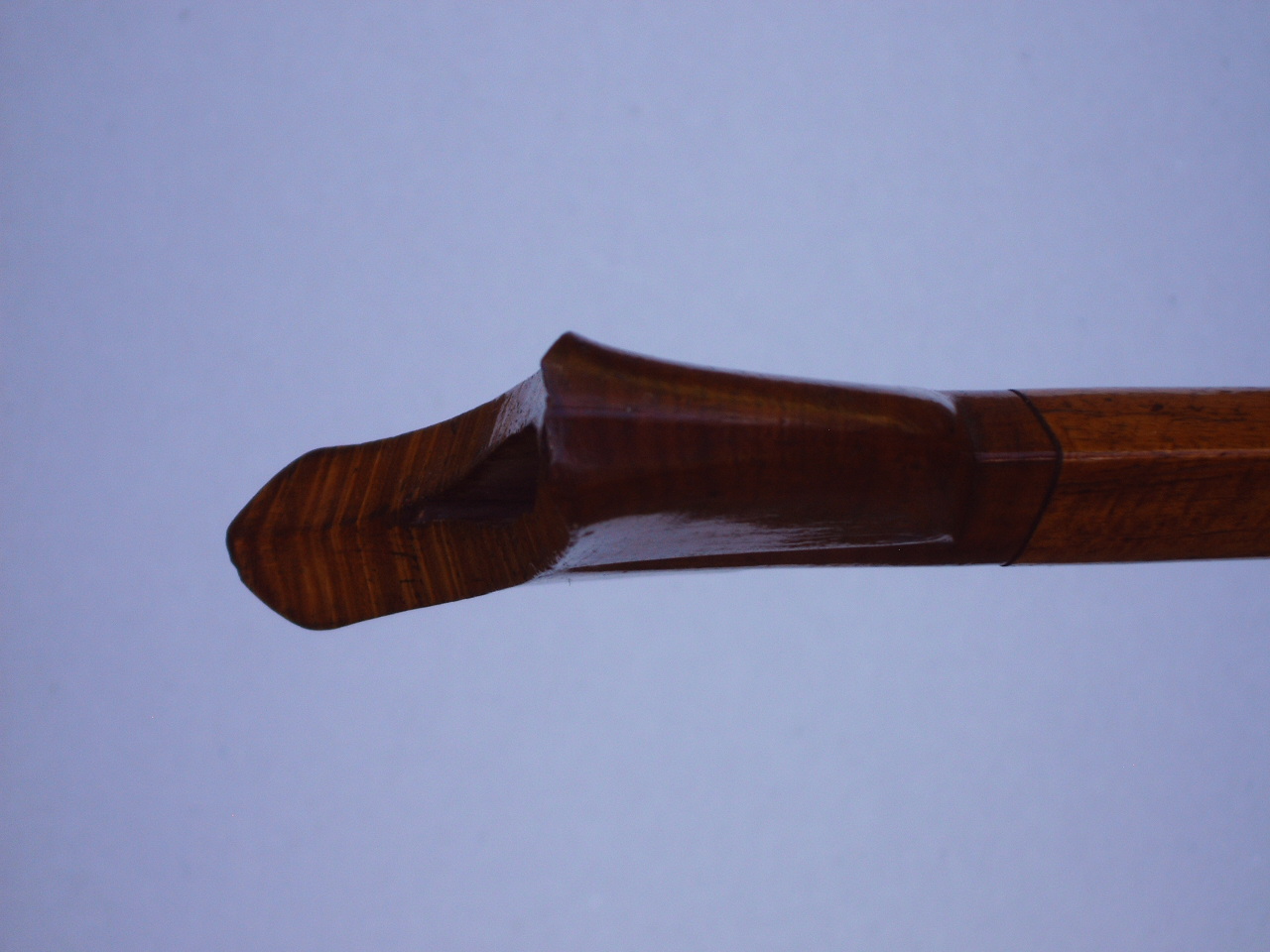

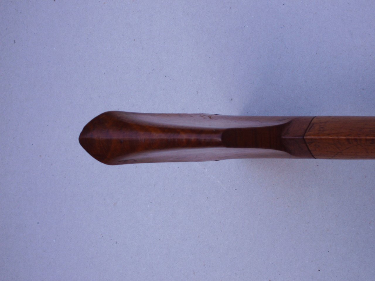

Two more.

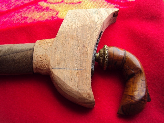

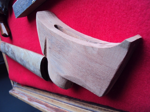

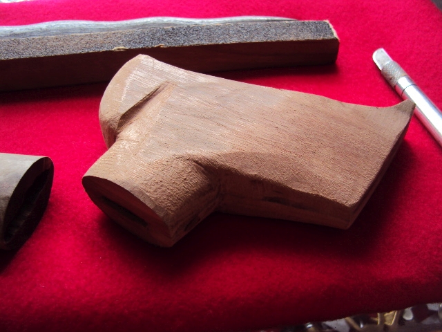

I have indicated how reluctant I am to post pre-completion pics of the wrongko project, but David felt that it would be good, so I respect that.
This pic shows how far I have come. The blade goes in deep enough, the fit is satisfactory. The wood is a bit difficult to work with; I have used various tools to reach this stage. From here on it will be carving knives and files, then sandpaper. (The angle grinder's work is done!)

Johan, you might find that scrapers will be useful in shaping the contours.
The typical cabinet scraper is a piece of rectangular steel about 6'X3", but for concave and convex surfaces you can make your own scrapers from pieces of heavy tin can, just cut the needed shape with tin snips.
I use old pocket knives a lot as both carving knives and as scrapers, the castrating blade on 3 blade stock knife makes a very good detail scraper.
Pieces of glass are also useful as scrapers.

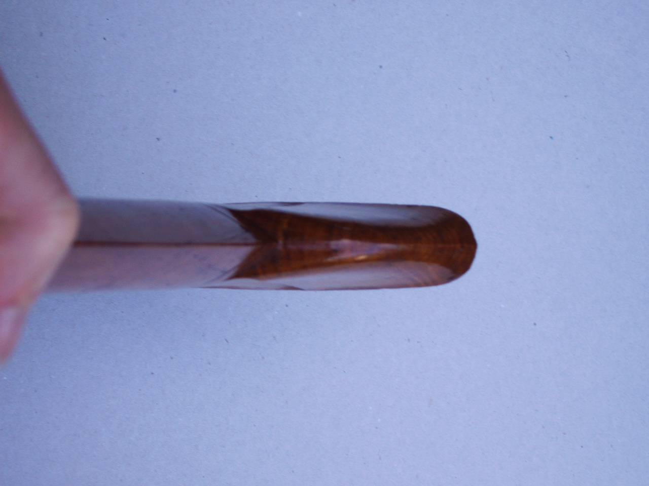

Johan, just one remark regarding the line you have drawn on Gambar/Sampir with pen - if that's the line you later intend to carve - it shouldn't be parallel to the central axis of the whole sheath (the sheath will then look stiff), it should fall a little bit inwards. At which angle - you should esthetically decide it, considering all other angles of outlines of your Sampir, and also hilt of your Keris when sheathed. They all as ensemble should be in a state of a floating harmony.

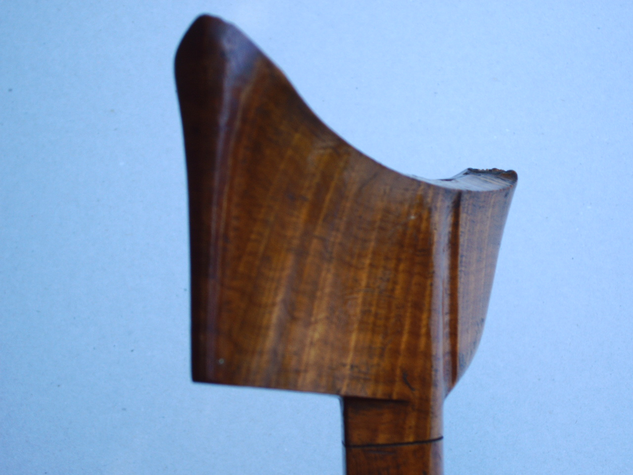

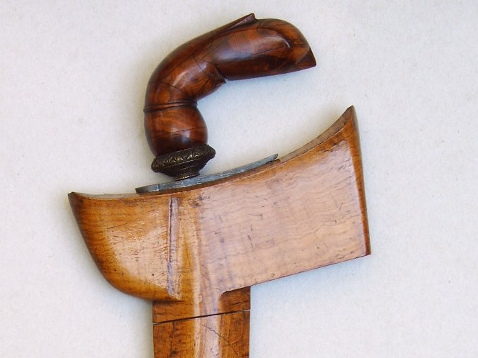

Second attempt.
For comparison.

Yes, three sheaths in Sulawesi style.

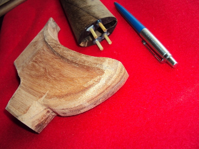

More progress has been made (see two pics). The project still looks ugly in its lack of completion, but I hope to remedy that as well as possible with painstaking work. I know that I am not able to live up to the high standards you all have brought forward in your advice and pictures for my benefit, but I think you will come to realise that it was not possible for the likes of me (not an experienced carver, not having a real scabbard to copy) to deliver a product even remotely equal to a true Bugis keris wrongko. For starters, the wood does not even come close to timoho or kemuning. But I know that I am doing what I can and learning all the way. Please note that the the gambar I am wresting from the unyielding wood has got a mind of its own, and although I frequently compare my work to your pics, it is turning out somewhat different! Please forgive me.
Johan van Zyl is offline   Reply With Quote

Hello Johan,
No worries, I'm confident it will look much better, finally!
What you are experiencing is the "spirit of the wood" and an experienced carver would take this into account when selecting and during carving wood. Just try to go with the flow as best as you can...
The upturned stern still needs quite some wood to be removed and also the whole piece could become more thinner, especially just right of the socket for the stem. I'd also make the notch on the left less substantial (if you compare it to the examples, this does run almost the whole length and is fairly shallow groove).
Tropical hardwoods tend to have very large pores and it will be wise to fill them before the final polishing steps. Any surface treatment (boiled linseed oil, shellac, wax) will make the wood looking much nicer than in its current raw state! Is the crosspiece teak?
BTW, don't forget to wear a mask to avoid wood dust (many timbers are proven or suspected to be carcinogenic).

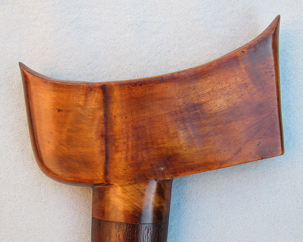

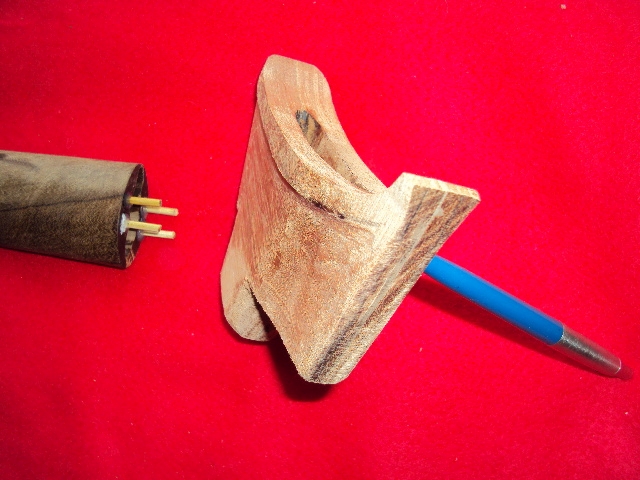

Hello Johan,
This is how the integral tenons/ tongues should look like on the gandar side. Sorry, the piece is not in pristine condition (very old balinese scabbard). This joint was nailed but it should normally be glued only.

Jean & Kai, looking once more at your latest pics, I am totally impressed with the craftmanship of the old mranggi's. And I am now in the position to appreciate their skill even more!
