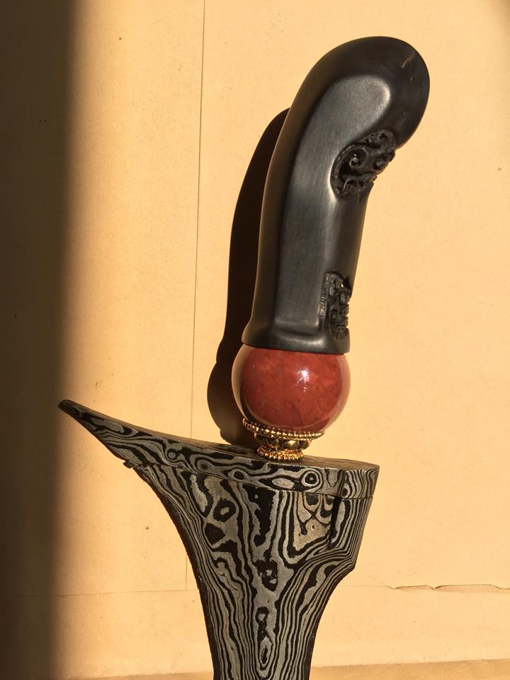

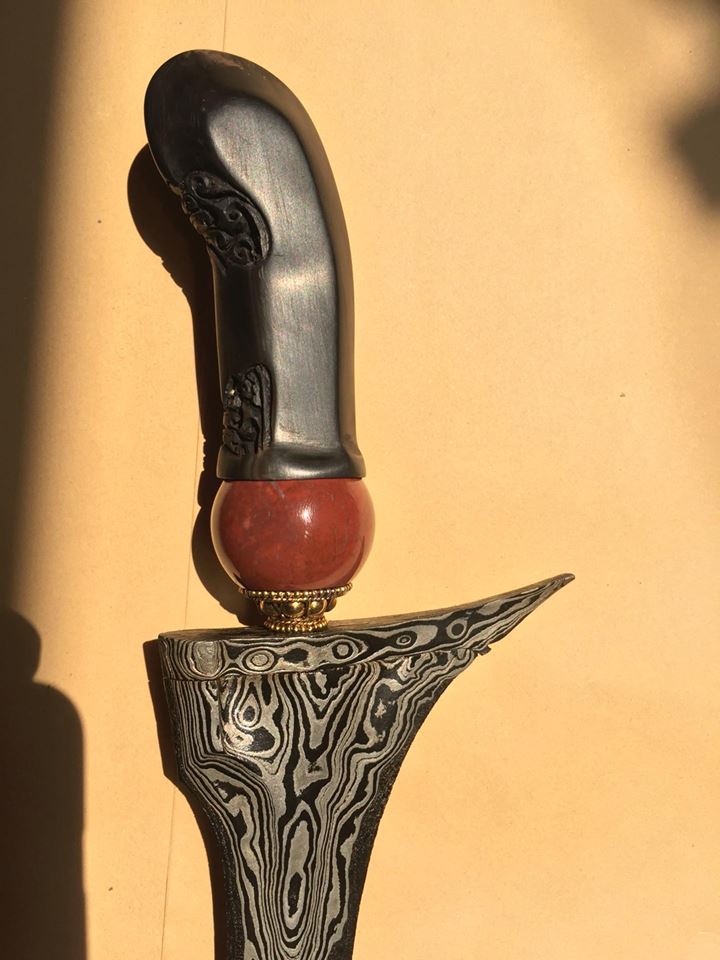

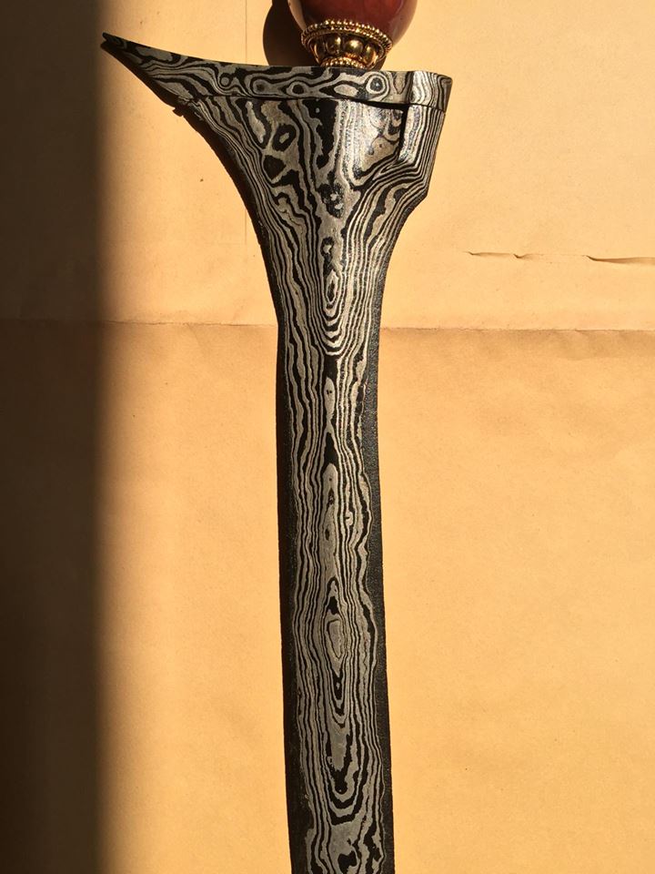

Default Kanjeng Jiwana Keris
This is another keris, courtesy of Donny Yonatan, called Kanjeng Jiwana
the inspiration of the pamor is of course wood burl, meaning we must be like plants, the first to grow and the first to sacrifice so other living being may inhabit an area
basically humility and perseverance
enjoy

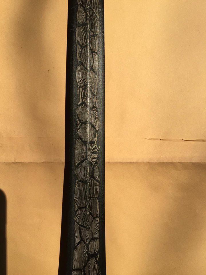

Old 5th September 2016, 03:51 PM   #34
Thank you Satsujinken for all the pictures and this interesting thread! But like David and some others I have problems to accept some of very outlandish looking pieces as keris.
Old 5th September 2016, 04:00 PM   #35
Posts: 7,303
Originally Posted by rasdan
The tambal pamor work is amazing. Thank you for sharing the photos Satsujinken.

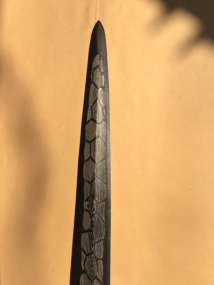

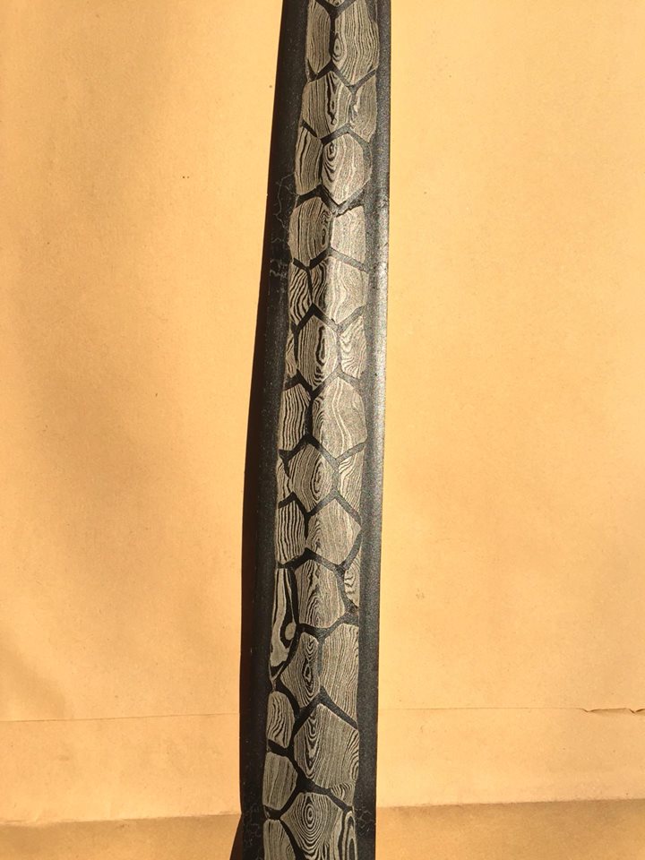

Rasdan, were you referring to the keris in post #32?
It is beautiful, btw, but at the risk of displaying my ignorance it doesn't look like what i understand as pamor tambal.
Old 5th September 2016, 10:43 PM   #36
Posts: 7,255
I thought that was tambal when I first looked at it, and I guess, in a way, it is tambal, but its a new approach, I think.
From what I can see and guess, it looks as if the pamor has been welded normally, but then the separating lines have been cut into the pamor and filled with strips of black material, probably steel, because of the lower weld heat required.
The forging has then been returned to the forge and another couple of weld heats put into it to fix the separating strips in place.
Of course, I'd need to examine this blade in the hand to confirm my guess, but however it was done, the effect is a new initiative.
I've said it before:- these blokes are amongst the world's best pattern welders. Maybe the best of them are the world's best pattern welders.

Old 6th September 2016, 10:06 AM   #38
Posts: 7,255
Yes, the Bali one.
Strictly speaking "tambal" is a patch that mends something, but in this Bali keris the patches are not the pieces of pamor, the "tambal" is --- I believe --- the strips between the pieces of pamor:- look very closely at the way the grain continues from one island of pamor to the next, and then look even more closely at the junction between the black separating strip and the solid black border material.
I'd need to handle it to be certain of what I think has been done, but in any case, however it was done it is brilliant work.

Thanks for pushing the point Jean and clearing this up. Rasdan's remark came right after post #32 which as i stated did not look like tambal to my eye at all which is why i asked the question. I became even more confused when Alan responded after my query specifically naming post #32 that he did indeed think it was tambal. I do agree that the Bali keris in post #31 does indeed look like a form of tambal.

Hi David,
Sorry for my late reply. As suggested by Jean, I am referring to keris in post 31. It is just that at that time I think that the pamor bits are inserted into the baja, but upon closer inspection I think Alan is right, the baja are the ones that were inserted into the pamor.
