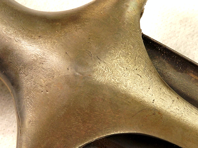

Originally Posted by ariel
Yes, Indo-Persian Khanjar.
The handle is old, with spots of rust, tarnish and pitting.
The blade, however, is pristine and the wootz pattern is very similar to modern Indian examples.
There is some black mastique oozing from the slit in the handle. Epoxy?
Where did you get it from?
Rajastan?
I am sorry for my paranoid remarks, but that's IMHO.
I second what Ariel have said. Owned a few of the recently made Indian wootz pieces, good projects if you are making replicas but a complete rip off if sold as antiques. Though some have really good quality and craftmanship.
The wootz is not crystalline but modern wootz tend to be similar to it. The cracks are not sign of age but sign of forging flaws which can happen to this day (unless you believe in the miracle of modern technology, which I doubt Rajastanis are using in mass)

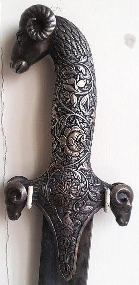

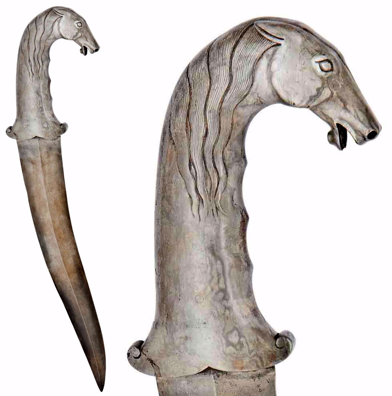

Talking about the Chicago dagger.
Clearly modern-looking pattern welded blade, suposedly coming from a time when almost all daggers were sporting wootz blades.
If it were for this reason alone and I would suspect a fake.
Also silver Koftgari in exceptionally good condition from a time when gold Koftgari was almost exclusively used.
Everything points to a modern production dagger and how the "specialists"of the Chicago Institute got their oppinion is beyond my understanding.

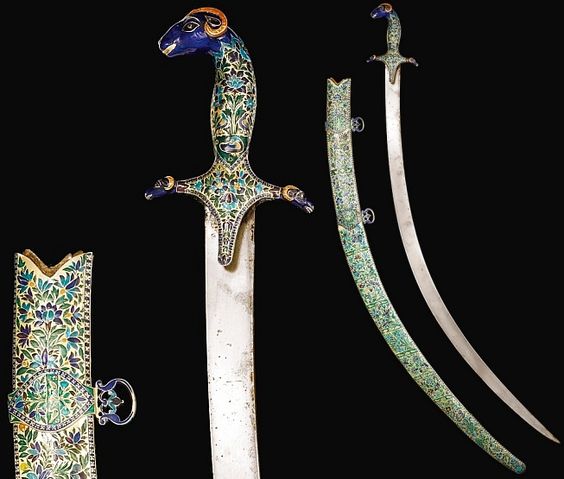

Here is an example of how the Rams head transitioned or was copied as a sword hilt..
From the collection of Arms and Armour in the Prince of Wales Museum, now known as Chattrapati Shivaji Maharaj Vastu Sanghrahalaya, Mumbai India.

Agreed, with the observation that the Ram-head hilts were quite popular in almost all fathomable materials during the 18-19th century, with steel chiseled ones holding quite a prominent position. I have seen several in various Indian museums and also E. Jaiwant Paul in his book "Arms and Armour: Traditional Weapons of India" mentions them as being popular (he also shows some examples from National Museum, that in my oppinion also show some very generous age allocation).
I have used every combination of search terms I could think of and looked through the images I know of from Indian Museums and still I have not found any more images of carved iron rams head dagger hilts.
If they were "prominent" and "common" why is it so hard to find any additional images of one? I also thought they were more widely used but what at first appeared to be old turned out to be modern on close inspection.

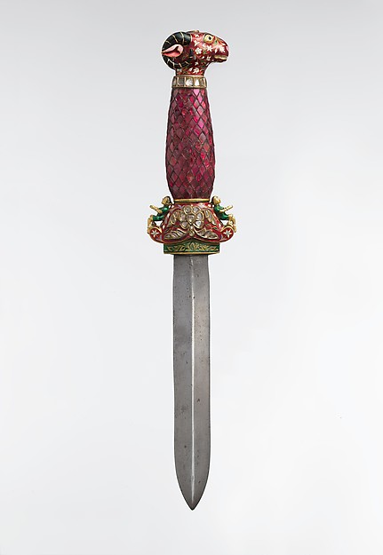

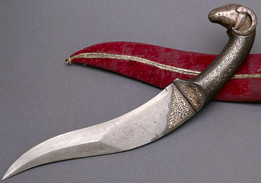

The Met SEE http://www.metmuseum.org/art/collection/search/452103 for a Rams Head Hilt. I the case of the Met exhibit is of Kuldan style ...which is perhaps described reasonably at http://www.sneharateria.com/let-kund...ak-for-itself/

Another Ramshead Dagger is at http://library.clevelandart.org/node/238552

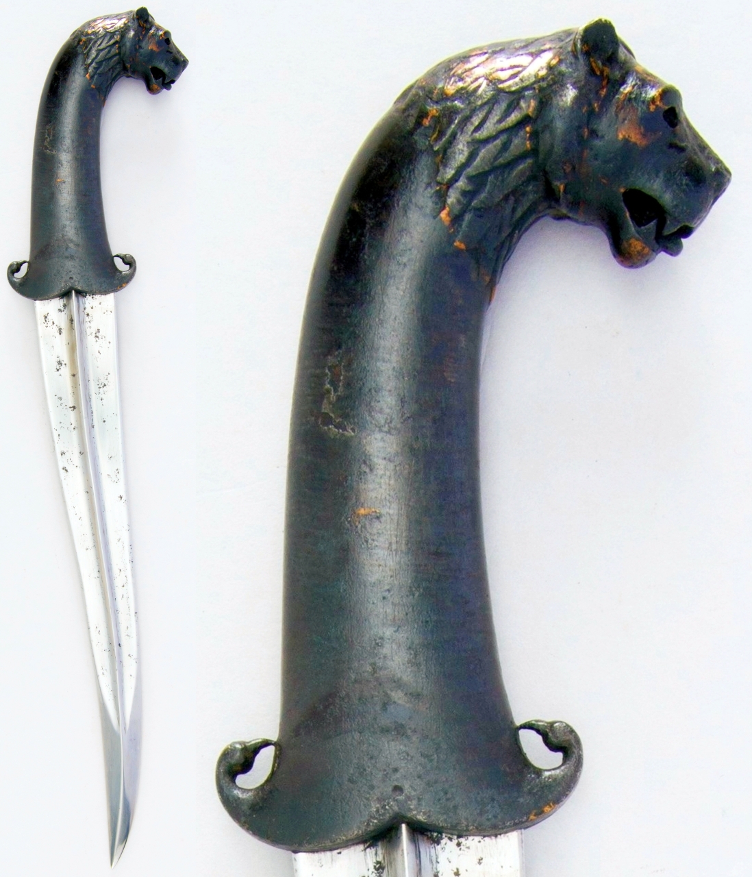

I have seen a few iron ram heded daggers in the museums I visited in Rajahstan, but I didn't take any photos of them as they looked quite dull and uninteresting. Maybe that's why there aren't so many photos of them on the net, because they don't look very spectacular.
Being able to hand carve any type of animals head from a solid piece of iron / steel with primitive tools is quite spectacular to me, and much more interesting than plain iron hilts of which there are many examples, so how about if we look for ANY type of carved iron dagger hilt with an animals head.....ram, horse, elephant etc.
"The Arts of the Muslim Knight," page 220
"Arms and Armour: Traditional weapons of India," page 50, 73, 78, 83, 84, 139, 140
Some of them may be other metals (gilt brass) but most are iron.
PS: Yes, carving iron is difficult but it was quite wide spread and the Katar you showed in your earlier posting is just one of the many examples of such ironwork. To my knowledge, iron animal head hilts were mostly popular in the 19th century, but I cannot remember where I got this information from. Tried to find in a few of my books but couldn't find it there so it might be anecdotal.

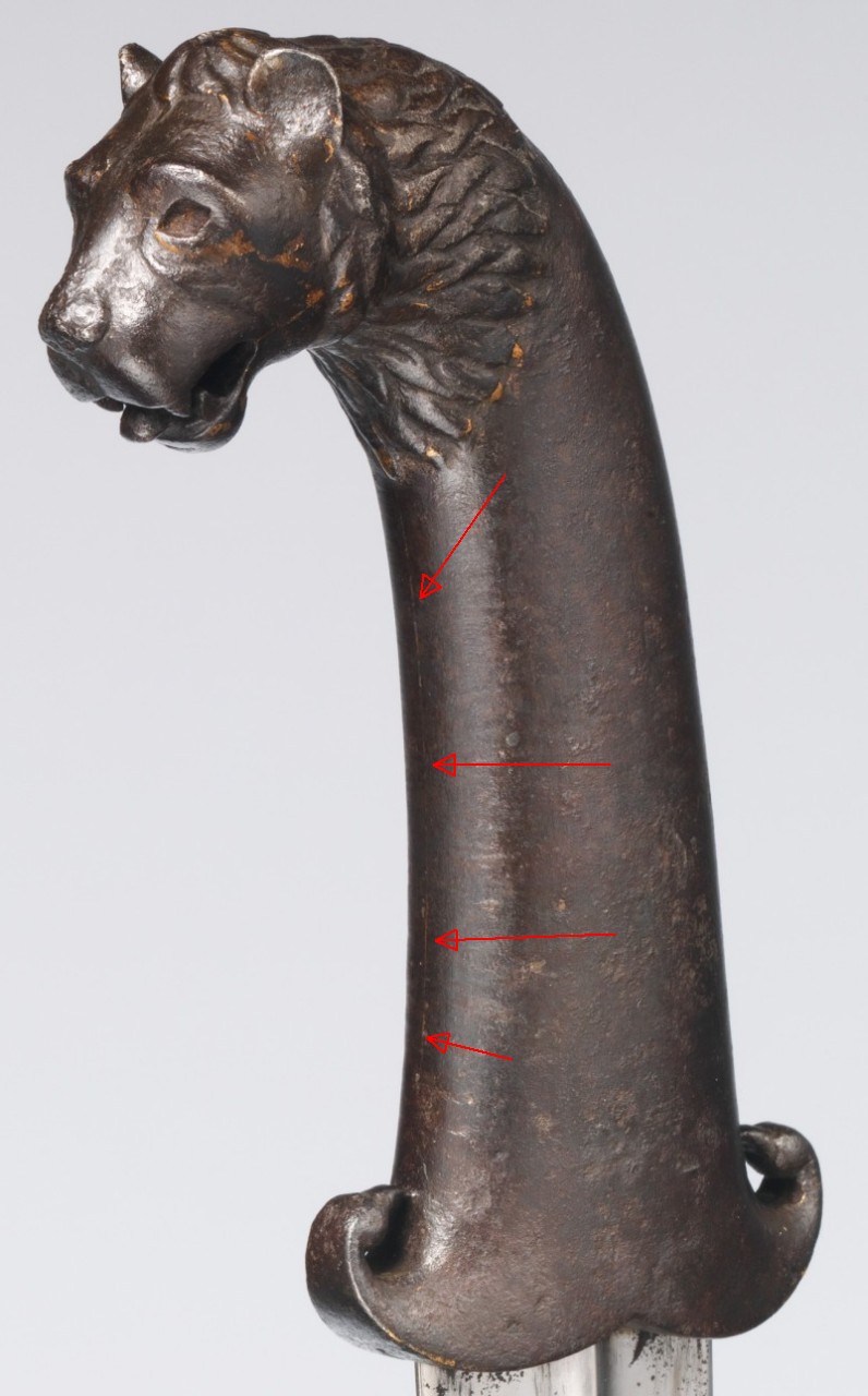

Here is one that seems to be carved iron / steel, from the Met Museum.
Indian khanjar dagger, 17th century, steel, iron, silver, copper alloy, H. 14 3/16 in. (36 cm); W. 3 1/4 in. (8.3 cm); Wt. 12.8 oz. (362.9 g), Met Museum.
Indian khanjar dagger, 17th century, steel, iron, silver, H. 14 3/16 in. (36 cm); W. 3 1/4 in. (8.3 cm); Wt. 12.8 oz. (362.9 g), Met Museum.
Isn't it copper or brass?!
Anyhow, the margins of the hilt are pretty much like those of the one in the original posting.
But again... 17th century (namely 1600+) ?!?! I doubt! Much more likely 19th century!
I am not sure if it was cast or carved but the hilt is iron according the the Museums description. Now here is an interesting statement. "This dagger is exceptional in that its hilt is made entirely of iron." This seems to indicate that in the opinion of the Museum, iron / steel zoomorphic hilts were not common.....humm.
Animal-head daggers came into fashion at the Mughal court in the second quarter of the seventeenth century. Horses were the most popular subject, followed by nilgai (a large antelope from India), lions, tigers, goats, and camels, usually carved from nephrite jade, serpentine, marble, or ivory.
This dagger is exceptional in that its hilt is made entirely of iron. The lion’s mane retains traces of silver, and its deep-set eyes were formerly jeweled.
These additional photos quite clearly prove it is iron.
Maybe they consider it exceptional for 17th century. Maybe they consider it exceptional because thy didn't see another. However, I have seen a few and I don't think it was exceptional in the 19th century.
Moreover, you found yourself a couple of iron carved zoomorphic hilts.
I found others (at least a couple of the ones I indicated are iron).
Now how many more do you think are needed to officially say they were "common"?!
What relevance will it have as the next question might be "how common" or "define common"?!
I believe the essential point was to demonstrate the existence of such hilts as early as 17th century and whether there were only one hundred made or ten thousand is less relevant.

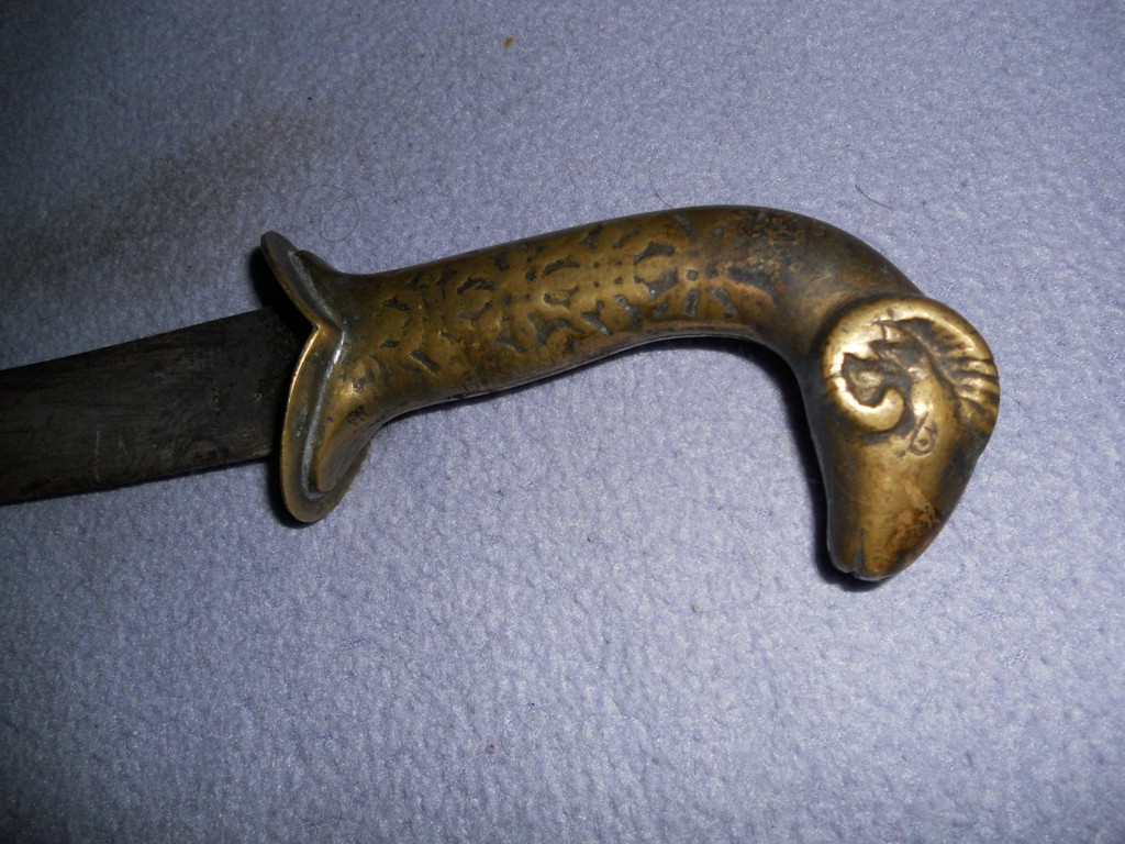

Here is another one with a horse head hilt, this one though is described as being cast, I think the lion head one may be cast as well, there seems to be a what could be a casting line on it (red arrrows).
Indian (Mughal) khanjar dagger, 18th century, watered steel hilt cast in two parts, the head with its mane to one side, the forelock falling on the forehead, the mouth open, with finely cast nostrils, two rivets to hold the long double curved, double edged blade of fine watered-steel, with central ridge, 17 3/8in. (44.1cm.) long.

One thing I'm noticing in the hilt photos is that there don't seem to be a lot (aside from ones that are modern) where there are horns or ears that stick out very far. It's one thing for a hilt to be carved to look like a lion/tiger/bear/etc, but perhaps it's entirely another for it to have actual horns. My dagger appears to have horns made separately and welded into place. Or...it's just occurred to me...perhaps they're epoxied into place. There's a lot of blackness and discoloration right around the base of the horns. Is there a non-destructive test for epoxy or other glues?
I assume that if you polish the area until it is completely free of oxidation, and examine it with a magnifying glass, you should be able to tell if it was welded or glued. But this might be seen as destructive already.
PS: However, this is a very interesting observation that would almost certainly indicate a much more recent production.
