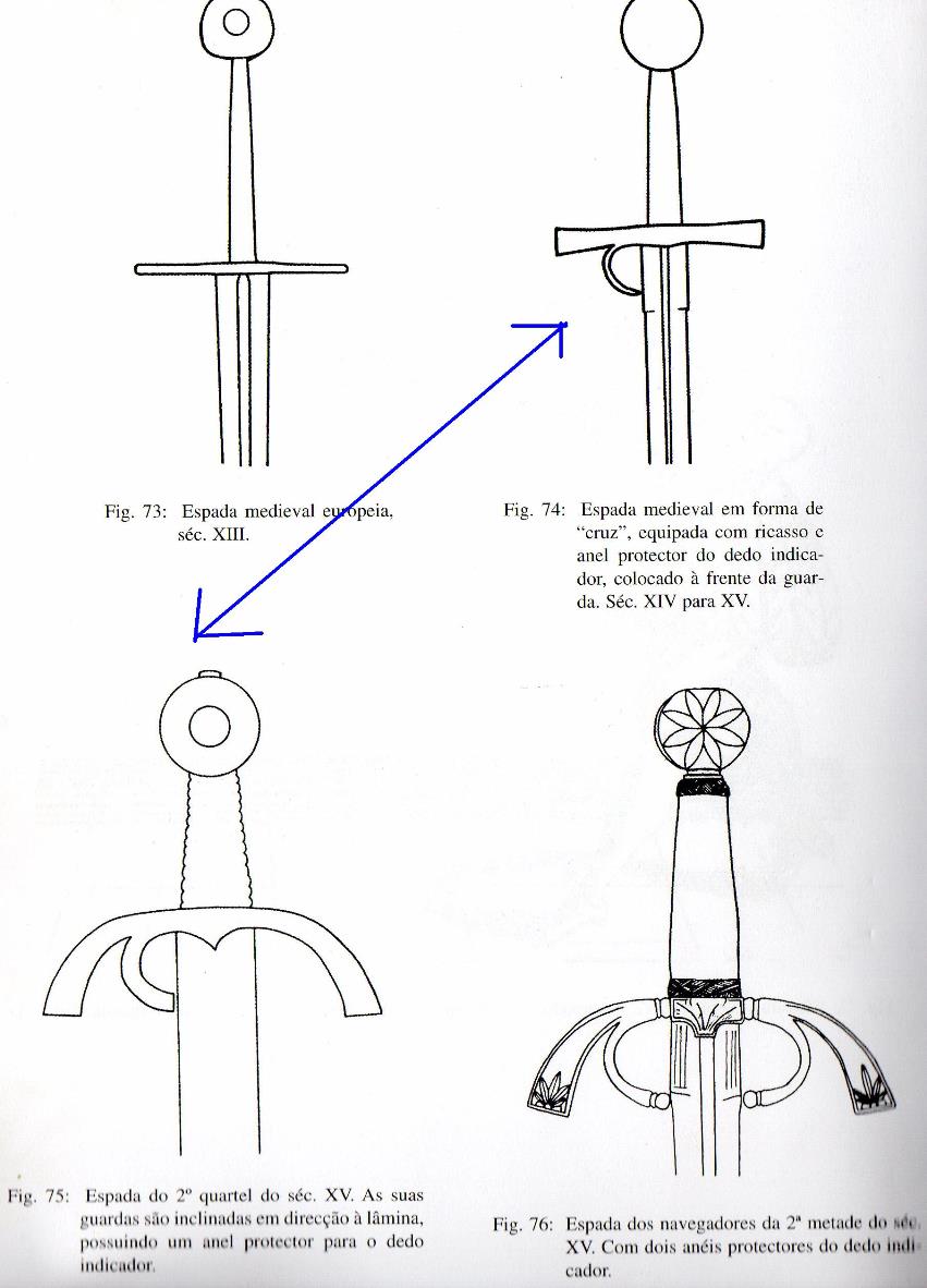

I am going to add something not so valid here but, for what it is worth ...
In the eyes of historian/collector Rainer Daehnhardt (author of HOMENS ESPADAS E TOMATES), the finger protection appeared in fusion with late medieval cross guard swords, which he places in the transition from XIV to XV centuries. As seen in the sketch, he pretends that this was also the beginning of the ricasso solution.
Later he shows the same type of finger guard in a sword with a guard of curved quillons, now dating it from the 2nd quarter XV century.
