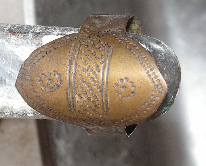

I have a matchlock with these saddle bands, but have not seen David's saddles he mentions.
See below;

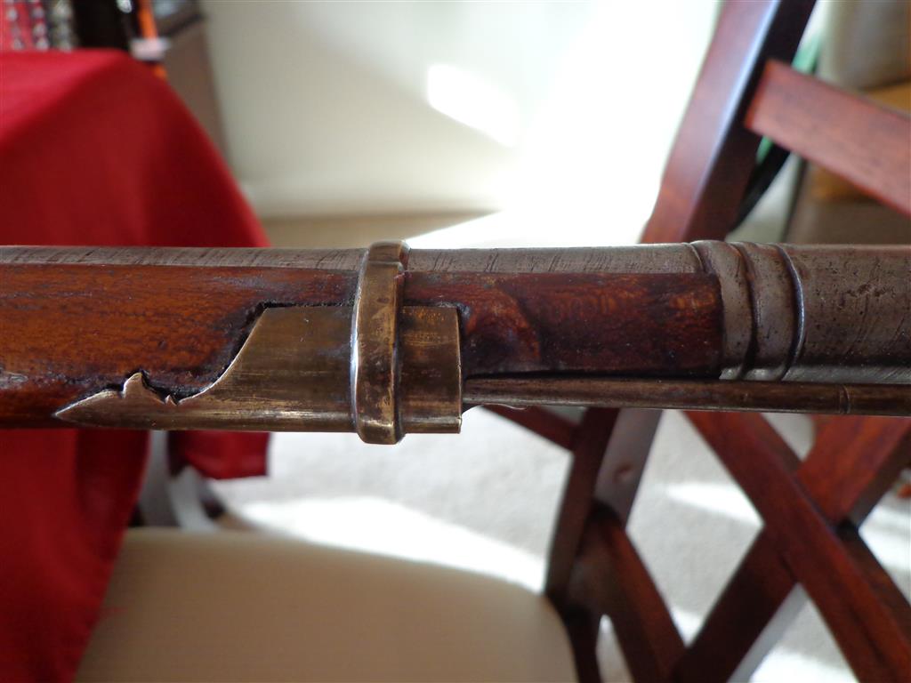

Hi Richard.
If you go to my Thread from January 14, and look at photo #6 and #12, you will see the so called re-enforcement saddles under two of the barrel bands on my Torador. But I believe the primary use for these was to help support the METAL bands. The reinforcing bands would not be necessary if you are using leather bindings. You could also simply use a thin piece of DRY flat leather on top of the barrel portion before wrapping the DAMP leather lacing (?). Just a thought.
Rick http://www.vikingsword.com/vb/attach...d=161399&stc=1

Hi Richard.
Finally back home. LOL That barrel band looks Afghan to me. You see this style on Jazails. But I still like the colored leather bands idea.

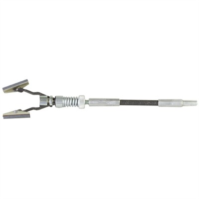

Shotgun Hone: There are a couple different ones out there. Here is a pic of the one I use. The stones actually pivet as you go back and forth in the bore. Would also automatically adjust to get the slightly smaller restricted area. They are very inexpensive, and you can purchase extra stone sets. Works great even by hand. Just twist as you go back and forth. They also make a polishing tool with compound.
