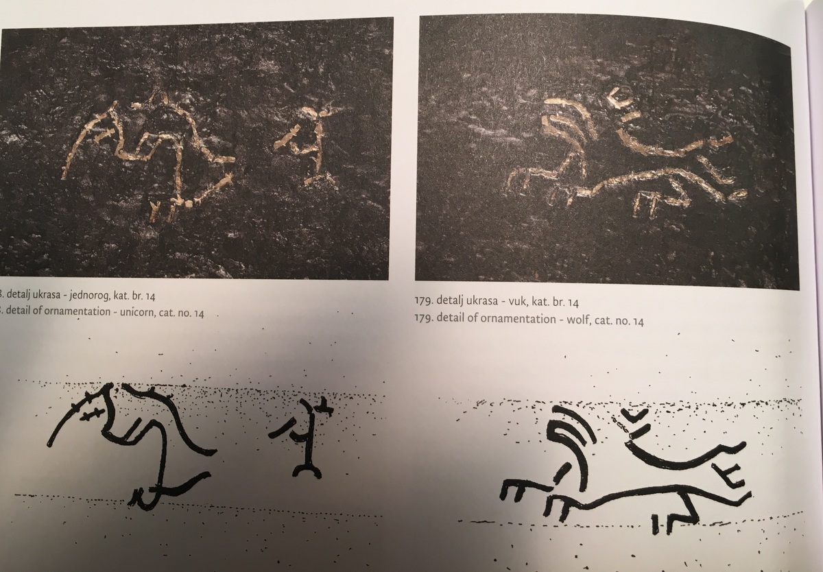

Default unicorn against wolf
the Unicorn has one horn and the wolf not, furthermore the tip of horn always points toward the point so that the force is directed to the opponent.
the horn of the unicorn is always clearly recognizable in the inlay of a sword.

Thank you so much Jasper, excellent images illustrating these markings.
Actually what I meant, in my bungled wording, was that unicorns were among creatures which were represented in these artistically stylized renderings, many of which could not be discerned. Obviously that distinct unicorn feature would be readily spotted, making that one of the exceptions.

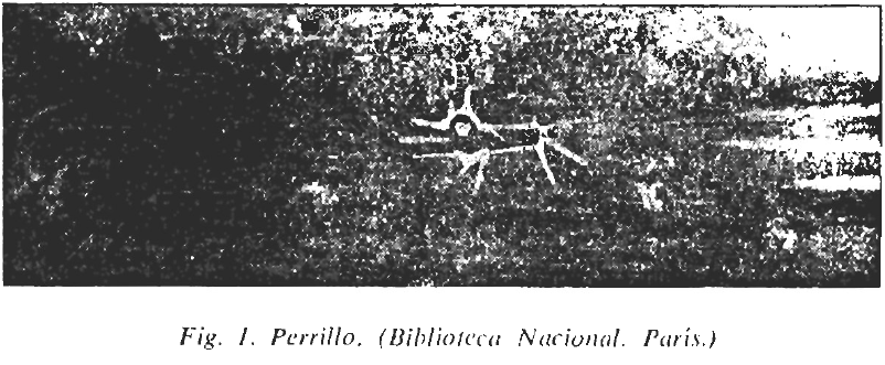

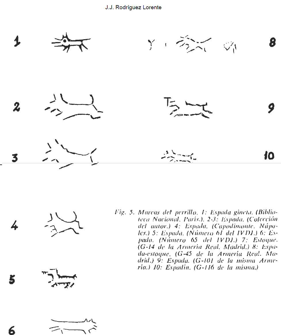

We may read in a paper by Rodriguez Lorente that, when the beast present in a blade is of Spanish origin, usually comes accompanied by other marks, whereas the German wolf appears only by itself.
Two Hispano-Arab ginetas can be seen in the National Library of Paris (as per picture uploaded) and in the the Armeria Real de Turin.
So it appears that in later times (XVI century) the perrillo was used by Spanish masters, like Sebastian Hernandez for one, as a quality hallmark.
Lorente also presents us a list of the various perrillo marks found here and there.
