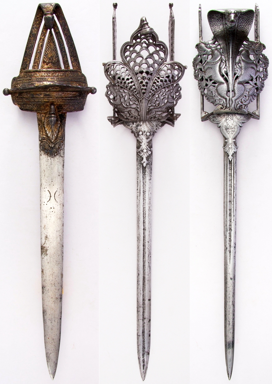

* this assumption is indeed reasonable with the number of European blades found in the Tanjore katars.
The Met has some very nice katar that are described as having European blades, several others appear to have them as well but it is not mentioned in the description.

If you have not already read this essay you should, it is from the book titled "Sultans of the South: Arts of India's Deccan Courts, 1323-1687" By Navina Najat Haidar, Marika Sardar, 2011.
Between the 14th and the 17th century, the Deccan plateau of south-central India was home to a series of important and highly cultured Muslim courts. Subtly blending elements from Iran, West Asia, southern India, and northern India, the arts produced under these sultanates are markedly different from those of the rest of India and especially from those produced under Mughal patronage. This publication, a result of a 2008 symposium held at The Metropolitan Museum of Art, investigates the arts of Deccan and the unique output in the fields of painting, literature, architecture, arms, textiles, and carpet.
"Swords in the Deccan in the sixteenth and seventeenth centuries: their manufacture and the influence of European imports" by Robert Elgood.
https://books.google.com/books?id=iW...page&q&f=false
