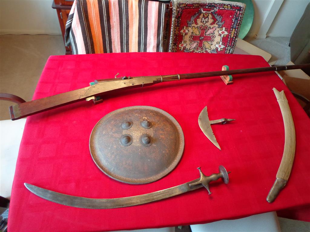

Very neat matchlock muskets you have there.
