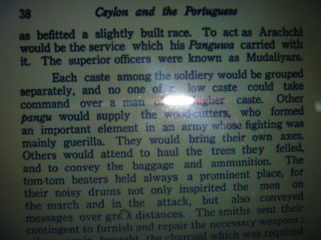

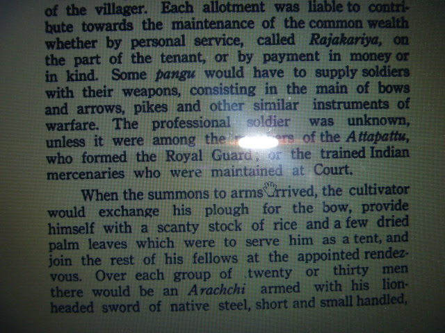

Salaams Jim, I was delving amongst the Portuguese/Sri Lankan VOC and other archives ..please see... http://books.google.com.om/books?id=...liyans&f=false which delivers a fabulous description entitled Ceylon and the Portuguese, 1505-1658 By Paulus Edward Pieris ~
...where I found a report relating to Sri Lanka 1520AD .. on what I can only describe as a sort of Sri Lankan territorial army set up where land owners provided military groups in time of need to the rulers... One such page presents the description of a sword carried by the commanders of these small sub units as being small with lion headed hilts;
Since these were for fighting against the invaders...( in 1520 this was the Portuguese...) this document provides evidence that the leaders of these small militias were called Arachchi and had superior officers over them called Mudaliyars.. proving not only that the Mudaliyars leadership were early Sri Lankan invention not working for the Portuguese but against them...(On the home team so to speak !) and that there were Sri Lankans Arachchi in 1520 armed with Kastane!! whose blades were indeed made in Sri Lanka and not imported!!
That suggests that the Kastane was not a Portuguese invention at all... but may still of course have been designed around an earlier imported style perhaps via Hormuz where the Moors often traded.
(The emphasis on the weapon design other than a possible rough framework hinted at as maybe influence from a European derivative would illustrate the deeply historical and religious nature of its development and is an area that I would later like to place some detail.)

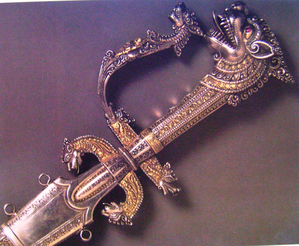

The quillons of the Kastane seem not to be actual functional defensive mechanisms in that they are too small to allow a finger to be inserted for extra purchase in the strike nor do they allow for the trapping of an incoming sliding blade in the usual manner of other quilloned swords. There is hardly a gap left to enable this action indeed the blade at the very throat is delberately less broad making that action impossible.,, and so that the quillons finials are closer to the blade; No gap no trap. See photo below.
(The situation of the long rainguard may pose an interesting disarming function but will be discussed later on isolating that feature.)
On reflection it appears that the device we call quillons is actually from a much earlier period than the earliest quillons in western weapons ;The Vajra protrusions seen on Buddhist ceremonial axes. Pictures below.
The finials are of the minor Deity style (of various possible names) but generally in the Naga or serpentine head type. They are extremely ornate but have no apparent practical function... except ornamentally or as a possible weight or balance factor.. though that is somewhat thin (excuse pun ) since some Kastane don't have quillons.
Comments welcome...

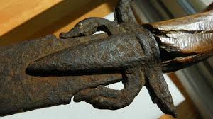

Taking on the Rainguard; It appears as a peculiar and extended triangular protrusion. Could this have been utilized instead of the quillons for trapping an oponents sword?.. and as a rainguard and locking mechanism into the scabbard ~ clearly its main function...Interestingly it is usually decorated with a foliate or peacock tail feather stylistic decoration associated with several Deities(Makara and other) but also occasionally thereupon sits a funny looking face which is the half humanoid monster "Kirtimukha" on the Kastane at my last posting. Otherwise often carved and painted typically above ancient architectural temple doors.
From Wikipedia; Quote"The word mukha in Sanskrit refers to the face while kīrti means "fame, glory". Kirtimukha has its origin in a legend from the Skanda Purana when Jalandhara, an all-devouring monster created from Shiva, third eye willingly ate his body starting by its tail as per Lord Shiva's order, who pleased with the result gave it the name face of glory. Some authors have compared the Kirtimukha myth with the Greek myth of Ouroboros.
The Kirtimukha is often used as a decorative motif surmounting the pinnacle of a temple or the image of a deity, especially in South Indian architecture. This face is sometimes assimilated to, or confused with, another sculptural element, the lion face (Simhamukha). However, in order to be a Kirtimukha it has to be engaged in swallowing, for the Kirtimukha is the figure of the "all consuming" This monstrous face with bulging eyes sits also as an embellishment over the lintel of the gate to the inner sanctum in many Hindu temples signifying the reabsorption that marks the entry into the temple. Mostly it is only a face, although in some places its arms are portrayed as well".Unquote.
Is what is being portrayed the spilling of minor Deity form via Makara, Nagas and Kirtimukha(swallowing) etc culminating with overflowing and exuberant, lavish, decorative, mythical detail over the quillons and rainguard onto the blade at the throat and onto the scabbard? Thus it is hardly surprising that such a weapon is heralded and so important in the history of Sri Lanka...perhaps underlining its home grown, home produced nature?

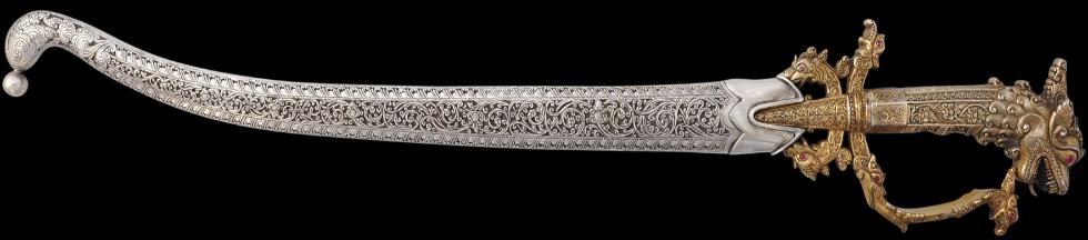

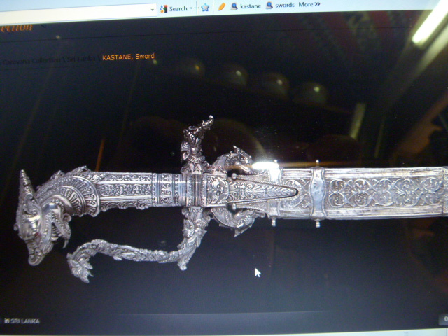

Naturally I am focused upon the short sword below with the exceptionally long rain-guard and the short blade which I perceive is of Kastane blade proportions and on a hilt with several similar constructions. I take this as evidence of a much earlier short sword style which must be taken into account when deciding on origin of species...thus predating any European influence.

Salaams All...
The reason why there is an apparent gap in the detail regarding Pre Portuguese and post Portuguese kastane making in Sri Lanka was because ....
according to http://thakshana.nsf.ac.lk/pdf/VIDUR...%2019_1_30.pdf
Quote"In ancient times the caste system was mainly occupational based. As a result technology was preserved by being handed down from generation to generation.The caste system was developed to maintain the socio economic systems of the day.The social system changed with the advent of foreign rule and as a resulot the traditional technological know how was lost under colonialism.
Another reason for the decline was the cheap import of iron and steel implements imported from Europe and the inability of the indiginous iron producers to adopt new advances in technology".Unquote.
In real terms this would not have started to take effect much before 1550 during Portuguese partial control, though, once the Dutch, driven by the VOC, which fed on trade (and indicated by VOC stamped kastane blades for example) and the EIC of the English (though they did not apparently stamp blades of Kastane) until the modern era it seems iron/steel production would have been, at best, only scant. The break then in indiginous iron/steel production probably occured in the mid to late 1500s though some local iron/steel may have been produced in the Kandian Kingdom thereafter but dwindled further under English rule as they seized the entire country.
In conclusion I place this as possible evidence to explain our misunderstanding and the gap in proceedings possibly tricking the reader into thinking the Kastane was introduced when in effect it has been a purebred Sri Lankan Icon from its early pre European period.
Ibrahiim al Balooshi.

Shown Below ~The Kastane hilt illustrating the humano/crocodile face half way down the knuckleguard framed by emissions of fire/the protective swish of a peacock like tail.. from two accompanying Serendipiyya/ Nagas.(is a picture showing the odd humanoid face which is a deity often associated with Makara (though not always). Picture from Forum see http://www.vikingsword.com/vb/showth...8&page=2&pp=30 #56.
