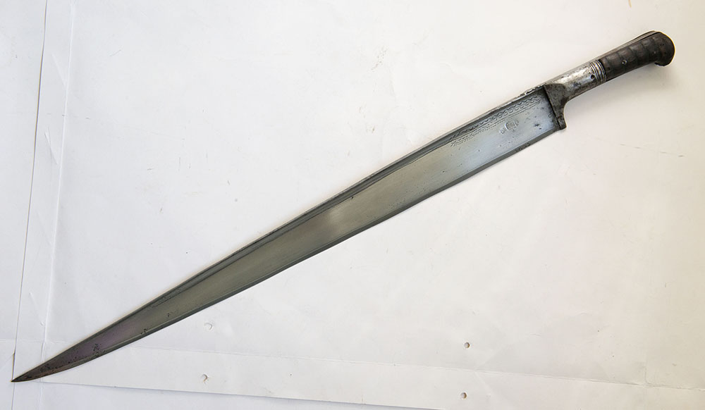

The so-called Khyber Knife (presumably called Salawar Yataghan locally) is an example of a typical Afghani bladed weapon, a mix between the short, - and the long-bladed configuration (Fig.1). It was called “sword” by Stone (4), but it may also be named dussack, or short sword, as defined by the modern terminology.
First, the name. Both terms, - Khyber Knife and Salawar Yataghan, - are unsatisfactory. The latter one was first mentioned by Egerton (5) and repeated by Stone (6). That was how it entered the contemporary usage. Nevertheless, native Afghans themselves cannot explain the connection of this term with any of the 3 main languages: Pushtu, Dari or Farsi. Moreover, we are hesitant to use the adopted word “yataghan” for a traditional Afghani weapon. The name “Khyber” is also unsatisfactory. It derives from the locality where this weapon was regularly observed. There is a stable tradition of transcription of the term “Khyber Pass”, that is derived from Pushtu: د خیبر درہ. Why then do we call the weapon Khyber Knife, if Khyber Sword would be a more precise term due to its respectable size? The only explanation for this term is its simplicity: short and convenient, and most importantly, - traditional. While we fully understand the imperfection of the established terminology, we shall henceforth employ the established term Khyber.
In its classical variant, the Khyber has massive, straight, T-reinforced blade of substantial length, widened at the basis (root), so that the latter actually plays the role of a guard. The back of the blade is as a rule straight and undecorated. The handle consists of 2 horn or bone slabs (the bone ones are often assembled of separate pieces). The scabbard is conical, made of wood and covered with leather or fabric. Frequently there is a long metal chape that is often decorated with chasing technique. The handle enters the scabbard by ~2/3 of its length, and the beak-like pommel is the only part visible, making the sword very convenient for rapid withdrawal. Egerton mentions that Gilzais, Khyberies and members of other tribes carry on their hips swords in massive scabbards that are about 3 feet long and refers to the illustration showing a typical Khyber (7). The length of a typical example is between 45-100 cm.
