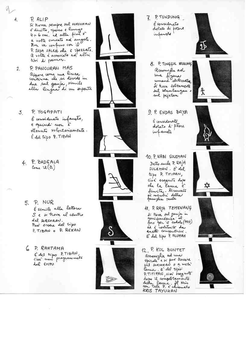

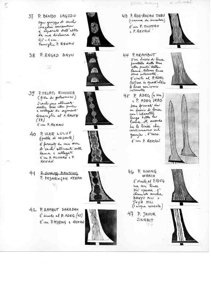

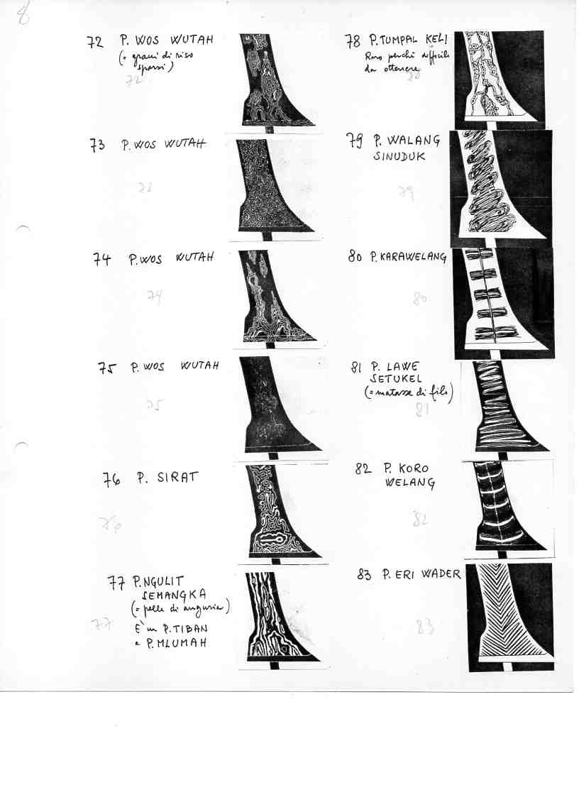

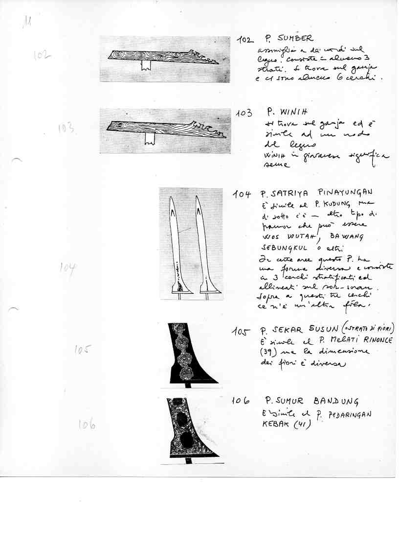

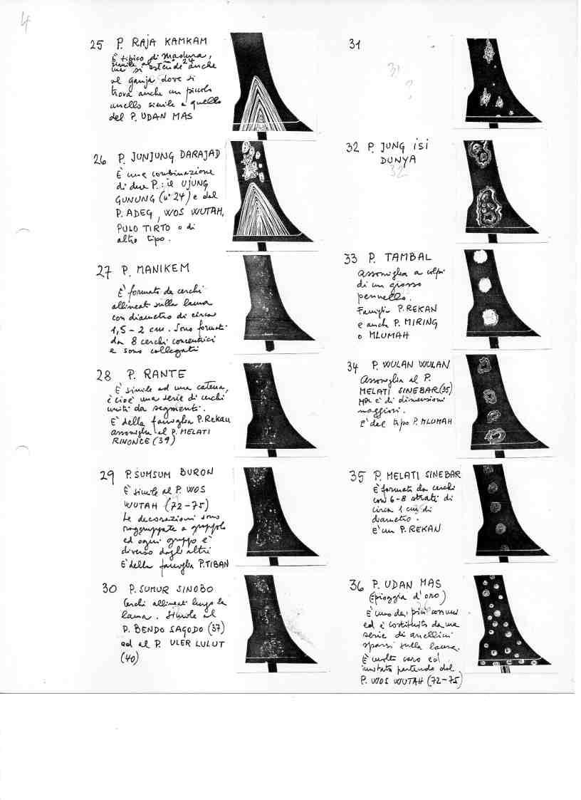

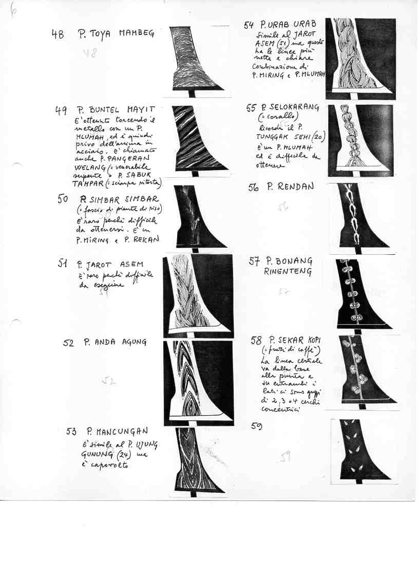

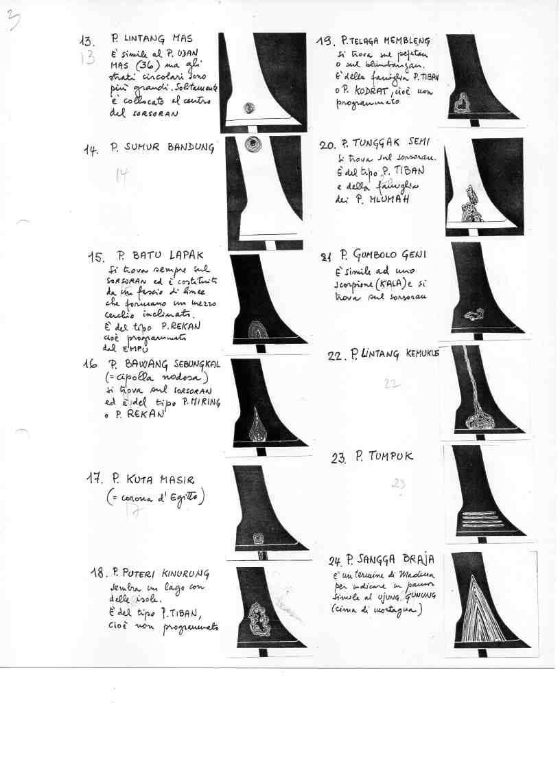

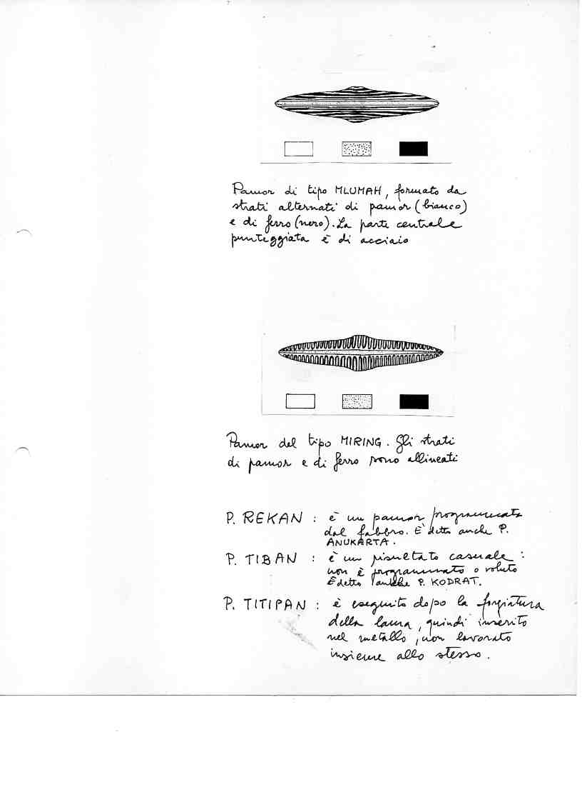

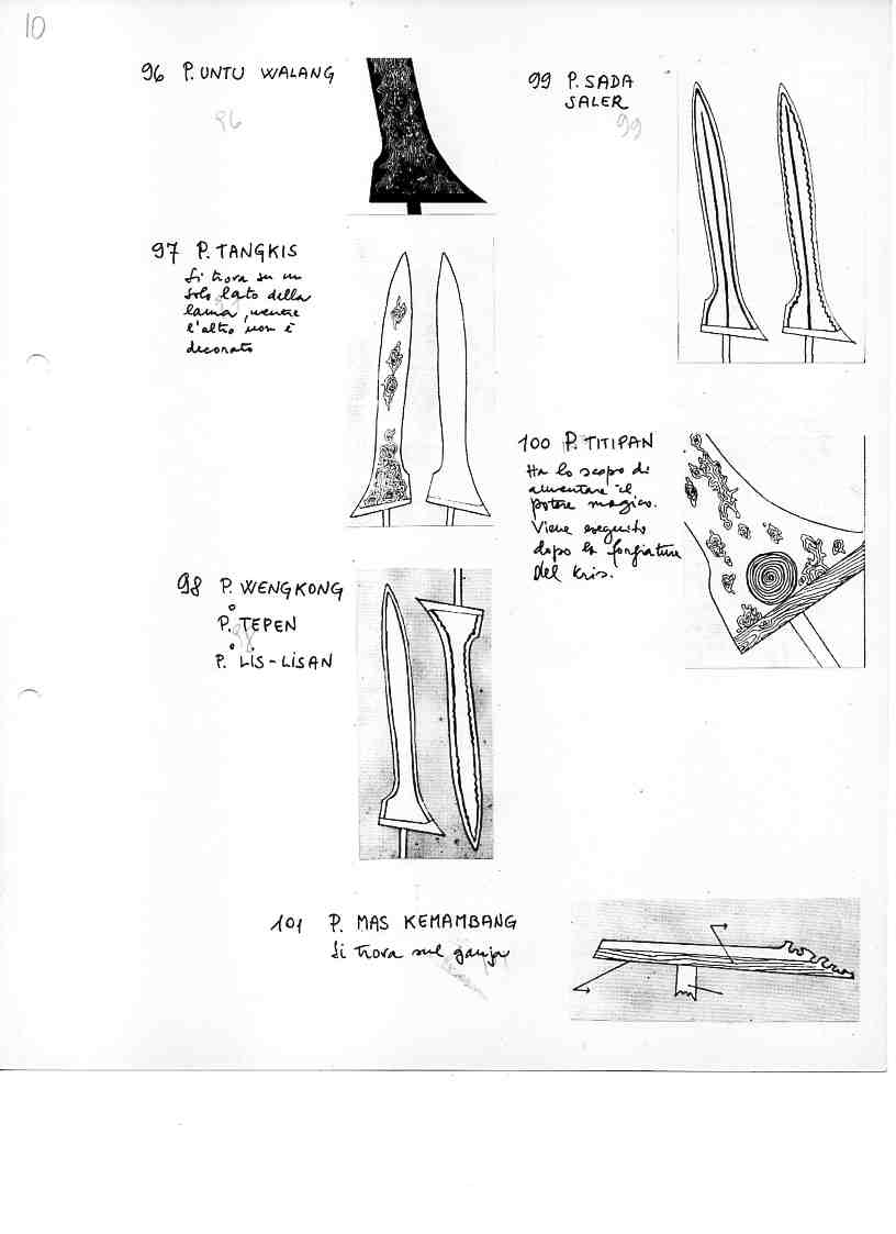

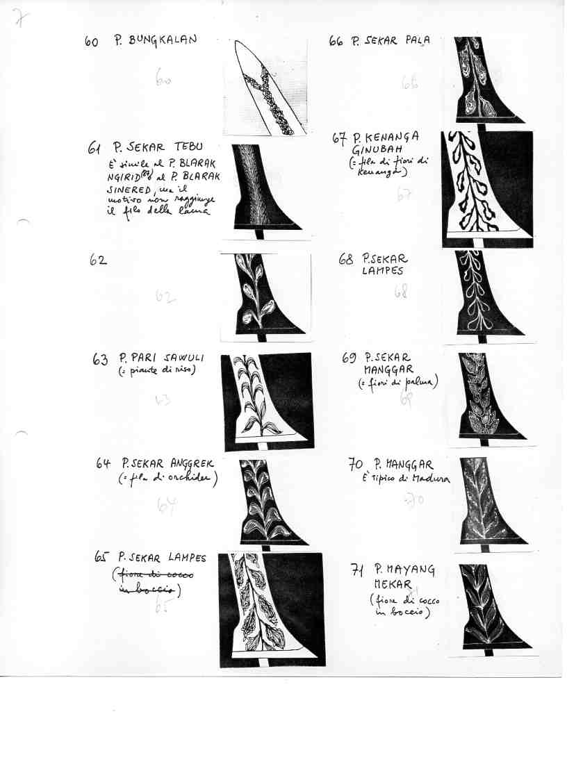

Far from being exaustive, I took the enclosed designs of various pamors from the "Ensiklopedi". My intention was to make a sort of handbook to identify pamor designs. The list is incomplete and is missing important pamors (mainly the newest ones). Moreover some designs are very badly reproduced in the book itself.
A great work would be to prepare a file for each pamor as simplified in the drawings and join the largest possible number of photo of real kerises with the same pamor.
My work is included.

Posts: 500
thanks, Grazie, my mother tongue is Italian (I am naturalized Dutch) so that is an extra bonus
Old 29th March 2022, 11:34 PM   #49
Posts: 7,230
Nice job GIO

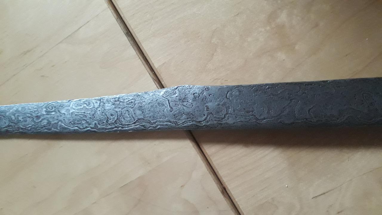

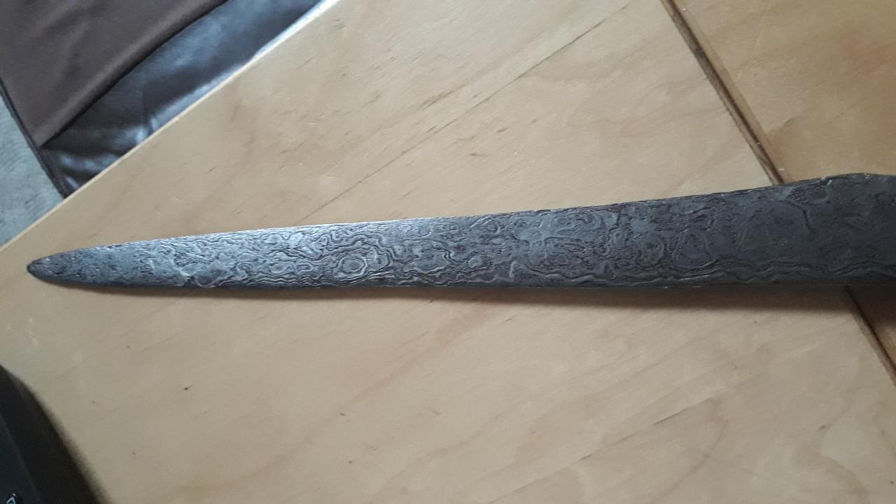

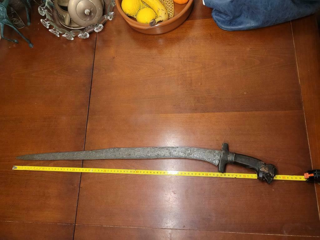

Are pedangs welcome on this thread/board? I have only one blade with pamor so far, and it is perhaps not as fancy as some of the blades on this thread (a bit of damage to the hilt), but I really like handling this little sword. The weight and grip angle makes it feel both choppy and stabby (it brings the point exactly in line with the outstretched arm without hyperextending the wrist, and the forward slant makes it feel somehow "eager" to chop, if that makes sense).

Originally Posted by Richard Furrer View Post
Not exactly what I had in mind Sirek.
I am not personally seeking a discussion of pamor per se, but a gallery of patterns.
As a blackssmith I wish to reverse engineer the techniques used in creating the patterns and as such I collect photos (and keris) which I find interesting.
Ric
Interesting. Try this
Actually no. From the start we have reserved this forum solely for the discussion of keris and keris related subjects. But is is an interesting pedang and you should start a separate thread about it on the Ethno Forum.
