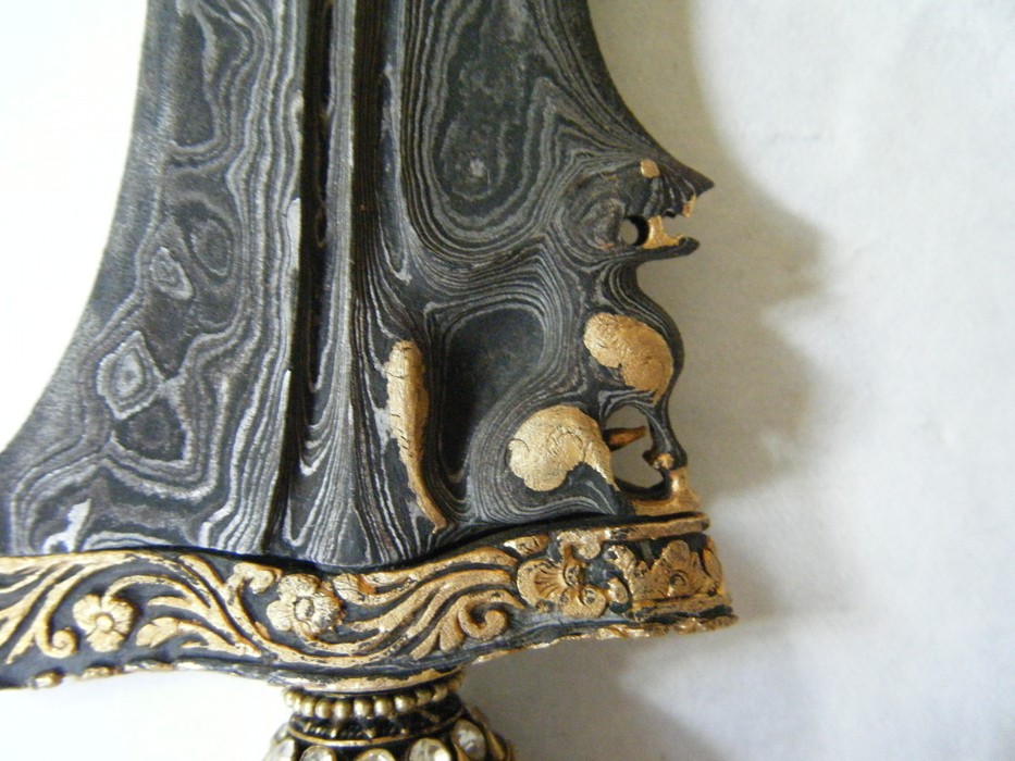

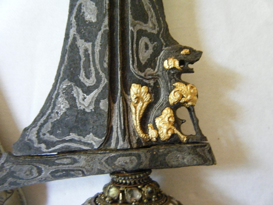

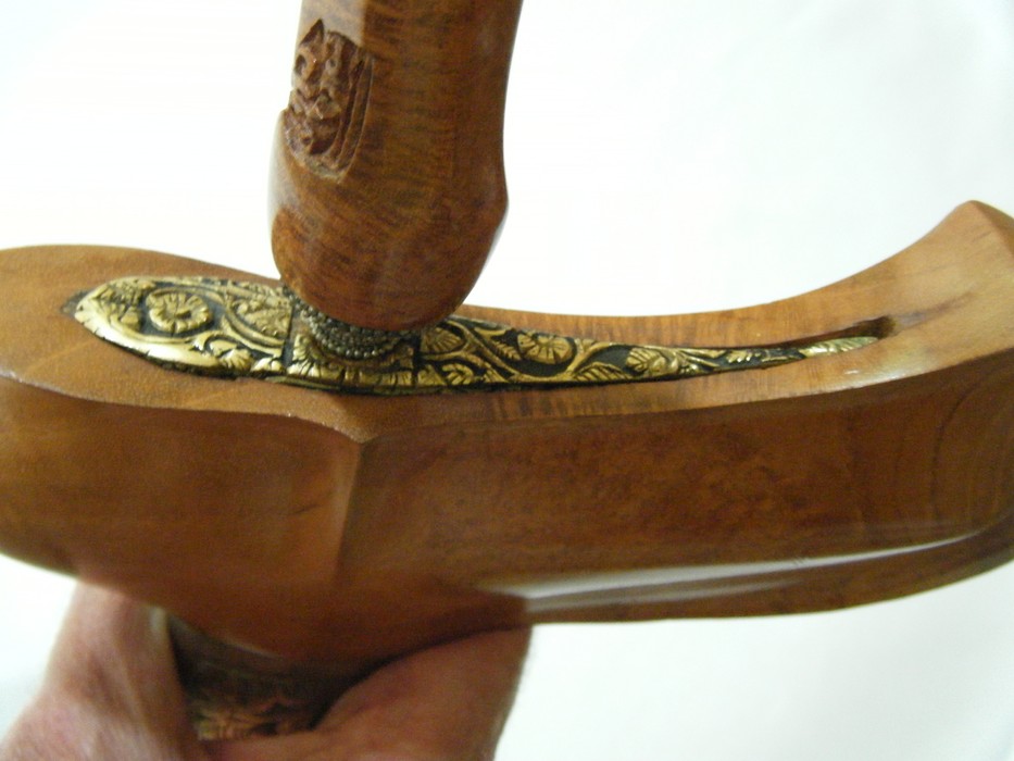

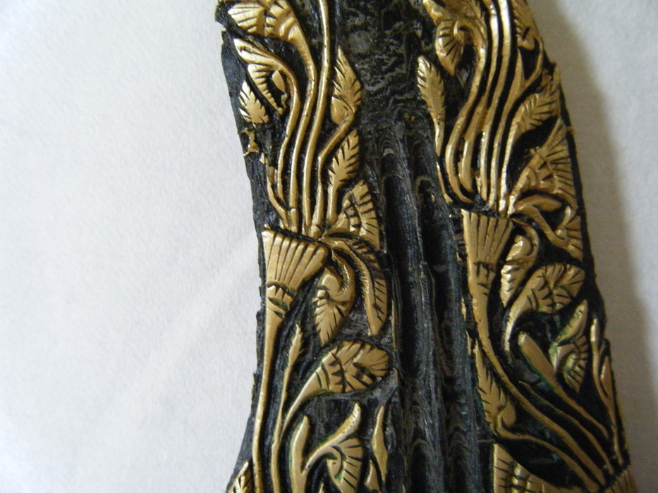

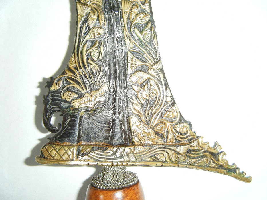

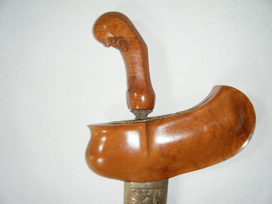

Have received the keris and it is not so good as supposed but also not bad as many I have seen before. Here some first fast taken pictures.
Old 7th August 2012, 03:15 PM   #48
The kinatah seems to be from brass and very thin gold washed.
Old 7th August 2012, 03:44 PM   #49

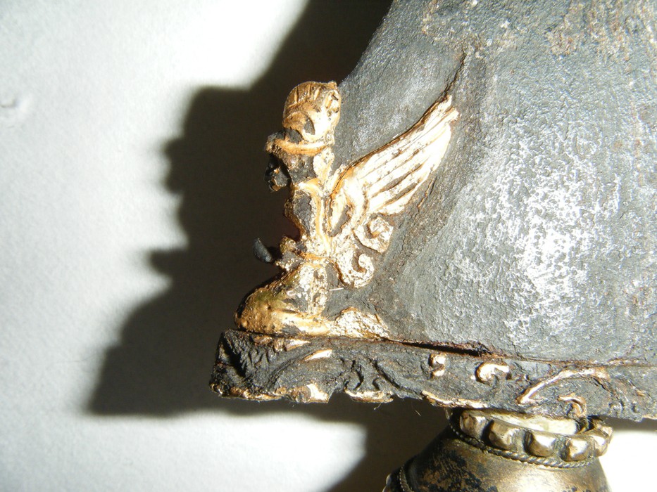

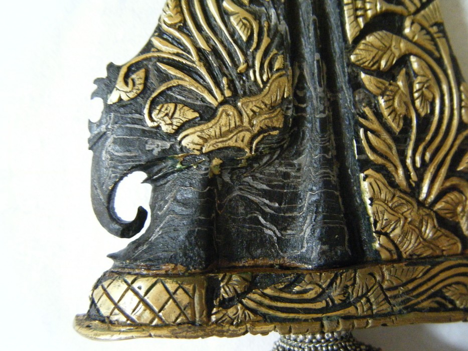

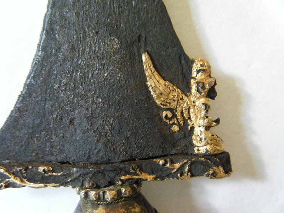

And here, since Jean asked for, pictures of an IMHO old kinatah blade.
Old 7th August 2012, 03:48 PM   #50
By this blade i am unsure. I think that the blade is original but the gold is newly reworked.

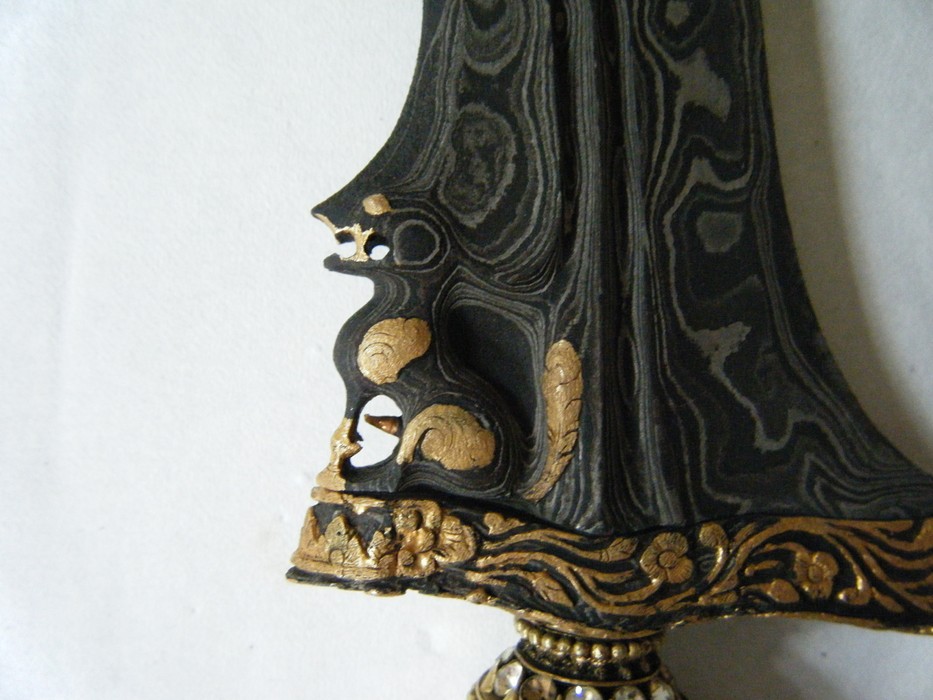

And here recent Madura work.
Hello Detlef,
You may test the presence of gold at a jeweller's shop or by using a gold test kit. I don't see clearly the presence of brass on these pictures as the kinatah looks shiny. May be low carat and thin gold coat? High gold content kinatah (22 kt) has a deeper colour.
Hello Detlef,
Thank you for the detailed pictures. This specimen is interesting because I am not sure that the Singo Barong is original to the blade: from the pictures there seems to be a discontinuity in the pamor lines at the interface of the blade and the singa, the pamor lines of the singa look denser than on the blade itself and the colour of the iron is a bit different. So the singa may have been welded later on the blade, what do you think?
I have a similar Singo Barong blade but it is more difficult to determine if the singa is more recent than the blade or not because it is more covered by gold, I will send detailed pictures in the next days.
This is my impression from the pictures but other opinions are of course welcome!
Old 7th August 2012, 08:20 PM   #54
Originally Posted by Jean
Hello Detlef,
Hello Jean,
have a look at the last picture, at the gonjo you can clearly see the brass at some places where the gold is gone. And I have cleaned the green copper compound which is clearly a sign for brass.
Old 7th August 2012, 08:24 PM   #55
Hello Detlef,
Hello Jean,
have had the same thoughts before but I am very very unsure by this. When it is like you suppose someone have done a good work.
This may be an "old" blade", but the winged figure appears to my eyes to be a much later addition, as then would be the kinatah. Doesn't seem like the type of workmanship i would expect from older kinatah, though the material may well be real gold.
