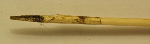

Hi,
A little update. I decided to insert a cocktail stick into the touchhole just to see if the 'blockage' went all the way, should have done this before. The area is free of any obstruction and I can hear the distinct rasp of grains!!! when moving the cocktail stick. As you can see the end of the stick is black and it smells of gunpowder, see photo. Am going to the tool store tomorrow so I hope to get a few bits to aid in the extraction process. Thanks for your continued interest.
Norman.

Hi,
Norman.
Hi Norman! Oh GREAT!!! Now we know there is powder in the breech of the barrel. It's now likely there is a lead ball in front of the powder. And, if your luck continues, there may be a patch between the powder and ball. There is no telling how long that load has been in there. As you have probably surmised by now, I'm thrilled with all of this. Wish I was there with you as your "helper" in extracting that load. Did you consider the compressed air method? Anyway, thanks so much for the update!! Keep us Posted. Rick.
