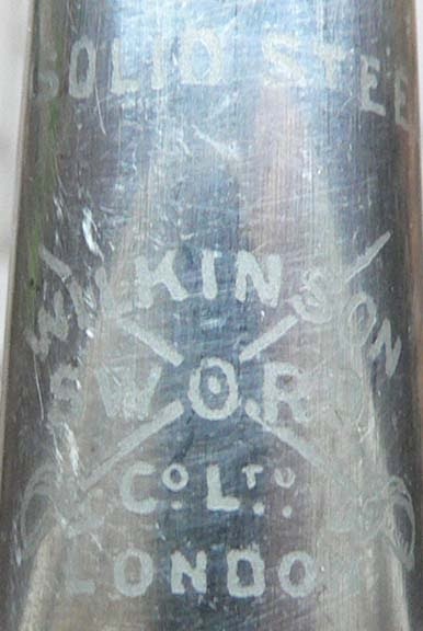

Wilkinson made these lances..This is a copy of the inscription.
