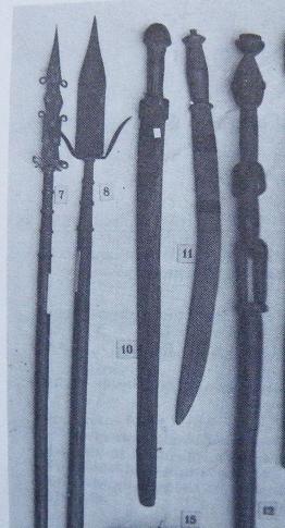

Here are a couple of images from the book "The Sherbro and its Hinterland" by T J Aldridge, 1901 (Sierra Leone), showing swords with similar shaped handles, for reference.
Plenty of scope for research here...

Dear Colin, I don't know the meaning of the holes and their filling but they are very common in central African blades especially in the Congo basin. I also suspect it is some kind of talismanic work. In the Congo blades the holes are usually filled with copper that surely had a talismanic significance but also great value. I do not have the sword with me and therefore I am not able to confirm that is an old cartridge case. I shall check. Many thanks for the beautiful photos. I love these old African photos. Many thanks also for the reference of the book that contain it. I already received in previous time the photo in the left side that is a late XIX century photo of a Mende chief. The sword is therefore Mende. The Mende sword is different from ours because it has a wooden pommel with a anular guard with rounded edges made of wood. It is separated from the forte and from the end of the handle by a brass or iron ring (ferrule in English if I remember well) that is missing in these example. Very great photos

I think I know the mutual friend with a Tomba sword in his collection! I think this is a case where we have a lot of inter related people groups with broadly similar sword styles. I don't have the knowledge to distinguish between them unfortunately.
As a dominant regional group the Mandingo would have I believe a large degree of influence over their neighbors and this probably extended to stylistic cues and weaponry.
Brass, or white metal fills in blades are fairly common in the area, as Mauro pointed out especially in the Congo. But I've seen similar things on swords more from the Sahel (Martin posted a very odd sword a while ago with several copper or brass dots like these).
Colin, really great pictures of the Sherbro! I particularly like the contrast between the chief and the men. The patterning of the cloth the chief is wearing is strikingly similar to what was coming out of major Hausa cloth production centers like Kano. Since I've seen a few trade blades in similar hilts might be interesting to see what we can find about trading between Hausa city states and this area.

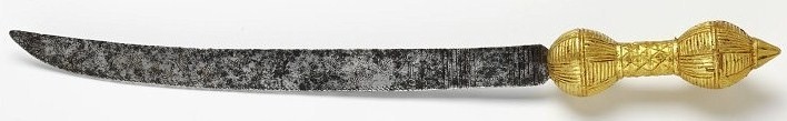

Hi

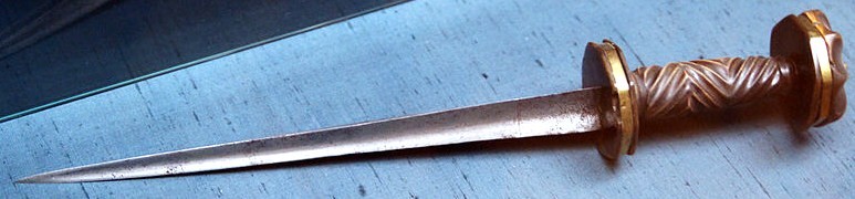

I would like to add a couple of ideas on these swords, particularly with reference to the distinctive hilt form.
West Africa came into contact with Europeans quite early on (15th century ?), and this had an impact on their material culture in a way not to be found in Central and Eastern Africa. Could it be that the hilts on these swords derive from European weapons ? The rondel medieval dagger comes to mind...
In addition, the form of hilt to be found on Ashanti (Akan) swords is also quite similar in form to that found on these Mandingo/Mende weapons.
A couple of images are attached to illustrate.
Of course its also still quite possible this hilt form developed within Africa quite independently.
Regards.

Hi Colin,
I love this type of discussion!
The rondel angel is intriguing, but first thoughts are that the rondel is a form marked by its flat terminals on the pommel and guard. The Ashanti swords, or what we are looking at from the Tomba/Mende are rounded. Which is not say the idea isn't without merit.
However, as I usually do with takouba, I like to examine things from the angle of practicality and how a form might be arrived at.
Given that these hilts are usually wood (the Ashanti example is somewhat more ceremonial) the shape seems like the most logical form you could come up with when trying to get a bit of hand protection, a bit of balance and a bit narrow enough to wrap your fingers around.
By which I mean it's not a hard shape to arrive at when putting together a weapon. I'm not sure Europeans need to be brought into the equation to explain it. For one thing, we don't have anything predating the Europeans which creates a big "oh" moment when things obviously changed. At least that we know of... The usual unfortunate caveat when dealing with African arms and armour. But just because we don't know doesn't mean I think, that we have to assume some sort of radical shift when Europeans arrived.
I guess my main point is, do we have any reason to suspect it required outside influence to create this hilt form? Personally I don't think so.
More direct European influence can be found for example in this Christies auction from a number of years ago. http://www.christies.com/LotFinder/l...jectID=4515427
Just my two cents/pence. :-)
Iain

I share the ideas of Ian that the possibility of influence are minimal although it is difficult to ascertain. Moreover, if we have to find an influence from the 14-15th century weapons I suppose we should to look at swords and not at daggers. Again we have should have to look at Kaskara, Takouba and even Mandingo swords or the nice example that Colin presented from a previous thread.
Ian why you do not start a thread showing the Mossi sword ?? I also have a Mossi sword and we could compare them.
