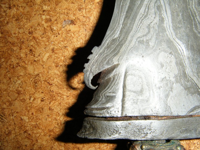

The best way that i can describe it is that the area in my keris seems to belly out as if it were pregnant. This is not the case as far as i can tell in most 19th-20thC Bali keris. It is a feature that i tend to associate with older Javanese dhapurs (which is probably why i thought it might be an indicator of age). I have borrowed a few example of Bali keris from the "Sold" gallery at Oriental Arms to compare.

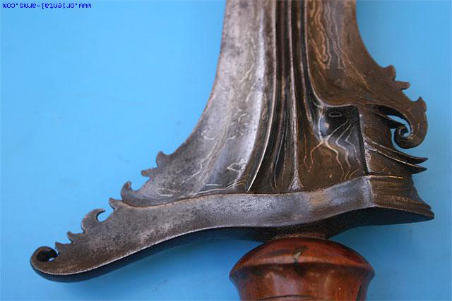

Regarding the slightly rounded form of the gandhik, I have seen this in a number of keris from both Jawa and Bali, and from various eras. I personally read it as stylistic variation that does not necessarily attach to any particular era or classification, but may be indicative of the work of a particular maker. In fact, in one of the keris that I made myself, I attempted a similar treatment of the gandhik, but it was not particularly successful.
Incidentally, the sogokan in the first keris you have shown from the Oriental Arms source appears to have everything that a well executed sogokan should have. This is very nice work.

And i do agree, that first one from Ari's gallery does indeed have a beautiful sogokan...
Old 20th February 2011, 07:23 AM   #40
Posts: 7,263
Its better than nice David, its excellent.
Which causes me to think that perhaps the gonjo may have been replaced on this keris. Not recently, but a long time ago, as the fit to the tungkakan is nowhere near the same level of craftsmanship as is displayed in the rest of the sorsoran.

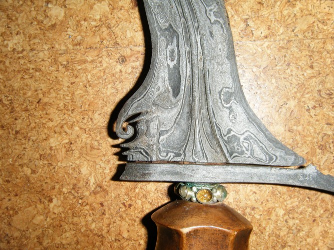

Hello David,
here are two Bali keris examples from my collection which have also a belly at the gandik area. Sorry for picture quality, I have taken the pictures just before with flash light. The first two pictures are the same keris.
