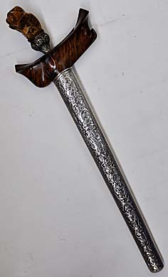

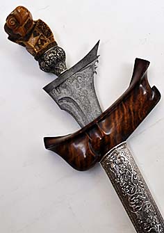

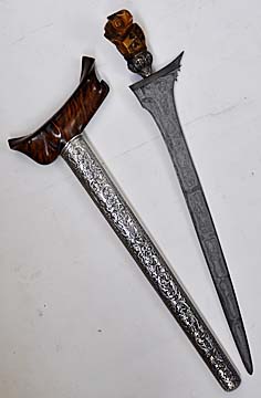

Originally Posted by kai
You have it in your hands - does it really look like a later replacement? From the pics the surface looks much smoother and the scroll-work more crisp; thus, this would be my working hypothesis if hands-on examination doesn't reveal hints to the contrary.
IMHO, Palembang style was much influenced to javanese style. We could still see until now, many old Palembang blades are sometimes quite similar to javanese blades. A ganjawulung fixed to a blade, is quite common in Java. And I think it could be common to Palembang style too.

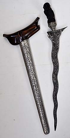

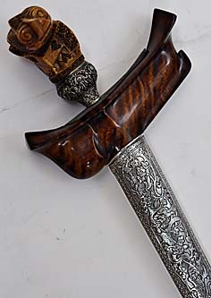

(Images below, the more complete picture of my Palembang keris, with another silver pendokok...)
GANJAWULUNG

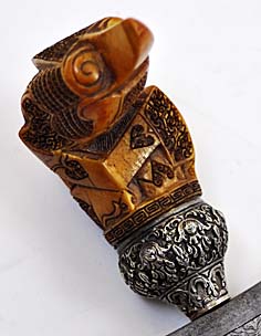

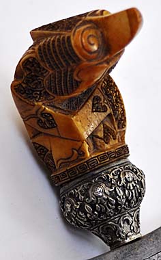

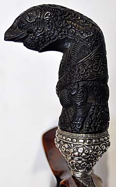

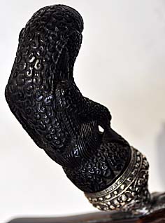

And another close up of the hilt and the silver pendokok...
GANJAWULUNG

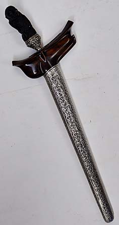

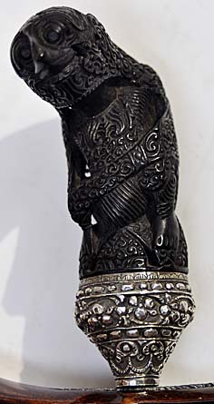

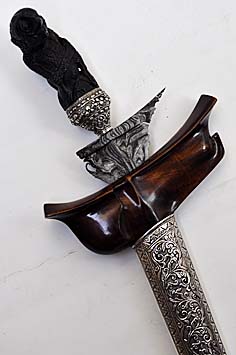

Dear All,
Another images of a Palembang keris, but with Cirebonese "buta" hilt. Is is a match pair, a Cirebon hilt on a Palembang keris?
GANJAWULUNG

IMHO, Cirebonese hilts are the most flexible. It can match any Javanese blade and Wrangka, or Malay blade and sarung..... even Buginese's.

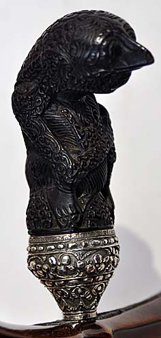

Hello Pak Ganjawulung,
can you show us a closeup view from the hilt?

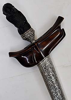

Posts: 991
Default Cirebon Hilt (close up)
Images of my Cirebon hilt, as requested by Detlef...
GANJAWULUNG
Old 3rd June 2010, 04:03 PM   #54
GANJAWULUNG
Thank you, very fine and dilly carved hilt and doesn't disturb the overall impression of the ensemble even it is from Cirebon.

Default More display
More on Palembang hulu and keris...
Old 6th October 2011, 08:50 PM   #59
Hello Ganjawulung,
very nice handles and blades! Are the pendokos on the left and right old or new ones?

Posts: 991
Old ones, dear Detlef. I hope you could see the different yellow of those golds. Not dark yellow, but light yellow... Later I would post the close ups.
Thks
