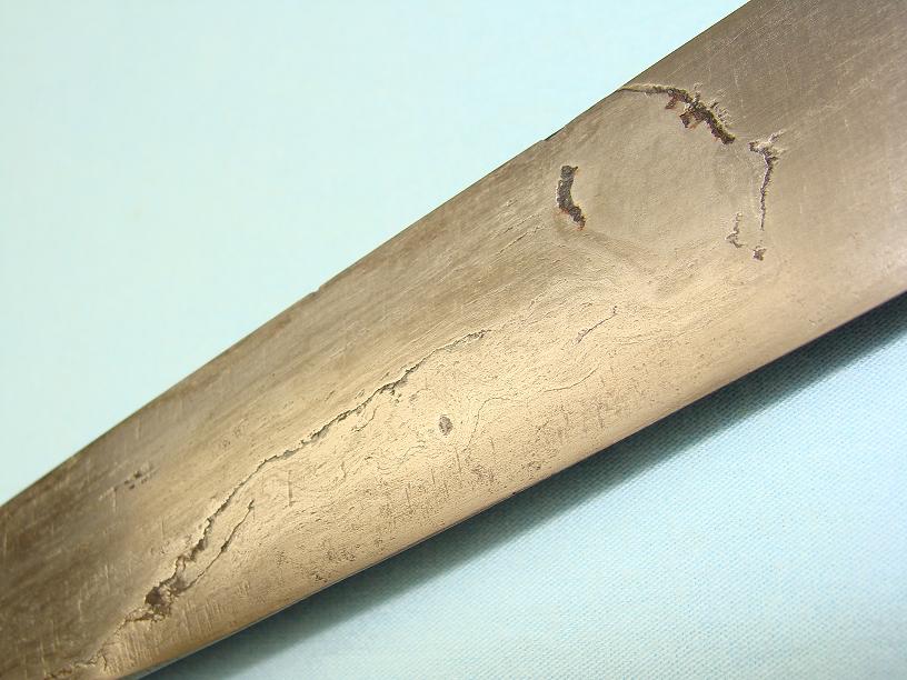

I spoke with Al Pendray today he saw the pictures and thinks it is Indian wootz and he agrees it wasn't forged from a billet to him it seems the blade was reworked from a larger sword blade.

This is a blade I would love to see in person. I do hope you have an opportunity to take it with you to the Ashokan seminar so that several people can have a close look at it. It is always better to form a firm opinion from something like this in person versus in pictures. At this time, I still remain skeptical and do not believe it to be wootz but I would love to see it in person and change my mind. If it is a reworked blade, I am curious as to what the spine of the blade looks like. Does it show any evidence of lamellar activity or the typical "cleft" one often finds on wootz blades?

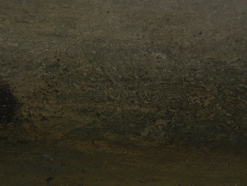

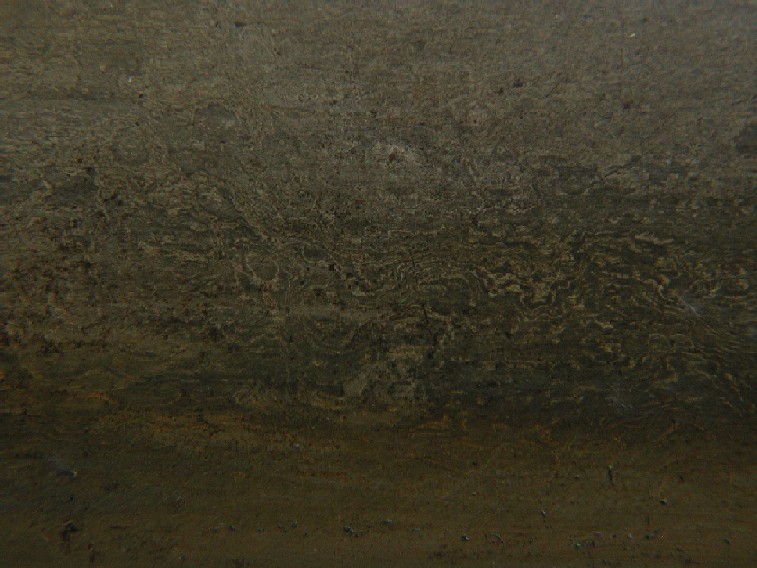

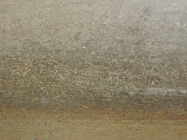

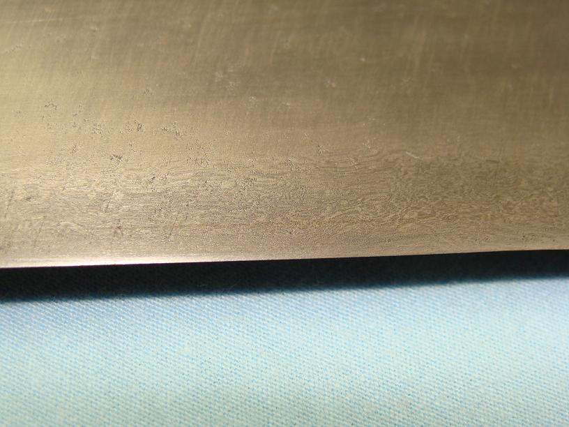

Hello All and thank you for all your post and interest on this bolo.
I understand how unlikely a wootz blade would be found on a Filipino sword and let alone on a tagalog blade of Christian region. The patterning on the blade is very tight and never seen it before on any Filipino sandata. Lew was skeptical as well when I told him about it. This was the reason why I brought it over to have him take a closer look at it.
The blade is chisel ground. The patterning is only visible on the beveled side and not visible on the flat side.
The blade was previously etched and Lew did a light etch on it with FeCl.
Unfortunately, I cannot make it to Ashokan and have asked Lew if he could bring this bolo with him. Hopefully many of you could get a chance to look at it in person and give a more definite conclusion.
Here are a few more pics. This is the best I can do with the camera that I have.

I will be taking the bolo to Ashokan Dr. Ann will able able to look at and let us know what she thinks.

The experts thinks its a very high quality pattern welded blade but they couldn't explain why they see both pattern welding in one area and a wootz pattern in another? They said if I just showed them a picture of the wootzy area they would swear it was wootz but they spotted a fine pattern welding near the hilt.

some wootz blades have the steel tang welded on... this maybe the case?
its a hard to tell whether this is banding or wootz... but it does look good no matter what it is... I think only a full etch of the blade will give us a true look at the steel..... but then the mystery is lost...
I'd keep it the way it is ...

It is very difficult to tell from the pictures but I think Ian is right on the money in that this is some unusual crystallization from the heat treatment of the blade. Sometimes old pieces of metal that would be used for making blades, ie very old railroad track, from the years of use when forged out would have an unusually high amount of carbon......but rather the railroad rails which due to age and heavy wear created a high carbon steel. What is wootz steel. A high carbon steel....many smiths over the years adding old, well used horse shoes and handmade nails to their forging process which in effect increased the carbon content in the finished product.
Unfortunately, this is not how it works. The carbon content of steel does not increase due to workhardening or wear, even with something as big and heavy as a locomotive beating on it. Also, most old horse shoes were made of wrought iron or low carbon steel. Yes, rairoad rails can be used many times for making tools and knives because they are usually of sufficient carbon to be hardened, but not always.
However, you are correct in stating that you can often times find interesting patterns in high carbon steels that are neither pattern welded nor wootz type steels.

Just to summarize the thoughts here for my own clarity. I think Lew has presented an intriguing piece for discussion, but we have no firm evidence that this blade is true wootz, as might have come from India about 200 years ago. Rather this blade appears to be an unusal laminated construction, perhaps with some odd crystallization in places.

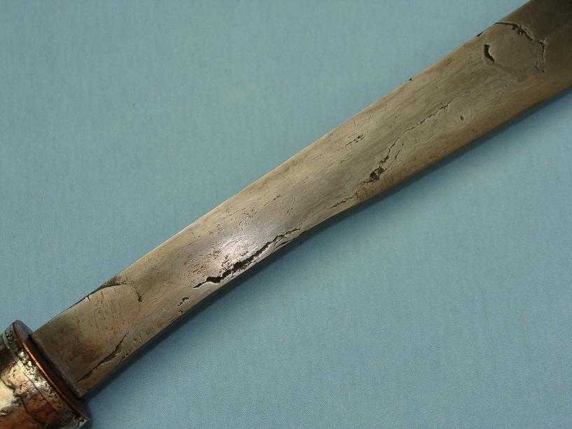

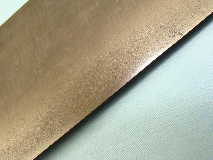

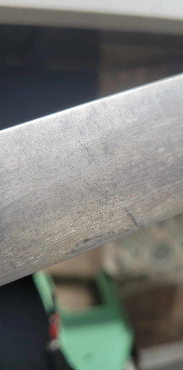

To re open this thread I would like to contribute a pic of these peice. Olso a luzon. Im still uncertain but it looks like sham wootz. Still need to finish polish but I hope this can help more with the discussion

This is interesting subject matter.
I recall similar back and forth I had on an Amanremu from the Kelling Hall Collection.
It was with what looked to be a three bar steel construction with typical scarf welding found on many Tulwar that have a root of non wootz and a blade of Wootz... image attached.
I'm still not convinced either way where the Amanremu concerned. I like to think it shows all the qualities of a scarf welded wootz blade when only the inserted edge is wootz and the smith did his best...and I cast my mind to a heirloom Tulwar here with an old Persian blade. It has a black wootz blade and what looks to be a very clear sham wootz inserted edge experly sandwiched within the black wootz...so anything is possible.
I am truly bewildered where with example in discussion is concerned... I look at sections in isolation and think there is potential given the smiths knowledge and abilities and that it is not something they would have worked with very often... but could certainly have obtained at some point in time... then I look at it over all in context and it reminds me of some very tight pattern welded barong blades I've seen, and some aspects I have seen on very fine pattern Welded Kukri too...
I think the definitive answer lays in more detailed testing as it could have been all down to the smith who just didn't quite nail it as it was not a common material choice...
