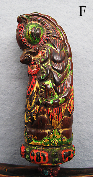

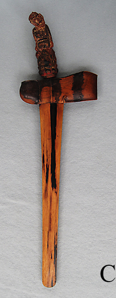

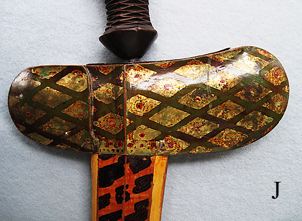

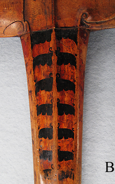

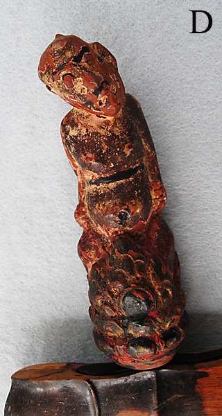

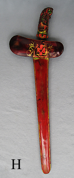

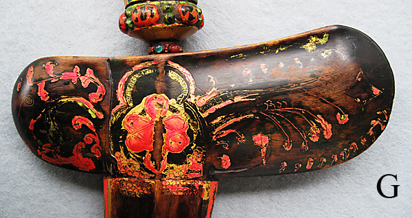

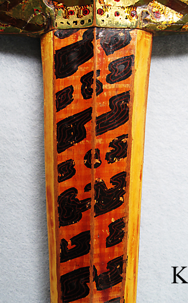

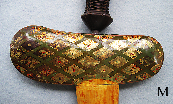

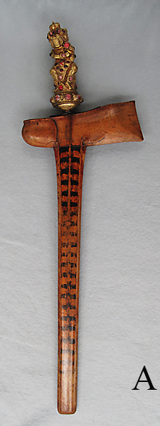

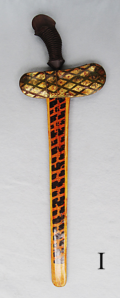

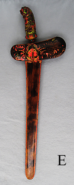

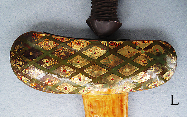

Here are a few more examples of Balinese sunggingan keris dress.
A. G. Maisey is offline
Old 13th February 2010, 05:58 AM   #42

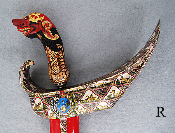

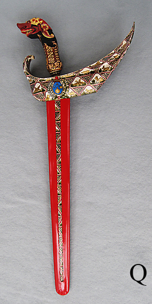

Posts: 7,258

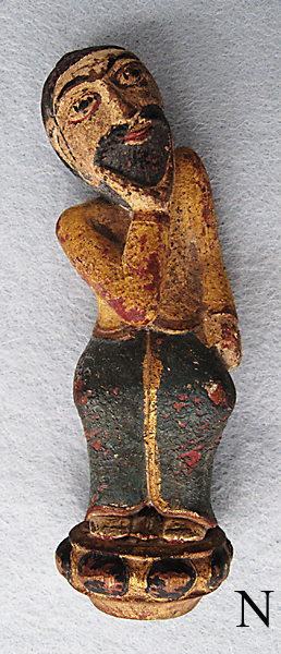

And a few more examples of Balinese sunggingan dress --- you can only upload a maximum of 12 images at a time, so these next ones follow straight on from the previous.
As is usual, the system has a mind of its own and does not post the images in the order in which they were entered, so you will need to follow the alpha tags to maintain coherrence.
The Balinese images finish at N

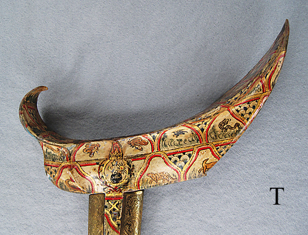

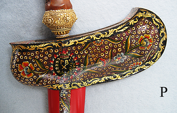

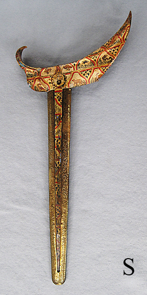

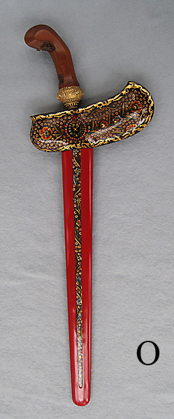

Then there are some Javanese sunggingan examples for comparison:-
O, P, Q, R are the work of Pak Legiman of Pajang, and were completed in about 1990.
S & T are of a pre-WWII Surakarta sunggingan in an alas-alasan motif.
