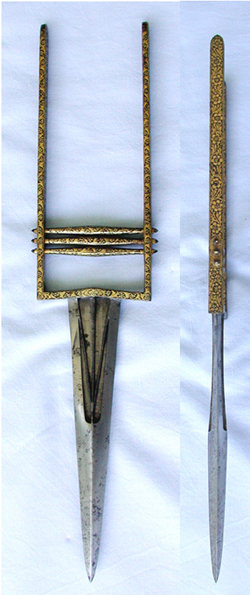

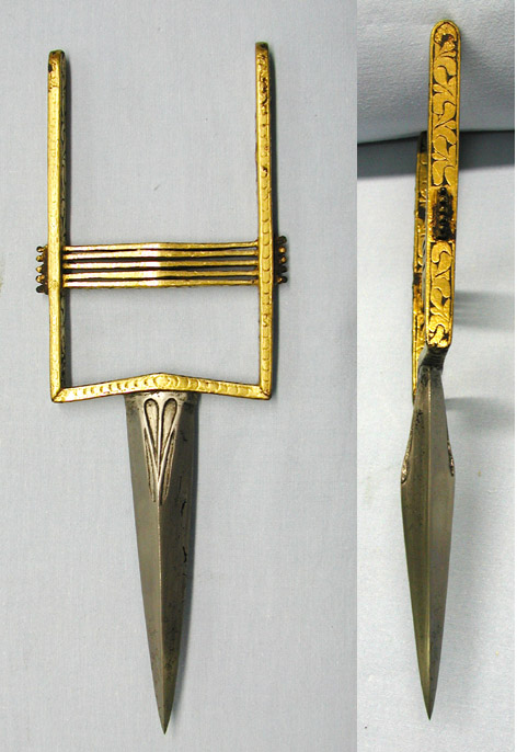

Excellent Jim, and yes katars were used in battle and when hunting, just like the swords, lances, bows and other weapons used in battles.
Well done Brian that you corrected the mistake, that the katar was not used for war, it most certainly was – as a second weapon of course, but still used.
The katar on the picture is rather special, and I doubt that it can have been meant used for other things than to open mails and wound/kill the opponent. If used on someone not wearing a mail, the risk that it would get stuck between two ribs was big, and the strength it would take to get it free plus the time, would most likely mean that the user would leave it to fight off other enemies – a katar lost. In such a case a flat bladed katar would be far better. You must also remember, that a katar was used with great force by trained worriers.

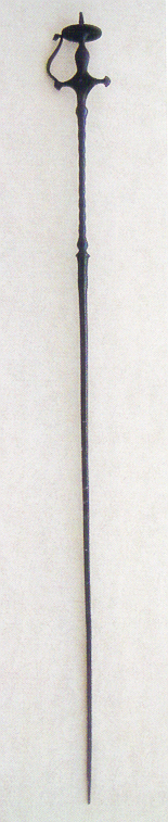

One of the ‘swords’, seldom seen, is shown in Tirri’s book ‘Islamic Weapons’, page 331, figure 251. I have only seen only one other ‘sword’ like this, it was either at the Top Kapi Museum, or at the Army Museum in Istanbul, the hilt was different, but the ‘blade’ was like the one shown. These swords were made for penetrating mail or plates, or to find a weak point in the armour.

Hi Jens,
As always, a very excellent photo of a beautiful katar which clearly has a defined intent as a piercing weapon, with this observation based entirely on the pronounced, ribbed cross-section of the quatrefoil blade. I wanted to be sure to qualify that after the dynamically inflated discussion that remains concurrent on another forum. I think physics is quite interesting, but feel that it is in large degree as superfluous as elevated academic procedure in basic friendly discussion.
While Indian armourers were clearly extremely innovative in weapons design and production, with some of questionable practibility,it would be naieve to presume that many katars were not intended for, and actually used to pierce mail or especially that they did not find use in combat. The absence of battle damaged katars reflecting damage at the point that would suggest impact with armour is hardly evidence that such use did not occur. It has been well established that vast quantities of weapons were gathered and scrapped during the British Raj, presumably in most cases to deprive potential insurgents of weaponry. The majority of weapons now found in significant collections were collected from armouries of important royal figures or attractive examples chosen by impressive appearance rather than 'fighting' or 'damaged' items...primarily to serve as distinguished decorations or souveniers.
The interesting Indian sword you have shown for piercing seems very equivilent to the European 'estoc' that was essentially a hilted lance to pierce armour , and seems to have had Islamic counterparts in the 'mec' as well as Chinese rapier type examples. The Tatars had the armour piercing needle type blades on many examples of the sabres of the 17th century known as 'ordynka', and in Russia and the Caucusus, the 'malle perce' (mail piercing) blade was well known. It would seem that in North Africa, the needle point sword distinctively known as the 'flyssa' was intended to pierce mail, which had become well established in use in both western and eastern Sudanese regions, as well as with Ottomans in North African regions. While the actual method of combat for these swords remains obscure, the suggested use for mail piercing seems plausible.
Despite the academic analysis concerning physics and evidential criteria that attempts to suggest against mail piercing use of the katar, it seems to me that specialized weapons intended to pierce armour were well known and represented in various cultural spheres. Such diversity would seem to increase the believability of such use, and that such application would be afforded to a weapon primarily associated with the thrust seems compellingly probable.
I think your note on the possibility of the weapon becoming lodged in either bone or complex anatomy is well placed, and this is one of the arguments against thrust weapons with serration or barbed configuration, that withdrawal would be a problem.
Whether or not these piercing weapons could actually pierce mail or other armour.....this cannot really be effectively determined using physics or typical scientific approach in all cases. The reason for this is that the factor that cannot be accurately measured in these dynamics is that of the nearly unfathomable magnitude of human ferocity in the heat of combat. It is well known that the power of adrenaline in extreme situations can reach unbelievable levels. In such cases there can be little doubt that penetration could be accomplished, the only question would be if the weapon itself could survive the force of the thrust.

The ‘sword’ shown in the Tirri book, has doubtfully been used as a two hand swords, but I have never seen the one in Leeds. You could have used it as a mace, but I doubt very much how big a help it would have be, and used as a two hand ‘sword’, what would the point be? Other maybe, than you could steer the sword better.
I find the discussion most interesting, but one must remember that in the Worlds at that time, the Oriental and the European, mails as well as weapons were made in many qualities, which would fit the buyers wallet, so one can’t say that European mails were better than mails from India, not can one say the opposite – it all depended of the buyer – not on the mail smiths, as they could make whatever you wanted.

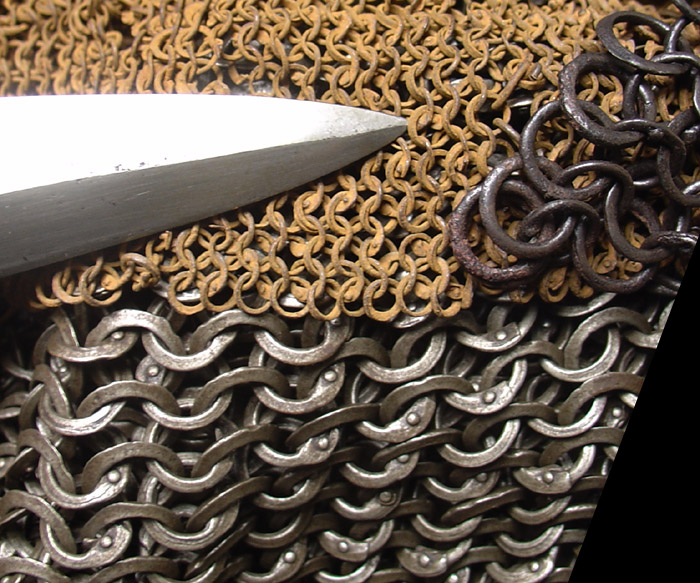

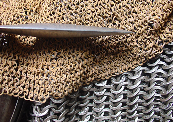

attached is an image of two types of mail. both are from the same region and probably the same date (give or take..) the katar is roughly the same date as well. the katar is relatively standard in form ie. not excessively thickened as jens' example, but just the tip, as found in earlier examples. the section of mail shown is of the upper torso section, which is normally heavier duty due to the vital organs that needed protection.
the katar is early 17thC. the mail is dated 17thC but could possible be 100 years earlier. to me (again, humble opinion) this katar would sail through the lighter mail, but would struggle against the heavier mail. (the blacker mail on the top right is ottoman and just for comparative size)
all opinions can only be asthetic. as jim rightly says, we could not imagine the ferocity of 17thC battle and so any scientific test, whether on paper or physical would be tainted.
jens also notes that mail shirts were commonly worn (more so that in europe) and the quality was related the the wealth of the owner. in europe, only a wealthy man could afford armour but the quantities of indian armour that survived, and the range of quality tends to paint a different picture.
i dont think indian mail can ever be compared to european because the culture, people and art of war was completely different.

Originally Posted by B.I
sorry to have been absent on this topic. i have been reading the other discussion on SFI and must agree that i still dont agree with whats being said.
i think the reason i feel the post goes astray, is that indian armour is still being classified as a whole. this isnt the case, and never has been. i dont see the point of testing against a similar, or even antique piece of mail. would you choose a high quality one or a poor one. which type of katar would you use? i true reading would be a poor piece of mail against a very good katar, as this would prove it can be penetrated but this is hardly accurate, nor is there much point in doing so. the answer doesnt require any tests, nor a scientific analysis. the proof is apparant in surviving examples, of which there are enough around to make a visual inspection and conclusion. if visually, there is no doubt, then i dont particularly see the point in taking the conversation further. the slightest doubt would induce a further anaysis but in my humble opinion, i feel this isnt needed.
I like the pictures you posted, they illustrate very nicely the differences between different types of mail. I also suggested on the SFI forum that an experiment would be useful , but I have changed my mind since then. Like you said, there was lot of variation from one mail shirt to another, not just in the size of the links but also in the quality of the iron used. Furthermore an antique mail shirt will have degraded over the centuries.
My own personnal conclusion is that the katar is a traditional weapon not specifically designed to penetrate mail, although variants do exist which have designed for that purpose. I also have concluded that a good quality ordinary katar, if used with sufficient force, will penetrate most mail shirts although probably not high quality mail with thick links over the chest.

Very nice, and well composed, pictures. A very good way to illustrate your point of view.

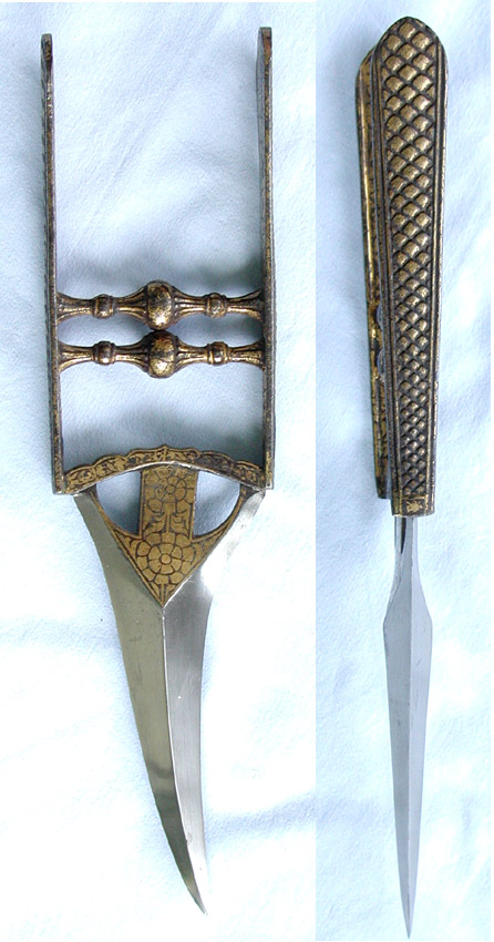

Of the katars I have, there are only two, which does not have a reinforced tip. Not that the reinforcement itself means that could, or was meant for piercing mails. Here is another one.

both you and aqtai has expressed that the thickened point 'could' have been used to penetrate armour and i think it good to stress this. at the end of the day, all we can do is speculate and it seems that a thickened point could well have been included for this purpose, given the style of armour in that time.
also, something that has been overlooked is that many spears also had this reinforced tip, as did (on rare occasion) a sword blade. again, we have to think why this was so and conclusions veer towards the armour piercing. not a debate that will ever be conclusive, but i am glad to be on a forum that listens politely to all opinions and happily agrees to disagree.
B.I is offline   Reply With Quote
Old 9th August 2005, 06:01 PM   #49
Mark
Mark's Avatar
Posts: 987

Somewhere in one of my books I read, that a silk shirt was often worn over the mail shirt, if that is so, we are not likely to find miniatures showing someone wearing a mail shirt, as those being painted were those how could afford to wear a silk shirt. On the other hand, we wont find anything if we don’t look.
A blade like the one shown has been made for a reason, and it is true that I can’t prove it was to pierce a mail, but it is the only logical use for a blade like that. Used against a man without a mail, it would go right through to the hilt, as the narrowest point on the blade is at the hilt, it would likely be jammed between two ribs, and be very difficult to get loose, not a situation one would like surrounded by enemies. Used against someone with a mail shirt, it would, if it penetrated the mail, maybe go halfway in and wound the man – or with a bit of luck kill him. Proof is a good thing to have, but unfortunately we don’t always have it when we want it, and sometimes we will never get it, then we will have to do with the old books and logic, although that is no exchuse to stop looking.
Hi Jens,
I've got some photos of that Indian 2-handed sword in the Royal Armouries. I'm afraid it looks nothing like the one you posted.
Aqtai is offline   Reply With Quote
Old 19th August 2005, 01:14 PM   #60
Jens Nordlunde
Jens Nordlunde's Avatar
Location: Europe
Posts: 2,718
Hi Aqtai,
I like the swords you show, and hopefully I will one day see the museum in Leeds. The ‘sword’ I show in mail #40 is quite different from the swords you show. The blade is square or round, and not sharp at all, but it is pointed and the tip is reinforced. Once I was told, that ‘swords’ like this one was used to penetrate mail, when the enemy was laying on the ground.
Can anyone confirm that The Army Museum in Istanbul has such a ‘Panzerstecker’ in the collections? If yes, would it be possible to get a photo?
