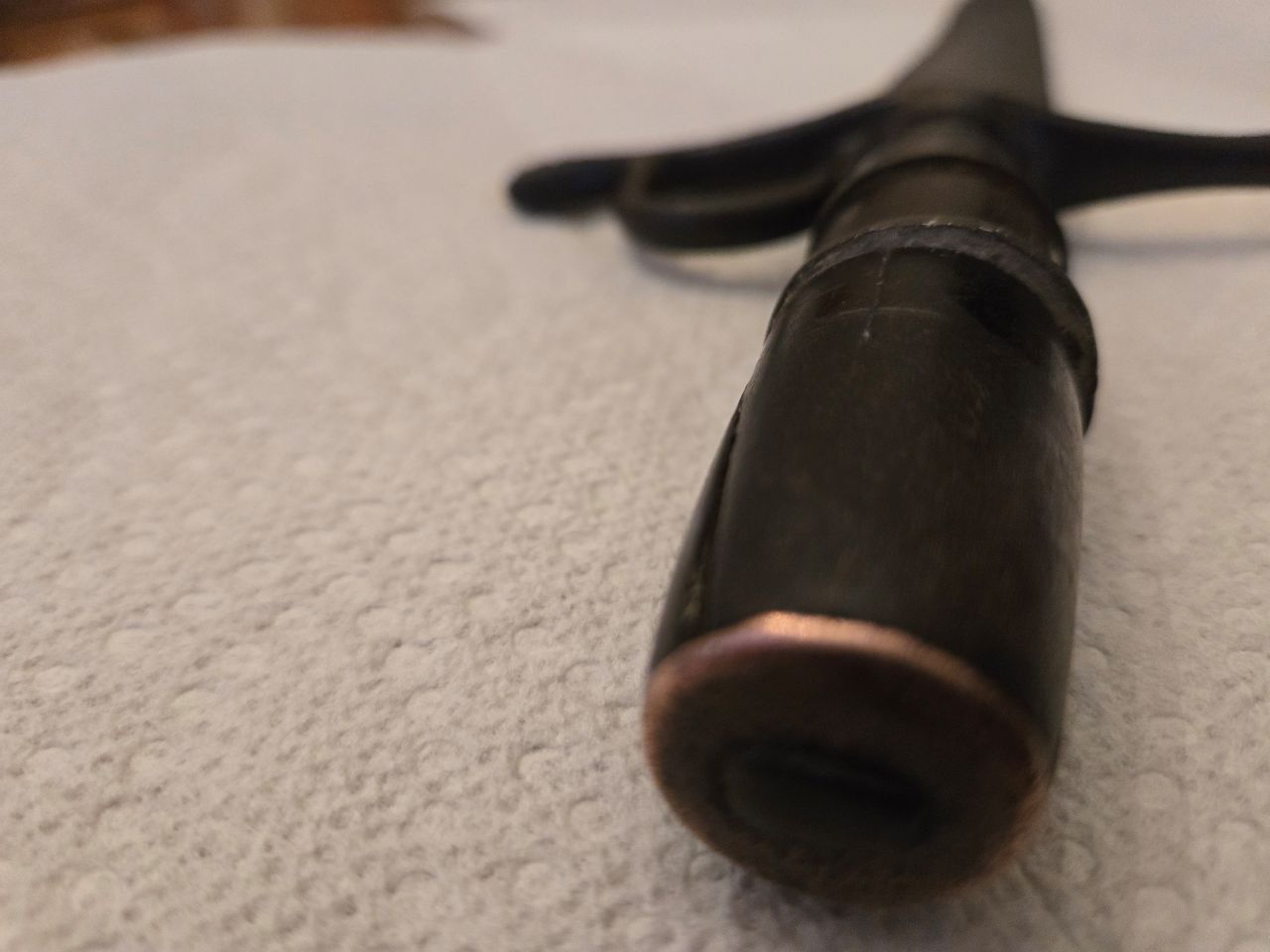

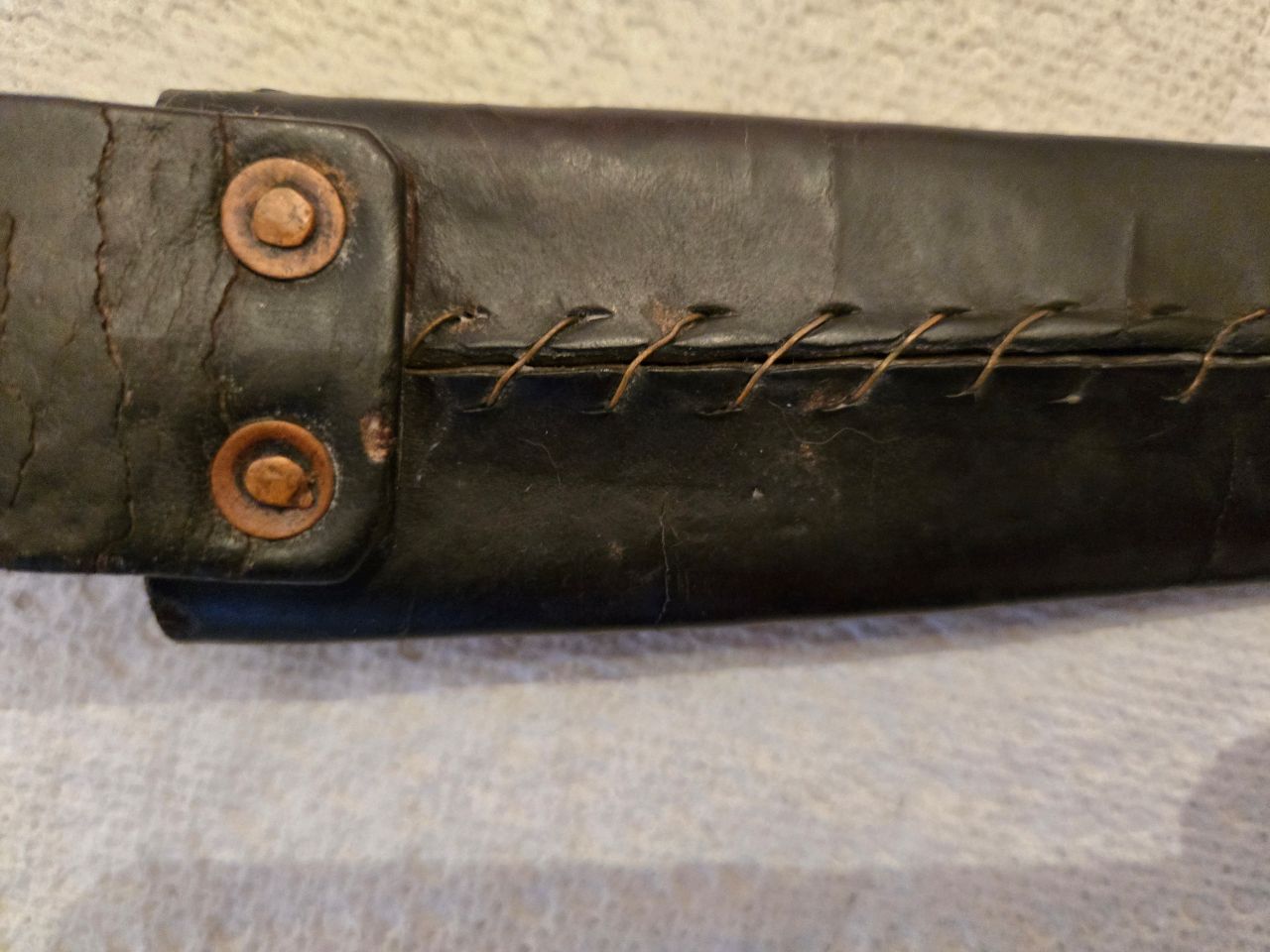

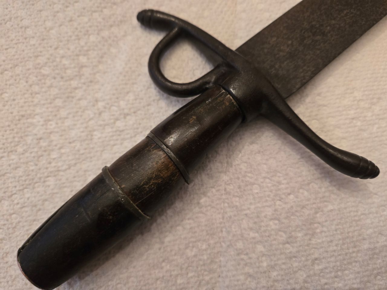

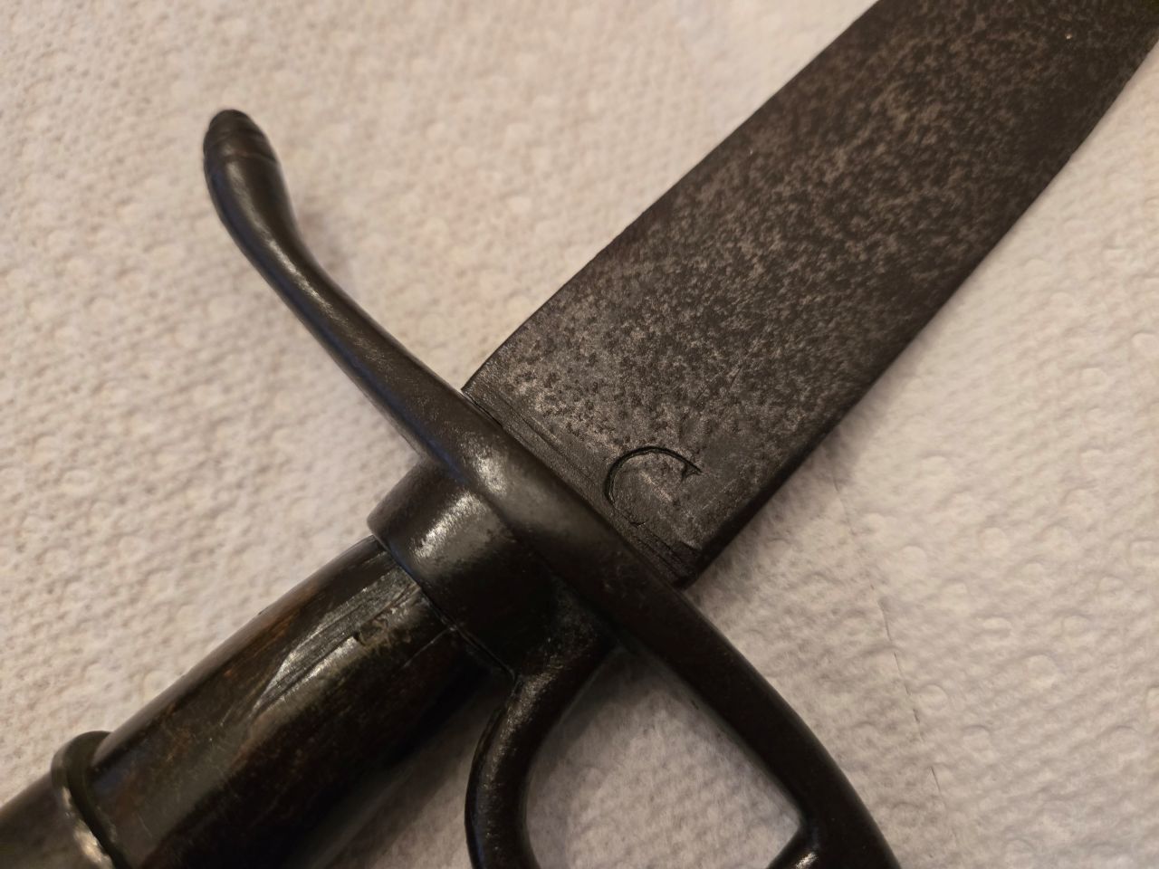

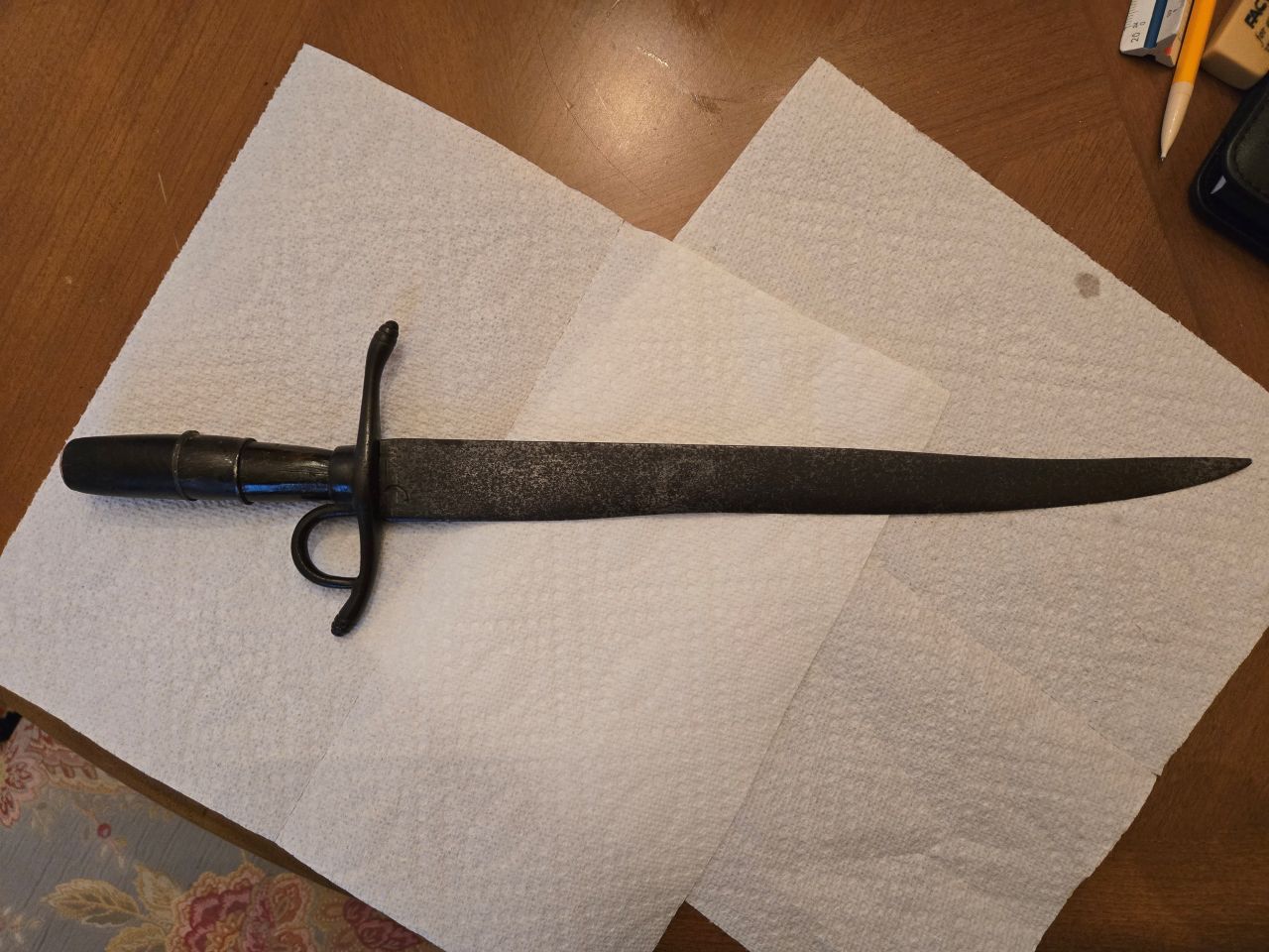

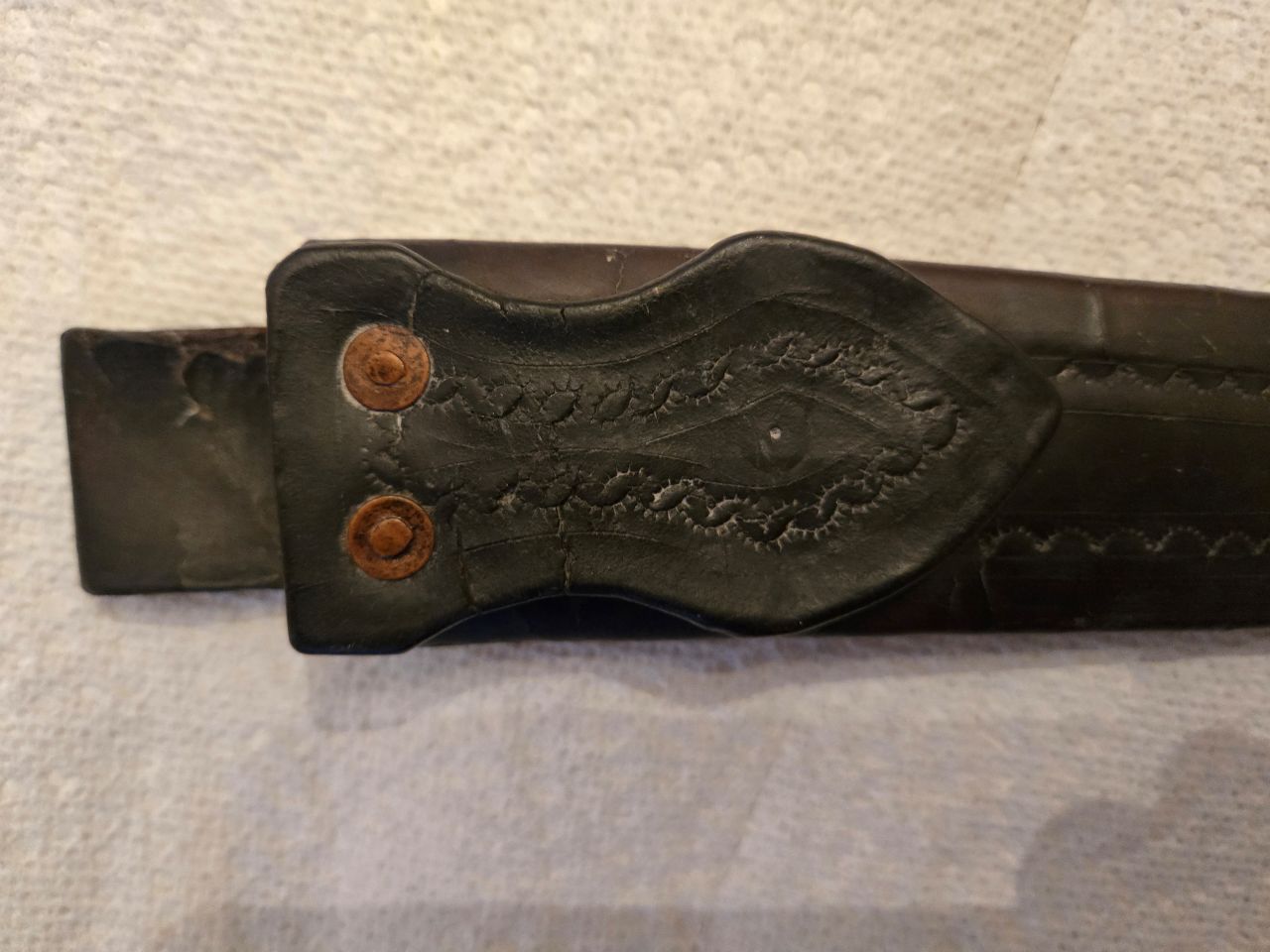

Hello again. Recent short sword purchase from estate sale via online auction here in Baltimore, MD. 18.5" overall with 13.5" blade. Assume Revolutionary War era due to the "homemade" simplicity and chunkiness of the hilt and lack of decoration other than simple scribed quillions. But maybe that is not correct? Cross guard and quillions are iron. Wooden handle with intermediate metal "washers" and simple copper cap. Blade style has that slight dip to it in middle. Has a letter "C' marked on blade with a barb (like a fish hook?) at top of the C. Wondering if anyone has seen this mark before? Also curious about the big finger ring/loop which is under the hilt. Is that an unusual location or size for it? (actually feels pretty comfortable to hold with finger thru it...plenty of room). Haven't seen anything similar to that ring in the Rev. period reference books I have. Maybe this is just a blacksmith one-off? Also came with a leather hilt with copper rivets, simple decorative stamping on one side, copper wire stitching on the other. Any thoughts on this one would be greatly appreciated!

These are generally listed as northern Mexican saddle swords. Mexican revolution period.
Someone will remember the espada ancha threads.
Cheers
GC
Buried on my drive are other examples
Old 14th December 2025, 06:33 PM   #3
Posts: 10,858
Murph, Glen is spot on!!! This is a characteristic Central American dirk, knife from Spanish colonial context, and one of the nicest I have seen!! as it does seem an earlier example, possibly early years of 19th c. or earlier. As for the Revolution, there were a number of Spanish colonial arms in use, but mostly Gulf colonies and swords of 'bilbo' type (Nuemann, 1972). It is not commonly known that there was a degree of Spanish involvement in the Revolution in some aspects.
It does present interesting potential if this can be proven an 18th century example of these weapons well known in later 19th c..

Thanks GC and Jim! You guys are a wealth of information! That's cool to know it's a Mexican Saddle sword! I saw the pattern on the scabbard and thought that did look Mexican/Spanish so there ya go! Very cool. And Jim, thanks for the encouragement! I only have 3 plus the bayonet so far and only have 1 left to post. Will do that.

So was the ring more for attachment to the saddle or for finger protection? Just curious.

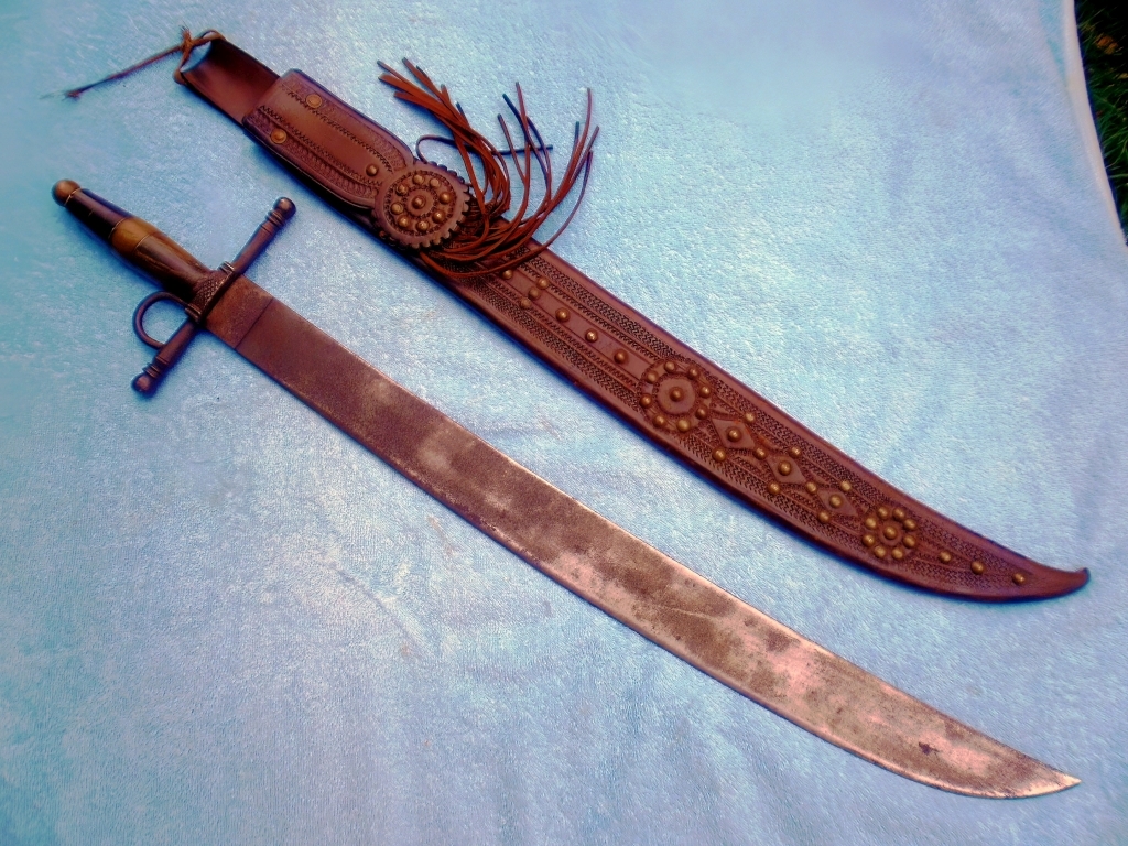

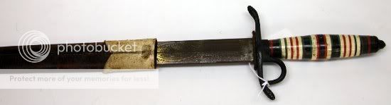

My mexican 'espada' - a favourite...

Wayne! Forgot about that beauty!!! A classic example of the often unusual development of weapon forms and their elements in the Spanish colonial contexts. While the unusual hilt ring feature seems most associated with the dirks typically regarded as Central American (Levine, 1985) the curious ring feature mounted at top of crossguard does seem to have diffused well into the edged weapons in Mexico.
As always it is hard to figure any sort of developmental progression in these often rural and unregulated contexts
Local blacksmiths and armorers were most innovative and certainly duplicated these weapon features favored by the incoming men from other colonial regions.
These notable guard rings appear to have become a component in examples of the espada ancha which are typically regarded as consistently situated in Mexico's frontera (northern frontier regions) northern Mexico and Spanish southwest.
There the espada anchas, which were actually short heavy hangers or 'cutlasses' eventually evolved into longer swords, which in the Mexican tradition were typically saddle mounted. Characteristically, caballeros and vaqueros mounted sword scabbards to the mochilla under the saddle and left leg of rider.

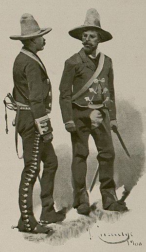

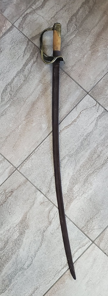

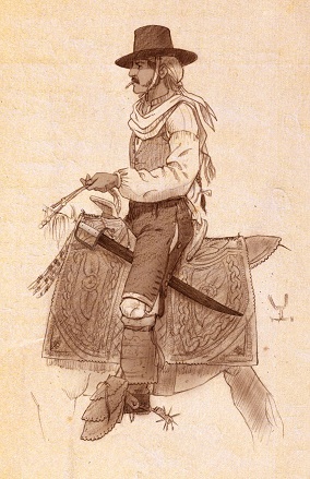

A vaquero with espada ancha worn on saddle as seen c. 1820s(first image). By 1850s, these had become shorter and more like Bowie knives so worn on the person. By later in the century saddle swords were still more the standard, so indeed there were cases of Mexican saddle mounted types into the Revolution period. However the Mexican 'rurales' of Diaz and many 'chinacos' into the Revolution wore swords in scabbard in the traditional manner.

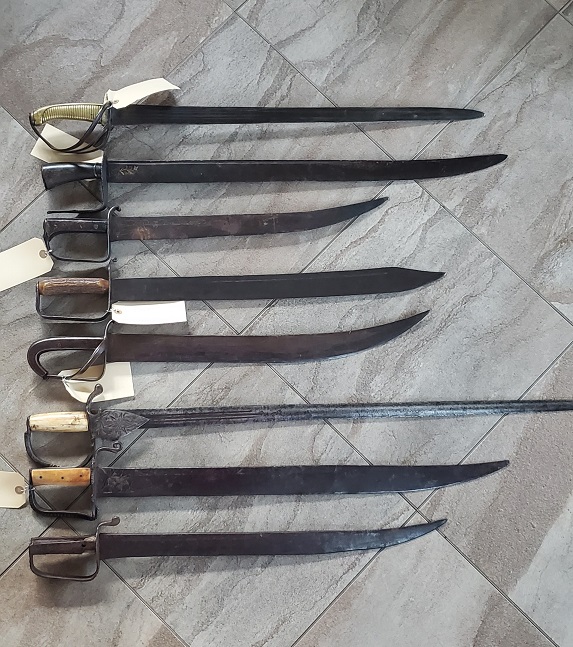

In the photos.....a vaquero of 1820s (original art by David Rickman for my article on espada anchas, 2023) the espada ancha is drawn from the 2nd from bottom in my grouping.
Espada anchas.....third from bottom with horn grip has dragoon sword blade and may have been saddle mounted, probably from Sinaloa.
Rurales, frontier police of Porfiriato c. 1880s
Emiliano Zapata, leader of Mexican Revolution forces in south, Morelos.
Typical 'rurales' saber c. 1880s.
