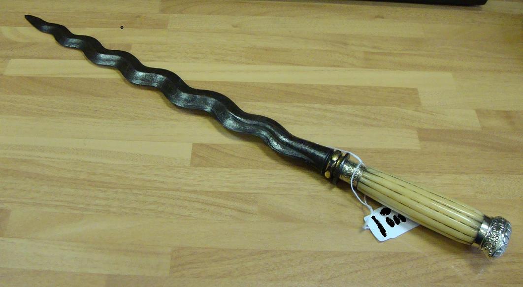

Default the one I passed
It seems this may have been a pretty common this to do in the day, here is the one I passed back in August.
Gav
