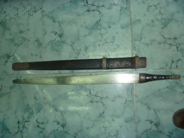

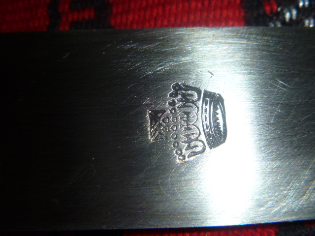

I was lucky enough to win this kattara on eBay about a month ago and it has finally arrived, which enables me to share pictures.
Scabbard and hilt are in poor shape, but at least they retain most of the original fittings and leather. As you can see the fittings are quite simple - no silver, nothing fancy.
Same can be said for the blade - it looks like a 19th century trade blade.
There are plenty of markings, identical on both sides - at the base of the blade there are gurda markings, with something in the middle - does anyone know what it is or what it attempts to represent? At the end of the fullers there is also a small cross. All the markings seem to have been added to the blade locally.
Do you think I am correct about this being a trade blade imported fro, Europe, or would you say this is a local blade?

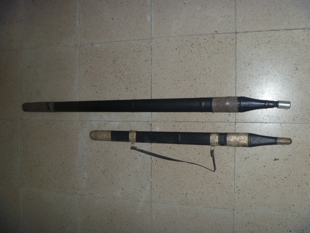

I am very happy to have added this to my other kattara with a curved blade (most likely an imported shashka blade), and I appreciate everyone's comments.
Teodor

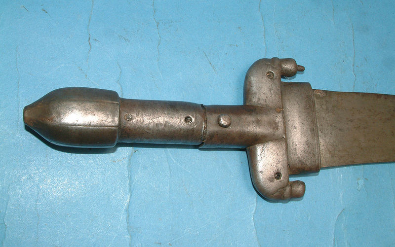

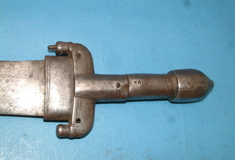

Great kattara Teodor! I've always found these so interesting, as a sword which seemed quintessently based on simplicity, they represent profound historical interest, especially concerning trade and the Arabs.
Naturally these are instantly recognized as the sword of Oman, who had the Sultanate on the island of Zanzibar, one of the most bustling trade centers of the 19th century. From there slaving caravans would advance into the depths of Africa, in the commerce of slaves, gold and ivory. It is my understanding that in regions beyond Kenya they likely interfaced with other traders and caravans coming in from regions in Ethiopia and westward on trans Saharan caravans.
I have always considered it intriguing that the well known sabres of the Manding in Mali have simple cylindrical hilts of similar form to the Omani kattara. One of the key points in trade routes from the Sahara was of course another familiar term in high adventure, Timbuktu, in Mali.
Also, note the spatulate rounded tip on the kattara, and compare with the blades almost unequivacably found on the takouba of the Tuareg, it is also rounded. Trade blades moved from ports of arrival in the east off the Red Sea as well as possibly via the Zanzibar trade, and to the east. Other points of entry are of course from the north, but it is interesting to note this feature's presence.
I would think this is likely a trade blade, which I believe often arrived blank from various centers, and the markings are of course native interpretations typically thought of as quality indicators, but in native parlance, suggested power in the blade. The 'gurda' marks are imitating the well known 'eyelash' or 'sickle' marks of Genoa and Styria, often on many German and of course Caucasian blades (from which the term gurda is derived).
Probably end of the 19th, into the 20th, and these were always a proud possession of Arab traders and merchants. Interesting detail in "Book of the Sword" under 'Zanzibar swords' and the swordplay of the Arabs, describing the leaps and slashes,
All the best,

Jim,
Thank you very much for another thorough and outstanding reply - I appreciate the effort you put in your posts.
I agree that the topic of Trans-Saharan trade is fascinating. According to Elgood, the straight trade blades entered the Arab market through Egypt, where some of them were of course also used on the Sudanese saifs, which we call kaskaras. Spring on the other hand shows evidence about blades enetring from the other side of Africa, and being distributed all over the Northern part of the continent from Kano, nowadays Nigeria. The Omanis were certainly not afraid to venture deep into Africa, as evidenced by Tippu Tib's trips to Eastern Congo.
This is a question I have always had on the Omani kattara hilt - did the shape travel from West Africa to Oman, or vice versa? And what about the other type of kattaras with hilts, more like the hilts of old Arab broadswords (and not dissimilar to Hispano-Moresque swords? I remember reading somewhere, I think it was Elgood's book that these hilts, which are generally considered to be of an older variety, originated in the Omani enclave in Baluchistan, rather than in Oman proper. Does anyone have a hypothesis on this topic?

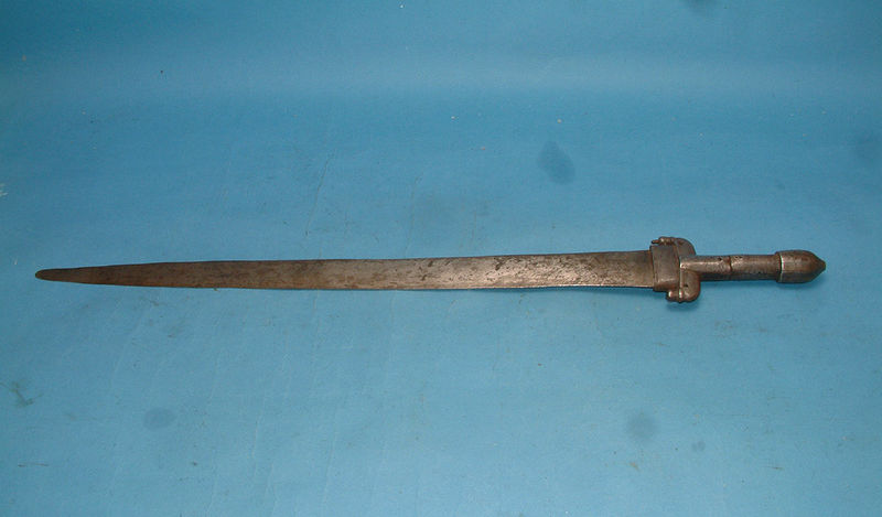

Hi Teodor,
Absolutely my pleasure as always. Good on noting the term sa'if used for the kaskara, which recalls the years I have spent trying to discover where in the world the term kaskara came from. Nobody in the Sudan, or Eritrea for that matter has ever heard the word, and I have had this researched all the way to the University of Khartoum!
What has always fascinated me is that the takouba and the kaskara, both North African broadsword cousins, have remained independant forms despite the constant traverse of caravans, nomadic tribal interaction and the entrance of trade blades from varying points of entry from varying directions.
The Tuareg swords have the rounded tip, the kaskaras typically have a spear point. The hilts remain simple yet quite different. The Hausas, from the farthest western regions in Nigeria and the prevalent trade center of Kano, were known for thier kaskara work.
The question of cross cultural diffusion and in which direction did influence move is a tough one and well placed. In the study of anthropology and archaeology these kinds of questions are resolved with dated and provenanced remains. With the movement of portable trade items such as weapons, it is hard unless soundly provenanced and dated examples are avialable. In general, one can follow the development of trade and colonial development by period in examining such examples.
The earlier Omani hilts may well have developed in Baluchistan as Elgood notes, and I of course subscribe heavily to his always well researched observations. These hilts are of the Muslim drooping quillon type hilt that seem to be evolved from these types of Hispano Moresque forms of the medieval period. It is also essentially a hilt with such features well emplaced in Central Asia (the paluaor from Afghanistan) to similar types in the Deccan (see Elgood, "Hindu Arms and Ritual").
In my opinion, Africa, particularly North Africa is what I would call 'reflective' in most situations. That is the weapons seem to reflect styles from foreign cultures, rather than their styles influencing others. This does not hold true necessarily in the obvious influence of ancient Egyptian weapons which have clearly influenced weapons across many African tribal cultures, and perhaps into the Middle East in ancient times.
For the most part, I would say weapons coming into Africa have influenced the forms there, not vice versa. Kaskaras and takoubas evolved from the broadswords of early Islam, becoming prevalent as trade blades began to come into Africa. The so called 'Zanzibar' sword became the s'boula of Morocco probably from basilards from Italian trade in Tunis; the koummya probably derived its hilt from the Venetian cinqueda, again Italian traders; the 'nimcha' (Moroccan sa'if) from Arab sa'if in turn from Italian hilt configurations (storte etc.). The double blade 'haladie' of Sudan is from the madu madu of India and known also as the Syrian knife, entered via Red Sea trade. The flyssa, evolved from Ottoman yataghans and in degree via that from early Meditteranean swords.
These are the ones I can think of offhand, but I cannot think of an example of African weapon that has turned up elsewhere . Im sure somebody will think of one though
Ramblin on as usual, and just expressing thoughts.
These really are great swords, and seem to have only recently begun to turn up. When I first found one about 10 years ago I thought I'd found Excalibur!
All the best,

Very nice swords of Oman... The straight sword is the famous Omani Kattara and the curved better known as an Omani Sayf.
First!! My apologies for shoving in and presenting my Short Omani Battle Sword meanderings on your thread... I hope you dont mind as no offence was meant and I should have made it a separate thread.
It is also a puzzle to me as to how many trade blades appear on Omani hilts... So far I have discovered people with Wootz blades from where?? who knows... and German blades some with possibly fake running wolf stamps and others with weird unknown stamps possibly fake?? I have one with a number on it; not arabic .. english figures ! and some with holed pommels and some not.
Decent blades bend double and retain their straight shape whilst cheap blades stay a bit bent !
The big question is; where did the idea come from and when ? The first indicator date is 1652 when Oman took Zanzibar ( they were very influencial all down the African coast and big in Kenya tradewise.. ) but the fighting technique with this weapon is so markedly different from its predecessor that it cannot be decended from it. The two swords (I mean the Omani Short Battle Sword compared to the long flexible Kattara)are as different as chalk and cheese.
Your sword "The Kattara" The straight one... was designed as a slash and snick fast whip action stand off system... The fighters were 6 feet apart or more ! and fought with a small shield; The Omani Buckler called a Terrs. This shield was used to disarm the oponent by twisting an attacking sword strike from the others hand. It was therefor a fighting system and developed a dance ... This war dance routine was a limbering up exercise before going in to battle so it became a martial art really. Nowadays that fact is shrouded in the dance and people forget its real meaning.
Great swords ~ well done !!

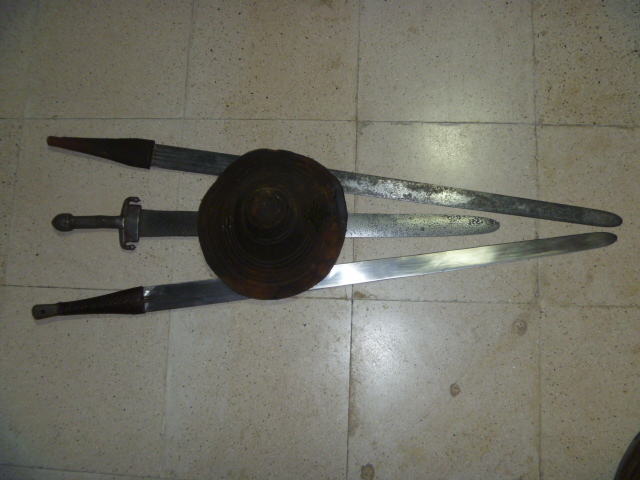

Without a Terrs Shield working with a kattara blade is a very wobbly business.

Thanks for the info Ibrahim, Jazaak allah khair. I am very interested in Bani Ka'ab history and do know that the Buraimi Bani Ka'ab have fought alot of wars.
btw, my Kattara looks very attractive with that shield :P

Salaams, In reviewing your excellent post #1 I note that the hogs back marks as you indicate are local add ons. They appear done with a chissel and mallet rather than a stamp. Although I agree these are both Omani weapons a Kattara and a curved Sayf I only agree that perhaps the sayf is a European Blade. The straight is perhaps not. I cannot deduce if the straight is a hybrid or in line with what I am trying to prove ... an Omani (RAK) made blade.
I also recently discovered curved RAK Sayfs made for Oman !
Regards Ibrahiim.

It has recently been discovered that Ras Al Khaimah(RAK) swords are a huge influence in Omani Kattara and may have been for generations. They have expertly copied several blade marks shown below and others e.g. #88. Now identified an Omani Sayf made in RAK.
As a side note other RAK industries use a Crown Mark such as the RAK Ceramics Co. There is a thought that Ras Al Khaimah which means "Head of The Tents" uses the illustration of a crown to reflect that stylised image...of tent tops.
Photos; Omani Swords. (Number 4 is a Sayf the rest Kattara) #88 is a Sayf.
1. UAE emblem with "God is Great" stamp to the right.
2. Lion + Sword, moon and star to left. Note "God is Great" scribed in the stamp under the belly of the Lion.
3. Lion... thin strike (on three Swords)
4. Crown Taj Mark on a Sayf.
5. Crown Taj Mark. Probable double strike.
6. Odd Crown reminicent of the Rolex stamp also the stamp of Berretta a European Gun Maker.
Ibrahiim al Balooshi.
