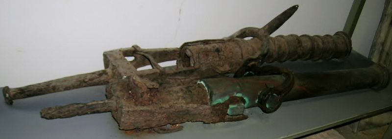

Two Portuguese bronze breech-loading cannon pieces, early 16th c. each, and obviously two from a series.
m
Sure they are Portuguese, Michl ?
I have found that the attribution of Portuguese'ship to some types of bronze canonry must be an added value, judging by how they baptize numberless examples in Commercial websites

Hi 'Nando,
I just adopted the assignment given by the auction house; of course I am not certain about their actual provenance. Your input is all the more valuable in this context.
Anyway, my opinion, though usually as well based as possible and backed up by more than 30 years of experience, is far from claiming to be a rule. I realize there are people out there who are able to add amendments. I only wish they would do that after all! All I've been hoping for when starting this has been a lively discussion!
Still hoping for the best,
Michl

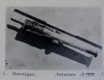

Regarding the staff in Spiridonov's posts # 85-86: cannons may well reflect architecture of the period, but the staff - a.k.a. "pilgrim's staff" - is actually a weapon of its own with the ball forming a pommel and a handgaurd. The size is about the same as two-handed sword and deployment is a simplified version of fencing (no edge alignment, no trapping with the guard).
Attached is another publication photo from 1978 of a different breech loader from the coast of Israel, bronze barrel with iron breech. The second photo shows the same cannon today (bottom), with another one made of iron.

Thanks a lot for this interesting addition!

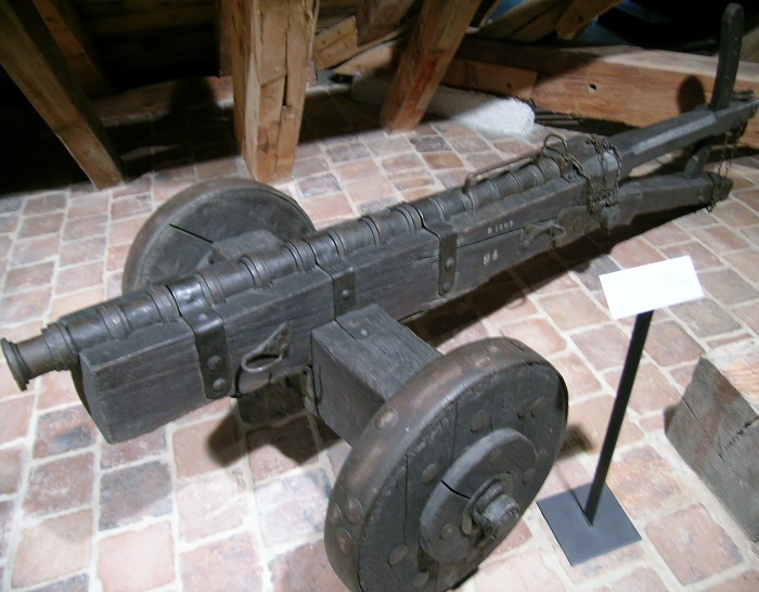

Same kind of gun, real life, full size. Original cart & fittings, Schwarzenberg castle, Prague.

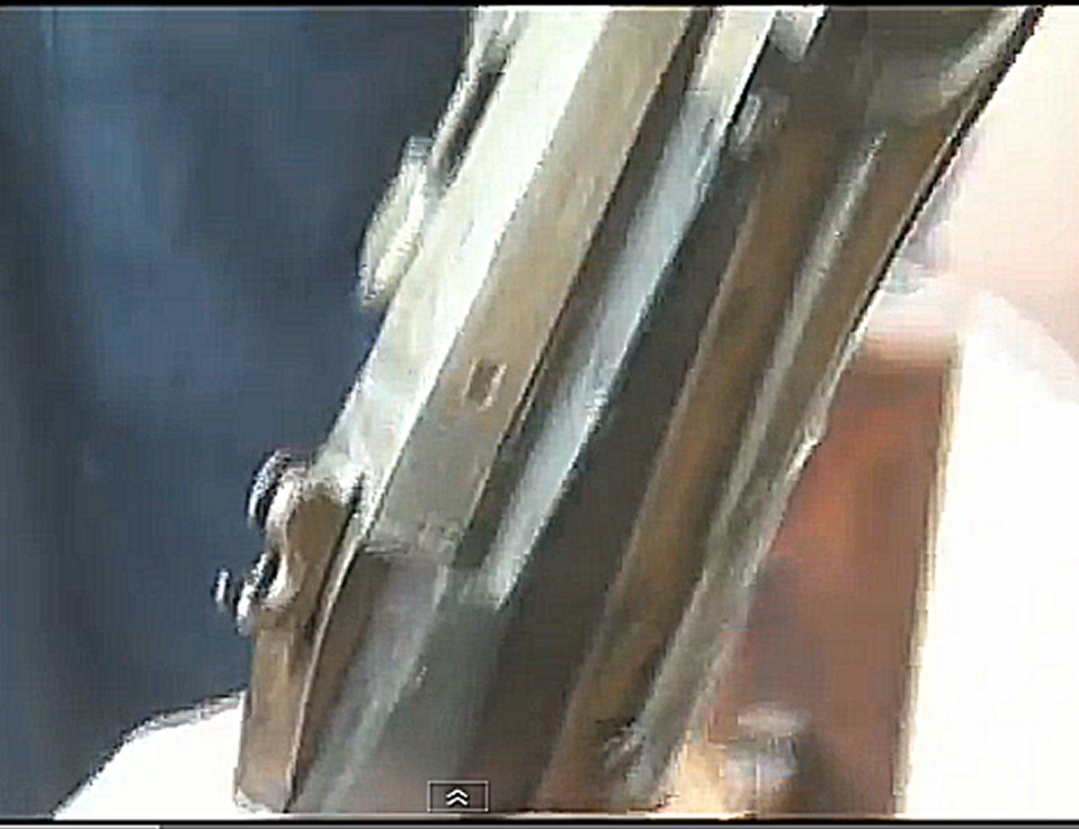

The lock working, made by Bolek Maciaszczyk!!!
http://www.vikingsword.com/vb/search.php?
The system works perfect, it is strong and makes a lot of sparks and guarentees to set of your main charge with eas
Old 23rd July 2013, 08:08 AM   #101
Marcus den toom
Marcus den toom's Avatar
Location: Netherlands
Posts: 543
(wrong link in previous post)
http://www.youtube.com/watch?v=DtlYa...pGjs_VuLPYLRkg

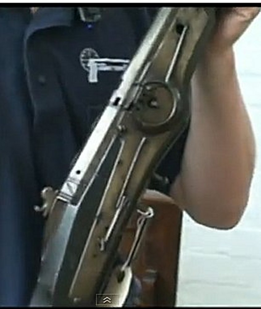

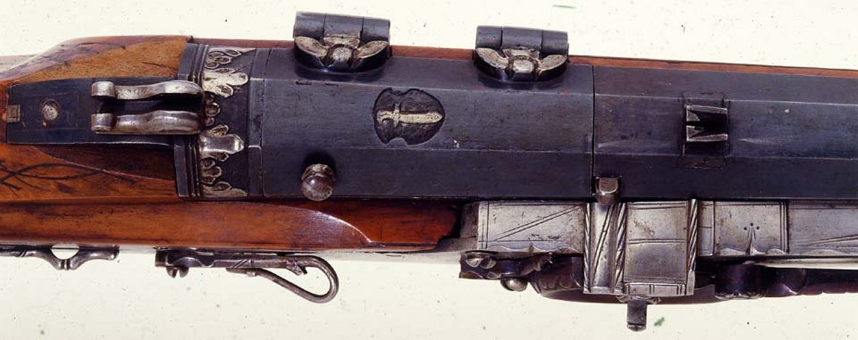

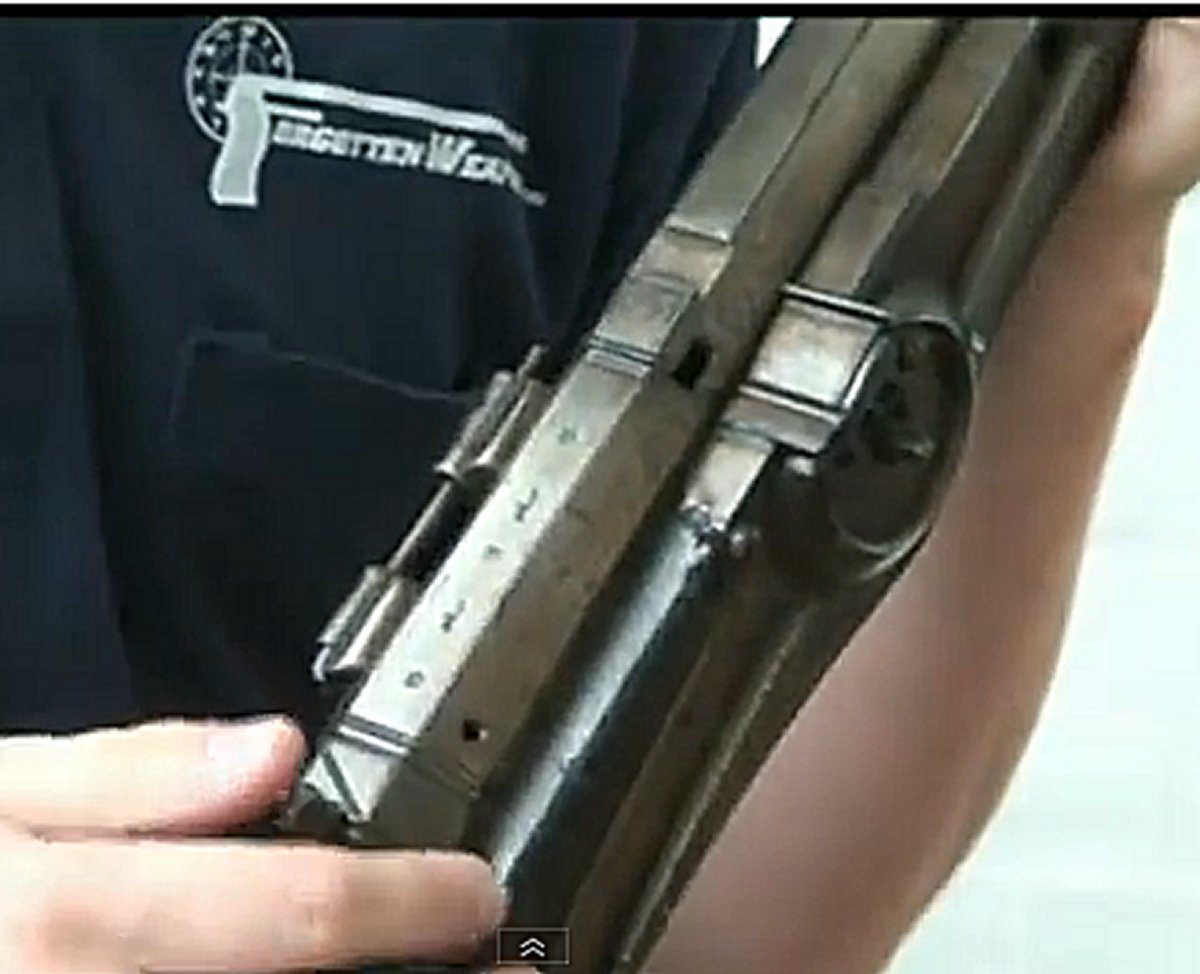

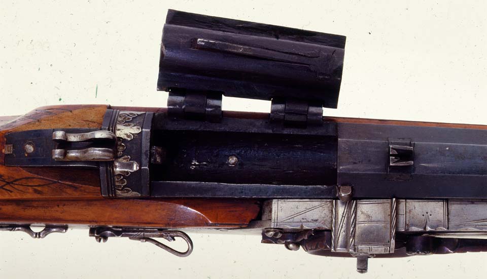

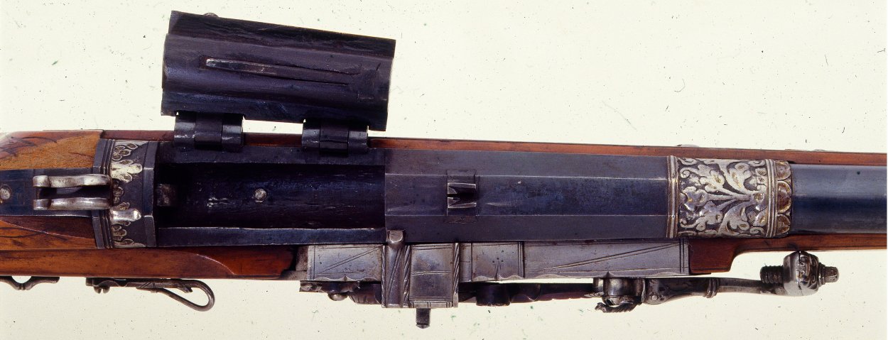

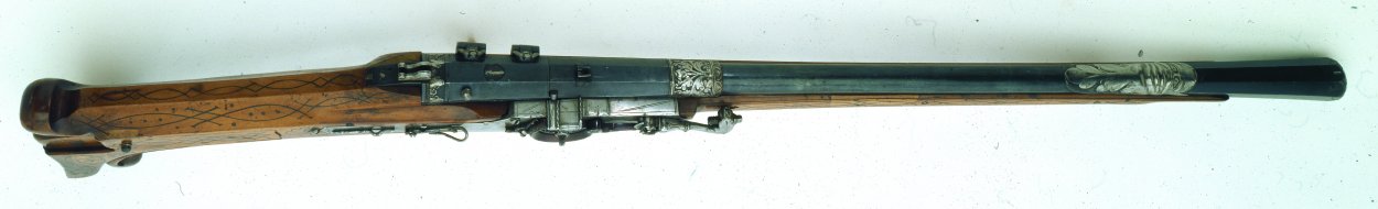

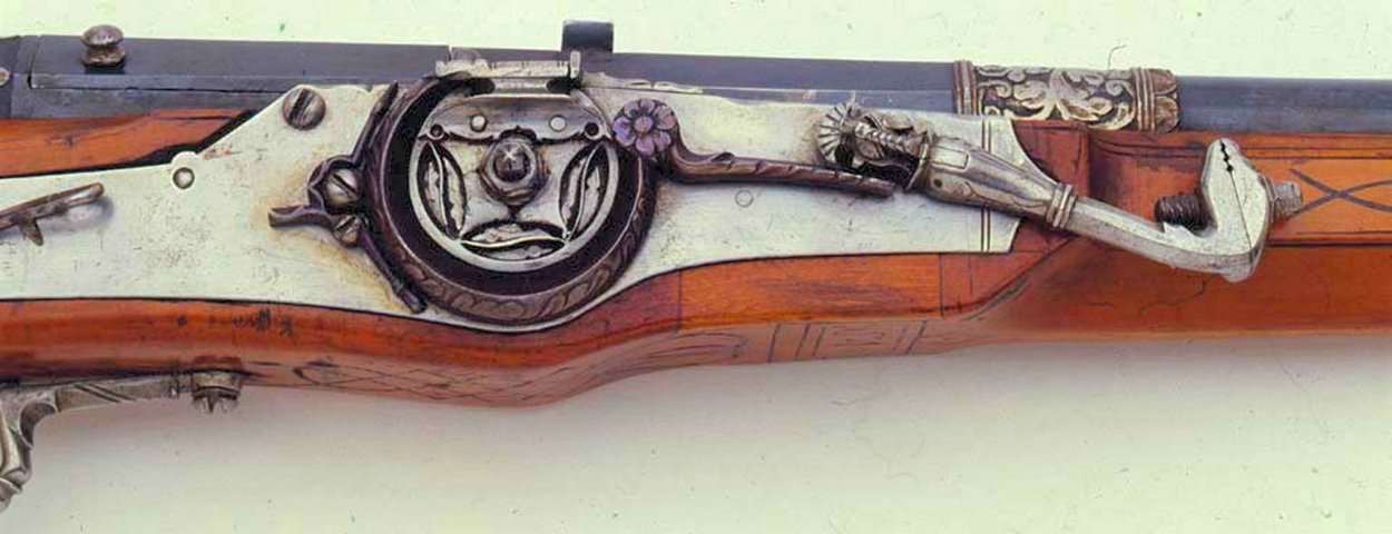

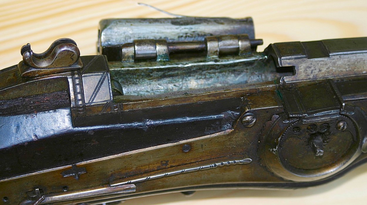

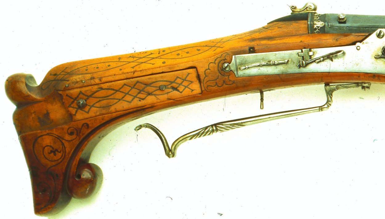

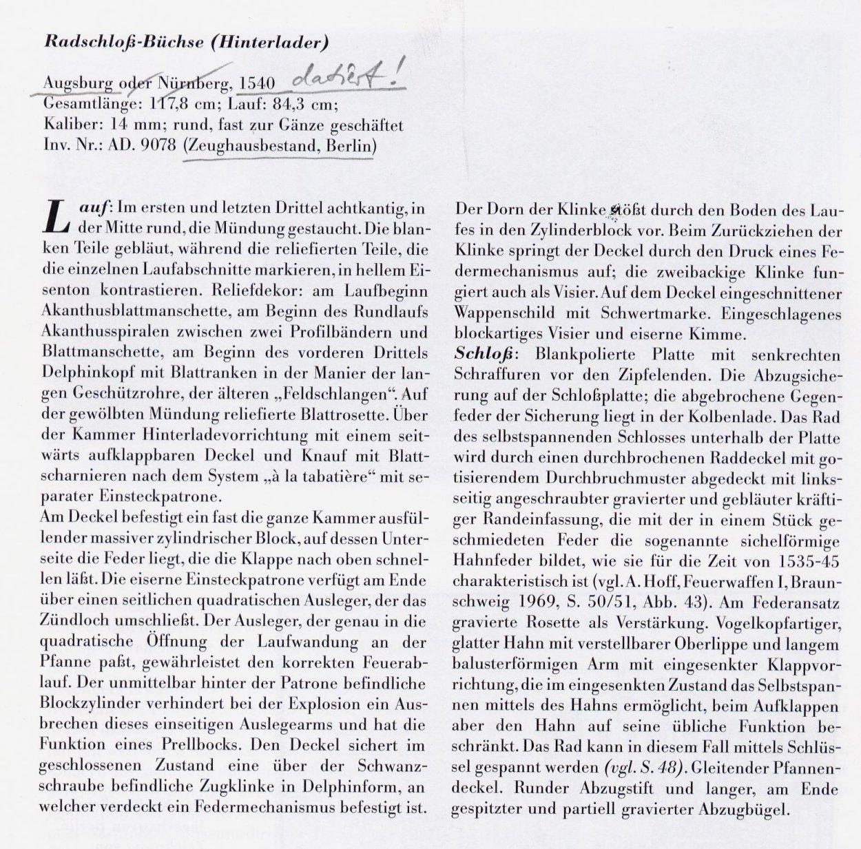

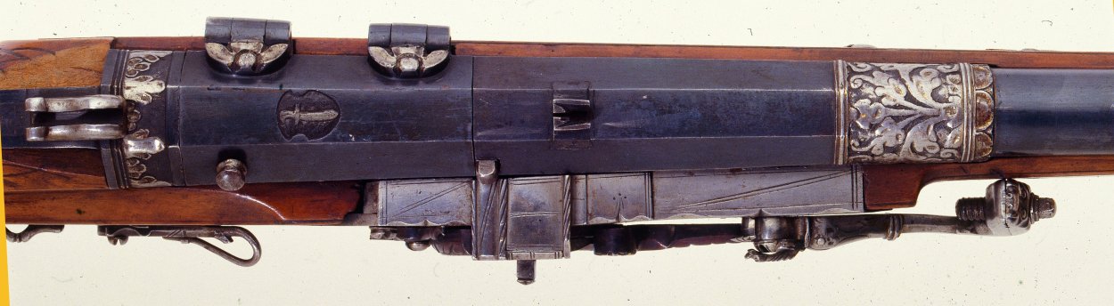

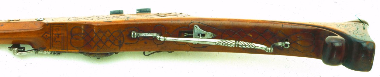

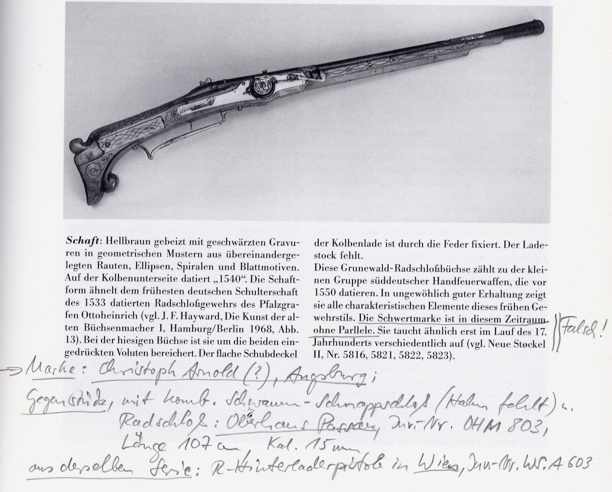

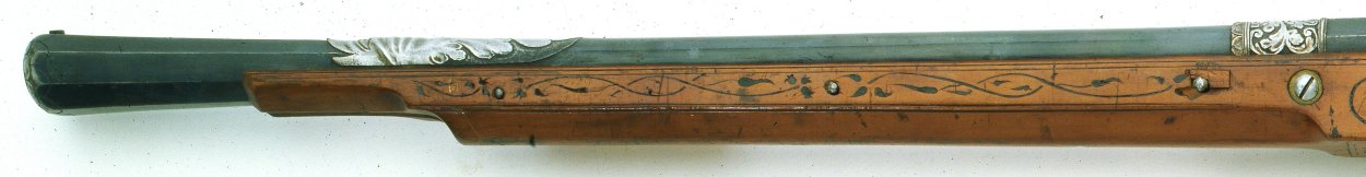

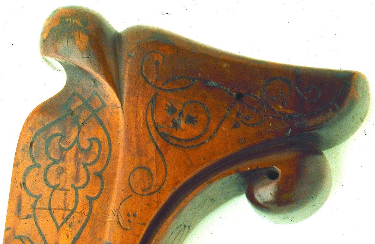

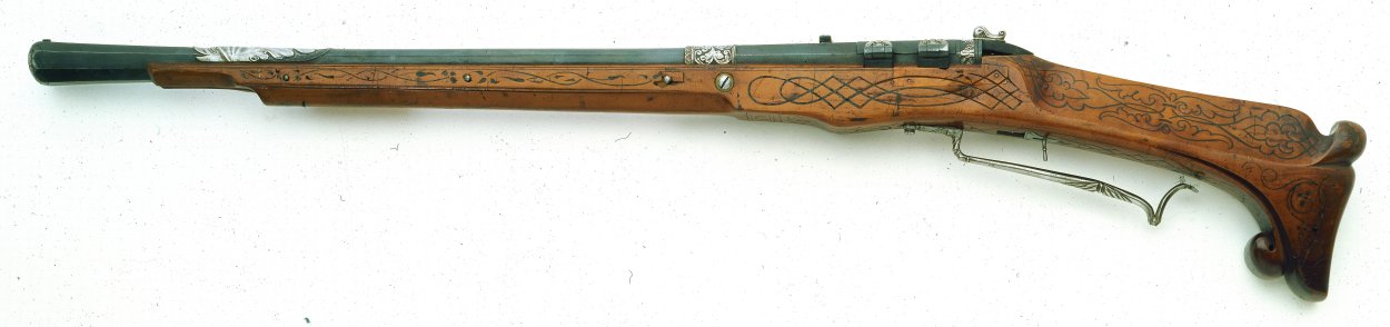

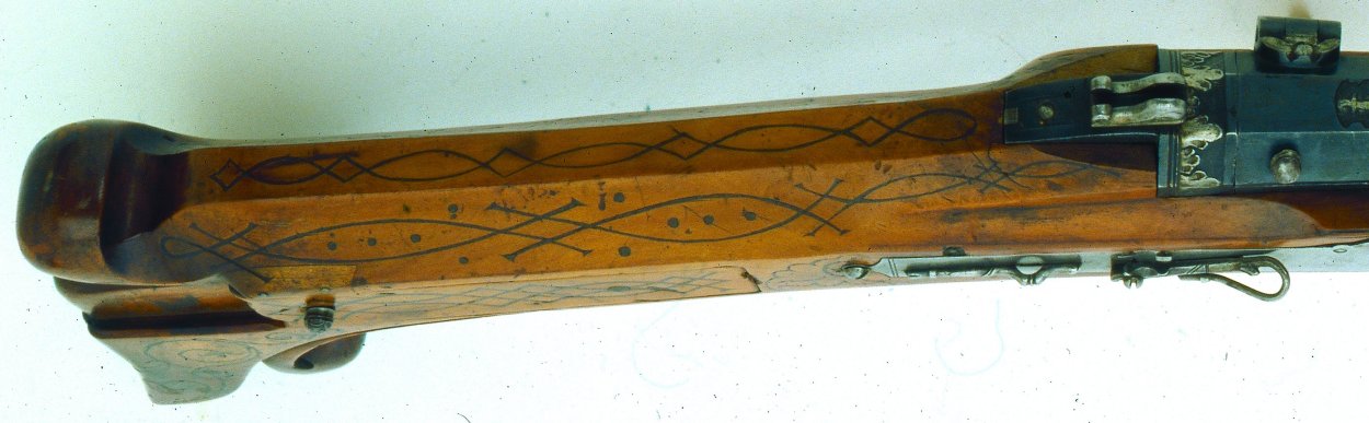

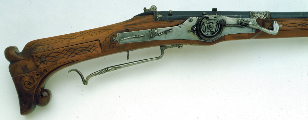

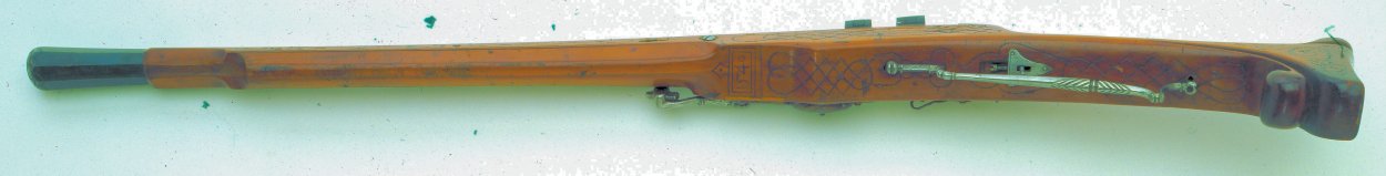

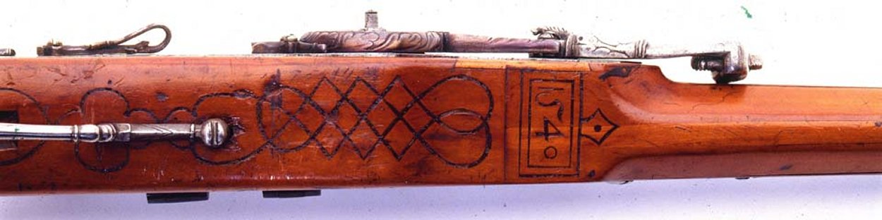

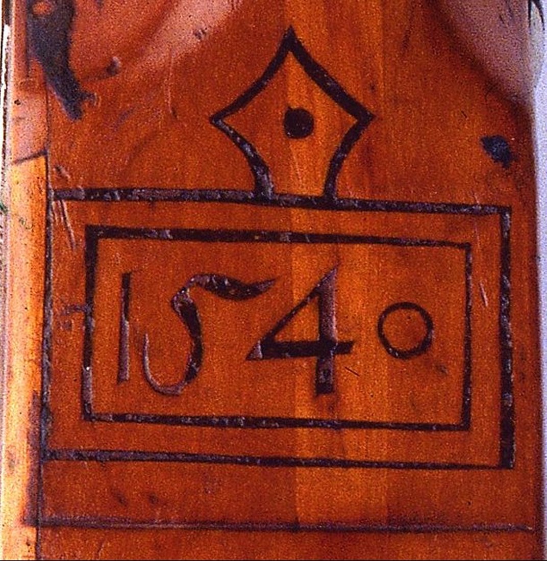

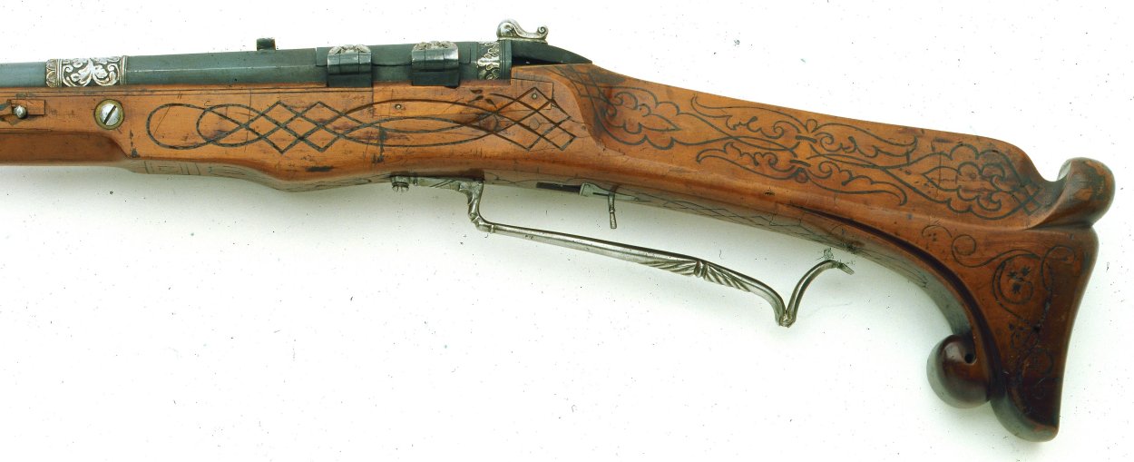

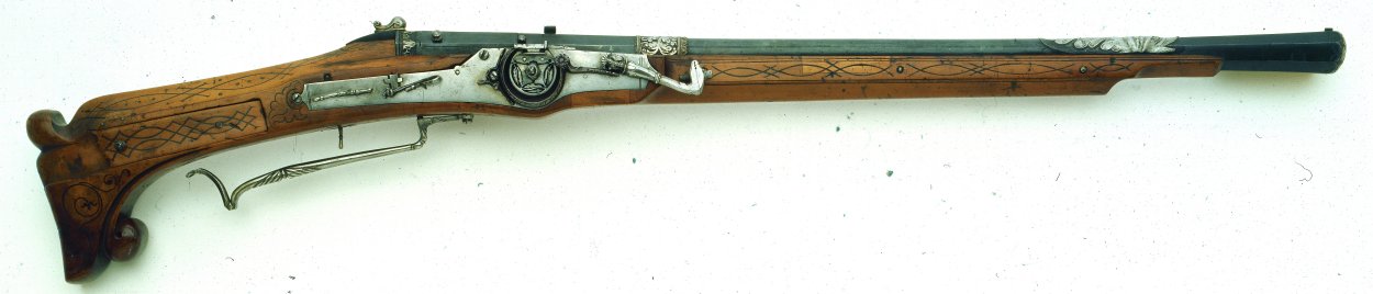

Default Two More 1540 Augsburg Breech Loading Wheellock Arquebuses
Both thhese arquebuses, just like the combined wheellock and snap-matchlock Passau arquebus shown in post #5 and and the Vienna wheellock pistol illustrated in post #6, bear the maker's mark of Christoph Arnold of Augsburg, Bavaria, Germany, on the breech.
Both have self-spanning locks as well!
They are stunning pieces of 500 year-old high tech!!!
Please note the sickle-shaped dog spring running around the wheel!

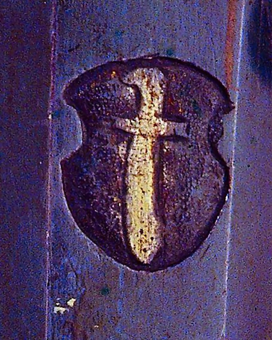

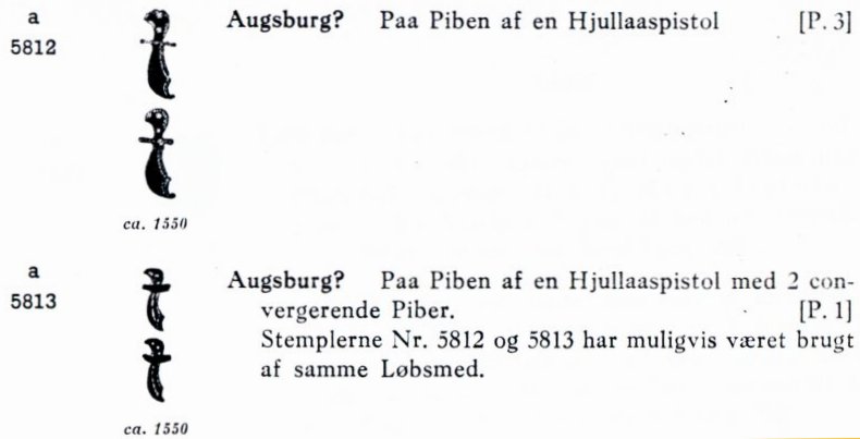

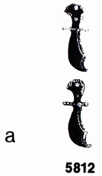

This falchion mark (Stockel #a 5812) is illustrated below. In most cases, Christoph Arnold struck it twice on the barrels of his guns.

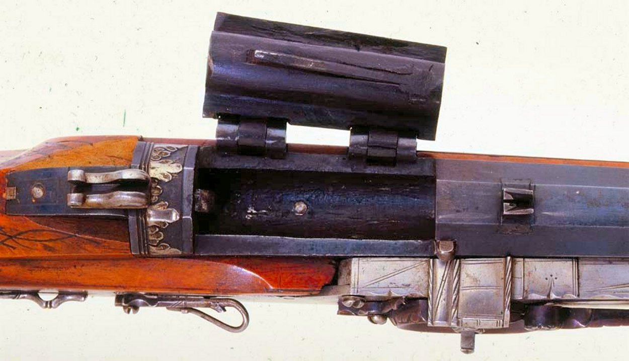

The first arquebus is preserved in unusually fine original and near mint condition; its surface colors with the striking dark blue and the bright polished acanthus leave friezes in between, contrasting with the light brown color of the pearwood full stock decorated with dark Early-Renaissance loops and tulips or hops (German Hopfendolden), demonstrate how overwhelming the impact of Early Renaissance coloring on 500 year-old weapons actually was!

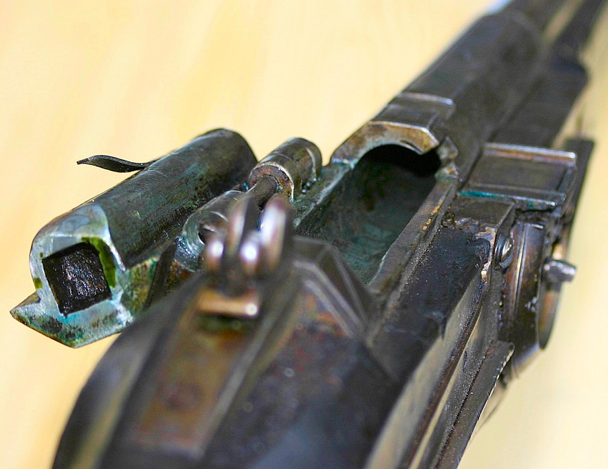

On breech-loading guns (système à la tabatière), the spring-loaded breech section normally opens by pulling back the rear sight allowing one of a number of iron cartridges once held ready for fast exchange to be inserted. On this piece by Chistoph Arnold, however, the breech snaps open by pulling back a spur-like device at the rear, much like the spur of a percussion hammer!
Another special feature of Christoph Arnold's locks is that their pan covers slide manually instead of shutting by a spring-loaded relase button!
The self-spanning mechanism is acivated by pressing a little clamp at the base (foot) of the dog which, in this unique instance, then actually acts as a cock and spans the wheel via a long chain consisting of a lot of riveted liinks - please see images of the inside of the lock in post #5!
The cleaning rod (in this case it was not a ramrod!) is now missing; it would have been of wood, most probably ash, and equiped with a tubular iron finial threaded for a scourer. Also a wood screw is missing from the rear end of the trigger guard.
A small piece of wood has been replaced below the dog.
This arquebus is preserved in the Jagdmuseum (hunting castle) Grunewald near Berlin, inv.no. AD.9078.
Overall length 117.8 cm, barrel 84.3 cm, caliber 14 mm smoothbore.[I]
Michael

Both, just like the combined wheellock and snap-matchlock Passau arquebus shown in post #5 and and the Vienna wheellock pistol illustrated in post #6, bear the maker's mark of Christoph Arnold of Augsburg, Bavaria, Germany, on the breech.
Both have self-spanning mechanisms as well!
Please note the sickle-shaped dog sprimg running around the wheel!
On breech-loading guns, the spring-loaded breech section normally opens by pulling back the rear sight allowing one of a number of iron cartridges once held ready for fast exchange to be inserted (système à la tabatière). On this piece by Chistoph Arnold, however, the breech snaps open by pulling back a spur-like device at the rear, much like the spur of a percussion hammer!
The cleaning rod (in this case it was not a ramrod!) is now missing; it would have been of wood, most probably ash, and equiped with a tubular iron finial threaded for a scourer. Also, a wood screw is missing from the rear end of the trigger guard.

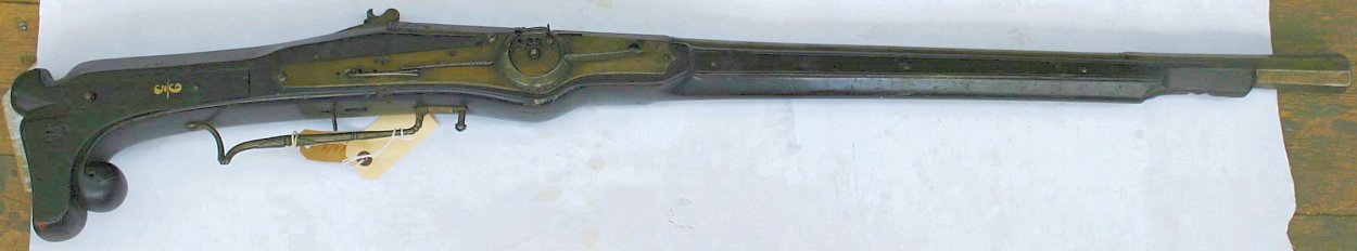

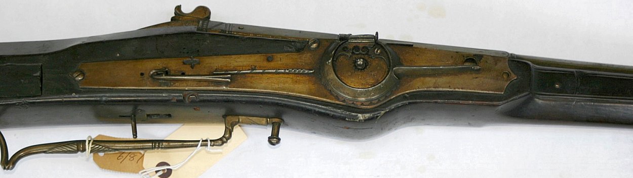

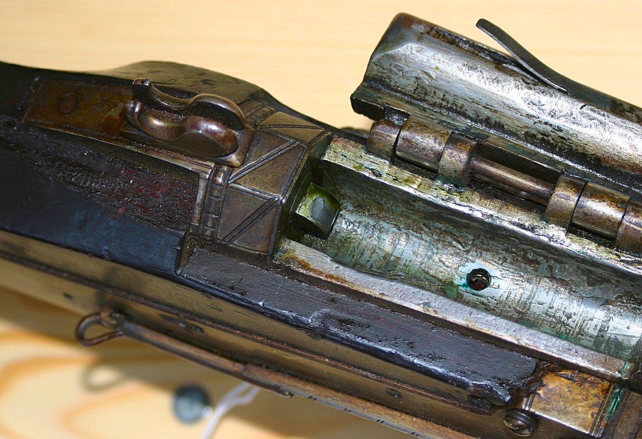

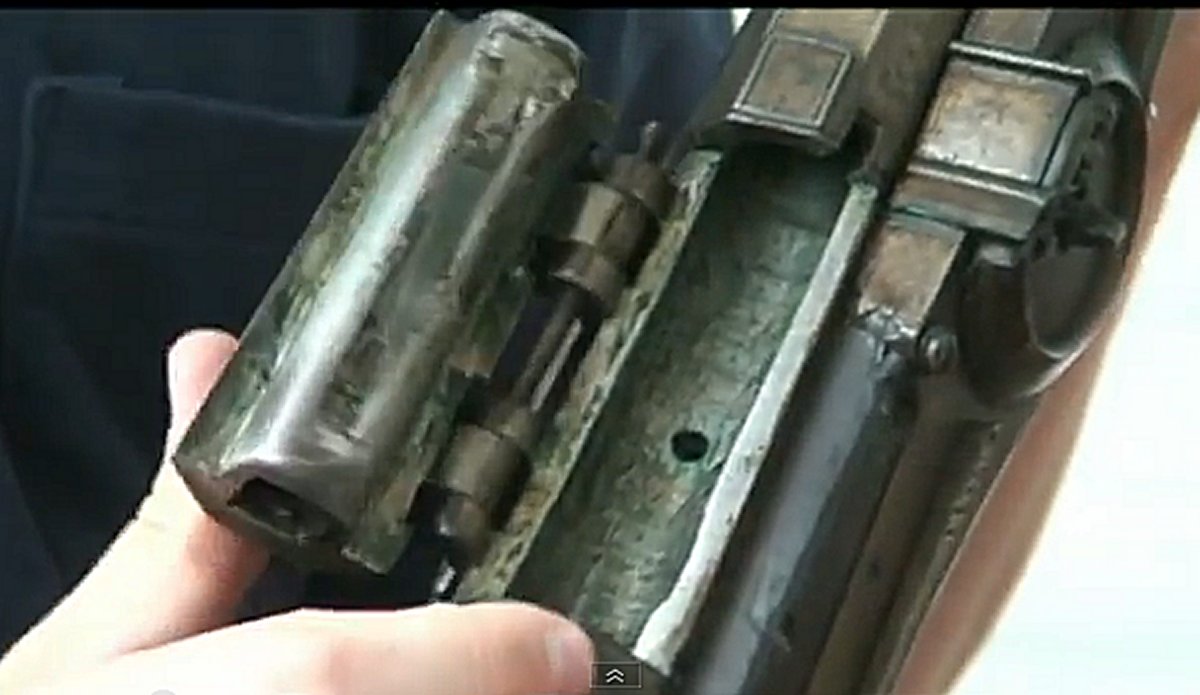

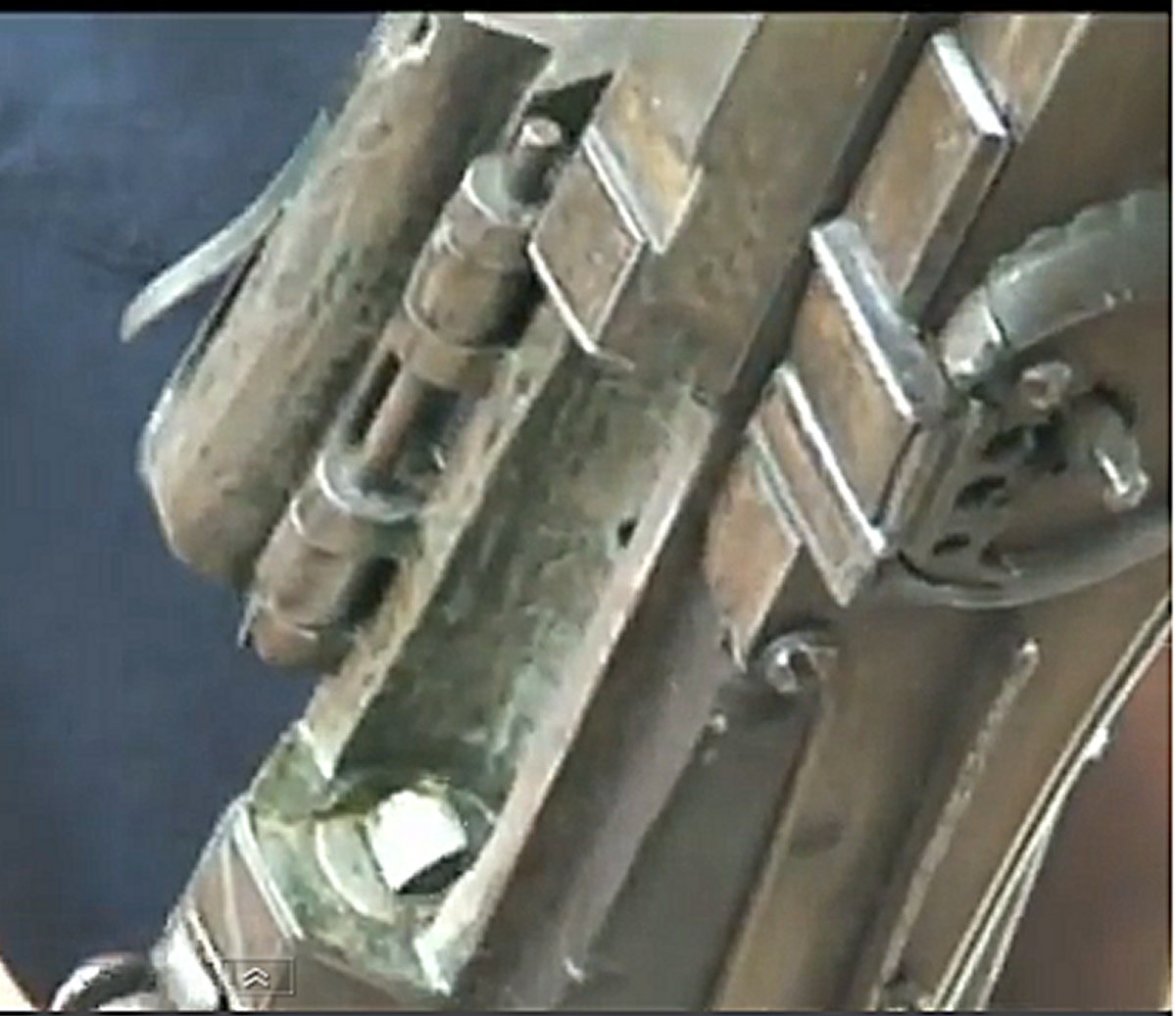

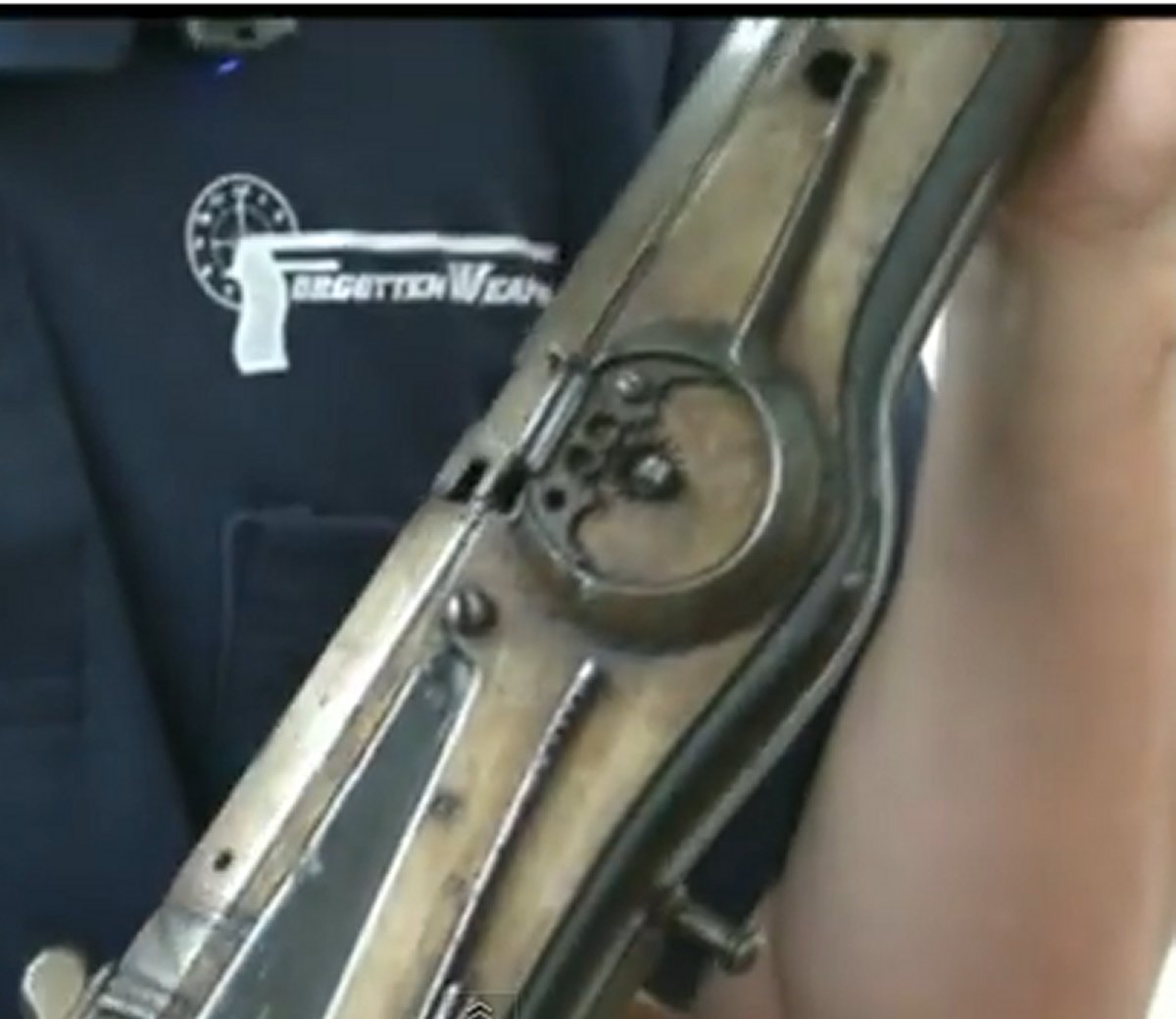

Both these arquebuses, just like the combined wheellock and snap-matchlock Passau arquebus shown in post #5 and and the Vienna wheellock pistol illustrated in post #6, bear the maker's mark of Christoph Arnold of Augsburg, Bavaria, Germany, on the breech.
This second arquebus is preserved in much less fine original condition but the iron parts show a nice old yellowish dried-oil surface, and together with what might be traces of the original bluing/case-hardening color, plus some fine greenish grease resulting from the chemical influence of the copper-soldered iron parts seen on the inside of the open breech, and the patina of the stock, they all add up to a very charming impression of a virtually 'untouched' piece, a sleeper.
The stock of this piece is painted black, which is not necessarily its original color.

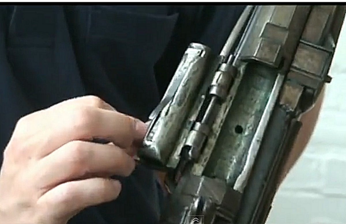

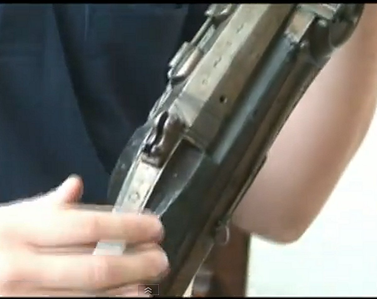

On breech-loading guns (système à la tabatière), the spring-loaded breech section normally opens by pulling back the rear sight allowing one of a number of iron cartridges once held ready for fast exchange to be inserted. On this piece by Chistoph Arnold, as on his other breech-loading guns, however, the breech snaps open by pulling back a spur-like device at the rear, much like the spur of a percussion hammer!
The dog for the pyrites is missing from this gun, and we cannot see the inside lock mechanism, but we may assume with sufficient certainty that it, too, originally employed a self-spanning action.
The iron cartridge is missing from the breech. The cleaning rod (in this case it was not a ramrod!) is now missing, too; it would have been of wood, most probably ash, and equiped with a tubular iron finial threaded for a scourer. Also a part of the swiveling safety catch is missing on the rear left-hand side of the lock plate, as well as the originally dove-tailed backsight of the barrel.
This arquebus is preserved in the Rotunda Museum of Royal Artillery, Woolwich, Great Britain.
May I ask the curators of the Rotunda to be kind enough to take out the lock from the stock and take good images from various angles of its inside mechanism? I would then gratefully comment on the gun with greater authority.
Overall length ca. 118 cm, barrel ca. 84 cm, caliber ca. 14 mm smoothbore.

Finally here is the link to the video.
The section on the 1540 wheellock starts ca. 14 seconds after the beginning of the video:
http://www.youtube.com/watch?v=NSyxpvIZXxY
That guy, Iain, is stating a few things that are incorrect.
E.g., he actually touches the wheel, encircling it and at the same saying that it is missing - which of course is complete rubbish!
I thought the Rotunda had personnel that at least knew what they were talking about ...
