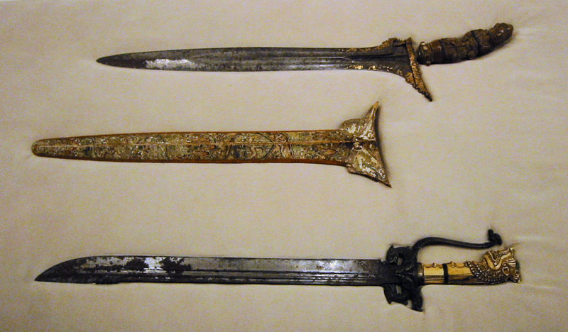

Gustav, thanks for the pics.
Originally Posted by migueldiaz
Which leads us back to Ron's very old kris with a round tang that defied the trend. Well, I'm still scratching my head on that one. Can it be that the smith was Indonesian? Could the prematurely broken 'elephant trunk' be another sign that the smith was not that familiar with the finer points of making a Moro kris? Just thinking out loud ...
Given said pics posted by Gustav, then all the more I'm led to speculate that Ron's kris must have made by an Indonesian also, with the roundish tang and all ...

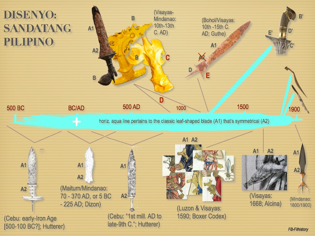

Originally Posted by David
Given that early ("archaic") Moro kris seem to incorporate all the exact same minute details of design that we find on the Javanese keris (gandik, gonjo, sogokan, blumbangan, kembang kacang, greneng w/ rondha, lambe-gajah, etc.) and that none of these features are visible on any of the examples of these ancient kalis that you have posted i have a very difficult time accepting the Moro kris as 70% homegrown as you have suggested.
David, thanks again for the comments.
I'm presenting below a rehash of my earlier visuals. And this will enable me to outline more clearly my position. But lemme say at the outset that I'm not emotionally attached to this position
In fact if my theory (or anybody else's theory) can be demolished soon, then I think we will all agree that that's progress. That is, the whole point of the discussion is to merely find the 'best fit' in the data vs. the interpretation.
But first we have to agree on what defines a Moro kris. For me and simplistically speaking, a kris to be a Moro kris has to have the ffg.: (a) an assymetrical blade; (b) a ganya, i.e., the guard; and (c) that whole 'elephant trunk' assembly with the gaping 'mouth'.
I think it's reasonable to add a 4th one: a greneng, i.e., the blade trap, as I know of no Moro kris that doesn't have this. And let's add a 5th and final one: the tang has to be non-circular, otherwise it won't be an effective slashing weapon.
Thus the five items above would be the 'must have'. And the rest would merely be 'nice to have'.
Using the above criteria, obviously the Bohol kalis is not a kris. Bec. though it satisfies four of the criteria, yet there's no "c". But I think all of us agreed already that the said kalis is not a kris.
Yet still, for me that kalis is a key piece in the puzzle. And that's because the said kalis, planted the seeds of what will become the Moro kris. And so we now turn to the plate below.
First the easy part -- the lower half of the plate pertains to what we already saw before: the leaf-shaped assymetrical double-blade over time and space was the classic form, both in our islands and abroad (Indonesia, Malaysia, Cambodia, Thailand, etc.).
And I've made the thickness of the aqua horizontal line thinner as one reached the 19th century. What I'm implying there is that the volume of blades produced with that design declined, as more assymetrical and larger blades grabbed the limelight over the last 300 years or so.
Now on the upper half of the plate --
The group of three hilts/blade should actually be on the lower half of the plate. But I just ran out of space. Anyway, it's good to also place that bunch up on top, because together with the Bohol kalis, we can see the seeds of what will aggregate to become a Moro kris:
(1) the 'elephant trunk & mouth' ['C'] on the northern Mindanao gold hilt is for me a key evidence, that the Moro kris must have been homegrown -- and as a side note, the round thing on the other side of the hilt is reminiscent of some Moro kampilan hilts, as well as other Indonesian hilt forms;
(2) then the blade assymetry on the Bohol kalis ['A2' crossed out] is yet another baby step;
(3) still on the Bohol kalis, the guard/ganya ['E'], and its greneng [also 'E'] would be further proofs; and
(4) finally, the square or rectangular tang ['D'], starting with the 10th to 13th century pieces would round up the picture.
In summary, since all these big ticket items can be found on archeological weapons artifacts in our country, then it is reasonable to conclude that most of the Moro kris' features are homegrown (the '70%', if we are to pick a number from the air).
As for the 30% (the finer features of the kris, which can't be found on ancient Phil. kalises), that to me is just icing on the cake And I can attribute those to Java as the source of the design elements (and this is not to belittle Java in any way of course).
Pls. correct me if I'm wrong. But my impression is that you are focusing on the 30% as proof that the Moro kris was not homegrown. But wouldn't that be a case of the tail wagging the dog?
But as I mentioned, I'd also like to try and destroy my own theory, if only to find out what's a more plausible scenario. Hence, while we all await with bated breath and with great anticipation Alan's book, can you please comment on the following?
(a) what would be the oldest Javanese artifact or image, wherein we can see something like 'C' in the illustration below (in any weapon), and we are not looking for a whole keris, that is, just that particular design element -- once found, we then compare the age of that, vis-a-vis the 10th to 13th century dating of that gold Mindanao hilt bearing 'C';
(b) what would be the oldest Javanese artifact or image, where there's a ganja preferably with greneng, in an asymmetrical dagger -- again, we will then compare it with the 10th to 15th century Bohol kalis bearing those features; and
(c) finally I've always been intrigued on what's supposed to be the oldest Javanese keris/es, as recovered from an archeological dig; can you please post pics of those? given Java's very rich cultural past, I've always wondered why I can't seem to find pics of those, which I'd really like to compare with ancient Phil. kalises.
In summary, if certain key design elements will be found on earlier Javanese objects (as compared to the Phil. specimens), then I will happily move on and formulate a different hypothesis
PS - My fearless forecast is that in between the Bohol kalis (10th to 15th C. AD) and the present Moro kris form (17th C.?), there ought to be another missing link in which either the leaf-shaped blade would have straightened already, and/or the gandhik would already be there on the opposite side of the greneng, with the gandhik design element most probably coming from Java, together with the janul, bungkur, lambeh gajah, etc.).
BTW, 'B' in the plate refers to the sun-fire-bird motif, which can be traced to the ancient Austronesian religion that venerates those, as the icons of the Upperworld (and the naga or croc or turtle, etc., as the icons of the Underworld). And so we see a coherent picture, of how the archeological items provide evidence of a continous stream from the past to the present forms.

Old 20th August 2012, 12:23 PM   #65
Gustav
Join Date: Jun 2009
Posts: 1,346

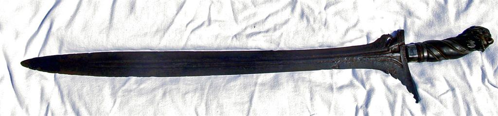

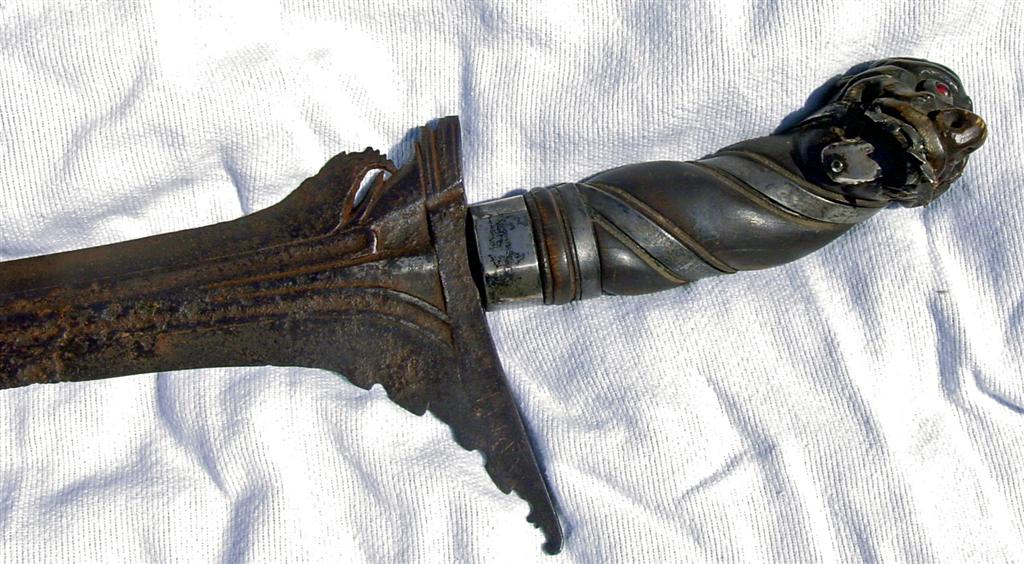

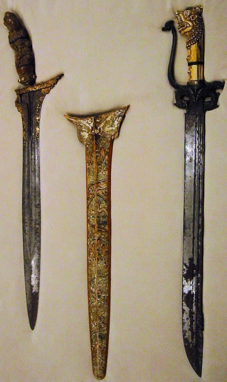

Dear Migueldiaz,
regarding the pictures I posted in#43, I would like to pose my opinion, which, of course has not much weight.
The kris without gonjo is the one nearest to the Javanese/Balinese keris. Yet even this kris has features we never would see on Javanese/Balinese keris, regardless of their age.
The kris with gold hilt is a big step towards typical Sulu kris.
Ron's blade in my eyes has a very Mindano like Gandhik area, which even would not fit the features of the more Jav./Bal.-like Sulu Gandhik. Here I really don't understand, why it has to be made from am a smith from present day Indonesia territory - just becouse it has a roundish tang?
Old 20th August 2012, 01:37 PM   #66
Gustav
Join Date: Jun 2009
Posts: 1,346
[QUOTE=migueldiaz]
[QUOTE=migueldiaz]
It has little to do with the discussion of kris origin, yet here I would like to remark, there are Moro kris without greneng.
[QUOTE=migueldiaz]
[QUOTE=migueldiaz]
Yes, but without any doubts there simply are Moro kris with round tang. You can't ignore them.
[QUOTE=migueldiaz]
[QUOTE=migueldiaz]
These ornamentics/symbols are found at many places in SEAsia, as you do remark by yourself. With the same ease you say this feature is Gandhik with 'elephant trunk & mouth' someone could remark it resembles Greneng. For a key evidence of a theory this likeness is a very week point.
[QUOTE=migueldiaz]
[QUOTE=migueldiaz]
As earlier mentioned, even early Javanese keris forms and pre-keris daggers also have a rectangular tang. It is absolutely nothing unusual&typical only for Philippines.
[QUOTE=migueldiaz]
[QUOTE=migueldiaz]
Here I would like to remark, all on Moro kris looks like a typical Keris-culture-periphery product: the symbolic details from Javanes/Balinese repertoire are taken and repeated in a increasingly ornamental way ("just icing on the cake"), with time progressing in features more and more typical for this peripheral region and mixing with the specifical ornamentics and symbols of this region. Such development per se is absolutely normal and absolutely typical.
Regarding the object from Bohol, the ancient japanese spearheads would give a more appropriate forefather of kris: you could find there by far more features similar to Moro kris. As I see, there (Bohol-object) is no Gandhik (ricasso) at all, and terms Gonjo (in this case Gonjo Iras) and Greneng would be need to be very stressed to fit the features of this object. It distantly reminds the silhouette of Keris Sepang or perhaps Keris Puthut, yet there simply are no Moro Kris Sepang and Kris Puthut, and no Moro kris at all, which would look like the Bohol object.

Miguel, Gustav has already answered some of what you have presented, but i will also give it a go.
This is good to hear. I also have no emotional attachment here, no horse in this race, so to speak. I am not tied to the present accepted theory of development, but do need to see solid evidence to the contrary before i would change my own opinion.
I can accept all of these except the last. As Gustav has pointed out there are indeed examples of Moro kris with round or rounded tangs. They cannot be ignored and they are not going away.
Perhaps we need to define our terms better, but on the Bohol kalis i not only do not see an "elephant trunk", but also NO gonjo/ganya, NO greneng and NO proper gandik. Please keep in mind that we are looking at this weapon in a very 2-dimensional format, but the blade appears very flat to me. I do not see a gandik by it's Javanese application on this blade.
I would also like to point out that this is the only example of this exact blade form which seems to have surfaced in the Philippines. That seems odd to me for the "seed" of what was to become the prevalent sword of the Moros. Where are the others and all the transitional forms?
I'd say there is little doubt that this gold hilt shows some of the stylistic flourishes that would be added to the Moro kris from the original Javanese design. But the "elephant trunk & mouth" were features well in place in Javanese keris centuries before they appear on "archaic" Moro kris.
The assymetric blade is classic to the area and did not originate in the Philippines. Certainly this ancient form influenced the early development of the Javanese keris as we can more clearly see in the keris buda.
I hate to keep repeating myself, but i do not recognize any greneng nor a gonjo/ganya on the Bohol kalis. A simple widening of the blade at the base is not what defines a gonjo. It is a separte piece that has both width and specific shape. Even when gonjo iras, it is defined by an incised line.
As both Gustav and myself have pointed out, square and rectangular tangs are not the invention of the Philippines. They were used long before the 10th century examples you post.
I am afraid that it is these "finer features" that you refer to here that is what actual make a keris/kris a keris/kris. They are not flourishes, they are the meat of the matter. You seemed locked a the rather superficial, 2-dimensional overall assymetric leaf-shaped blade. Also the blades must be examined in 3-dimensions to truly understand the shape and design of these features.
As i mentioned before, i think we can safely say the the "modern" keris emerged in the Mojopahit period, though elements such as the gonjo and kembang kacang may have developed earlier. Since no known Moro kris with these features seem to have been created until a couple of centuries later and when they do emerge that look almost identical in features to their smaller Javanese/Balinese cousins i have little else to go in as to which preceded and influenced the other. If you can show me a 13th-14th century Moro kris with all these features intact that might be a game changer.

Old 15th September 2012, 02:43 AM   #73
HERE ARE SOME PICTURES OF THE OLD AND UNUSUAL KRIS. IT IS 28 INCHES OVERALL, BLADE IS 22 AND 11/16IN. LONG. 4 AND 15/16 IN WIDE ACROSS TOP. HANDLE IS CARVED OF HORN WITH SILVER FITTINGS. IN THE FORM OF SOME DEAMON OR DIETY WITH TONGUE PROTRUDING. IT SHOWS A LOT OF AGE AND HAD A OLDER BLADE FORM LIKE A MALAYSIAN OR INDONESIAN KERIS. WE HAD A GOOD DISCUSSION ON IT IN THE OLD ARCHIVED FORUMS BUT I COULD FIND NO TRACE OF THE POST.
Old 15th September 2012, 07:17 PM   #74
Posts: 7,303
That's a very cool old kris Barry. I suspect that it is not Moro, but a Malay form. Seem obvious that this one was not made to incorporate asang-asang. If anyone can locate the old thread on this i'd like to read it. That hilt is very, very awesome!

And to 'monkey' with the topic some more, earlier there was a comment on why is there only one such example of a proto-Philippine kris (i.e., the Bohol kalis) per my assertion or speculation.
My answer to that is that discoveries of archeological blade artifacts are really few and far between. Also, if an evolutionist would have finally found his half-ape/half-man missing link and he found only one, I don't think people will question why there is only one example. Btw, I don't believe in evolution (but that's going off-topic).
On the dating of the Bohol kalis as being supposedly no good -- because it's very wide (a 500-year range, between 10th to 15th century AD) -- I don't agree with the 'no good' objection We have to distinguish between precision and accuracy (see illustration below).
If while traveling around New York and New Jersey I lost my bag and a reliable person told me I lost it for sure within Central Park, that tip won't certainly be no good. The info is admittedly not precise (Central Park is about 3.5 sq-km). But on the other hand the info is very accurate (at least I'd know that the bag is not in Brooklyn, and for sure it's not in Jersey). And if somebody will add that my bag was last seen at Strawberry Fields (the Lennon memorial inside Central Park), then that would not only be accurate but also very precise.
The 10th to 15th century dating is surely accurate -- there's consensus amongst experts that it's within that age range. But we need more precision as we all said. And a radiocarbon dating or any other suitable lab procedure is the next step, as far as getting a tighter age range is concerned.
So what am I trying to say? Haha, I lost my train of thought ...
PS'es --
Barry, nice examples you posted there. It's now clear that the blade profile ('waisted') used in the Bohol kalis still lives.
David, I think my primate analogy didn't come out that clearly. It's my fault. So I'll rehash the analogy, and make another post very soon (just fixing the revised 'planet of the apes' illustration). Thanks.

Dear Migueldiaz,
this blade shape is not something reserved for Bohol object.
This is the picture of a keris with provenance. It came to Japan at 1620.

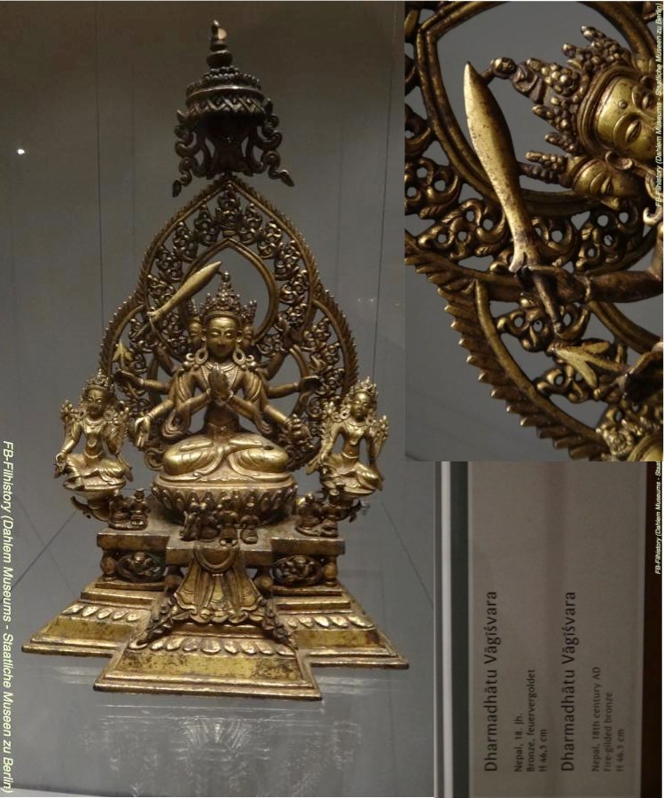

... the 'waisted' kalis blade, just like the Bohol kalis, is an ancient Phil. blade shape (but for sure, there's no exclusivity, as this blade shape is also found in many other cultures) ...
Just to add an example to the non-exclusivity of subject blade shape, here's a Nepalese blade that looks very similar (blade with a 'waist'). And it even has those triangular 'blade catcher'-shaped guards on both sides of the hilt.
But I'm sure nobody among us will claim that certain Nepalese blades are therefore related to the Southeast Asian keris-kris. And it's because we cannot analyze these things on a mere superficial level. I'm sure we are all in agreement on this point.
And so the blade shape is just the starting point. And we all look deeper -- trade routes, ancient religions which are the ones that bring forth design motifs, etc. To recap, I think there's no argument here at all

the point is, this blade is absolutely clearly Javanese/Balinese and has nothing to do with Philippines. That this blade was aquirred in Philippines is only one possibility, and this possibility is touched only in a wikipedia article. And I must say, I very possibly have read all existing publications about this keris.

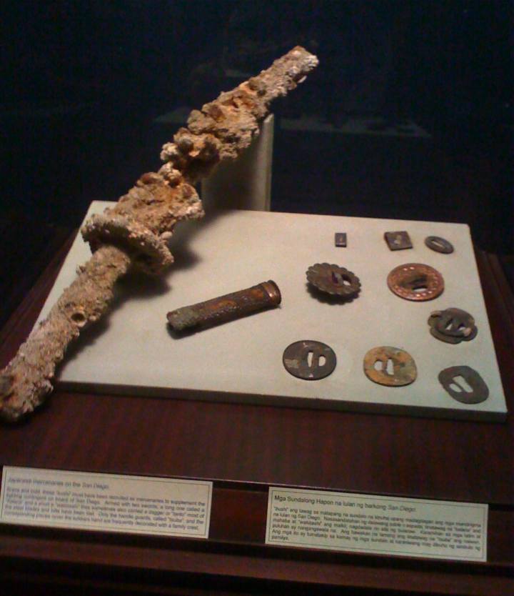

Here's pic of portions of a katana and tsubas salvaged from San Diego, from the Philippine National Museum.
The commonly accepted wisdom is that the keris as we know it (asymmetrical blade, gonjo, gandik, greneng, etc.) originated in Jawa, but the basic design for the keris didn't just pop out of thin air. Other blades certainly influenced its design. It did not develop in a vacuum. The "modern" keris (Mojopahit) developed in a Hindu influenced empire whose cultural roots come from India. Nepal is right next to India and also a Hindu state influenced by India. So, while i hate to surprise you like this Lorenz, of course there is a possibility, maybe even a likelihood, that this Nepalese blade is related to the keris and perhaps a forerunner in design to what was to become the "modern" keris in Jawa in the Mojopahit (or before) period. The Javanese keris has a few differences in the details, the specifics that we have already been over many times in this thread. The Moro kris, which doesn't seem to arrive until at least a couple of centuries later (again, please show me a Moro kris with all features intact that is earlier than the 16th century) has these same exact details of design. So for me, given all the present evidence we have to examine, the Moro kris was developed based on the specific design elements of the "modern" Javanese keris. All these features in the Javanese keris were fully intact before they appeared on the Moro kris.
Hi David. On the possible Nepali connection, I think that it can only be plausible if we can discover ancient Indian blades which remotely resemble kerises.
I can think of another illustration to visualize your scenario: let's imagine a figurative tree where the trunk is Indian Hinduism, the source of it all. Then there would be an older and lower branch and that would be Nepalese Hinduism. Then there would be a higher and younger other branch, and that would be Indonesian Hinduism (and a twig off this branch would be Philippine Hinduism, because we got our Hinduism by way of Indonesia).
Now to my mind if your hypothesis is to be plausible (that that Nepalese kris-like sword was derived from India, in the same manner that the Javanese keris had its ultimate roots from India), we should see lots of examples of Indian proto-kerises in ancient stone carvings, metal statues, etc.
But so far I haven't seen any (and I've been looking, too). So at the moment, I think it's just purely coincidental that that Nepalese blade resembles the Southeast Asian kris.
But as you also said, let's all continue to look for evidences, to either prove or disprove the theory, thereby continuing to make progress.
Old 22nd September 2012, 05:31 AM   #86
migueldiaz
migueldiaz's Avatar
Join Date: Oct 2008
Location: Manila, Phils.
Posts: 1,042
I am completely open to examining evidence to the contrary if and when it arrives. Still waiting...
David, I did not mean to keep you waiting. And we only have Gustav to blame, for coming up with those distractions! Just kidding, Gustav.
I can perhaps come up with other evidences, but unless we have a resolution on the definition of a keris-kris, then we will not really be resolving anything.
So I think it's absolutely necessary that we first go back to the topic of defining what a keris or kris is. And allow me to rehash that animal kingdom and blade kingdom analogy. Very quickly, once more (and my animal kingdom sub-classification is not meant to be taxonomically sound):
Birds & insects = Arrows, spears, & other projectiles
Aquatic animals & fishes = Shields of all sorts
Reptiles = Axes, clubs, maces, etc.
Amphibians = long swords
Mammals = shorts swords, daggers, & knives
- Mammal sub-group A (rodents, marsupials, etc.): blades of certain types
- Mammal sub-group B (primates, pachyderms, etc.): blades of another type
Now, the last sub-group B is still a big ball of wax. And since we all want to segregate further the 'primates' from within that sub-group, we have to make a narrower definition of what primates are.
My definition of what primates are: 'somewhat man-like in anatomy, and thus does not definitely look like an elephant, or a giraffe, or a dolphin, etc.' Hence the result of my definition of primates would be all of the guys below.
Now to my mind, you are defining what a primate is somewhat strictly, such that you will end up with just the gorilla, marmoset, and the chimp.
But this is not to say nor imply that since in reality all of the animals below are primates, then you are wrong As mentioned, this is just an illustration and all illustrations fail at some point.
Ok, moving now directly to the kris-keris world -- my definition of what a Phil. kris is: 'often has wavy blades, whether symmetrical or assymetrical, and/or is assymetrical and has at least one triangular 'blade catch' on the guard, and it does not matter at all whether the guard is separate from the blade or not'. Thus to me all of the blades below would be krises.
Now in my understanding of your definition, only the Javanese, Malay, and Sulawesi krises in the illustration below are real krises.
After the 1930s (if Cato is right), most of the Moro krises did not have separate guards anymore. Now let me ask you please, are those latter Moro krises not real krises anymore?
Also, I can practically guarantee that in the entire Philippines, once they see a wavy-bladed weapon, it will be regarded locally as a kris in the fullest sense of the word.
And once anybody sees that Bohol kalis, they will also regard that as a kris.
In summary, I now think that we all have to accept the fact that Philippines has a more liberal definition on what a kris or keris is (and that would be the whole caboodle below).
I would even venture to say that if we ask an Indonesian or a Malaysian and show them the Luzon and Visayan krises below, they would most likely say that it's those are krises all right, but they are the Philippine varieties.
Thus, in your definition of a kris or keris, wouldn't that be like defining the classical Indo-Malaysian keris more than anything else?
Hey, I have to leave now as I'm meeting in a few minutes 'Nacho' and Nonoy Tan. In fact I'll be late already but I'll have a good excuse!
