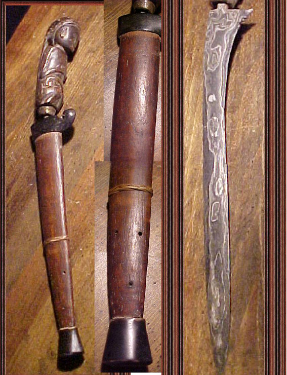

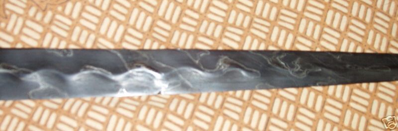

Dave, yes of course i can share with you about where and when i believed this blade is ASLIES (ASLIES=ASLI+YES). Sorry for using my own word, because your word ORIGINATES wasn't in dictionary.
Friend of mine brought this blade by the time Lombok's coffee morning is not finish yet. The blade was dirty, first exprescion in head was stranged about this blade and then suspicion for few seconds. About 2 minits later my feeling was changed and starting to belived that the blade is old (80%).
And then someone clean that blade.
After cleaned then of course i believed the blade is old.
Dave, i looked again...from Pasikutan, i guess this blade is tangguh nom-noman
(Bali).
Also according to blade's material + feeling of my NEW KNOWLEDGE about keris.
(Finally, surely answer is came out by other keris forum in Indonesia).
Dave, i knew some of keris dealers from Madura based in my hometown Surabaya (Jawa). I hang out with them and learn.
So, I knew their blades Dave.
Many blades are good too (hi...just my taste).

Simply put, i still think this last keris you have posted is a fairly recent one. You do not. That is OK, we all believe what we will.
I am still curious where you think this blade was made. Lombok, Bali, Jawa, Madura...??? Pasikutan is the length of the keris so it is not from there.
Tangguh is a system meant for high level Jawa keris. I don't think it can be properly applied to your keris. Even so, Nom-Noman is a fairly recent tangguh.
When a keris contains many unusual ricikan as this one does it makes me suspicious. Have you ever seen another keris in this form before? Is it in anyone's Pakem? If it truly is old and rare i think any smart keris dealer could have sold it for quite a lot of money. Ask yourself (don't tell us )how much you paid for it.
I hope this is clearer. Please ask questions if you don't understand my meanings.

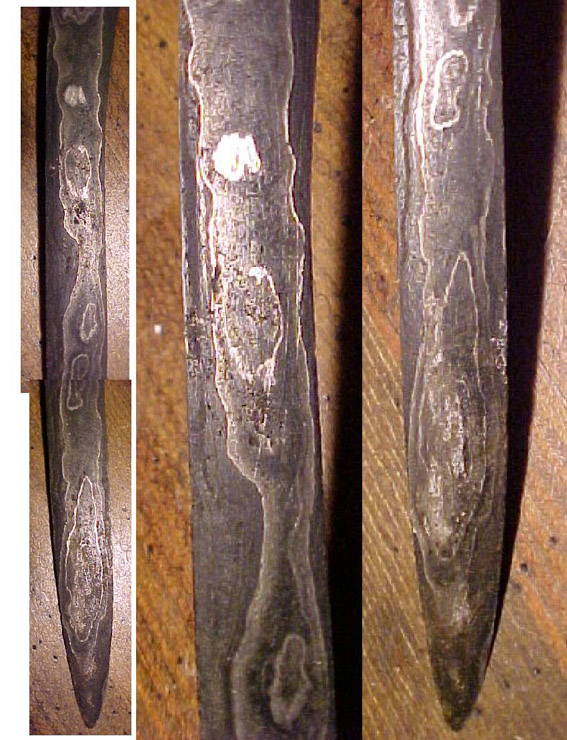

I have so far stayed out of this discussion, principally because I cannot see much point to it. However, right now it seems to be going in circles, so I will say a word or two.
When I see a picture of a blade, especially an internet picture, what I see is only form.
I know that I cannot rely on the colour I see; I have no idea as to its weight, its texture, its topographic relief. I can sometimes get some sort of an idea of the quality and style of workmanship, but not often.
From what I can see on the computer screen, all I can really trust is the form of the blade.
The blade that is being discussed appears to be a fairly large blade with a twist pamor and some unusual features .
The pesi is distorted and distressed.
Overall condition appears to be good with some minor distress.
We know that keris culture in Lombok is not so deeply entrenched in formal standards as it is in Jawa and Bali.
We know that the people of Lombok often have a preference for blades which display unusual features.
We know that this twist pamor which on Lombok is called "tambangan badung" is highly favoured by the people of Lombok.
On the face of it, this keris could well be an original Lombok blade.
However.
The point at which the pesi enters the gonjo appears to display the characteristic decline of current era keris with a Madura heritage.
The pesi is extremely distressed, far too much so for normal aging.
We know that the Madura craftsmen use published photos as source material for new creations.
We know that it is easier to sell a keris that is a little bit out of the ordinary in form, irrespective of quality of execution.
In Djelengga we can find pictures of Lombok keris showing similar features to the features of the keris under discussion.
We have been told how and where the keris was sourced, but this must be disregarded for the same reasons that we must disregard all undocumented stories when we undertake an objective assessment.
To sum up:- this is a keris with some unusual features which might be a recent creation, and equally might be an original Lombok keris, but upon the evidence presented which is only a series of internet pictures, I for one am not able to form an opinion either way.
May I suggest that we simply acknowledge that this is a rather unique keris , and even though the workmanship is fairly shoddy, and condition does leave something to be desired, it is worthy of collection if for no other reason than its previously mentioned unique features.

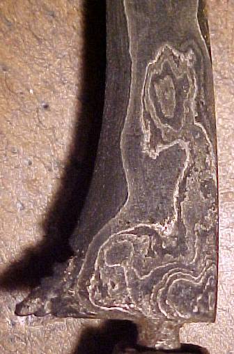

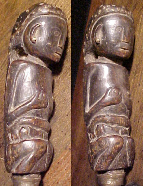

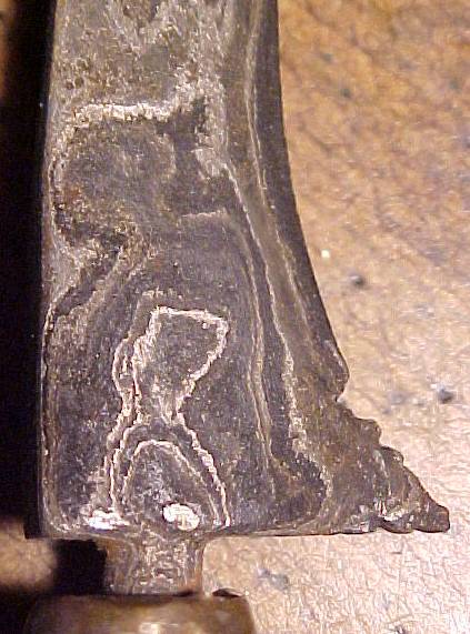

In this blade I see a bearded man wearing a robe and a head cloth; he is in a position of bowing respectfully; his shadow before him , he is outlined in bright pamor on the upper right hand side of the blade.
This is fun !
Hmmm... I see a woman bending over wearing a head-dress (possibly Minang style) handling a baby, nappy change, perhaps... hmmm...

It's funny how once you see something for the first time it pops up again. Here are pics of a keris that just finished on eBay.
I must say that to my eye this one appears to be more authentic to the Bali/Lombok style of keris making, but who knows.

Hi Guys, I would like to ask you something.
Do you see PICTURES on the blade? Because I saw some pictures. Kind of human sitting.
Is it Raja Gundala ?
Thanks
