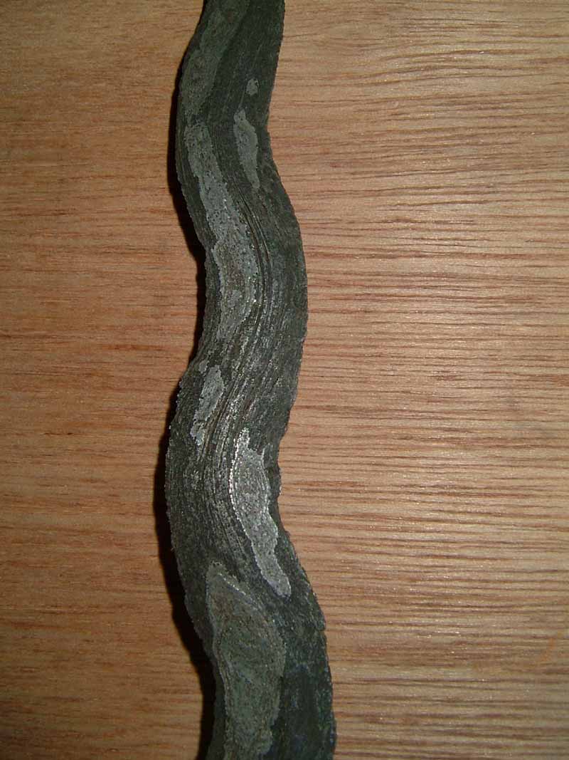

Hi guys ive just got a new project blade to work on,its in bad shape with no sign of contrasting pamor.....but does show a layered pattern.Its seems unusualy thick and heavy to me.I got this advertised as "old dagger or bayonet" and cost me the price of a carton of cigarets.A prime candidate for some cleaning and re-etching...should be fun
